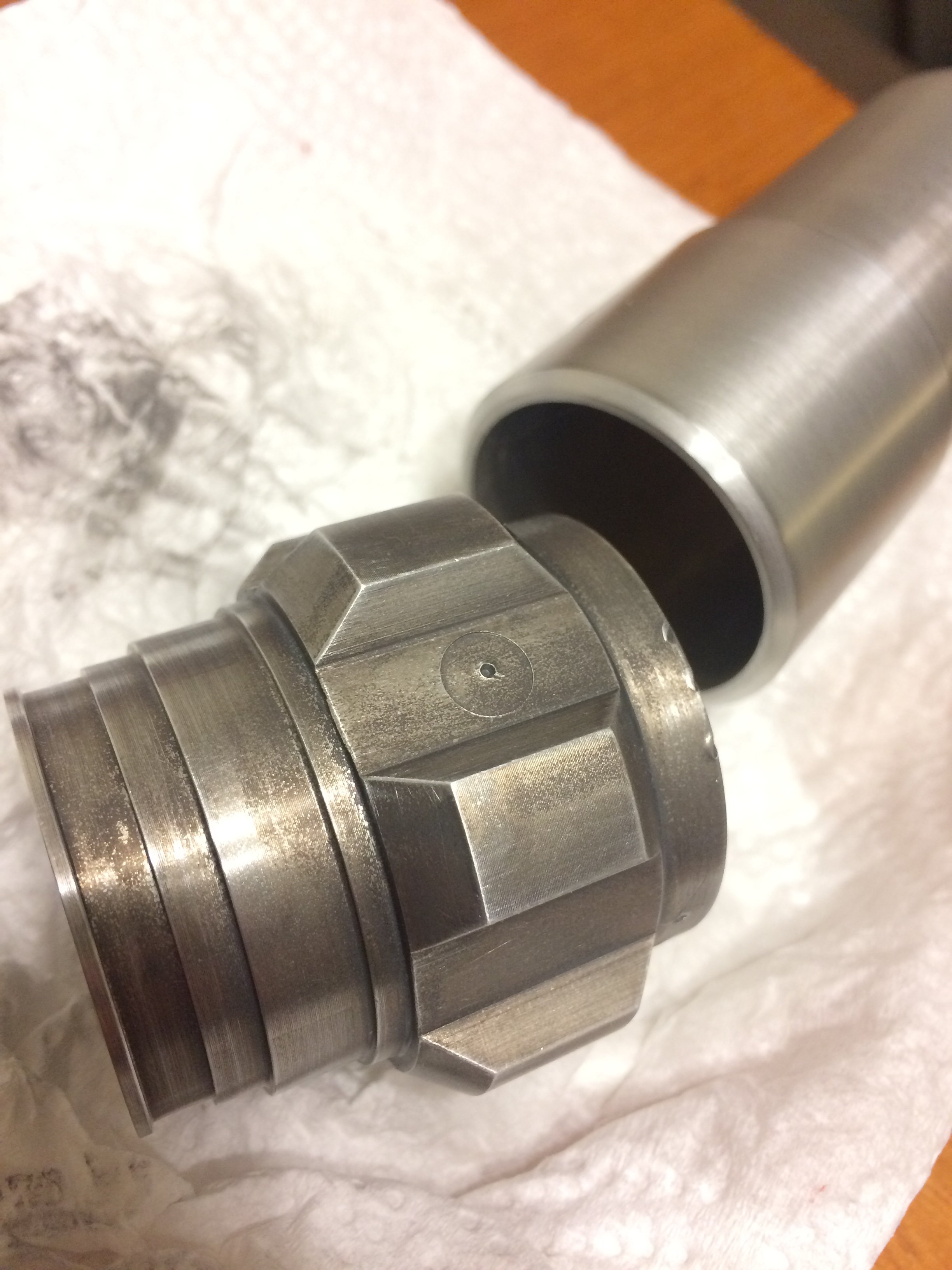

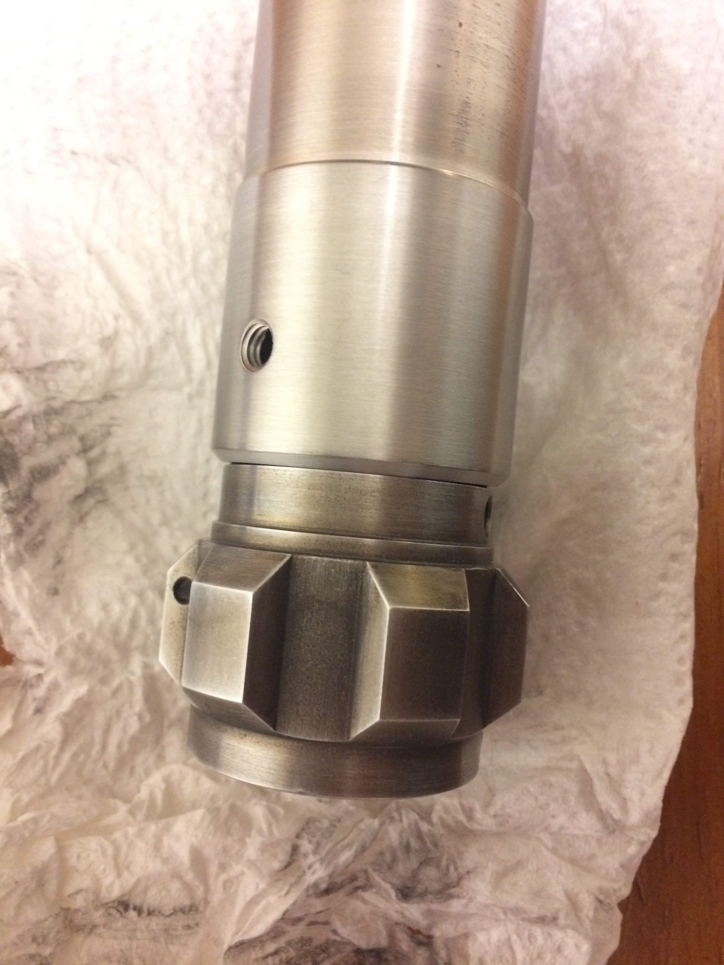

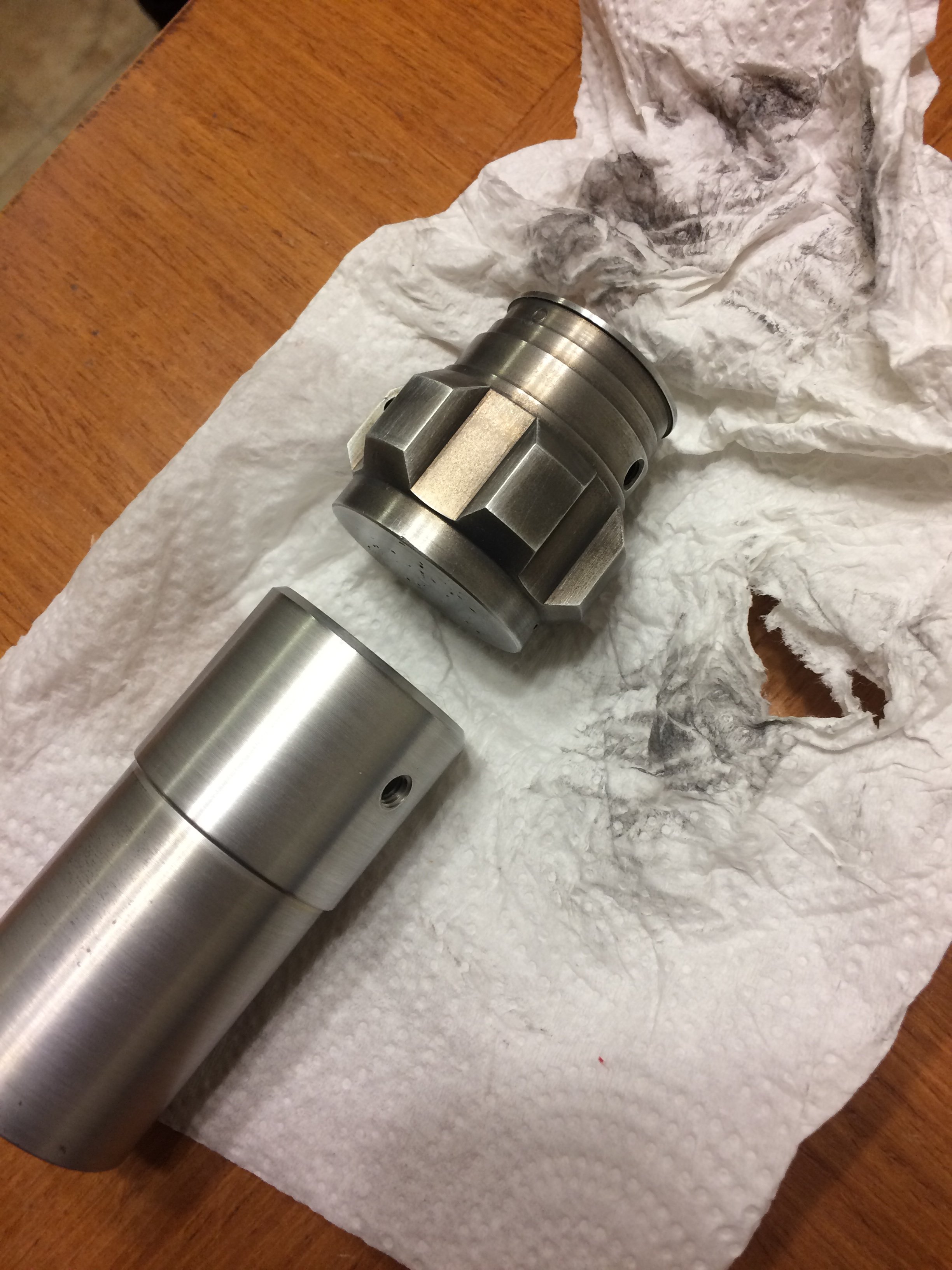

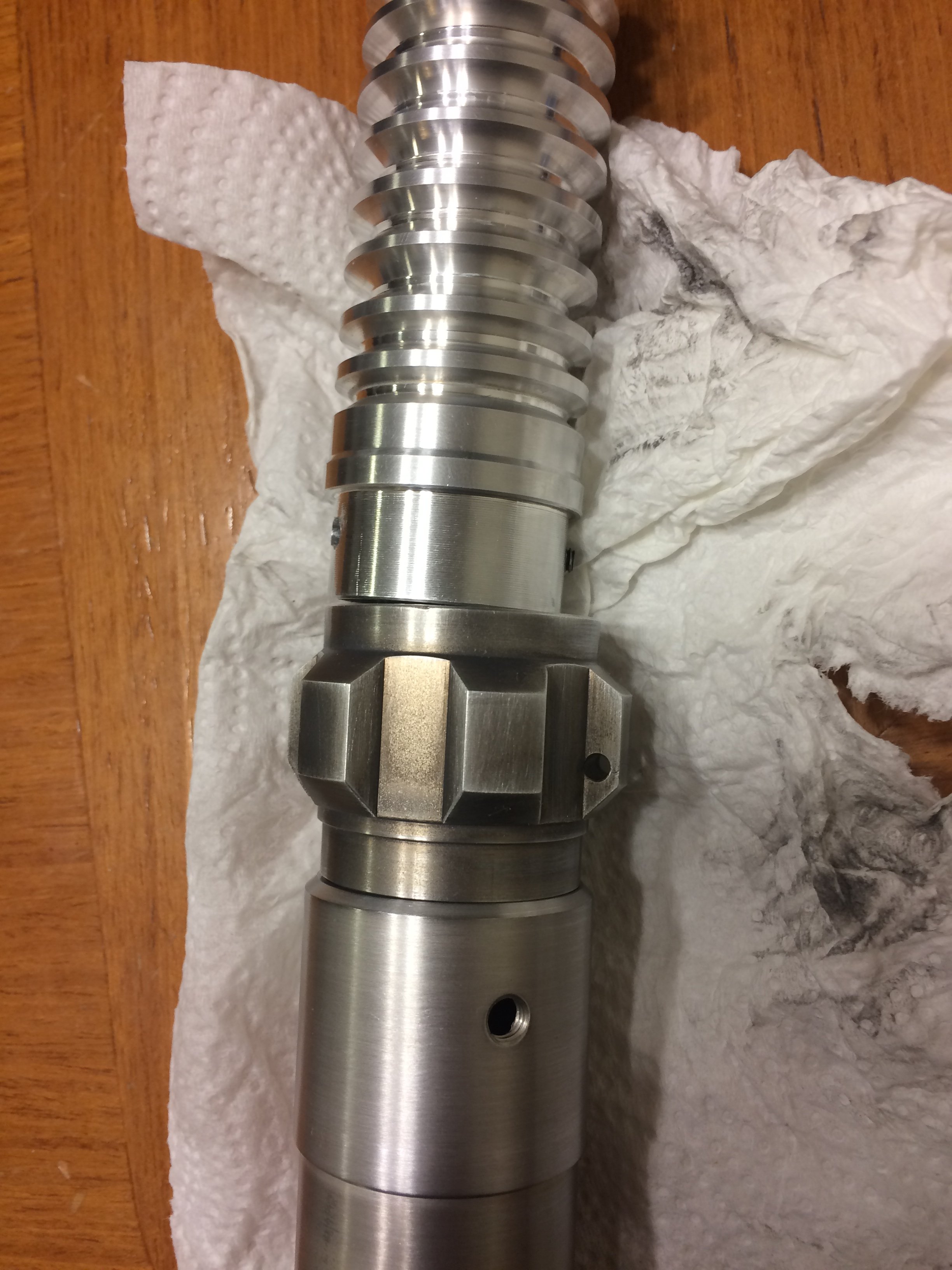

This should probably be in Halliwax’s weathering thread, but here are the first results of my wash with Versatile Oxiclean. My pommel came out DARK GUNMETAL. I included the paper towel so you can see just how much darkening was on there. Once I cleaned it off it didn’t rrally rub off easily and seems to be on there pretty good. The booster came out like nothing happened. Are these the same metals? I had the pommel on the top rack and the booster on the lower, so I’m gonna reverse them and see if that’s the trick. Here they are compared to the untouched body after I went over the pommel with some scotchbrite pad.
23003FC1-4052-4B4E-BD0C-ACE3A4F824C4.jpeg9F813227-68AD-41E4-84FA-8D5579F08E3F.jpegE01D4E16-D5B7-46AF-ADBA-301E0B228753.jpeg78F2BB9A-3D84-48E8-ABFA-04F23007AA8D.jpeg
When I first pulled that pommel out it was almost solid black, I’m glad it came down a bit with some scotchbrite pads. I did a normal cycle and pulled them out before they had much time to heat dry.
nice!! if your having a hard time with scotchbrite not bringing it down, you can always try a high grit paper, 3000 or so and wet sanding it. see if you can make it brighter
i throw mine on the lathe, its kinda cheating... but you can do it by hand and still work

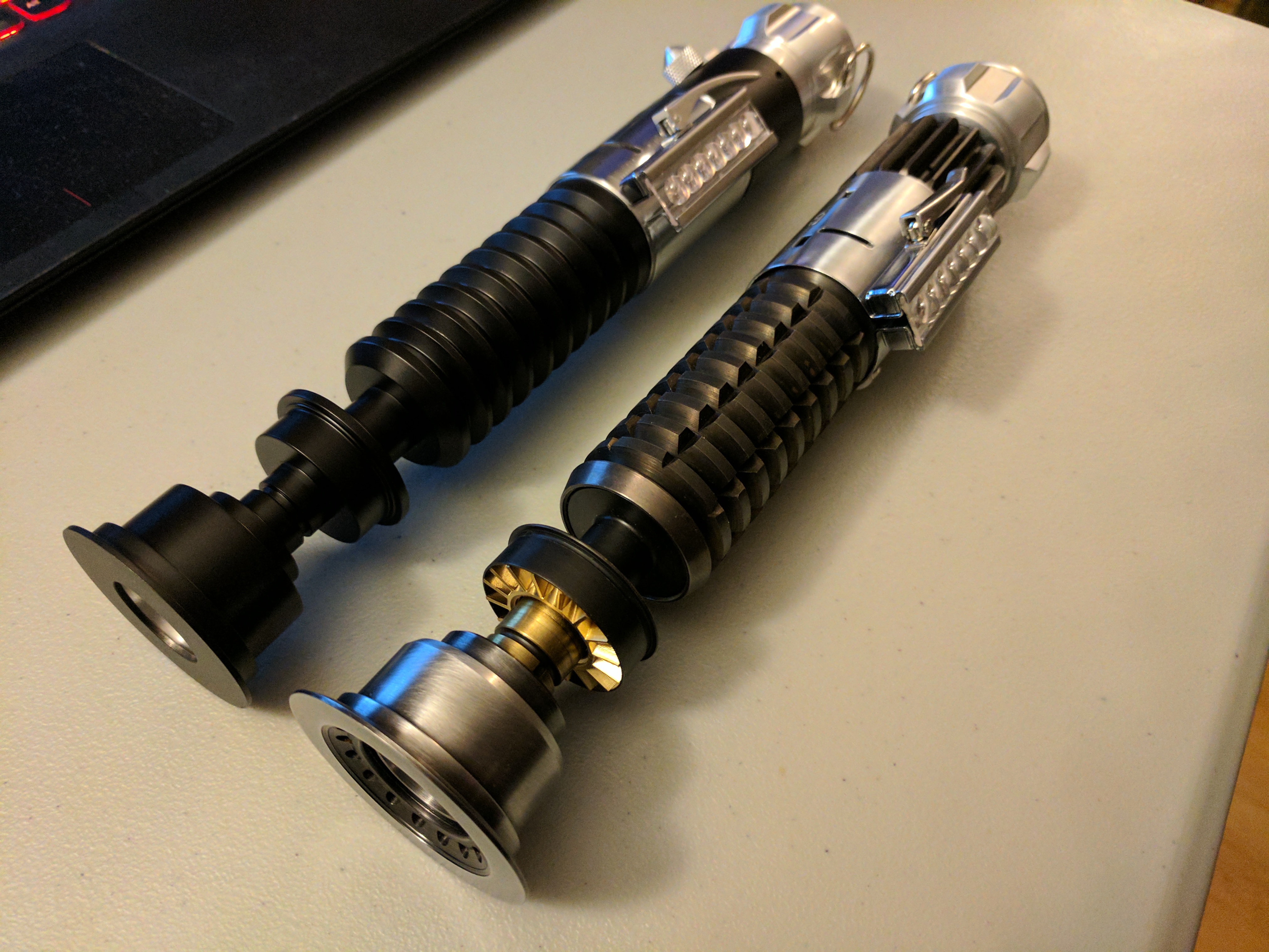

Weather it yourself for sure! I weathered my own K4 (plus I had my machinist pal make some alterations) and I think it turned out way better than a pre-weathered one. K4 on top, Roman's Empire on the bottom. https://uploads.tapatalk-cdn.com/20180511/4524b457d9fc60f1cf3e7df19903e7f7.jpg
Sent from my SM-J700P using Tapatalk
I'm still envious of your K4. I couldn't justify the price to get things modified. Oh well that money I saved will go to a MK 1:D
