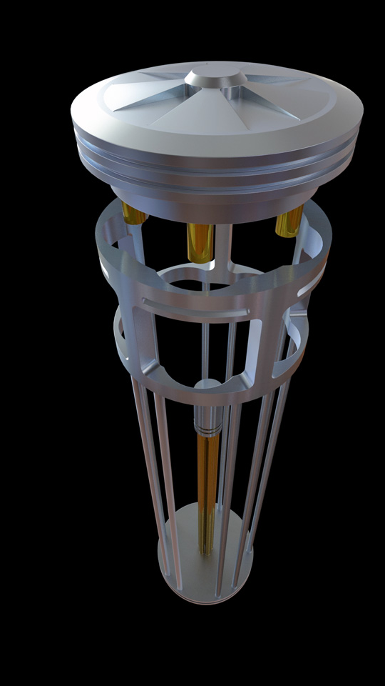

Here's a couple of renders of my CAD model.
Wow! Awesome work on the model Ramjet. A magnitude better than the janky TinkerCAD design I did for my build. I’m following your WOPR build thread. Looks like we have some similar taste in projects.
