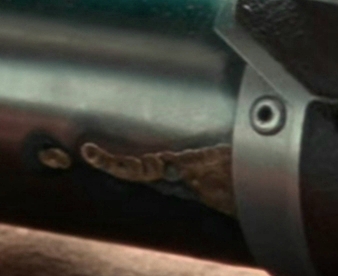

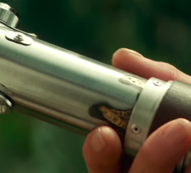

I don't know if this has been discussed or not, but I was looking at some high res shots from the movie. I noticed that, due to how the light is hitting the edge of the brass, it looks like the welding might have been sculpted on top of the Graflex instead of etched or melted.
Has anyone tried to add on with anything instead of using the dremel tool?
I am hoping to order a full kit from KR as soon as he makes more available, and I'm looking at how to create the effect.

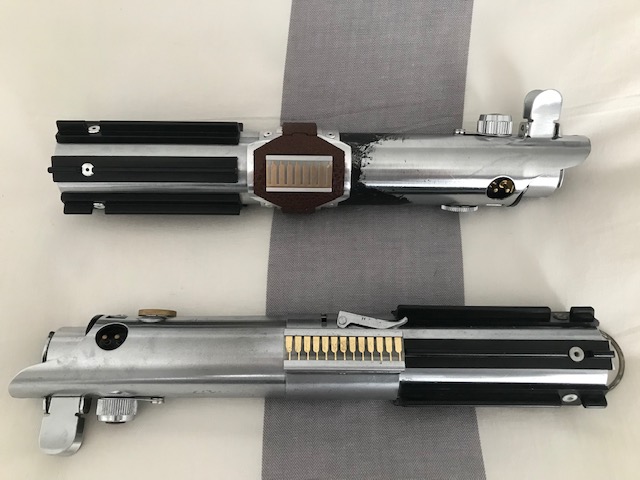

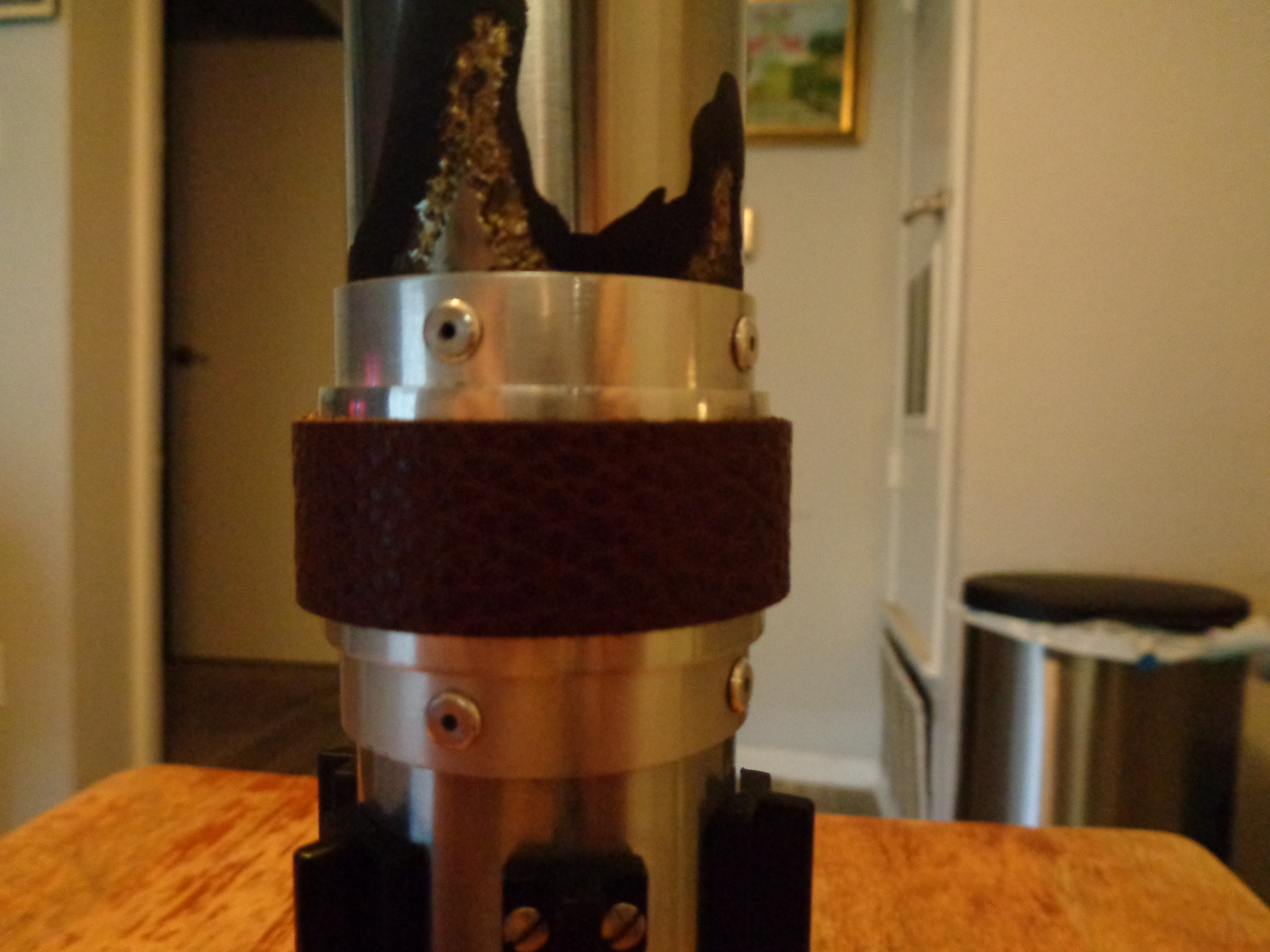

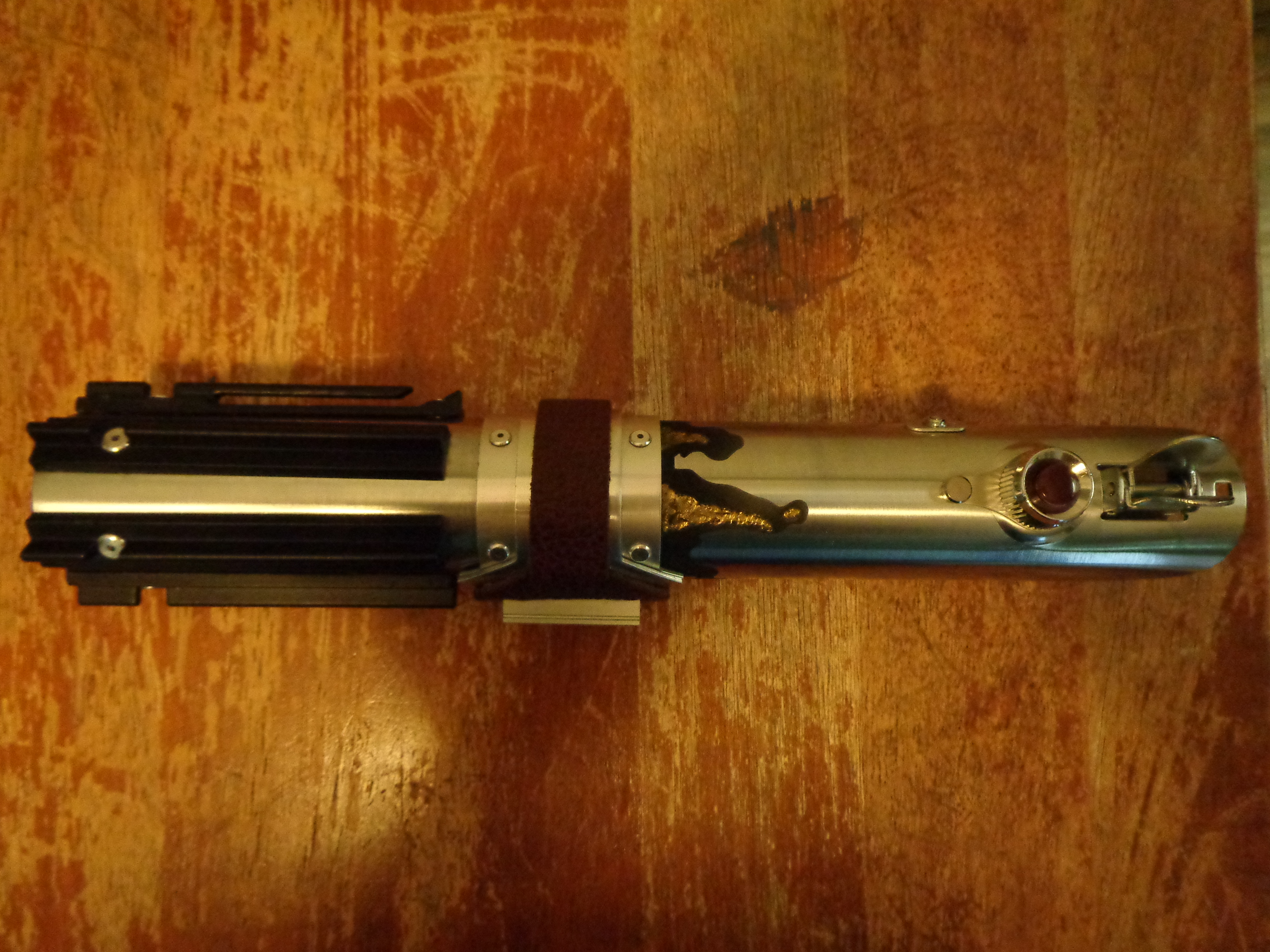

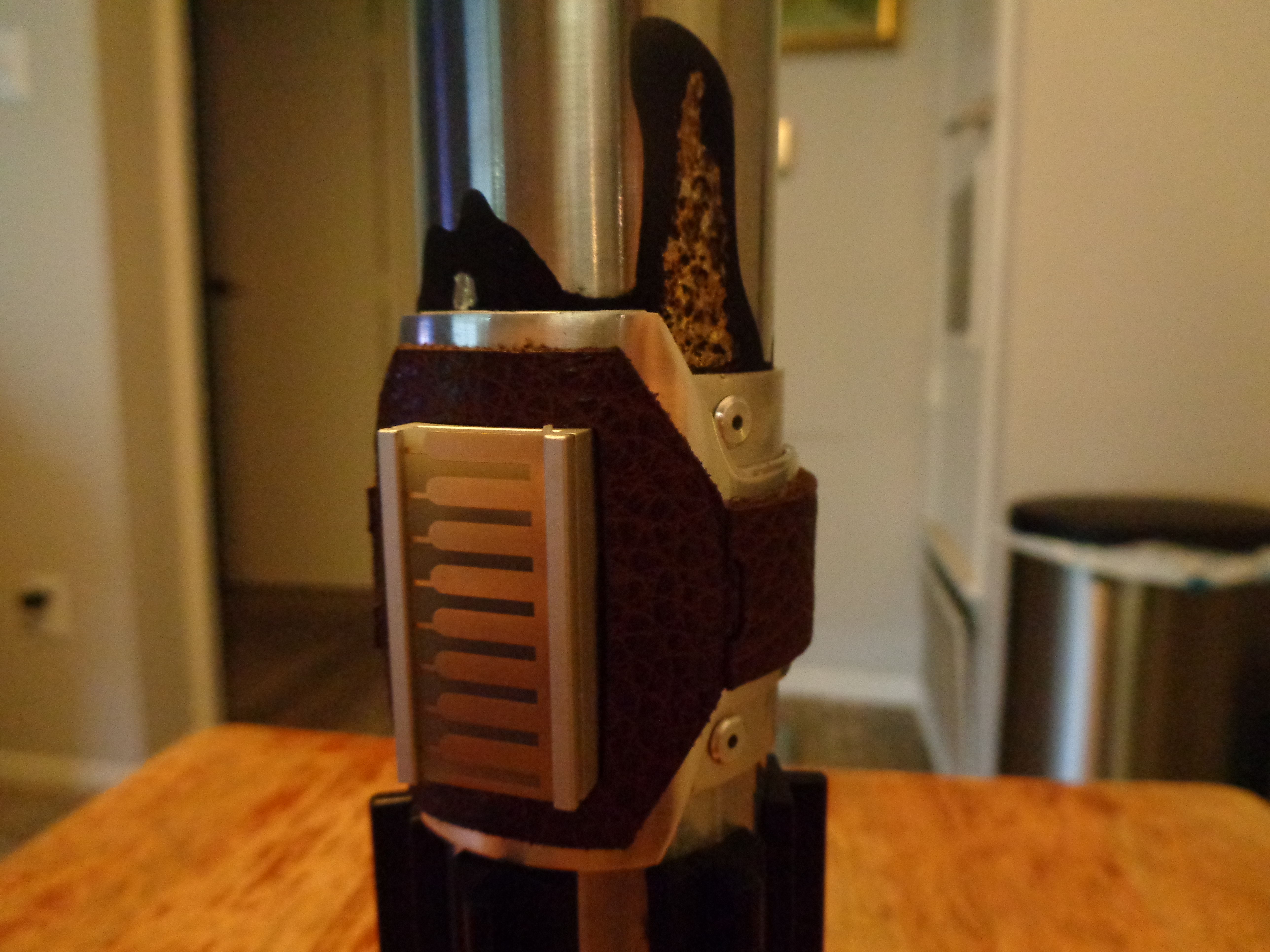

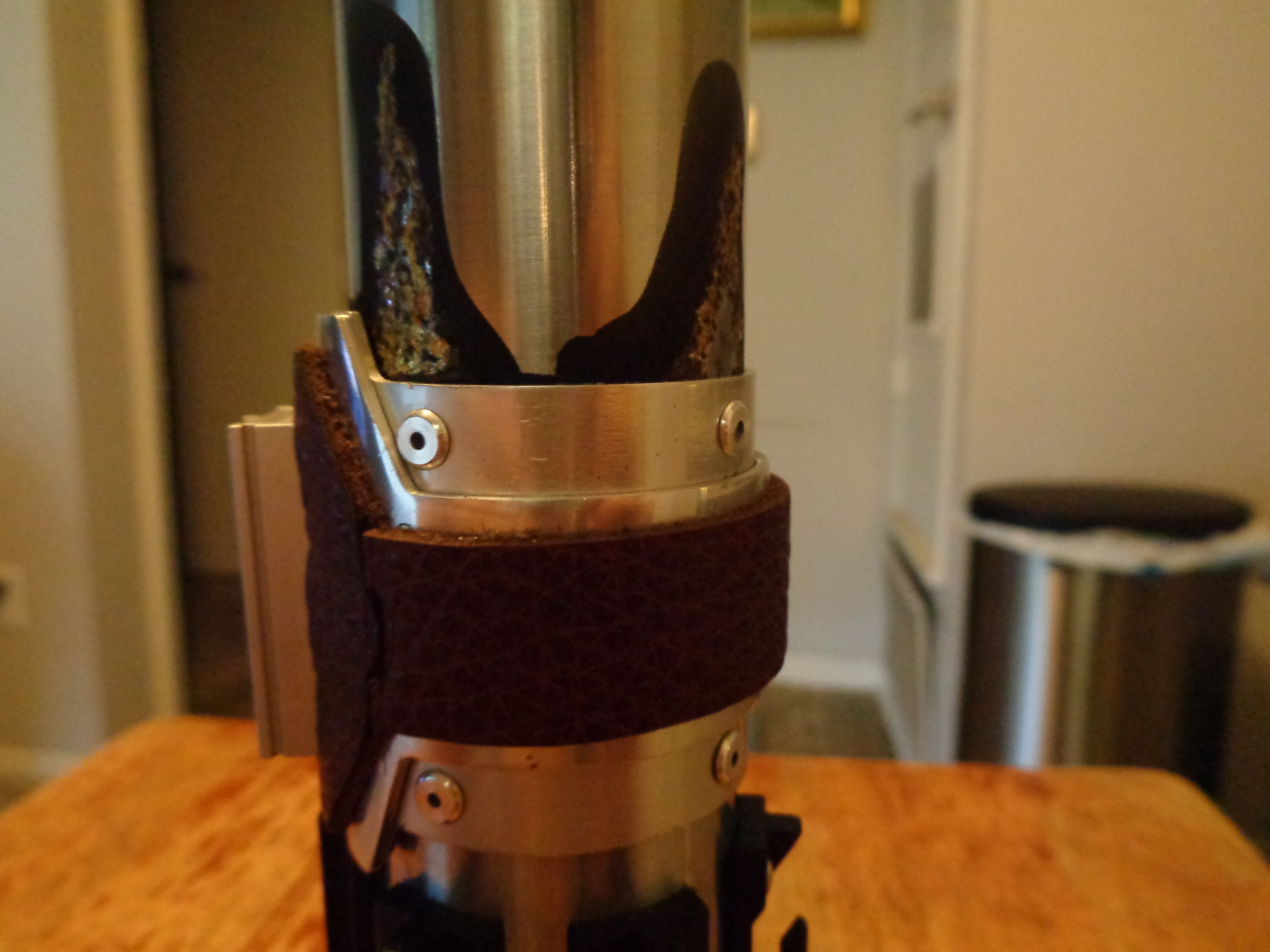

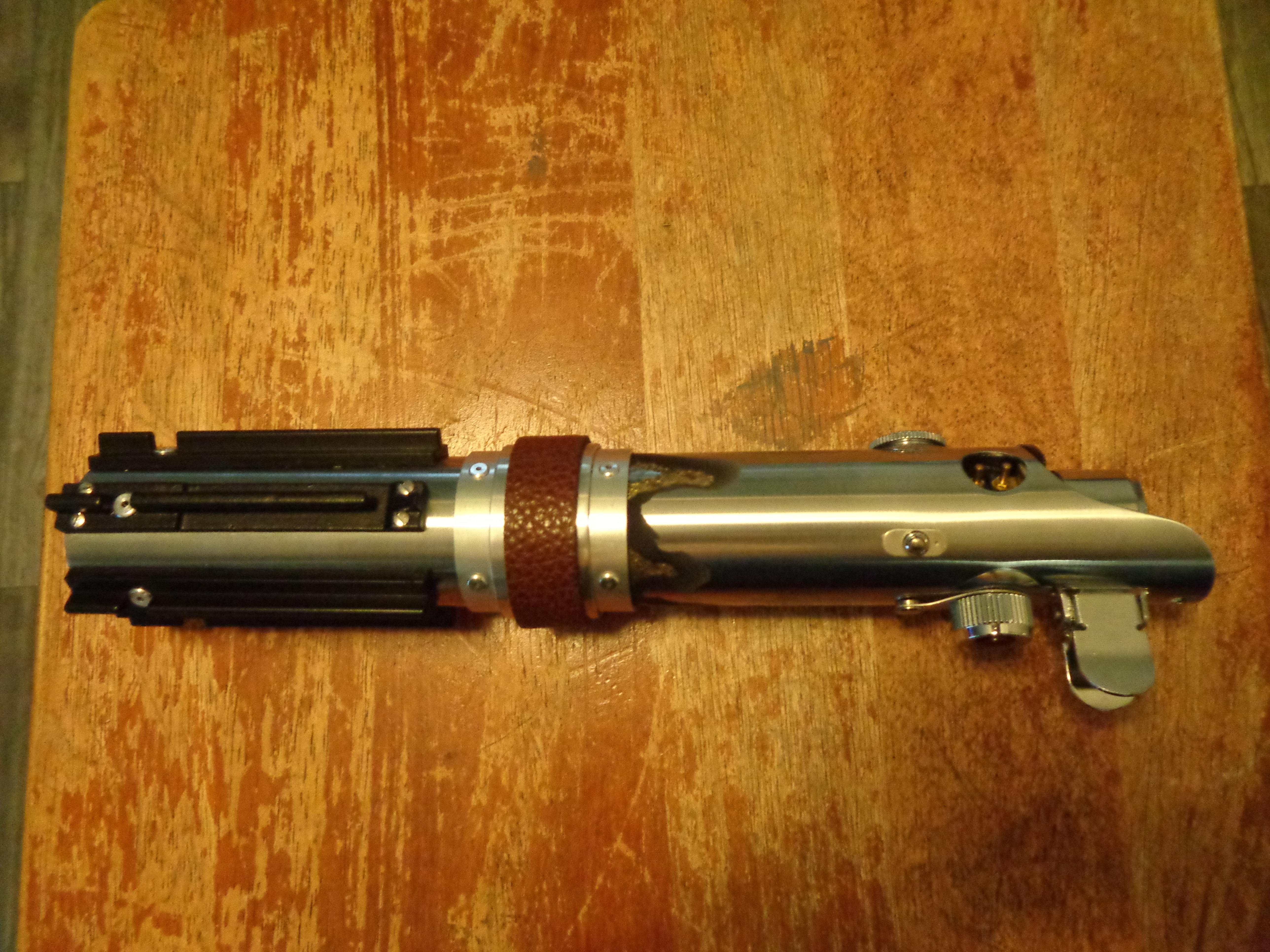

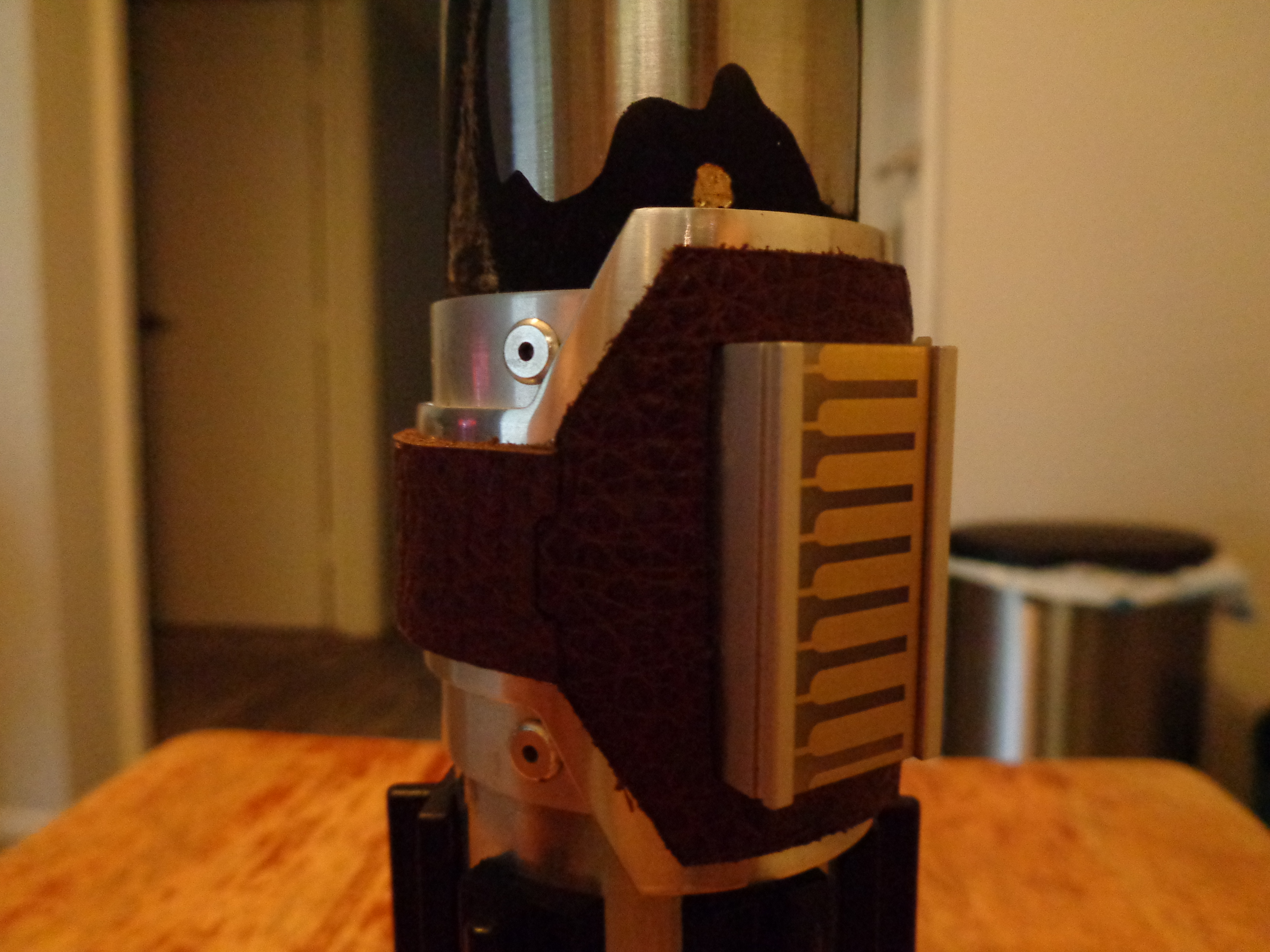

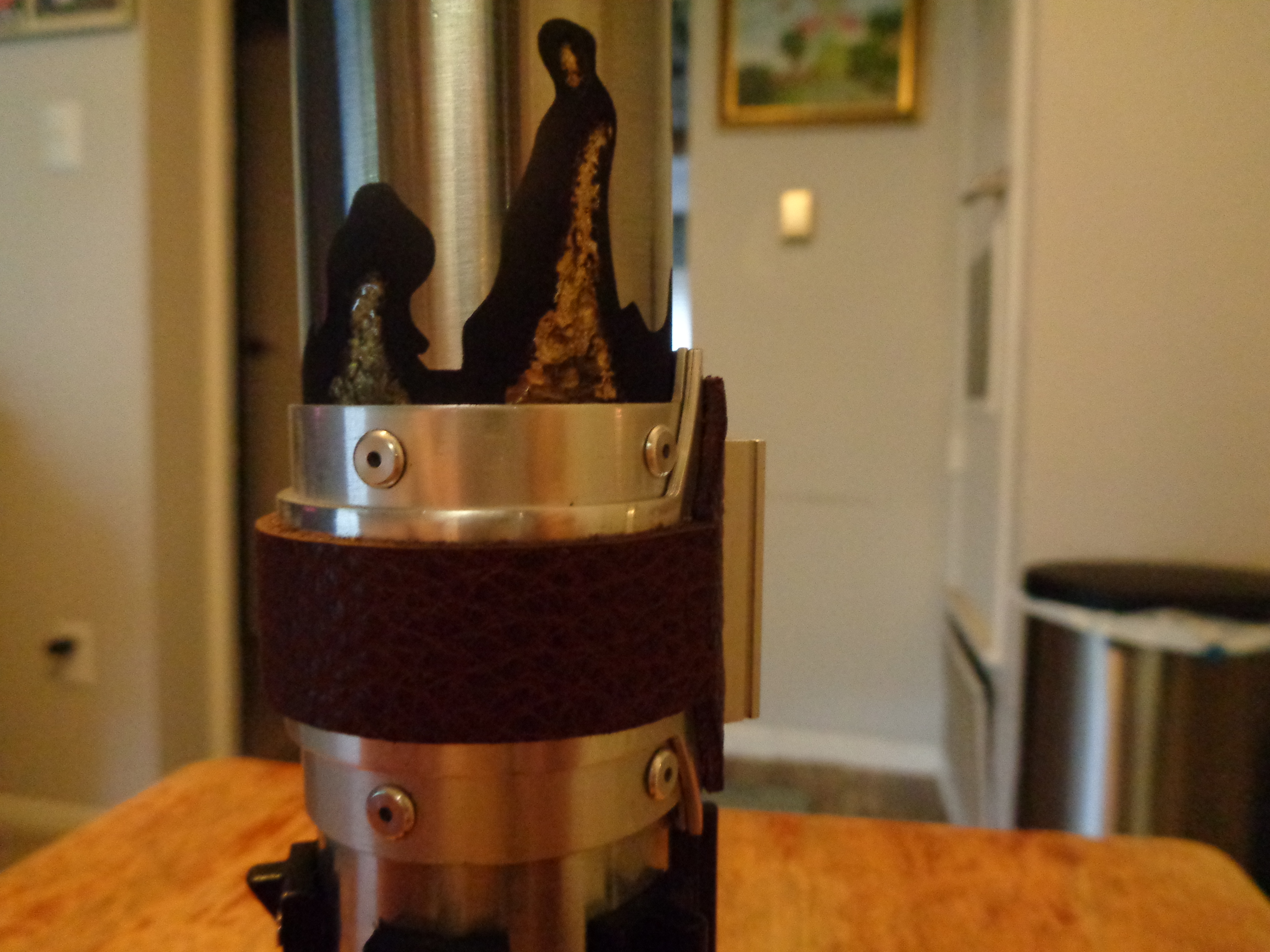

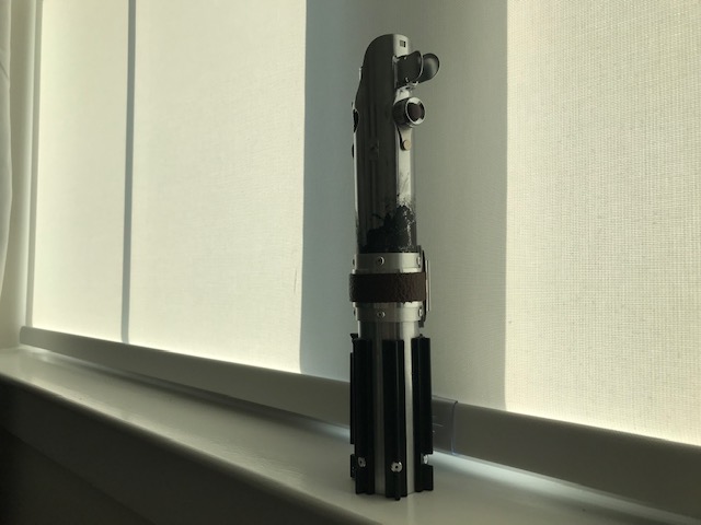

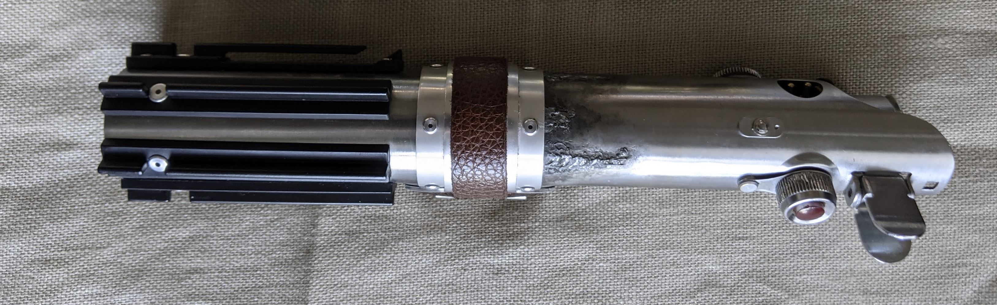

I had a cracked graflex top and it was in really bad shape, so I was going to throw it away after I salvage the bunny ears, etc. But then the movie came out and I decided to convert it ...
I don't have any welding tools and ultimately I just used solder to cover the cracks where they were, so of course it is not screen accurate. But I guess it still counts as " add anything instead of dremel " :) - so here are a couple of pictures:

I agree that it looks like they may have applied something to give it a more raised surface, I think the reason everyone uses a Dremel is that since the prop looks to have the copper exposed it is simpler to grind into the flash gun until you reach copper. With a little creativity you can get it to look pretty close.
However, I have no idea how they achieved that look on the prop. There are various things you could apply, like E6000 but it would be messy and you still need to figure out how to paint it.
I actually think that looks pretty awesome. I don’t know much about soldering. I wonder if there is a copper color your could solder with?
Whoa! That's really cool looking! I might be tempted to do something along those lines. Maybe brush paint the brass...
Yes, you can get brass solder wire, but they generally require a torch to melt, simple soldering gun does not go hot enough to melt it.
v312
I tried to paint the seams with some decent brass/gold paint and it probably was ok if you just see it on a picture, but when I had it in my hands it felt kind of too fake so I removed it. I'm not particularly skilled with these things, so I'm sure someone can do a more convincing job.
Collectorchris
I dont think it is TIG welded. They may have heated up some brass braising rods and laid small puddles, the ground it down a bit. I guess with some time and patients, you could mix some brass cold cast powder in with epoxy and achieve a similar result perhaps???
ID10T
You may be correct, but to me, it looks like low power TIG- just enough to make a small pool with a fine electrode. "stacking dimes"
No filler wire.
I have done TIG like that on a thin sheetmetal box with very tight seams. Just melt the two pieces together (almost like gas welding). Replace the "crack" with a weld pool. It is not the strongest weld with TIG but it works for thin stuff like that.

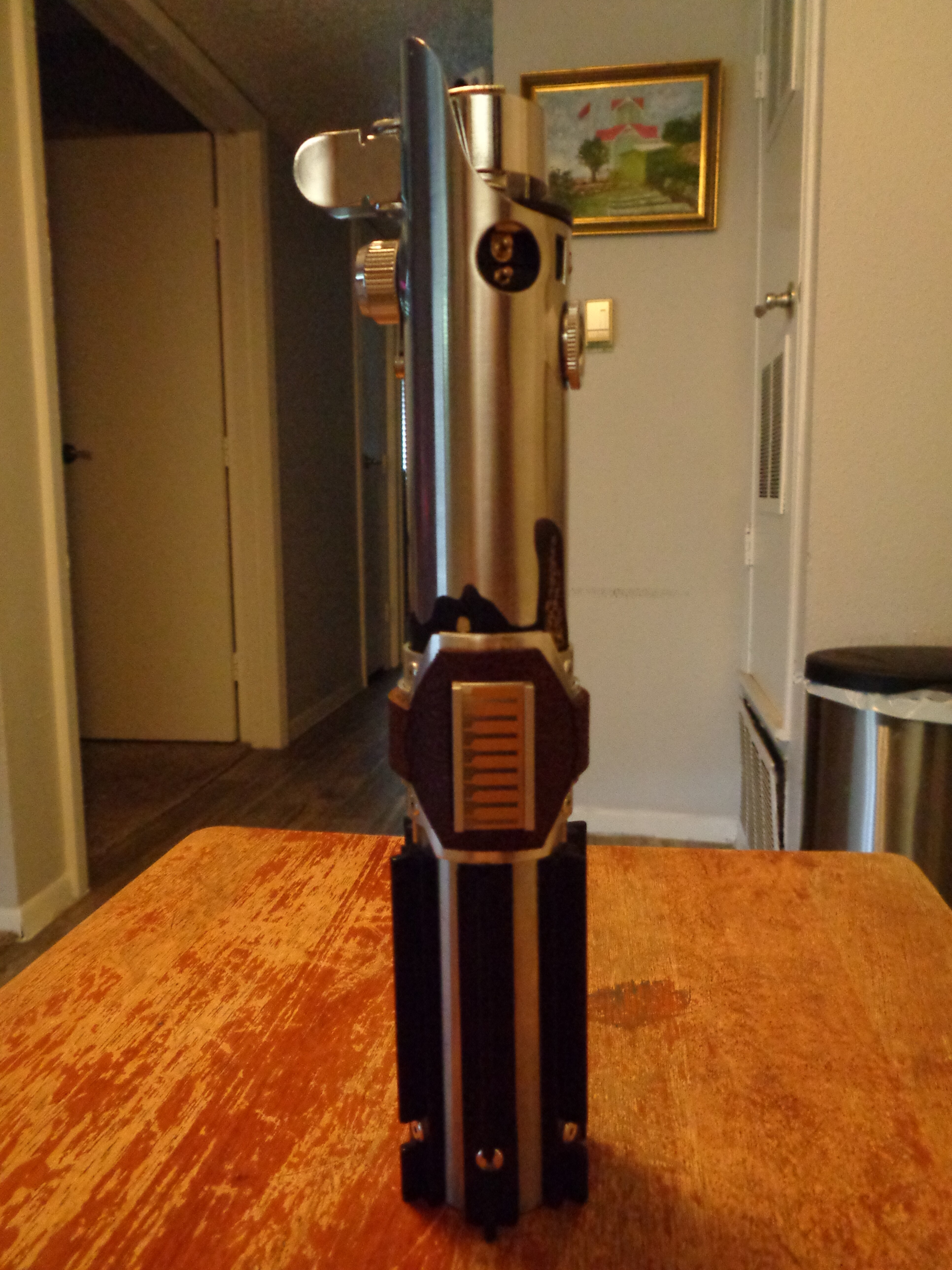

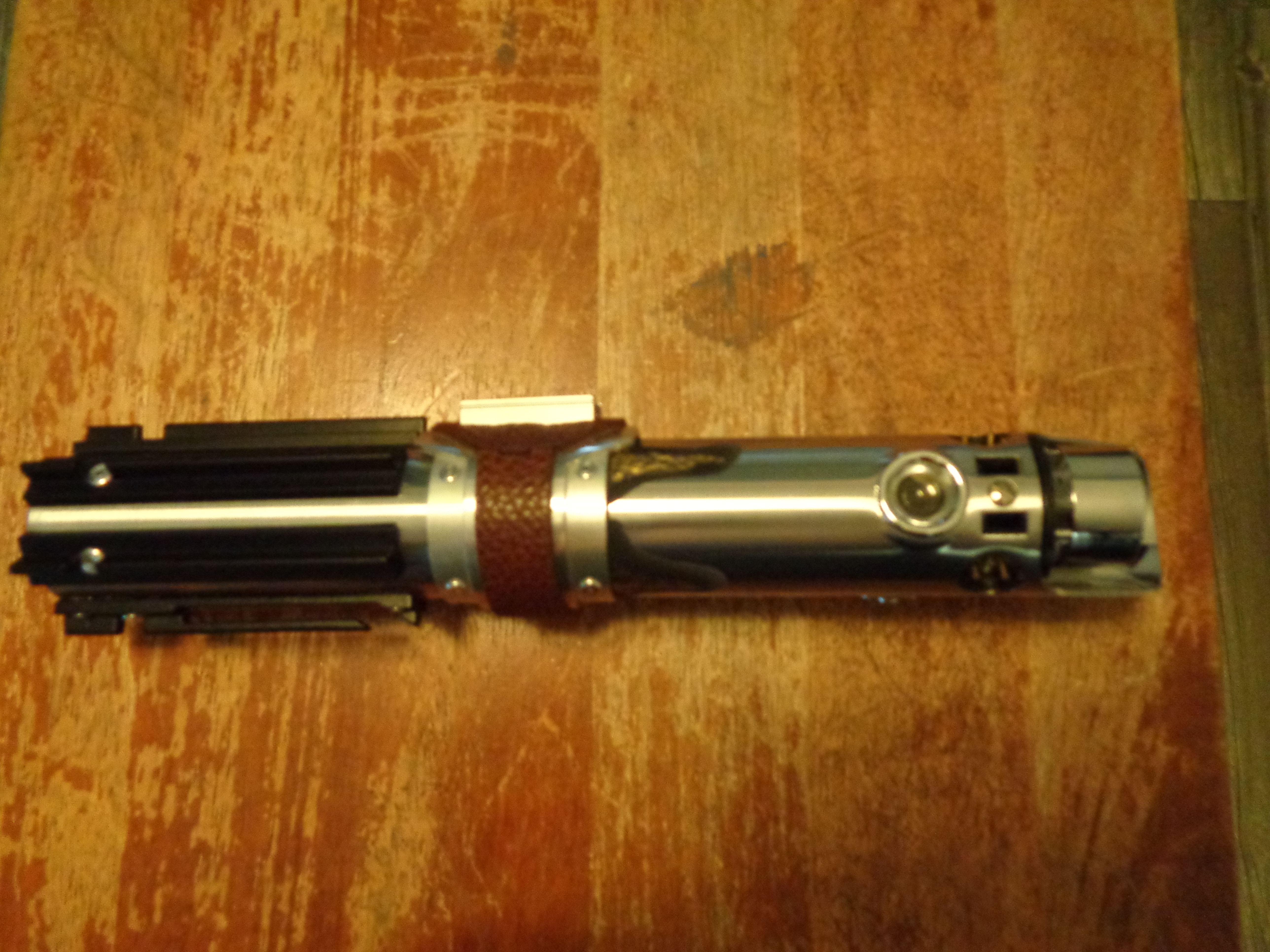

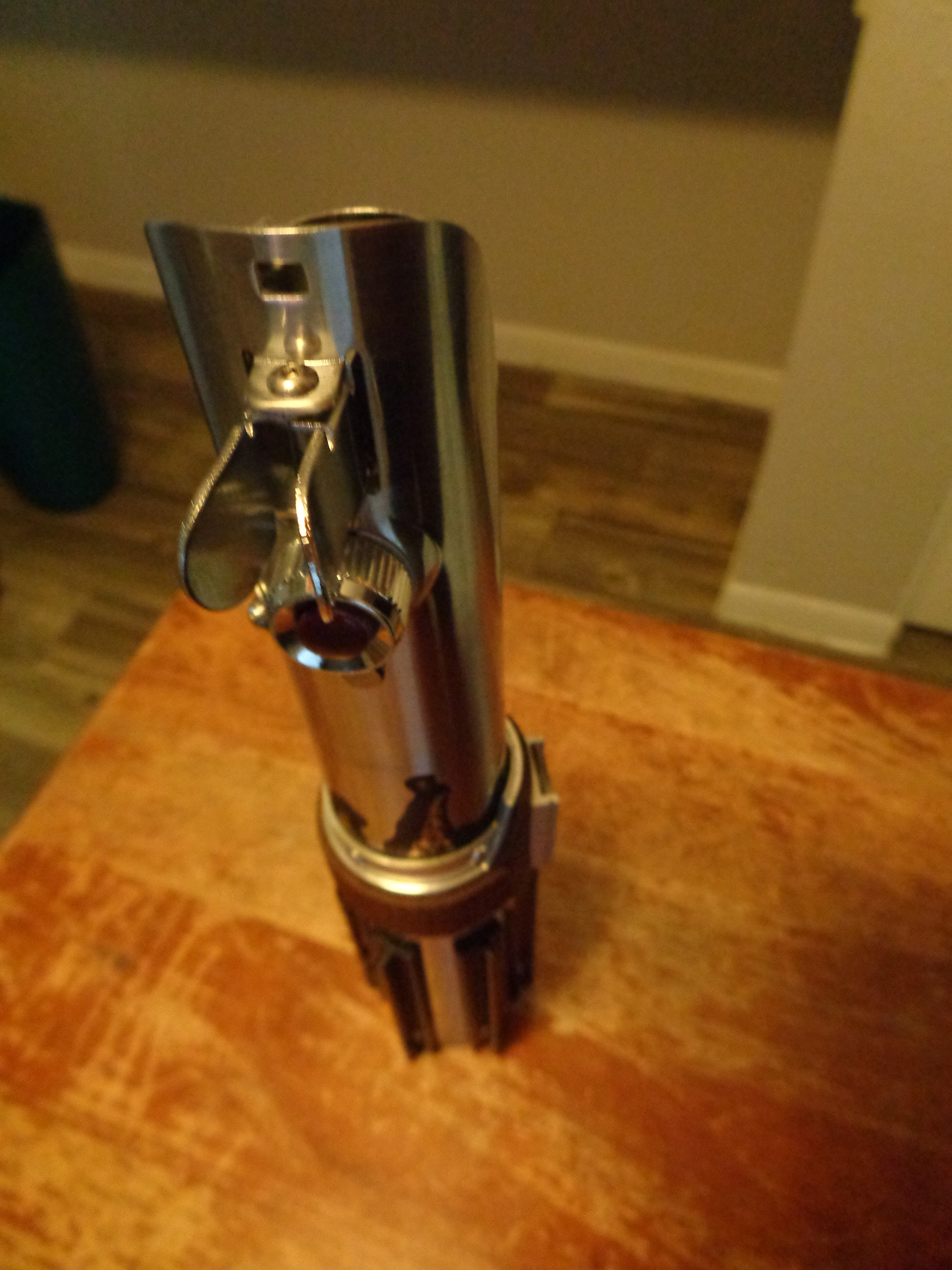

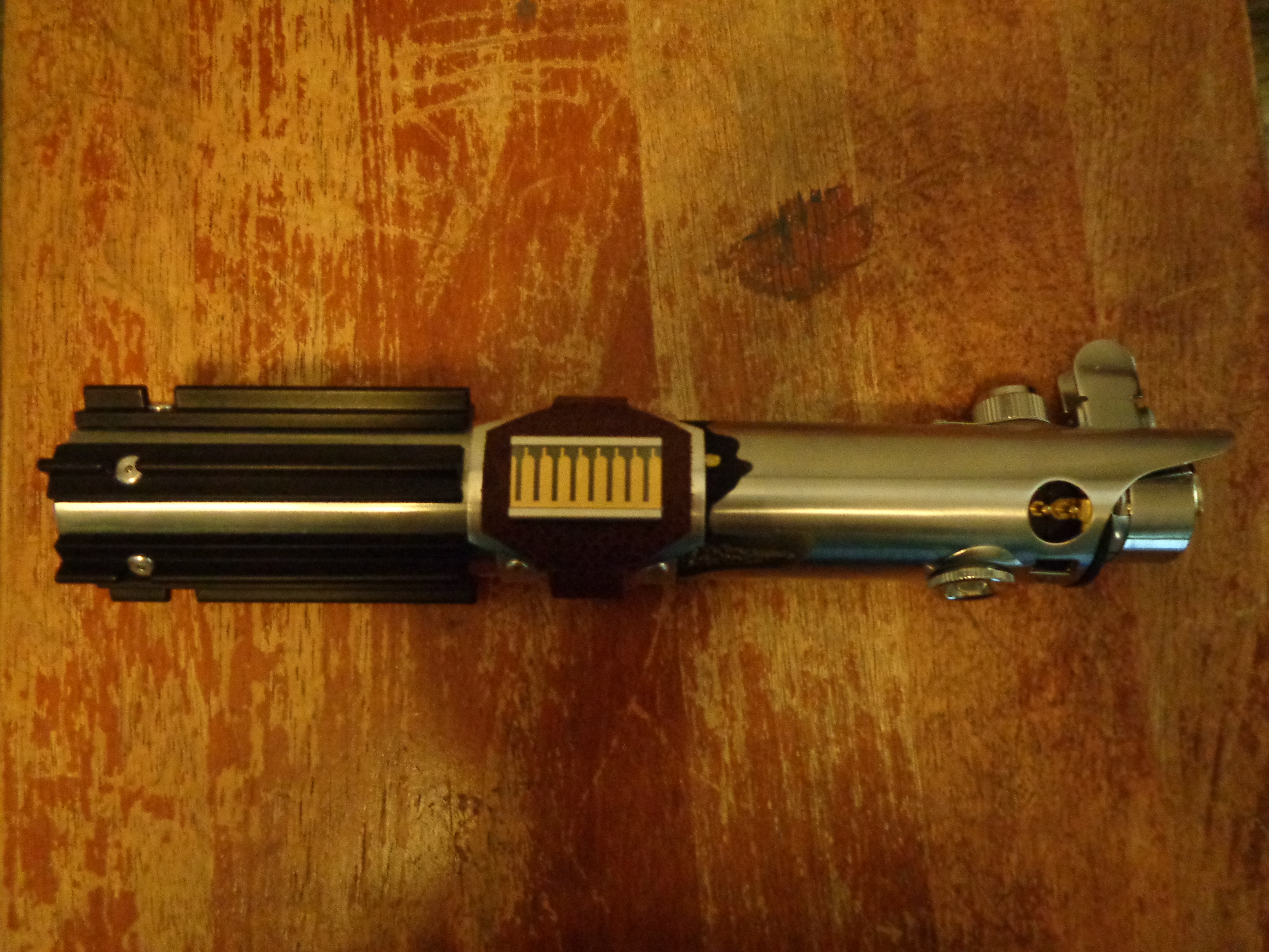

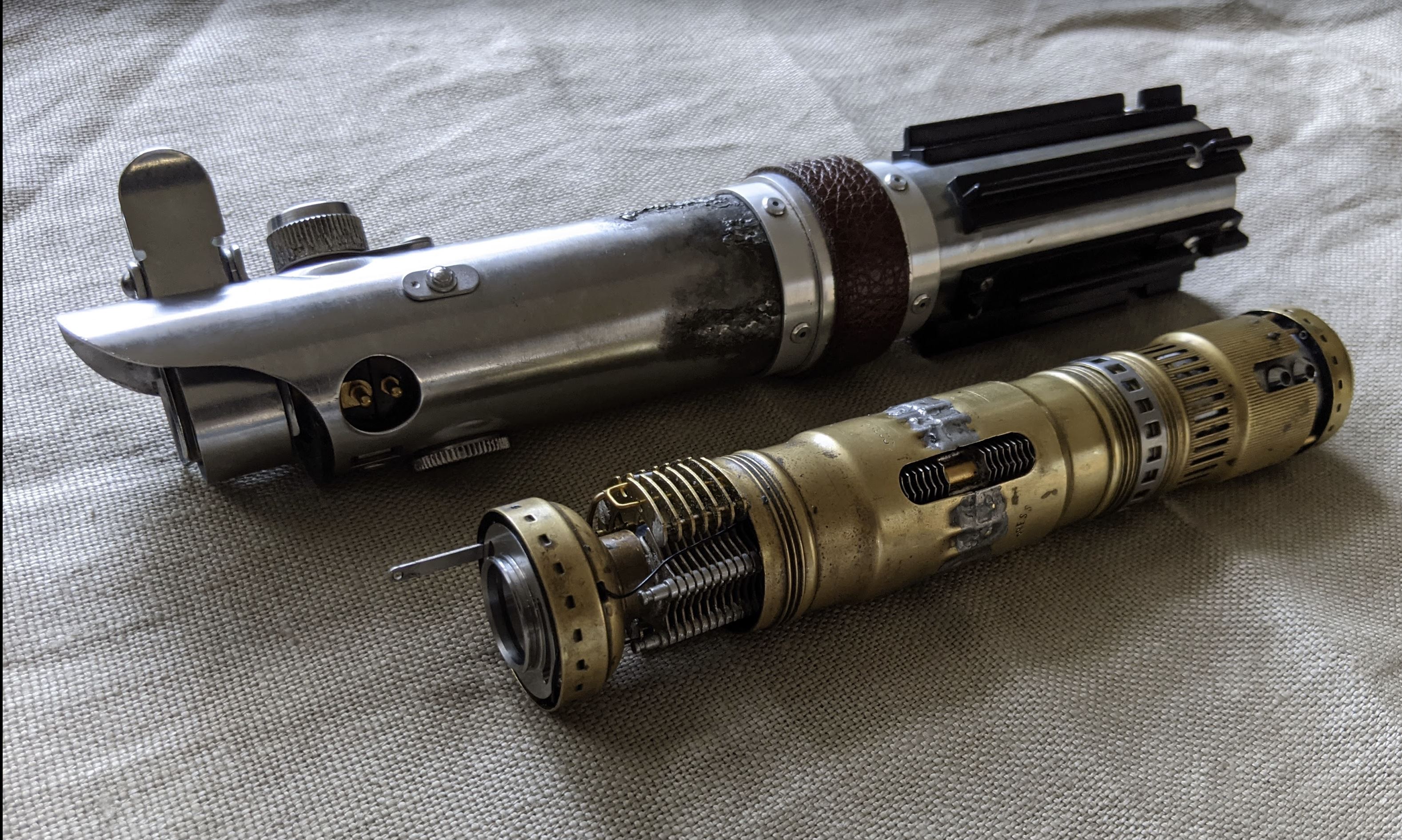

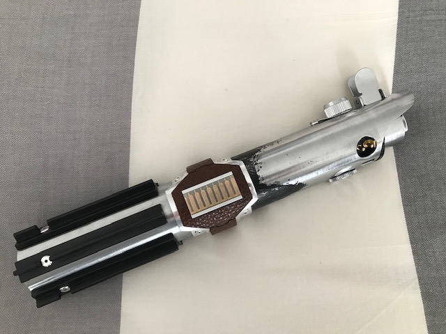

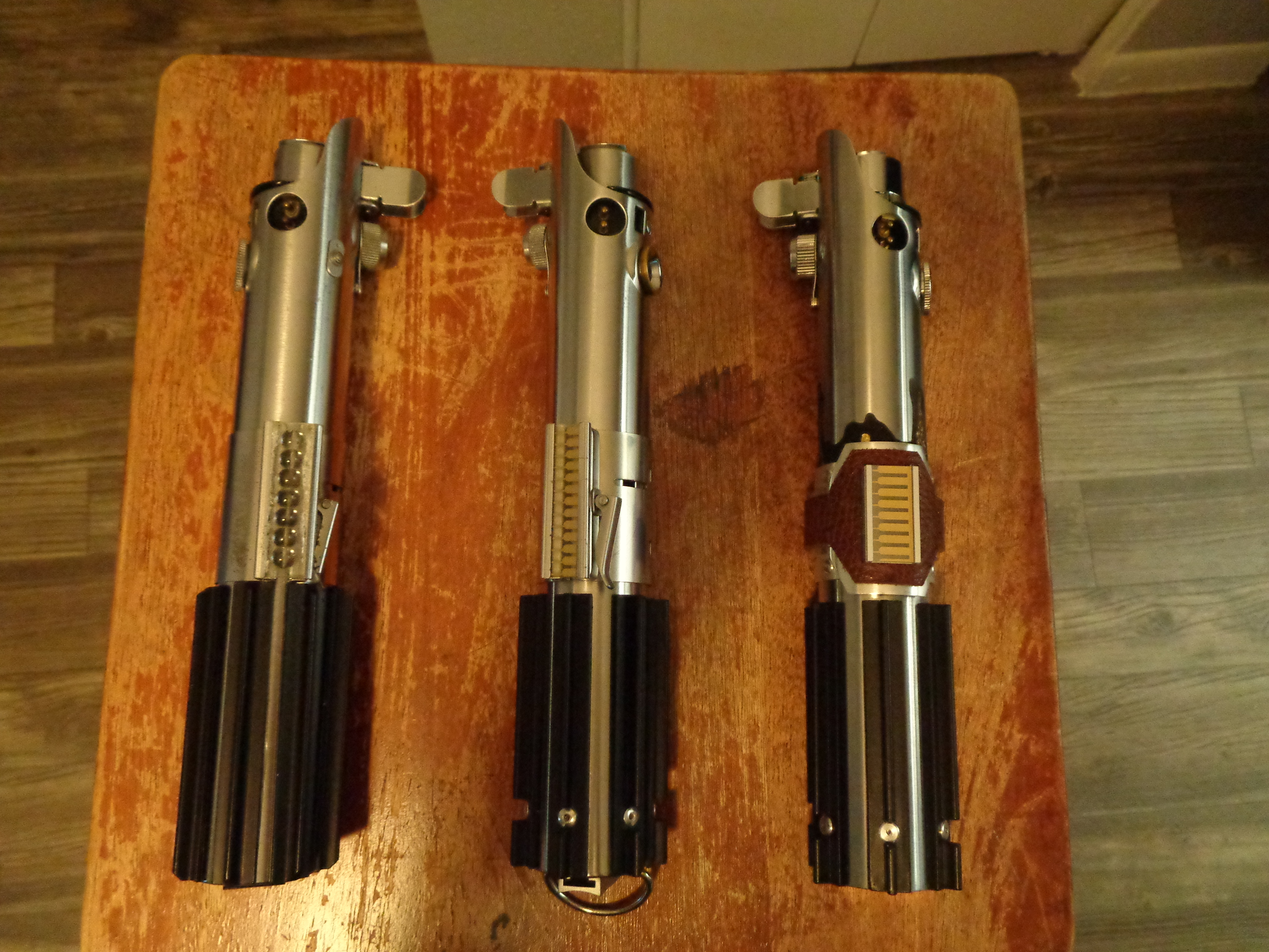

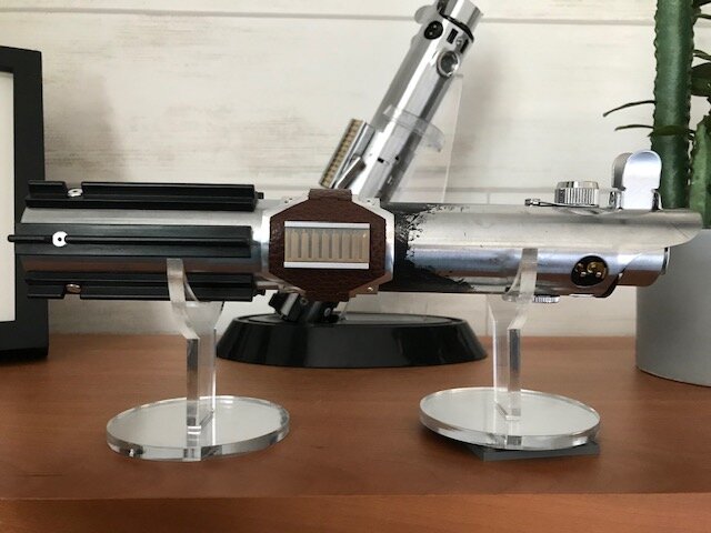

Here is mine. Made from a Roman's Gen2 Graflex and Khal's conversion kit. So about as accurate as you can get. Halliwax was kind enough to do the conversion and it looks outstanding! I will let him chime in if he wants on how he did it (I made some goofs he corrected). I am super happy with it. It is a static piece, not going to FX it.
DSC06127.JPG DSC06128.JPG DSC06129.JPG DSC06130.JPG DSC06131.JPG DSC06132.JPG DSC06134.JPG DSC06135.JPG DSC06137.JPG DSC06138.JPG DSC06139.JPG DSC06140.JPG
