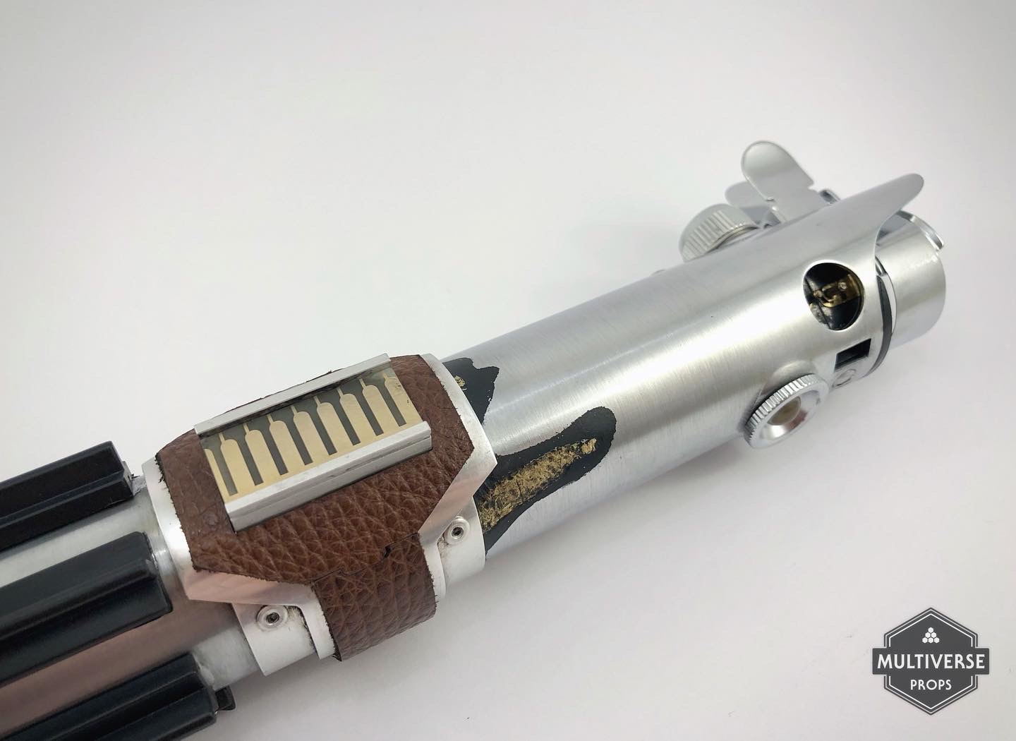

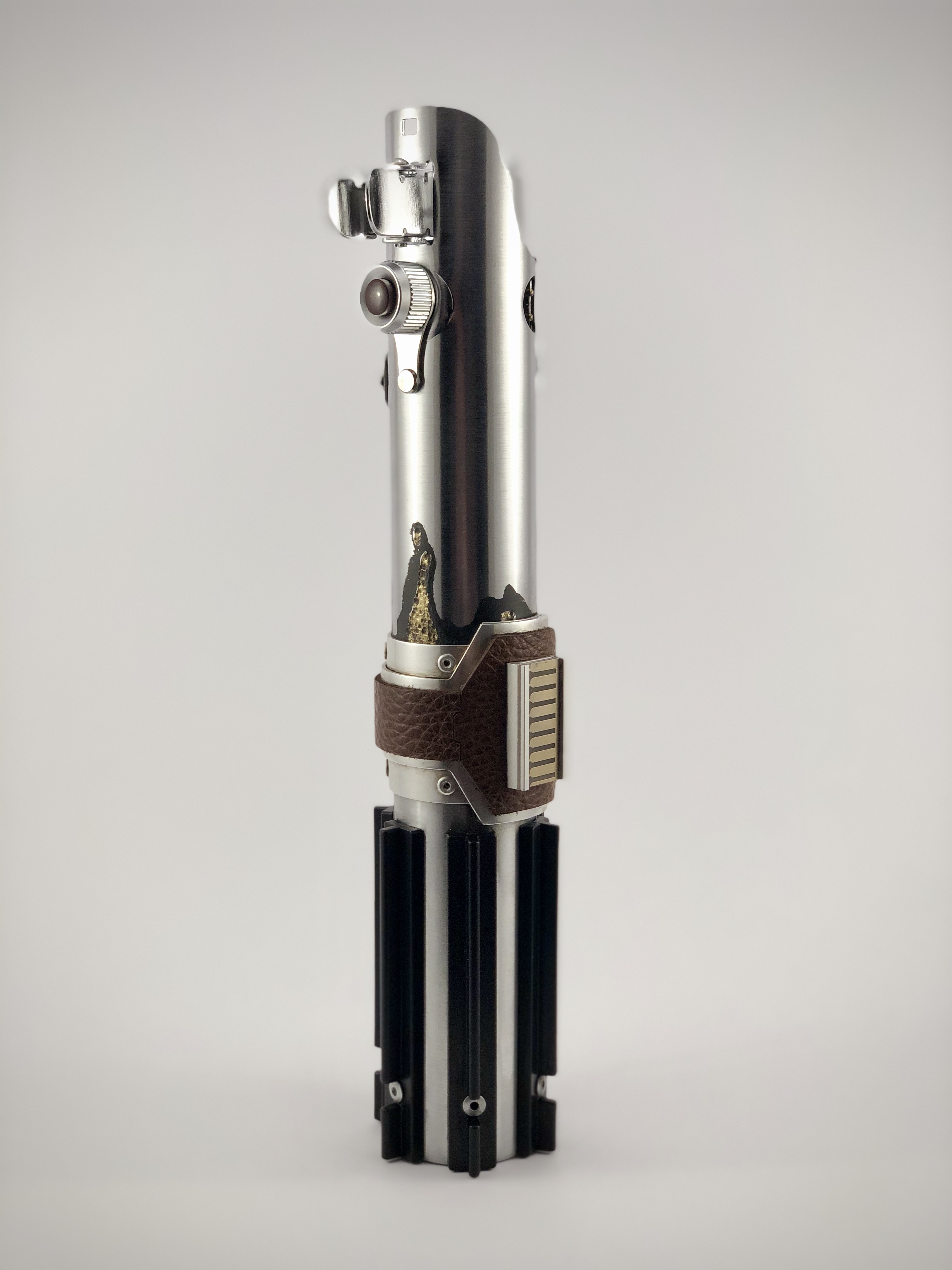

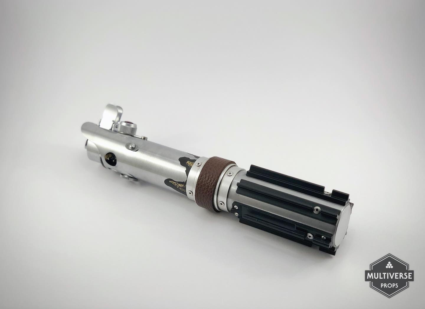

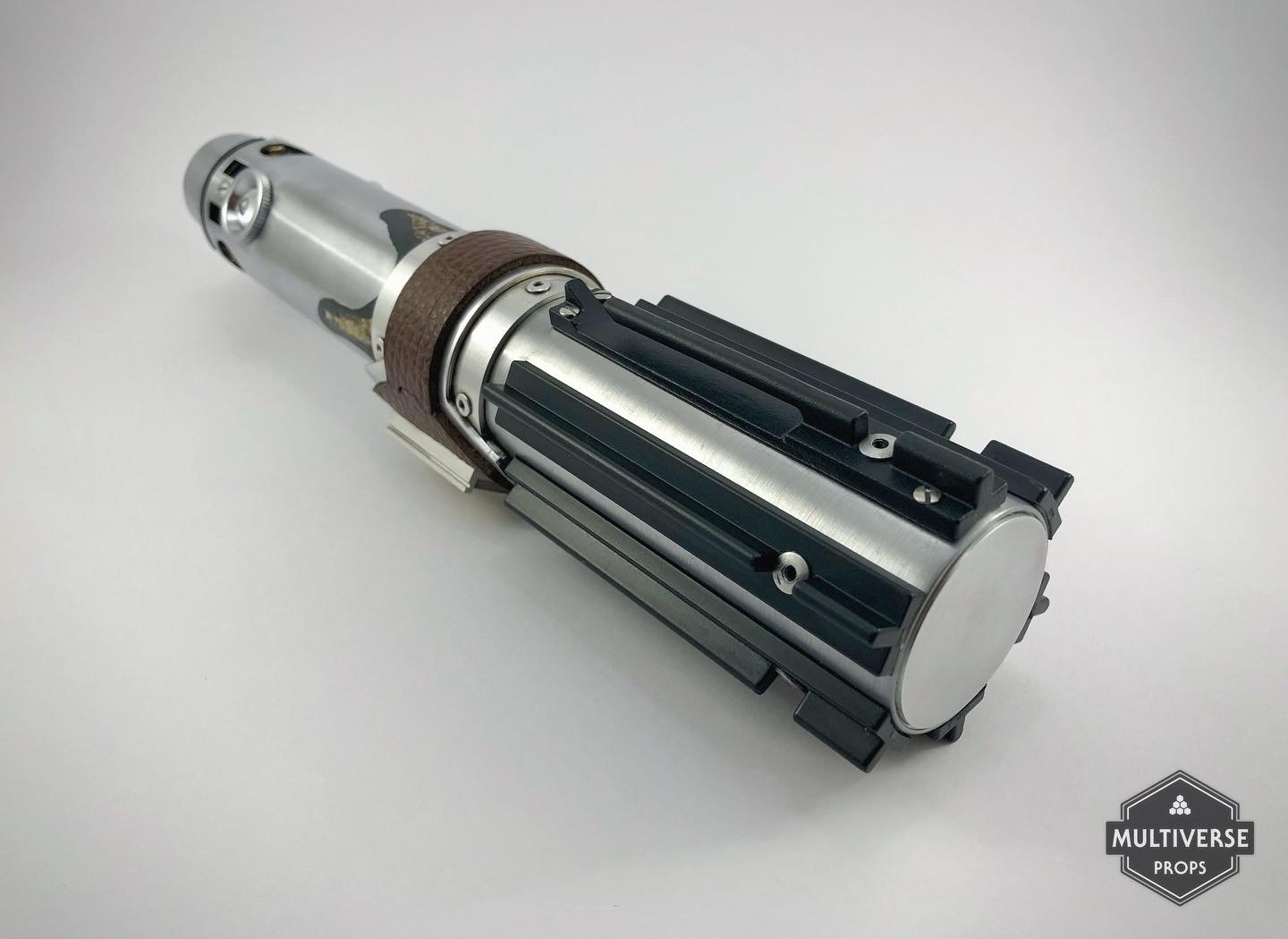

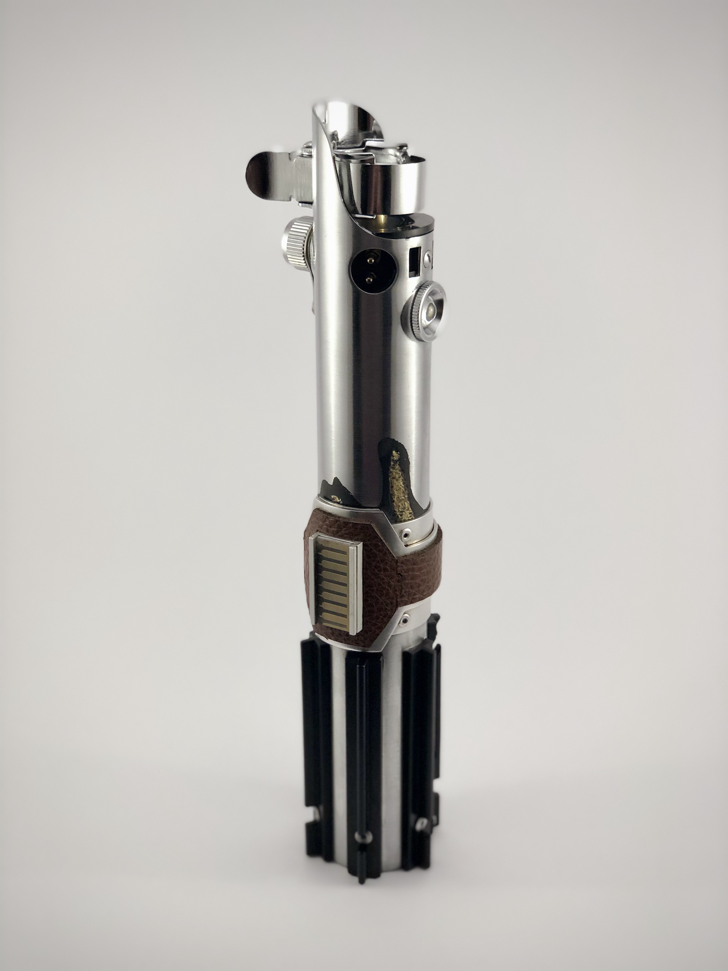

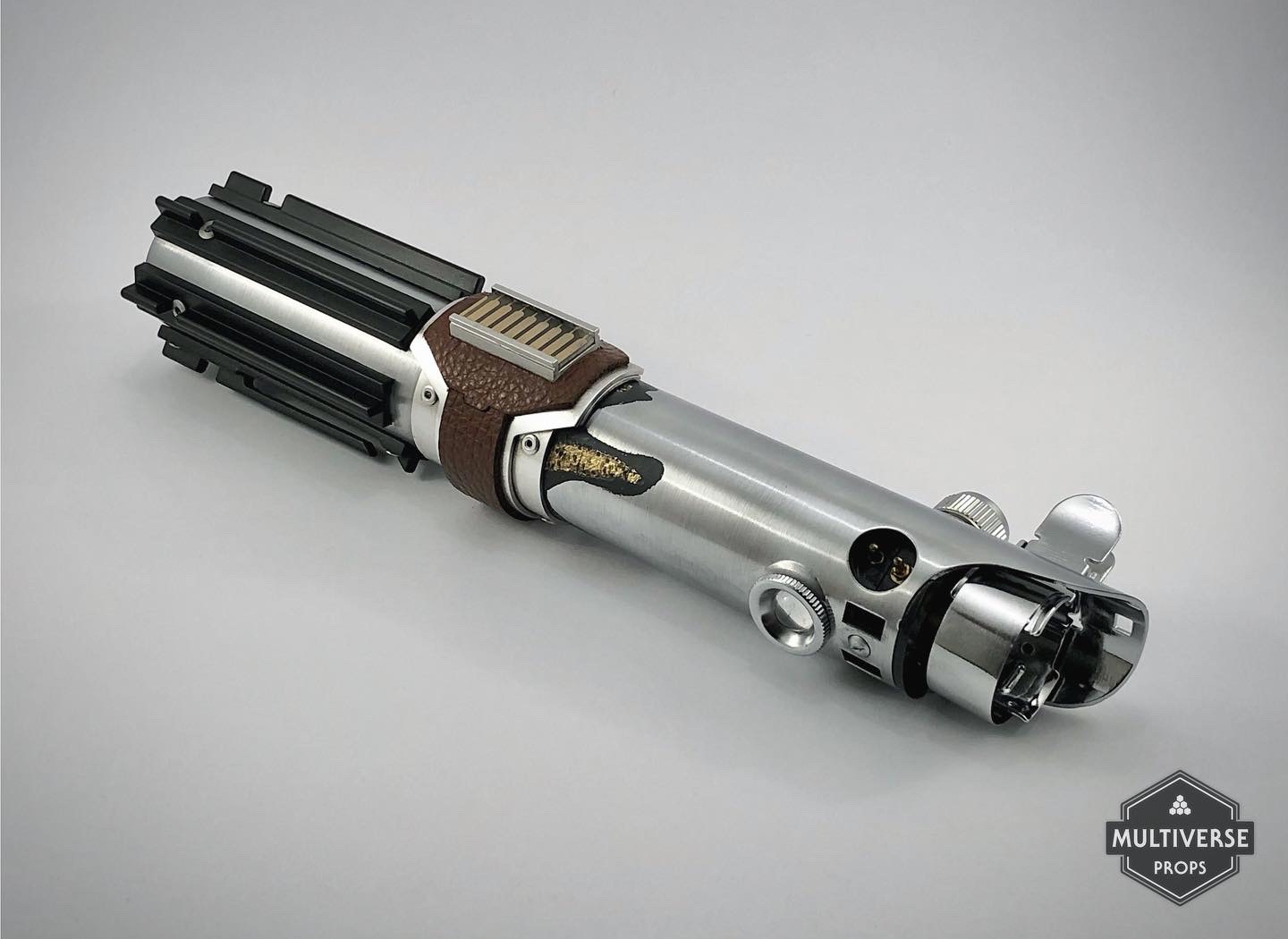

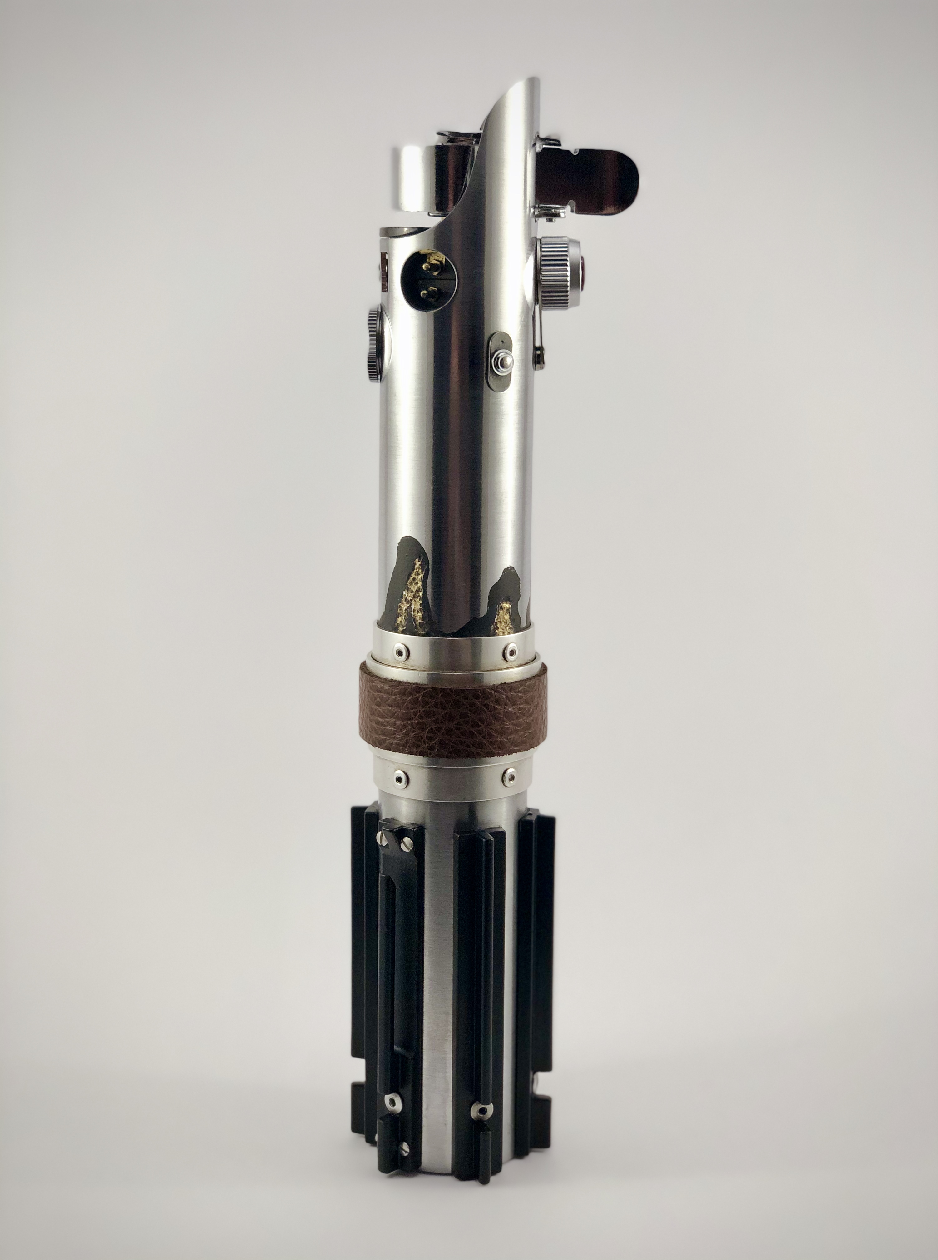

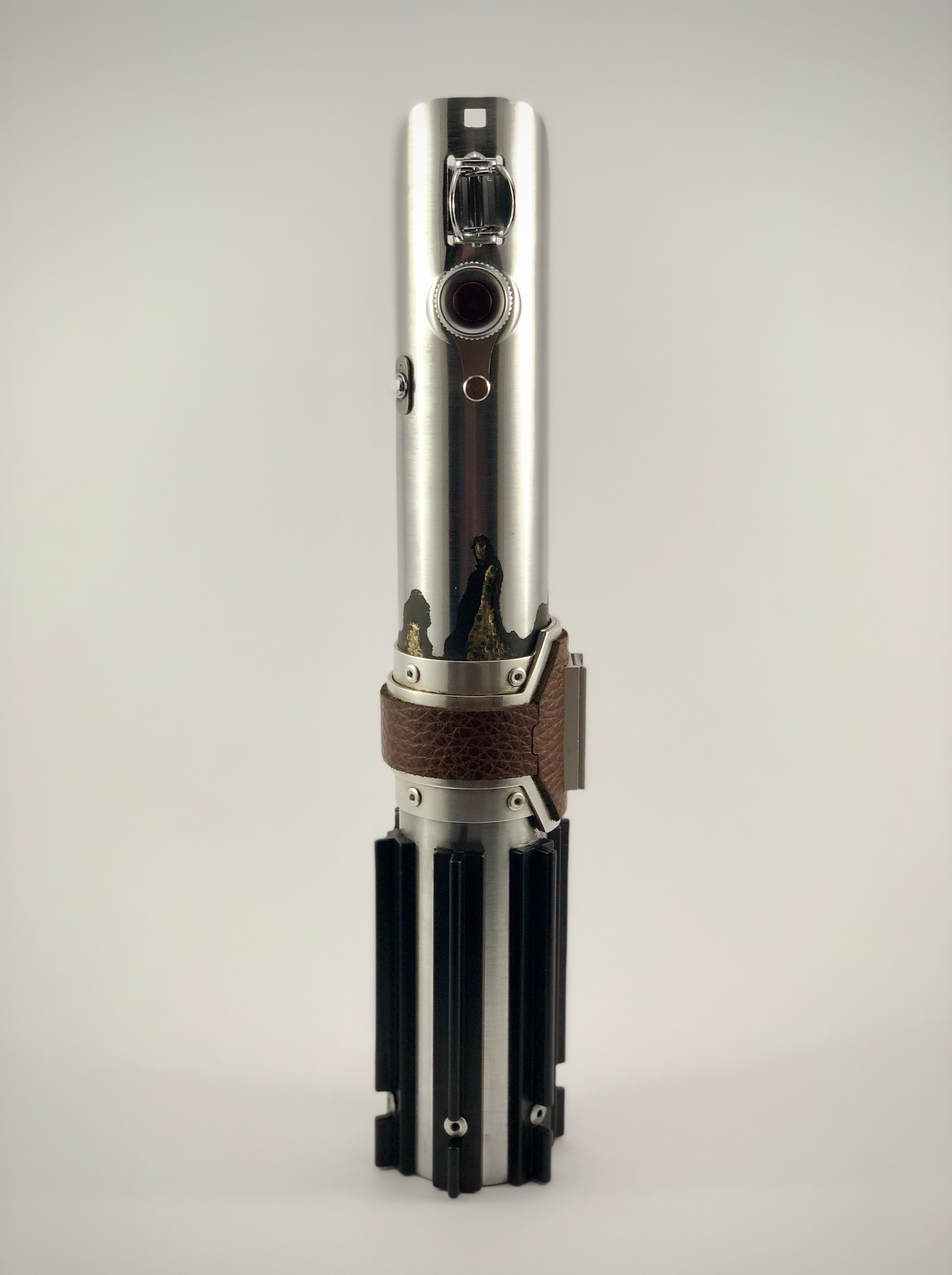

Just about finished up my KR kit! Think I want to fade the scorch marks a little more, but other than that it’s done!

Amazing work!

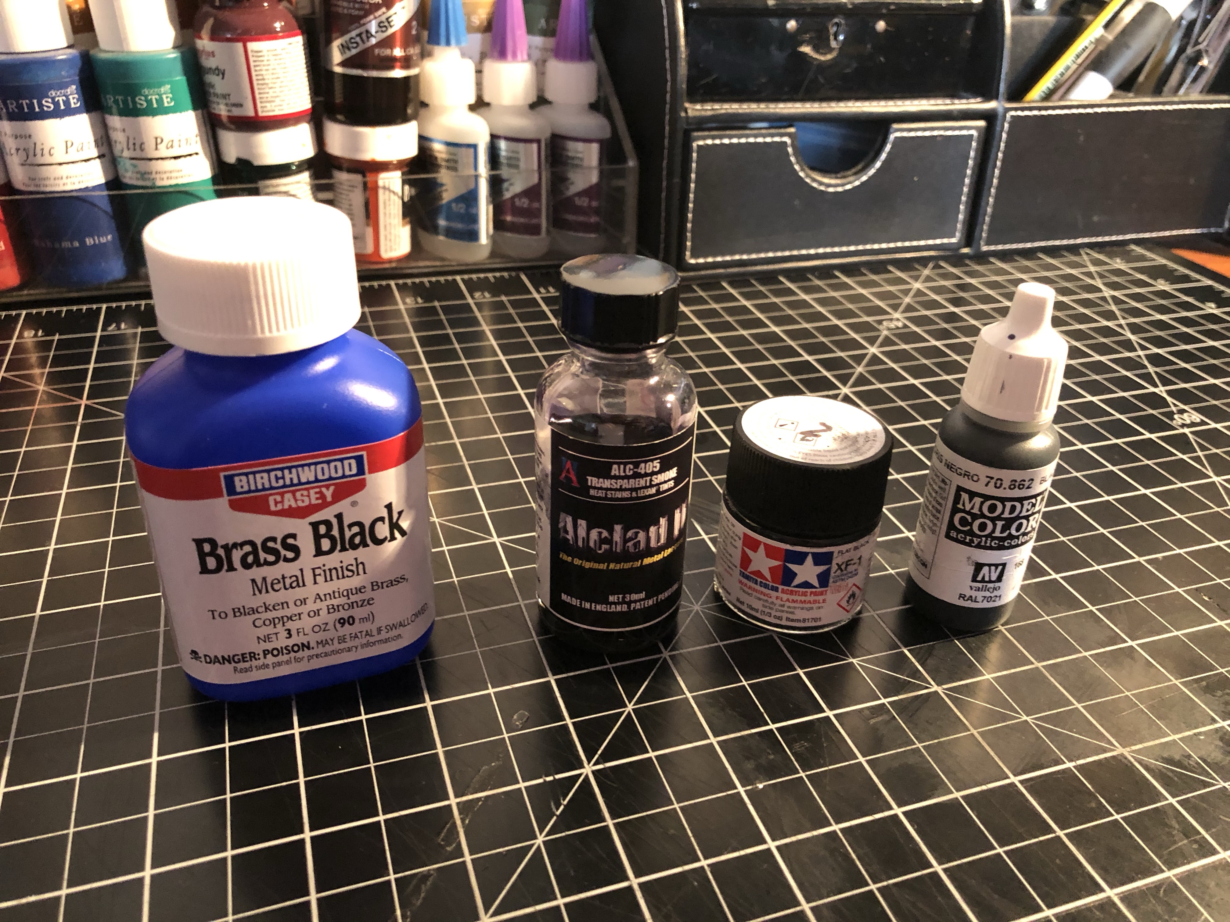

What method did you use for the scorch effect?
Thank you! For the welds I used a dremel tool to expose the brass, which I then darkened with Brass Black, then for the scorching around it I used a mix of airbrush paints, layered until I got the desired look.
Very cool! The weld effect with dremel comes very close to the real prop.
