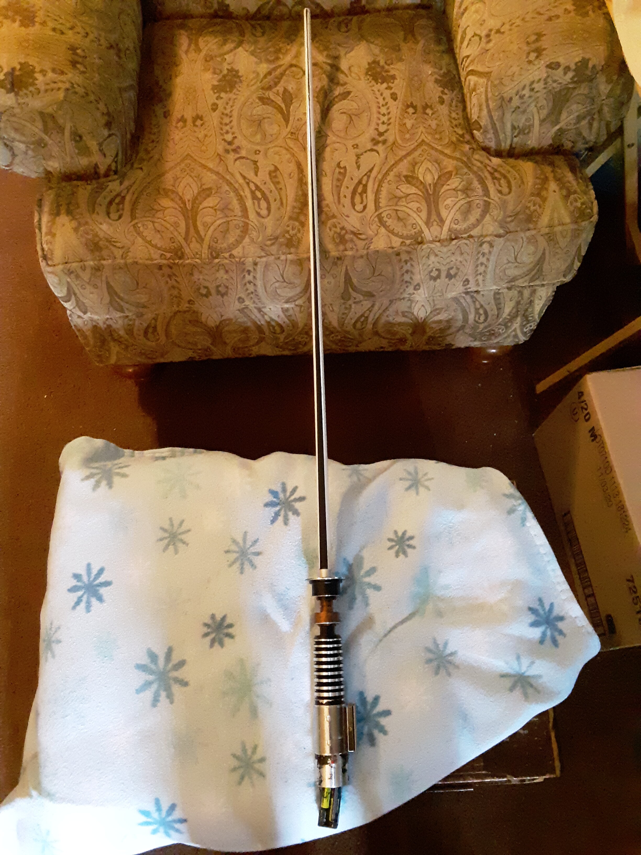

My android tracfone does better with the flash on but, understandably, i couldnt use the flash to display this

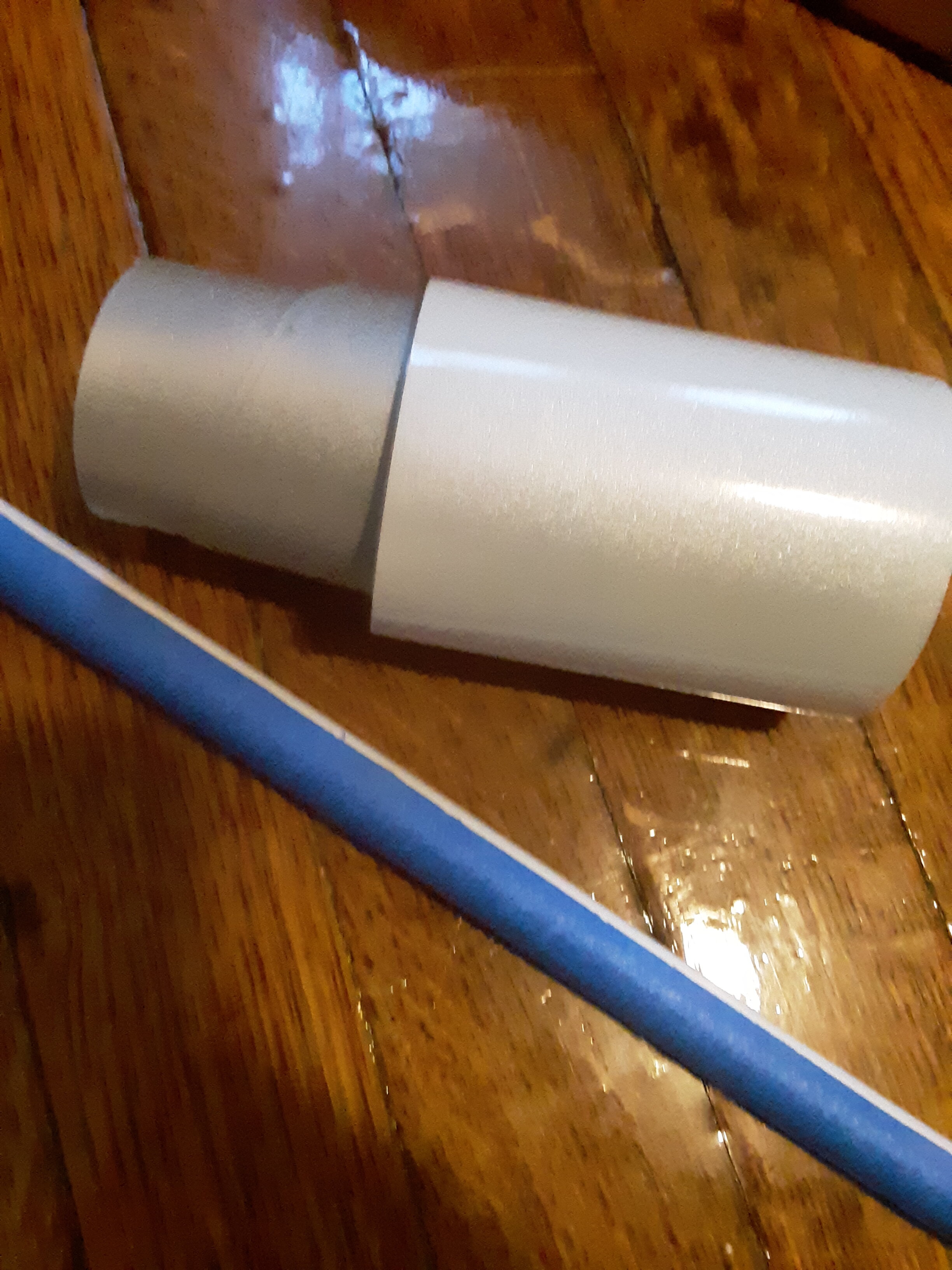

I have uncoated silver textured 3M and coated off-white 3M and I used the latter
The uncoated strips were not long enough and I was already figuring out how to taper it... you can see I didnt quite taper it enough near the tip and didnt get as much black as I wanted.
By the way, you cant run an xacto blade along this to trim it, it comes off in flakes and chips. The glue is THAT good.
I recommend little scissors. I actually ripped some of it away up top and patched it with strips of scrap for cleaner lines near the tip.

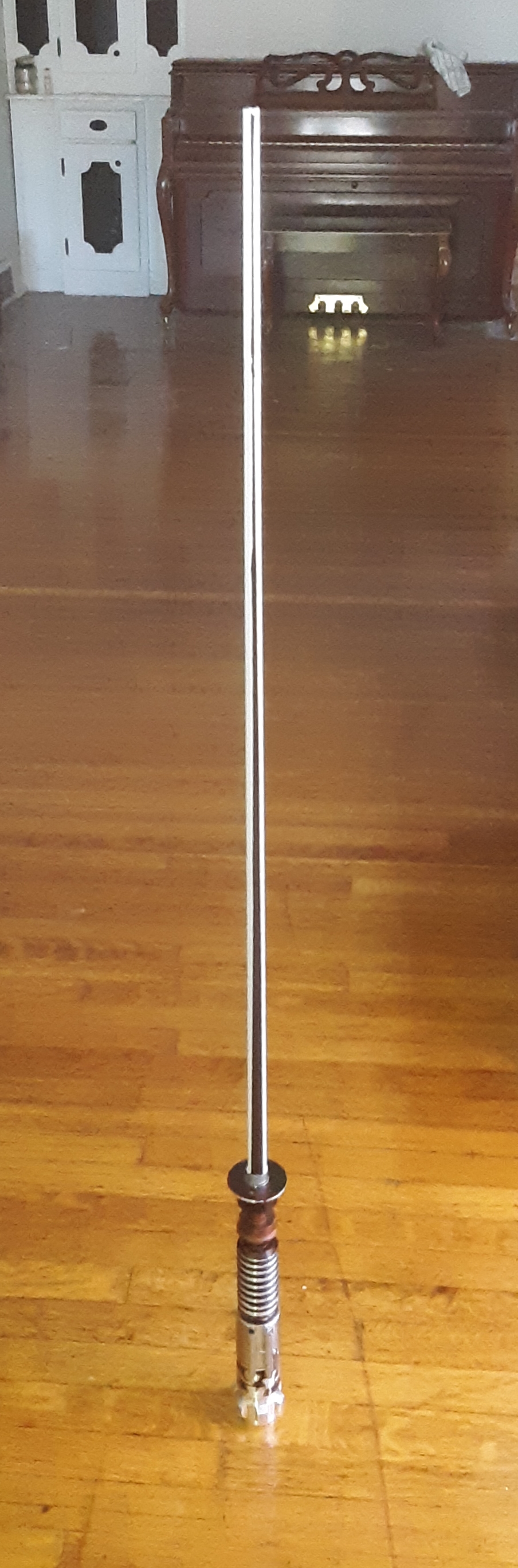

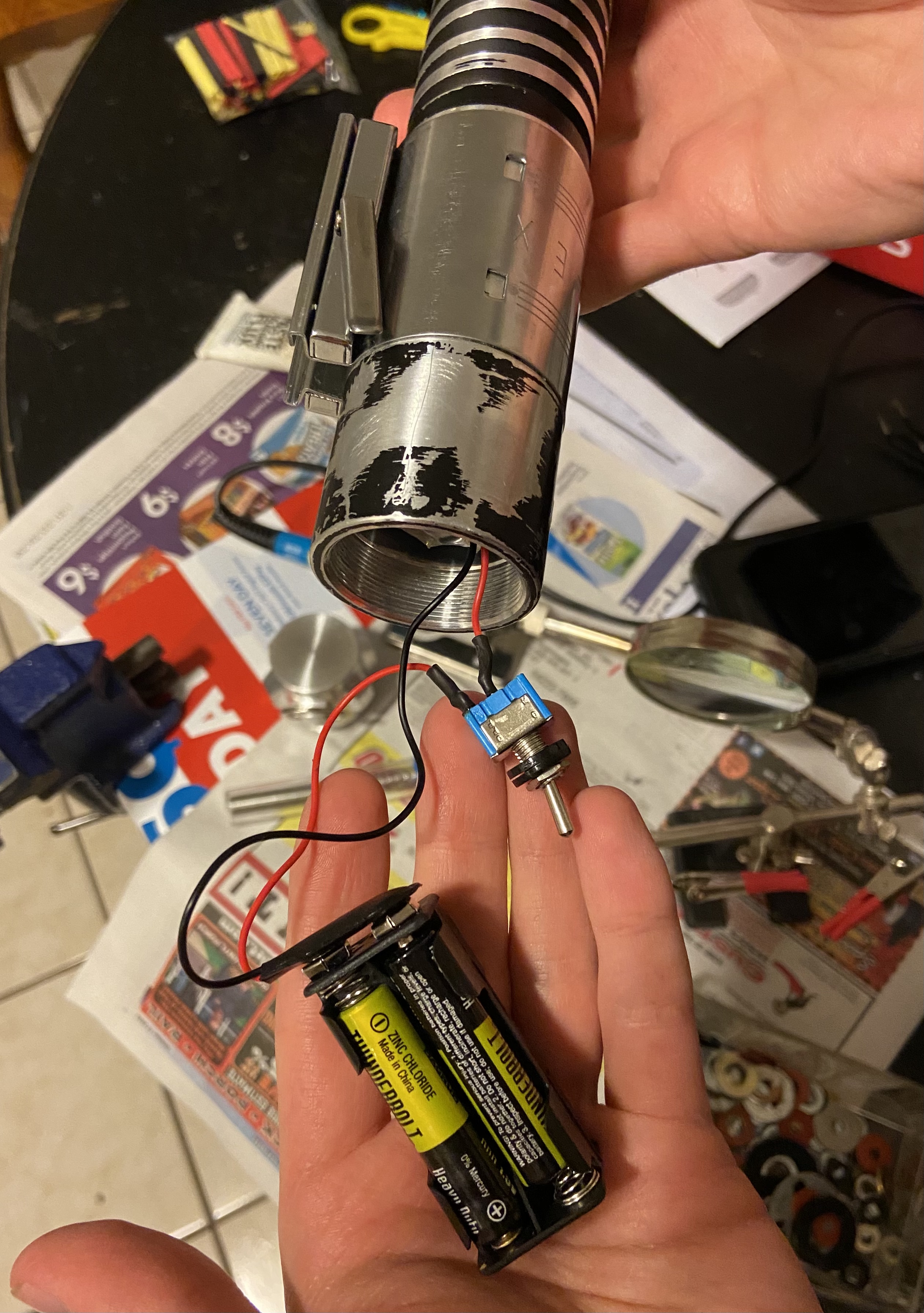

I believe it's 6V - Vadermania made the hilt and he said the motor needs 6V to run. I can see the end of the motor with red and black wires hot glued in place at the end. They run right to a battery pack (4 AAAs)
I actually am planning on interrupting the red wire and putting a toggle switch in the booster. AND I'll be switching the 4 AAAs for 2 3V coin cell batteries. The battery pack is much smaller (and it has it's own tiny switch too I guess) so I'll be doing a little soldering at the black wire, 2 at the switch and then splicing that to the battery packs red. I think?
There is a bearing at the emitter plate and the drive shaft runs right up the neck. I don't remember if there is anything else in there.

Coin cells are not going to work for you, I've just checked the spec's. Max rate continuous amp draw for CR 2032 is 3.0 mAmps (0.03 amp). The spec sheet for JGA 370 motor it draws 20 mAmp (0.2 amp) no load ; 50 mAmp (0.5 amp) under normal load & may even peak near 100 mAmp (1 amp) as used here. Amphr (should I be wrong) is a 3rd that of AAA so would not last long at all. You could look at 2x LiPo AAA. These are normally rated 3.7V so would run a little fast without a buck voltage regulator keep it down. Would last longer than alkalies & be rechargeable.
PS. Doesn't matter which wire you put the switch on, it's just convention it would be red one.
Thank you! This is stuff I'm still learning, man they don't have much of a current, I guess watches don't need it hahaha
Seriously just saved my butt :) Looking into lipo AAAs
You can easily remove the motor including the bushing and drive shaft by unscrewing the little grub screw in the section of the hilt which is covered by the Graflex clamp. I actually used 3 bearings in the hilt, two are sitting in the emitter, one inside the grenade section.
Thanks so much - Toggle switches are a bit big and I've been trying to find correct power thats a tad smaller.

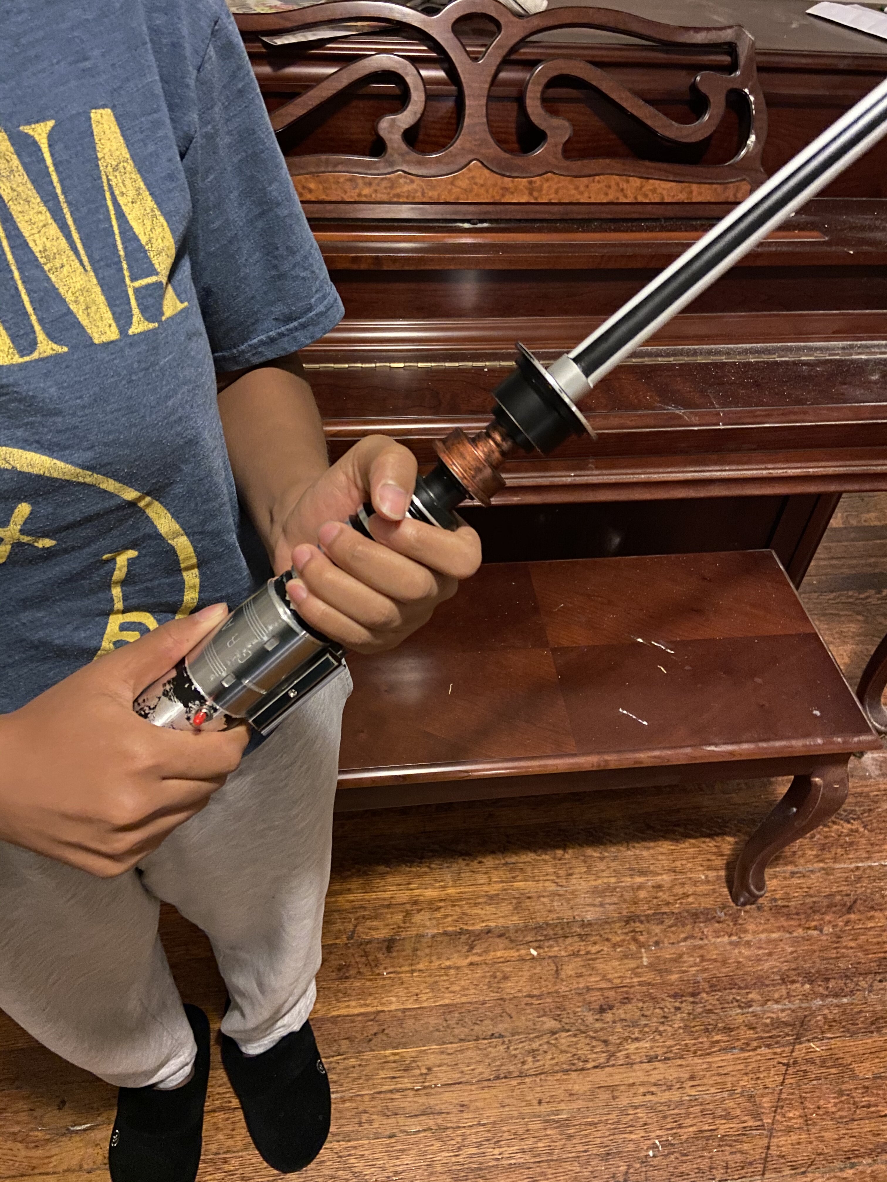

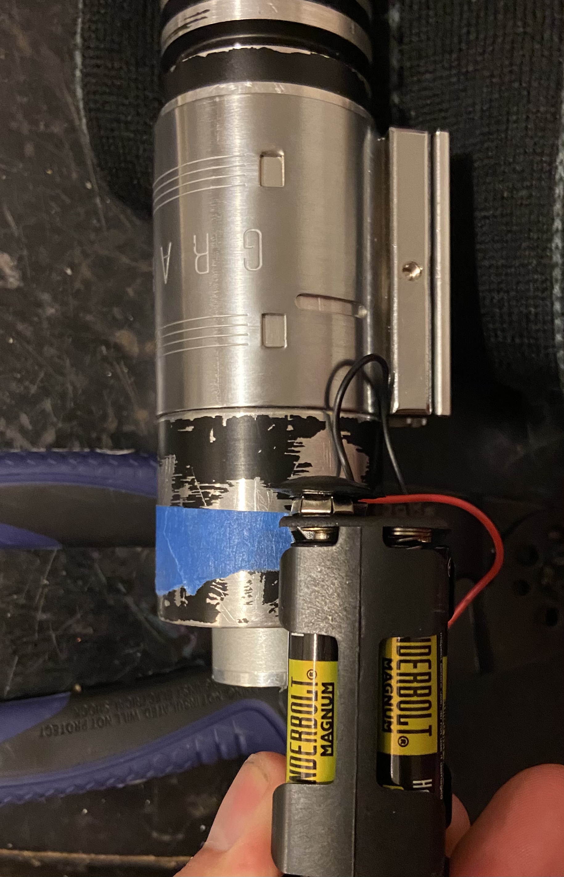

I gave into keeping the aaa batteries and dug up a generic SCI switch that seems small enough to fit
and this time soldering went well - it was almost instant - and heat shrink made it look nice haha
I know this is off track a bit but I got a switch installed. Its higher than the original props of course, batteries and all, but it feels really cool. (Never knew those motor adapters were springs)

It occurred to me today that the V3 has no switch hole, but a hole for wires... leading me to think it was a primitive version with just an external battery pack and possibly a switch outside with it if at all. Just pop the batteries in and let it go honestly

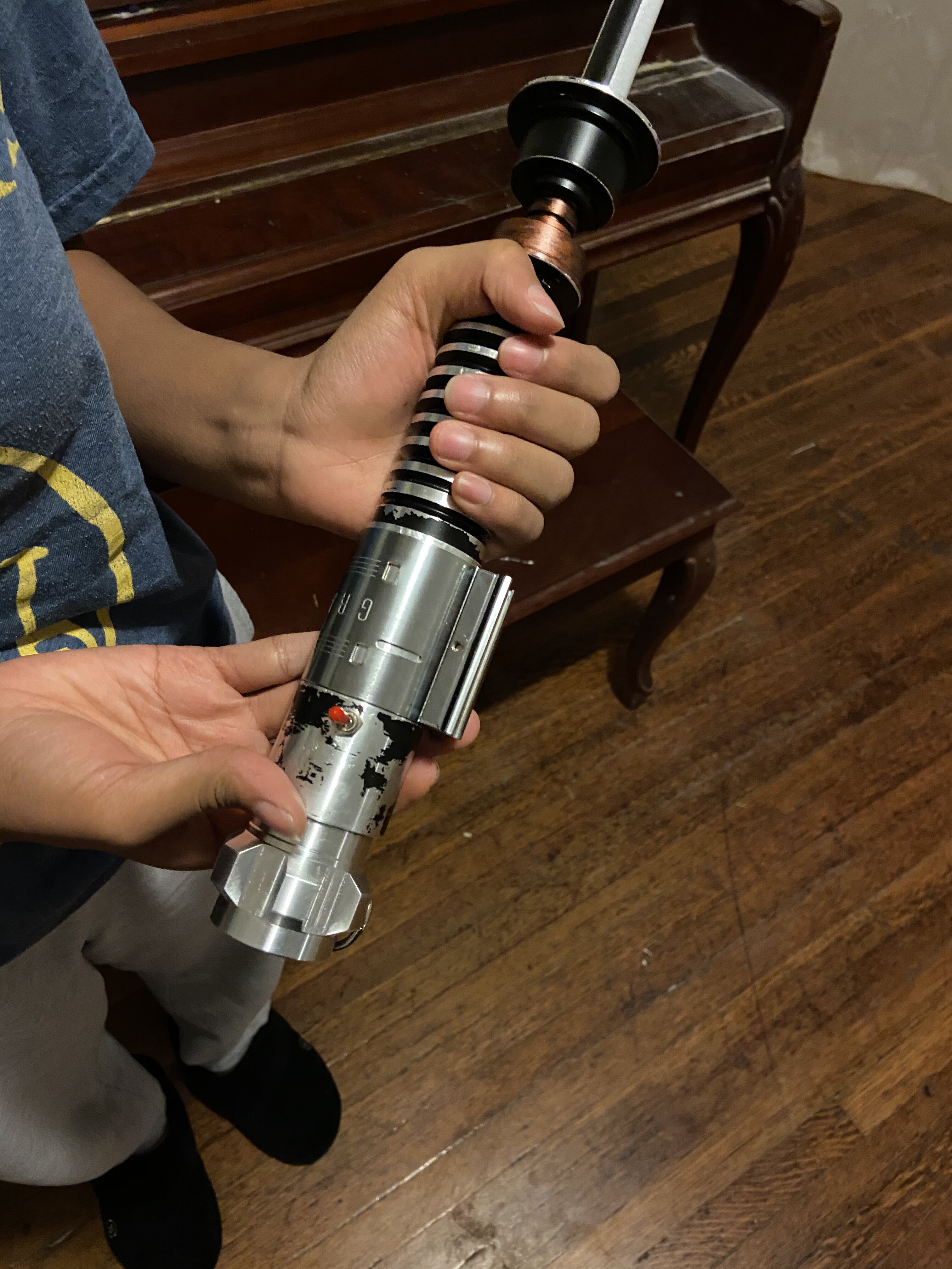

here’s the pommel screwed in, the battery pack fits with the wires and snap connector kinda jammed in there. The GF modeled for me!

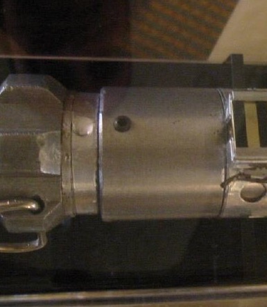

Are there any pictures of this wire hole? Are you talking about the depression under the silver tape? If so how do you know it's a hole & not the depression for a grub screw? TBH I'm in agreement with Halliwax ( :eek: ) that it was never motorised.

I absolutely was talking about the hole beneath the foil tape - it is admittedly true it could be a dimple or a half drilled hole under thay tape or something. It is where the mystery chunk is on the V2

I’m 100% confident it’s a hole..
Give me a second to switch computers to attach pics
maybe even possibly plugged with a screw? dunno
i think if it was just a divot they wouldn't have covered it in tape? i think the tape is there to hide the hole.. i dunno...
