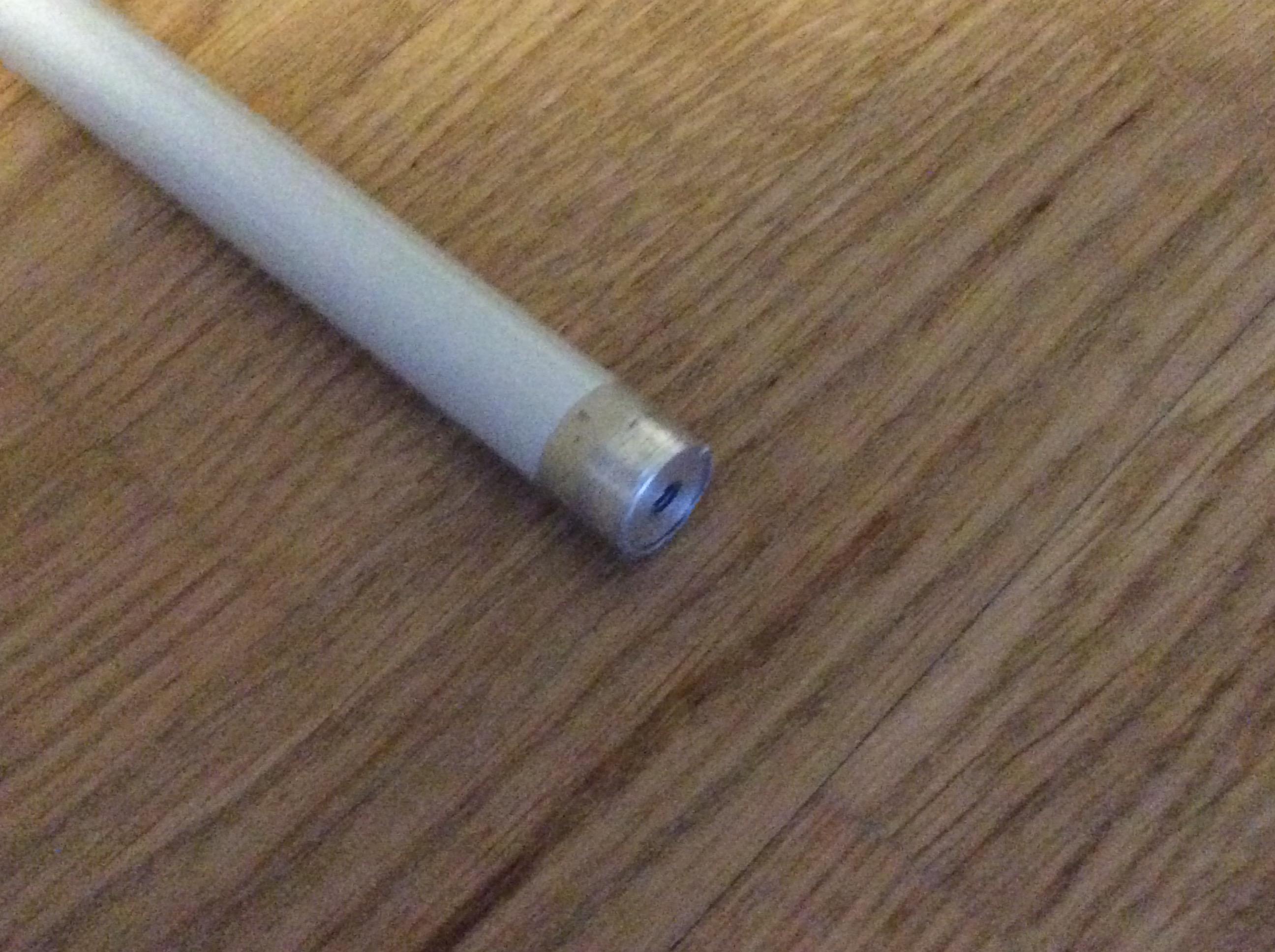

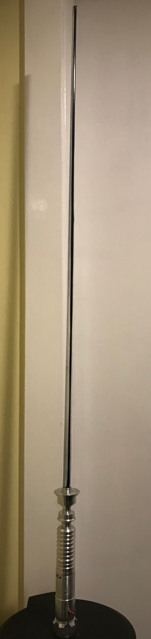

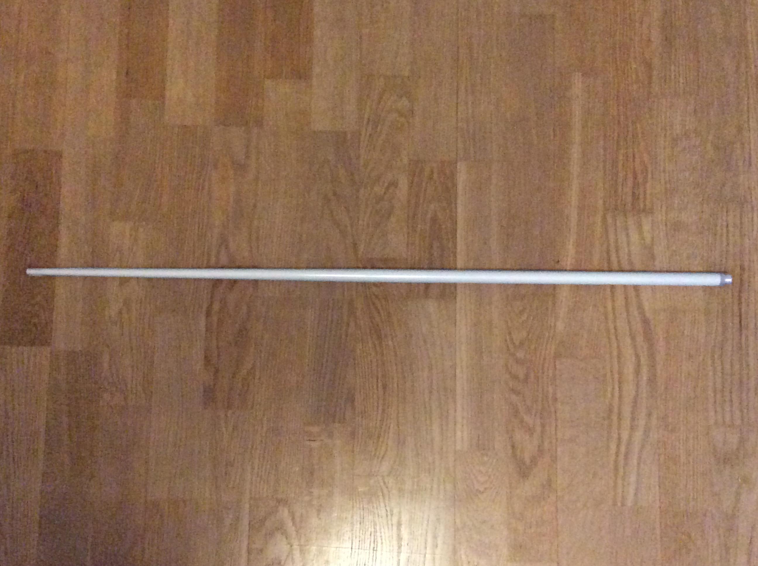

Aluminum ski pole covered in self adhesive scotchlite tape. Solid piece of aluminum glued into base with a threaded hole to screw it into my emitter. Length 96cm, diameter at base 17,5mm, tip 8mm.
