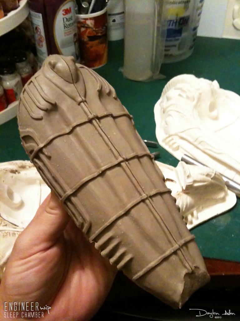

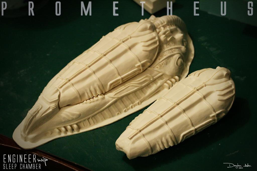

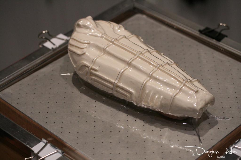

I spoke last time about placing the Sleep Chamber in the freezer hoping that the sculpted canopy will loosen from the plastic casting to make the vacuum forming process easier - happy to say it was a success!
Now that I have the sculpted piece free from the bed, I can make a mold and cast a copy to use for vacuum forming the clear canopies.
Here is an image of the casts from the sculpted canopy.

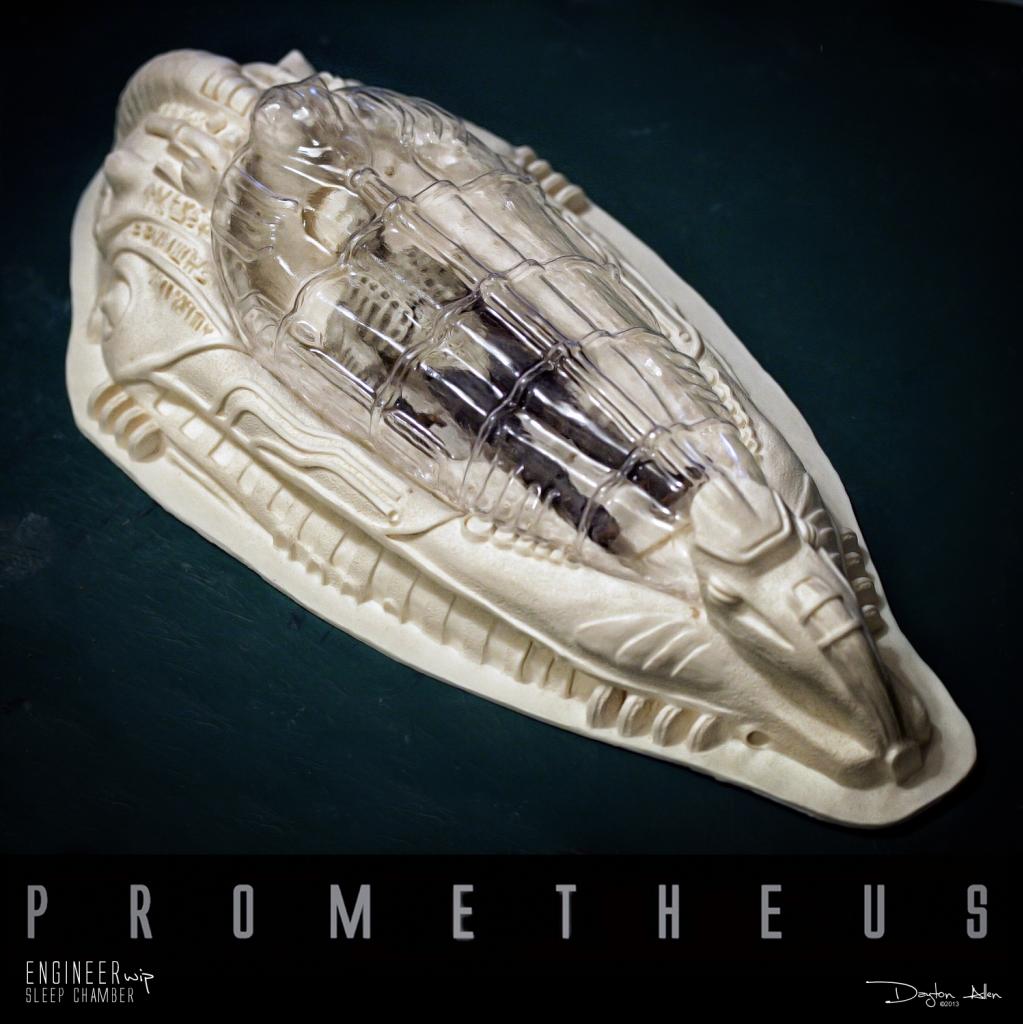

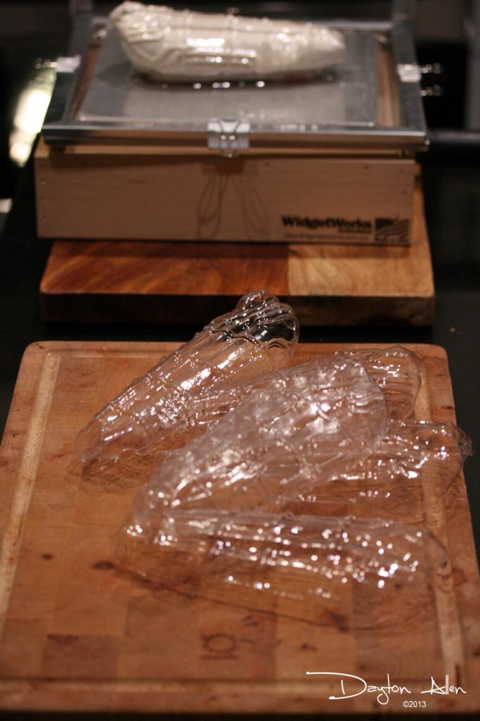

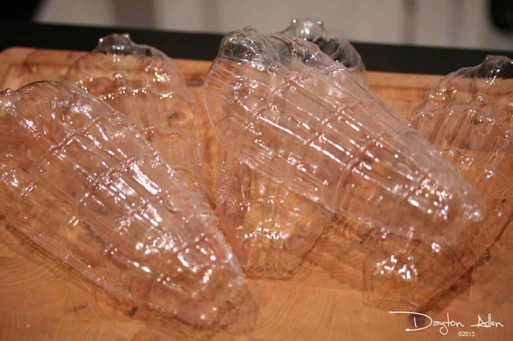

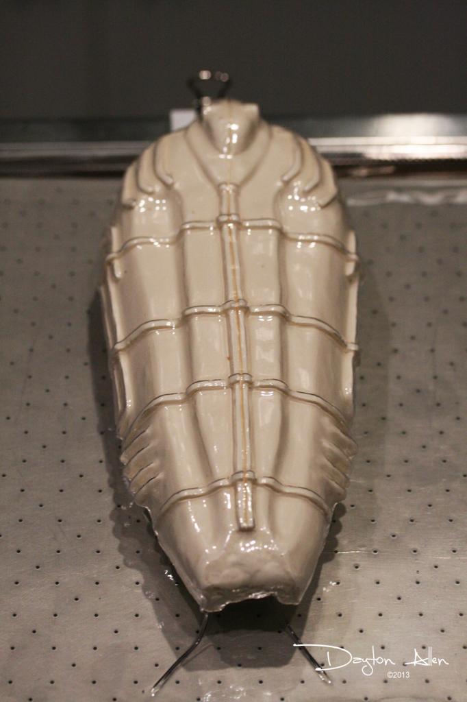

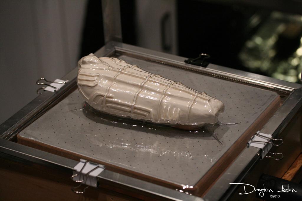

The next step will be to vacuum form the canopy - I haven't done anything larger than a 2" x 2" form so this will require a larger former and the kitchen oven. I'm using PETG .020 mm - don't need anything thicker than that. Thanks to my Dad for helping me out with the process - it can be done alone but always more enjoyable when someone else is there to participate...especially when they come out like this!!!

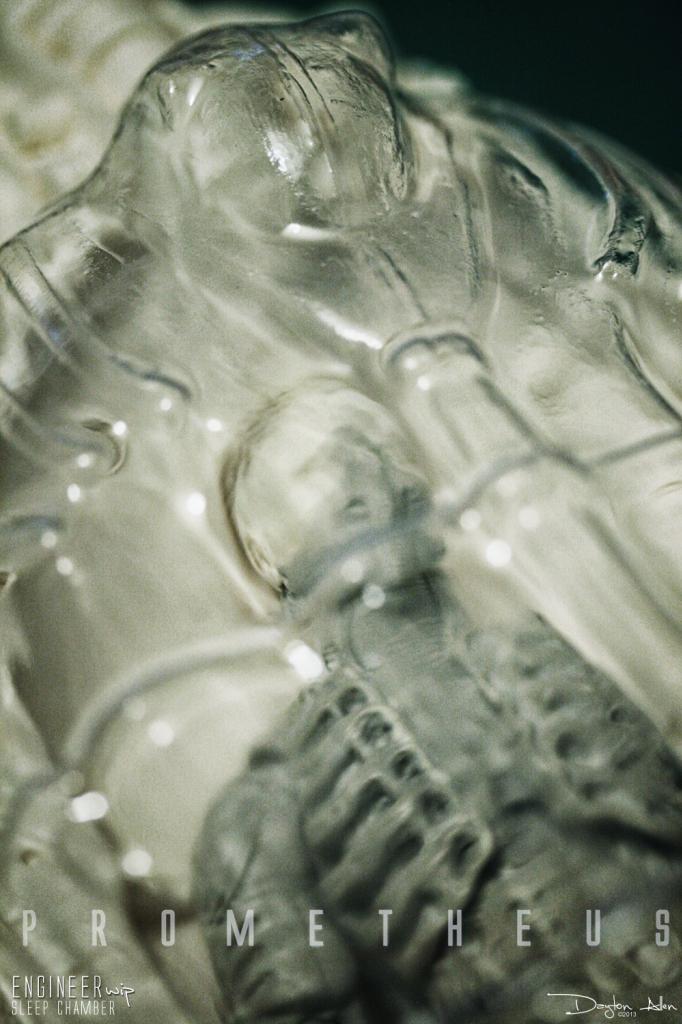

Temp of the oven is set at 375 degrees for 30-50 seconds. Made several - some for paint tests and such.

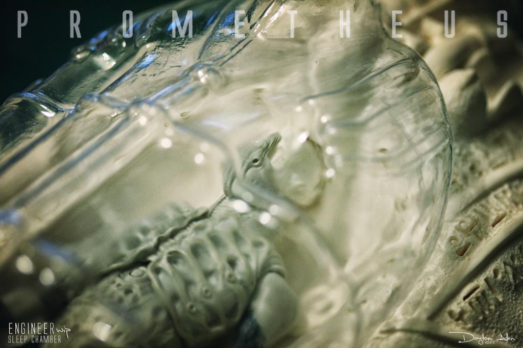

Thrilled about the outcome! The formed canopy will simply sit on top of the bed, secured by the lip at the front of the chamber. This will keep the canopy from falling off easily.
Below are shots of the finished canopy places on the bed of the sleep chamber along with a work in progress sculpt of a sleeping Engineer inside!

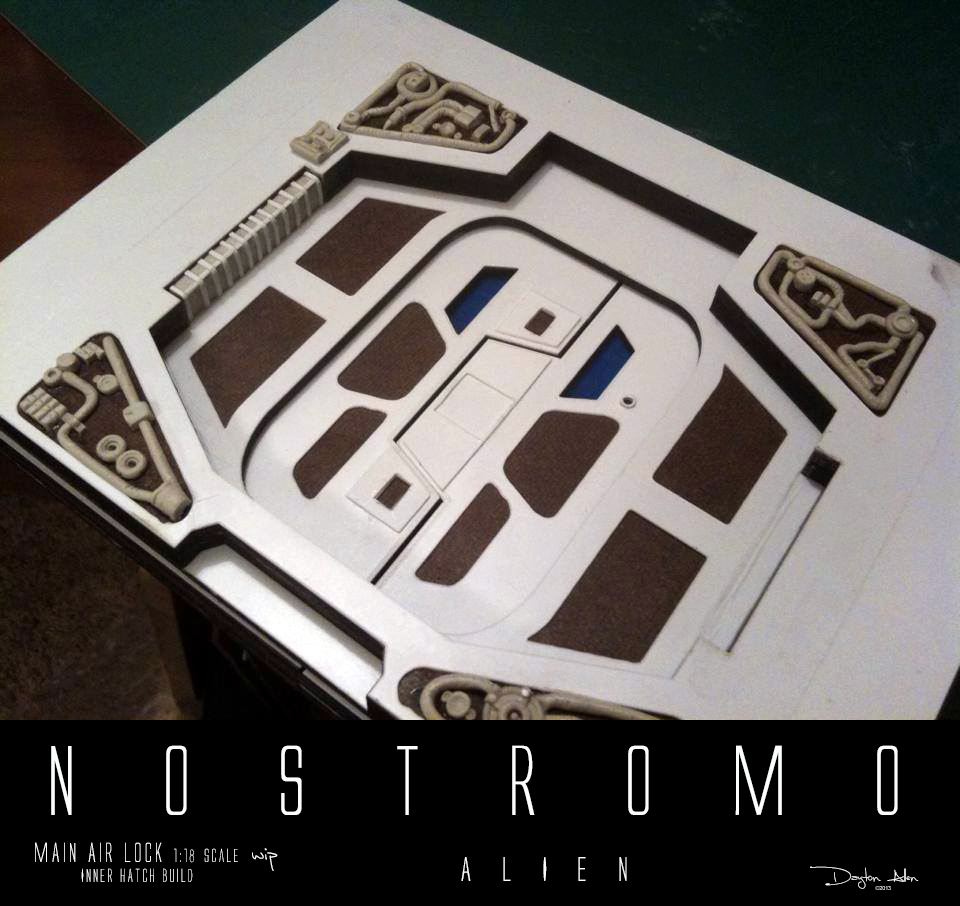

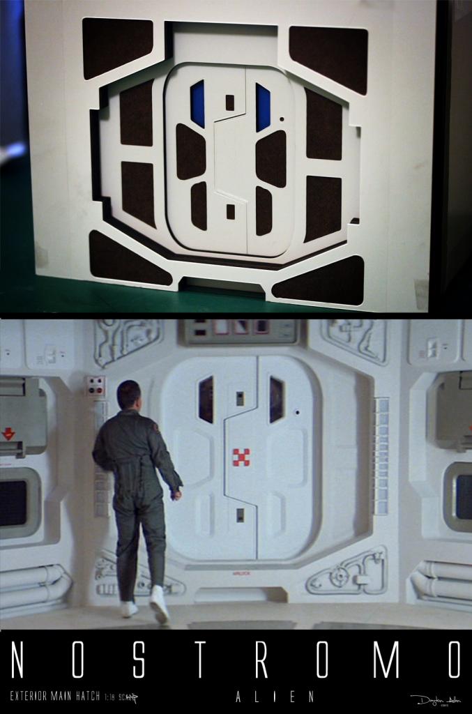

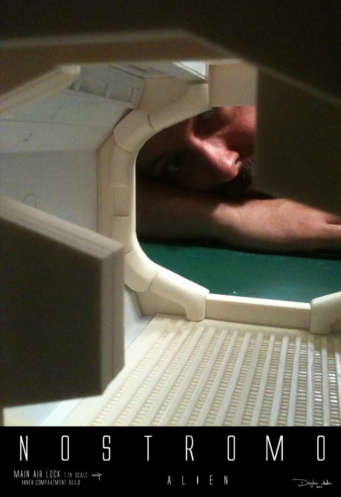

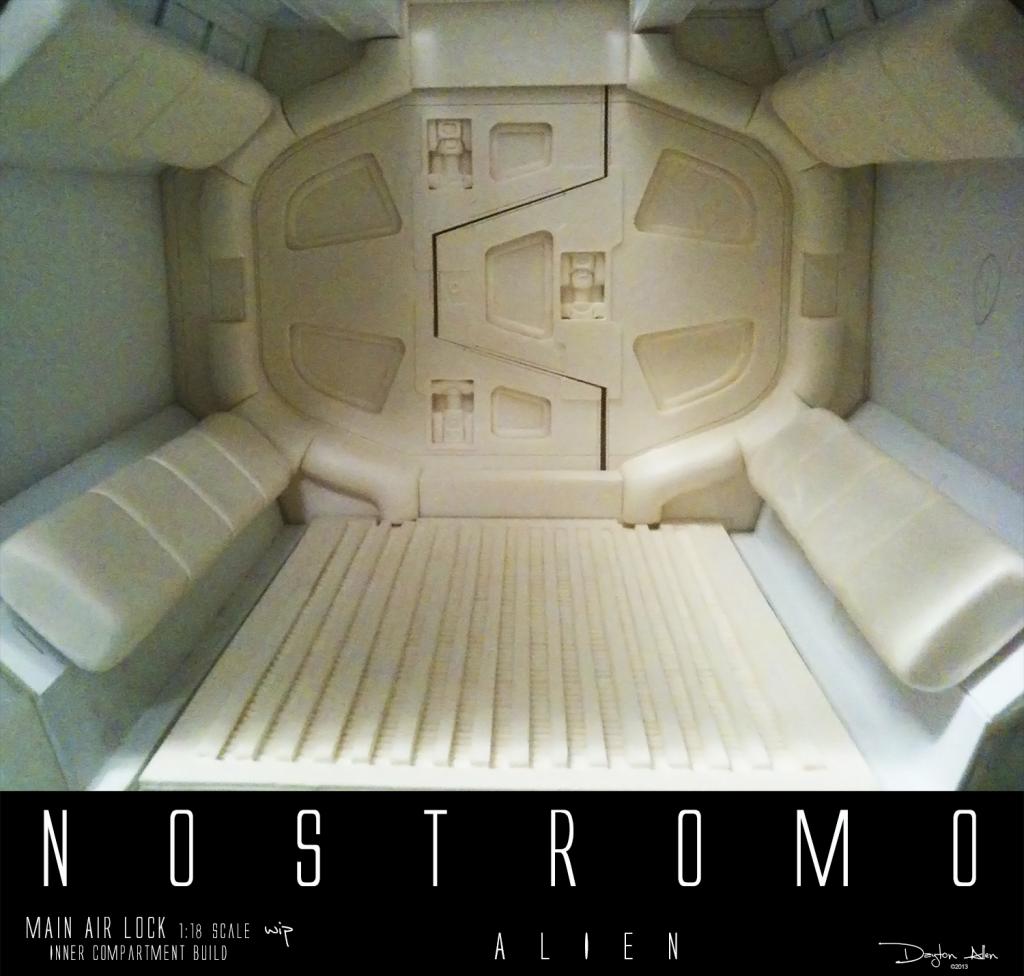

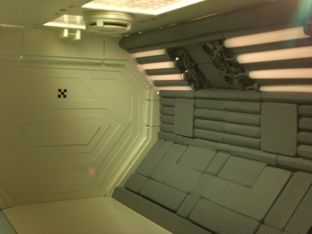

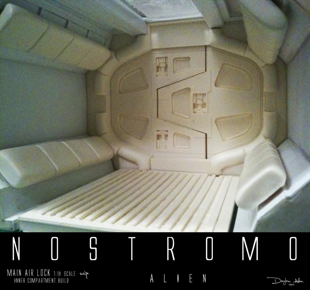

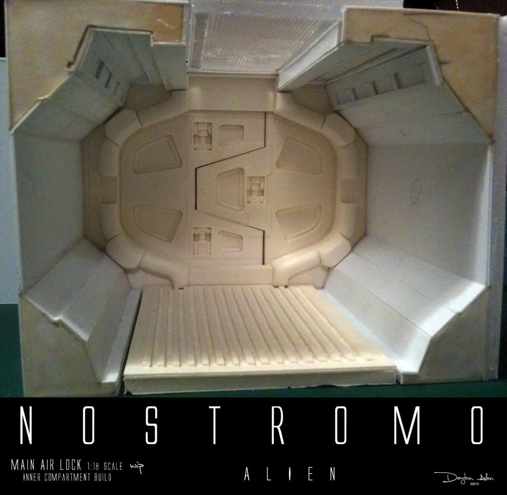

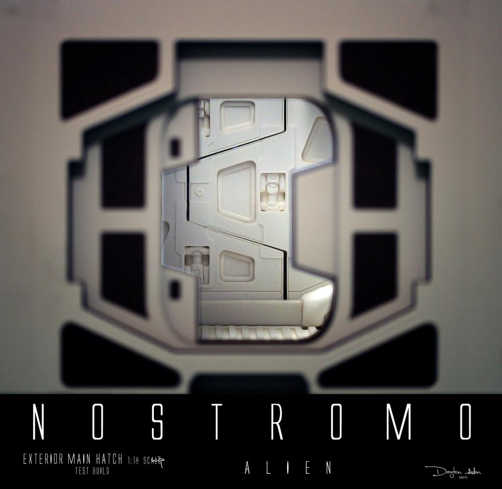

Back to the Nostromo and the addition to the work in progress, Main Airlock. I have created the vector line art of the Inner Lock Hatch Door and had the artwork laser cut last week. Here are a couple shots of the assembled pieces....
This will connect to the Main Air Lock - here are some images of the interior so far.
A shot from the outside looking in LOL!

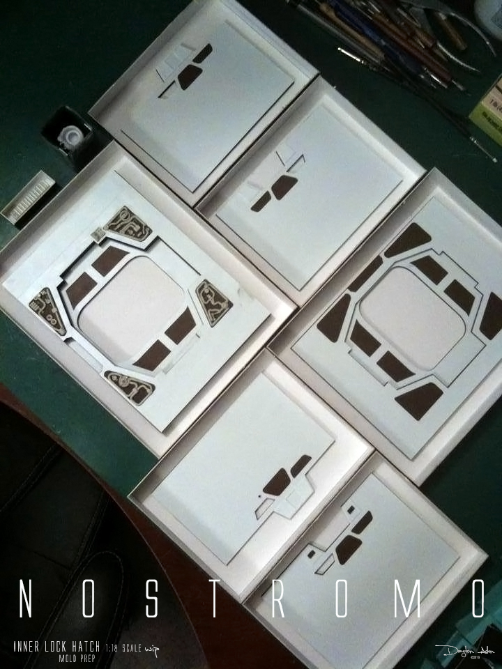

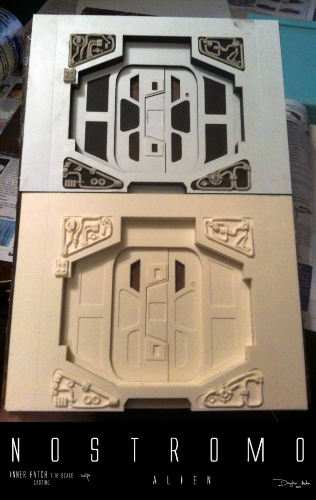

The Inner Hatch Door needed some greeblie work so I used Aves FIXIT to sculpt tubes and hardware.
Once complete, I prepared the parts for mold making. Unfortunately I only had enough mold material to create the front panels of the door - the interior will have to wait till I can afford purchasing some more. Isn't that always the way it goes?...
...and here is a successful casting of the front panel and door pieces of the Inner Lock Hatch Door.
Some of these images were taken with my iPhone so forgive me if some of the photos look to be grainy - they are LOL!
So that is where I am so far...more to come so stay tunes and thanks for all the suggestions and comments!
Created a short video of the Air Lock section of the diorama so far - nothing glamorous but a good test of things to come...

THANK YOU Samster! It's truly a labor of love at this point - at first is was simply a figure set of the original 1979 crew but just blew up into all things alien through alien3! As far as sets for sale...I'm doing the best I can to mold and cast plastic copies at this point to use for my completed piece while keeping the masters stored away for just an event. Once I have completed a good chunk of a corridor or section of the ship, I will begin offering limited kits - unpainted - which those that are interested can use as displays or whatever they would like.
Re: THE NOSTROMO - 1:18 Scaled Interiors - 12/23 INNER LOCK HATCH page 3
Can you tell us what material you are using for the molds/casts? Silicone and urethane I assume, but whose? I'm a big fan of the process documentation, anything showing the steps to help out your fellow craftsmen.
Sure Bondo - I am using Smooth-On products. The molding is Mold Star 15 SLOW which is a Platinum silicone and the casting material I am using is Smooth-cast 320 which is a off-white urethane plastic that is great for prototyping. Can get expensive at times depending on the project but I do want to replicate and keep the masters in a safe place. The laser cutting isn't cheap and I'd hate to ruin a master if I went wonky on the paint job :(

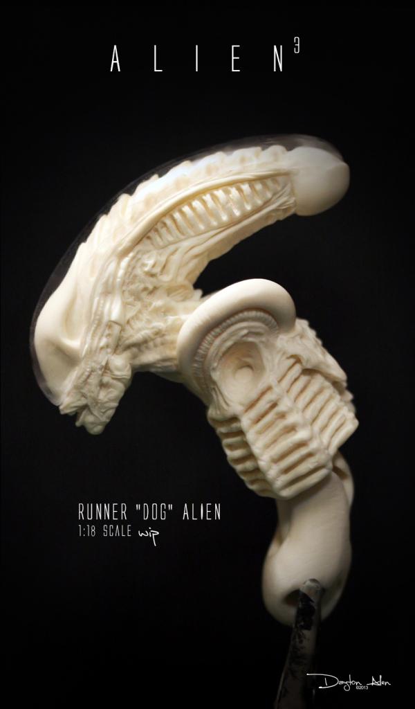

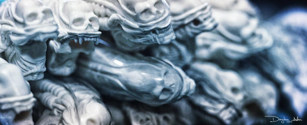

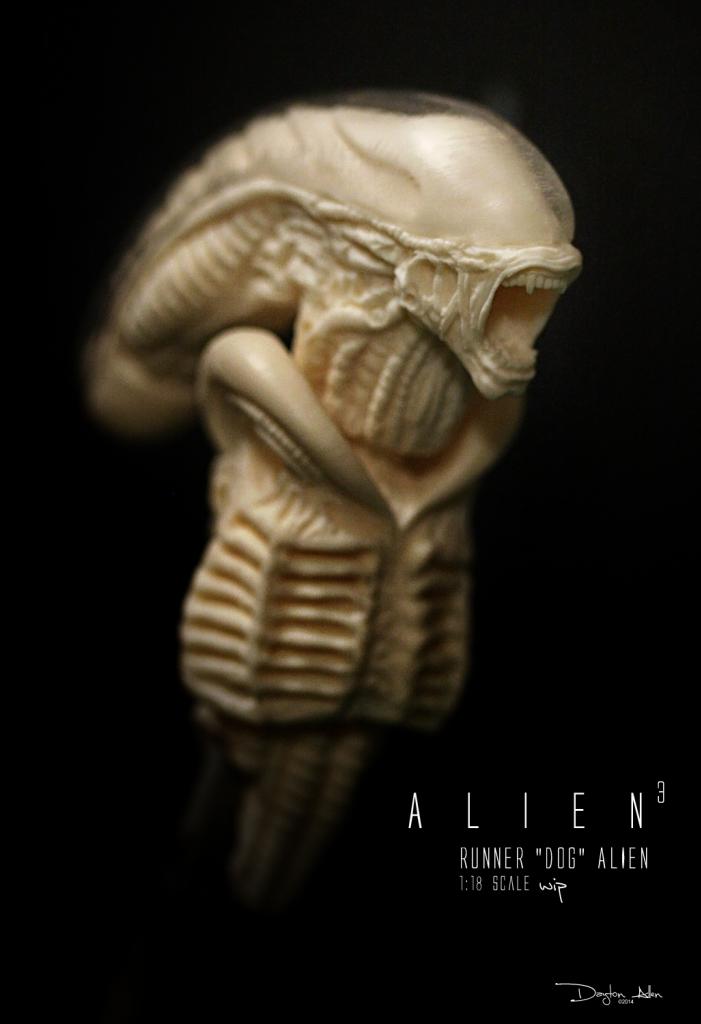

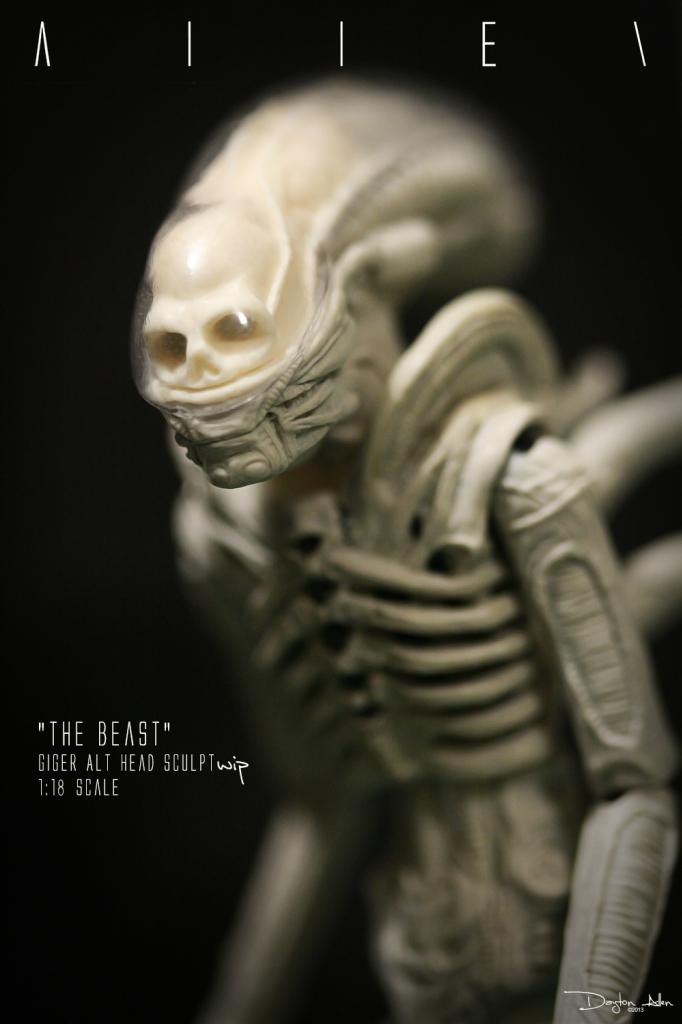

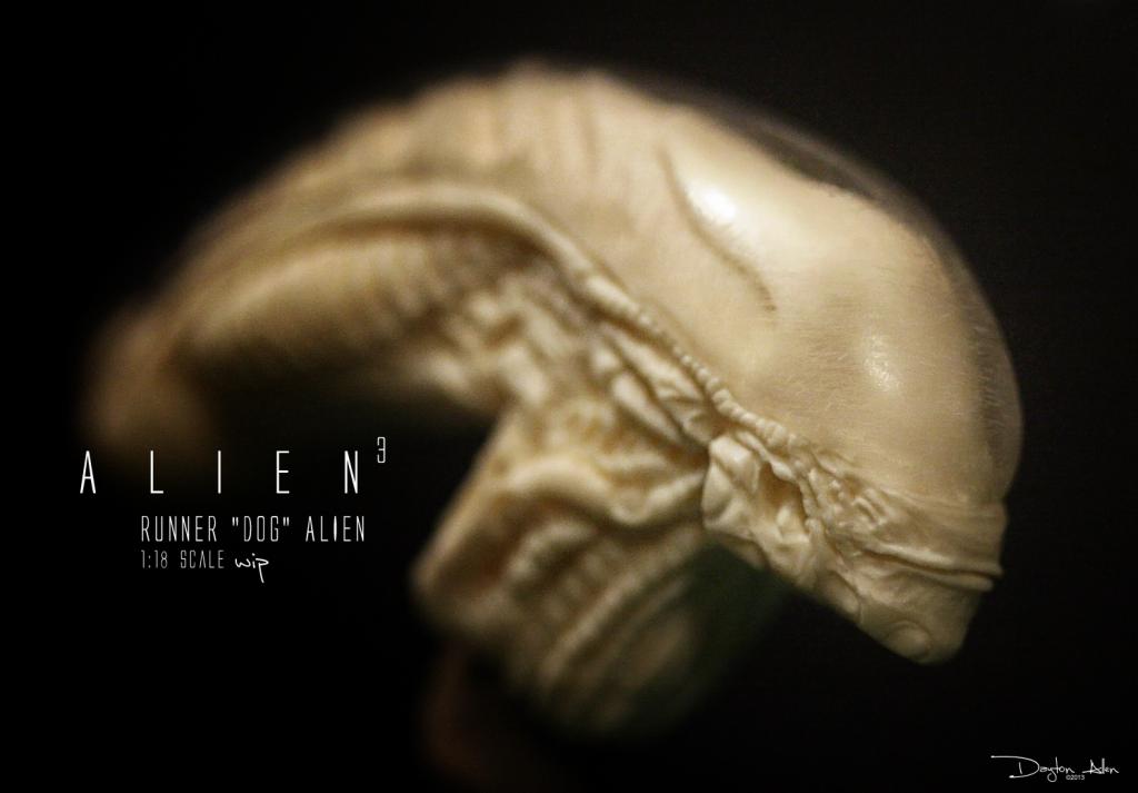

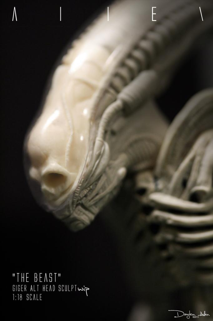

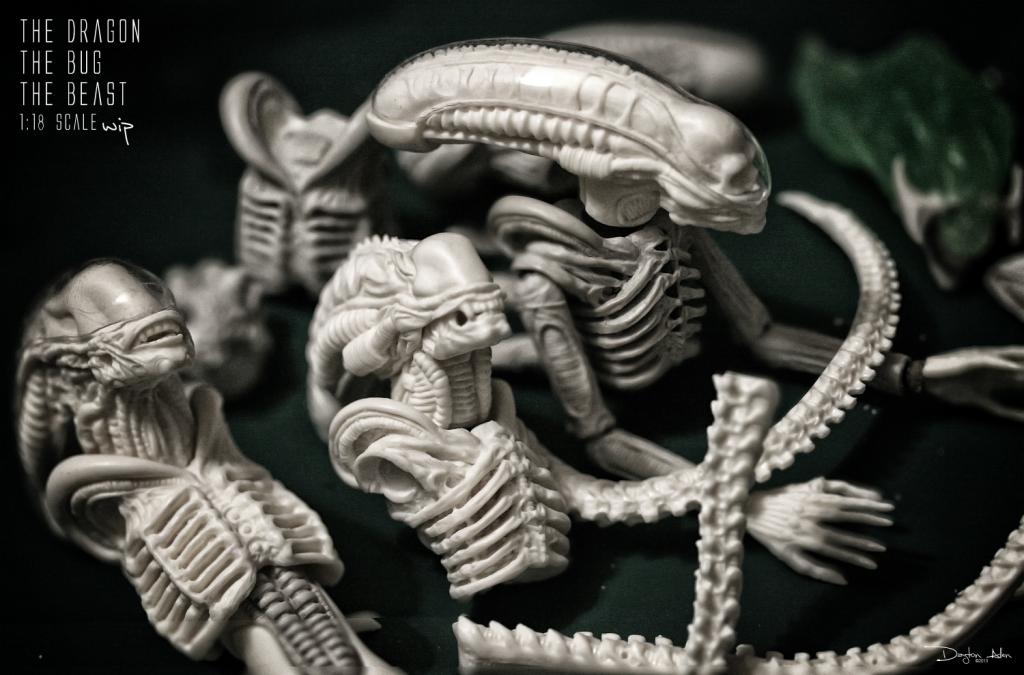

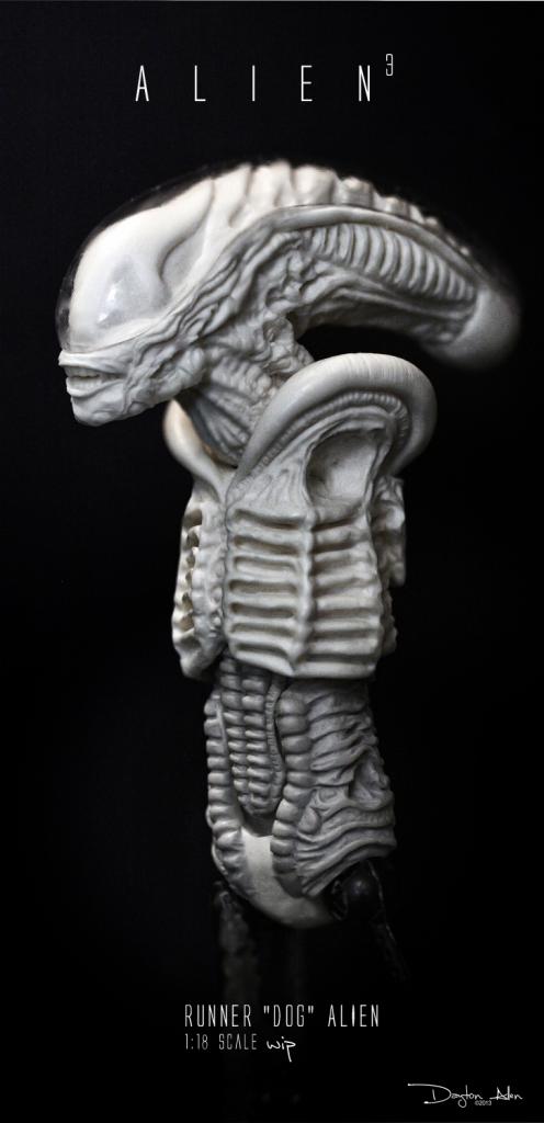

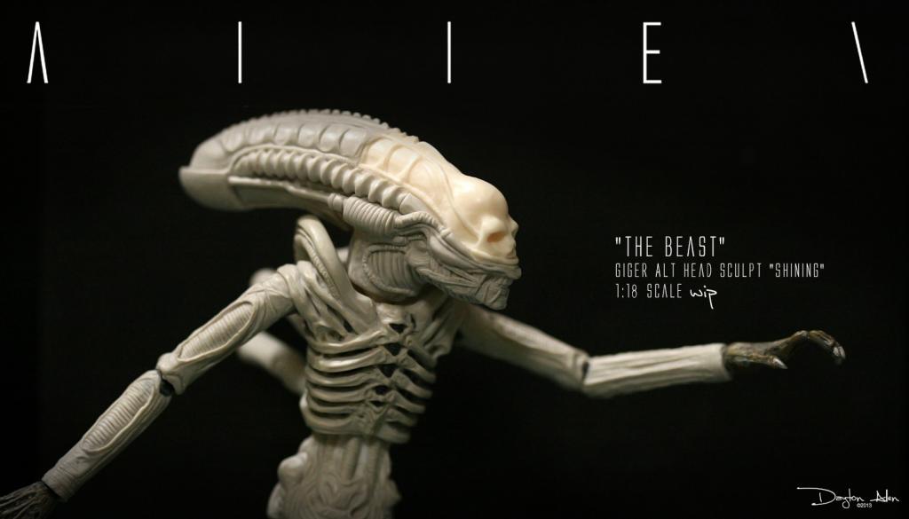

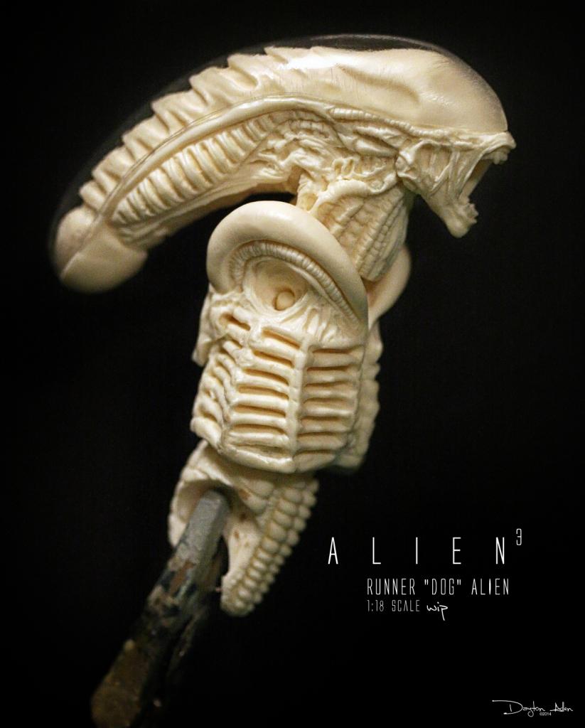

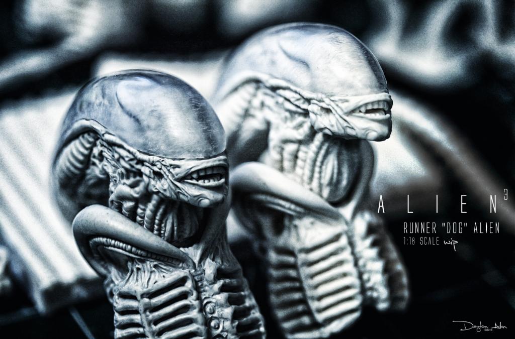

Here's a sample of some of the most recent 1:18 scale sculpt work I am working on - first with the Dog Alien from ALIEN3.
...and the original 1979 "Beast"...
You can see more of my 1:18 scale work here - Flickr: sith_fire30's Photostream

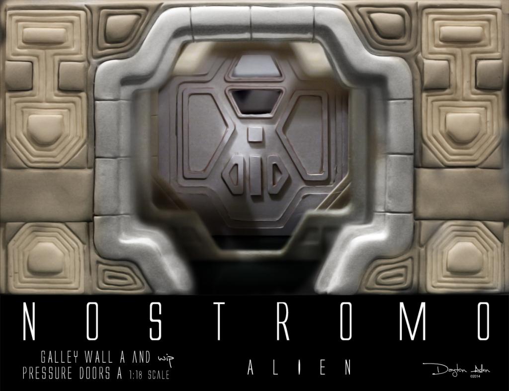

ANYWAY - This is all about the NOSTROMO today and most of what I have to show you is at this very moment being cut or will be laser cut in the next week or so. So most of what I have at this point are line art shots and some paper builds I create to make sure the layers are accurate before investing the money into laser work.

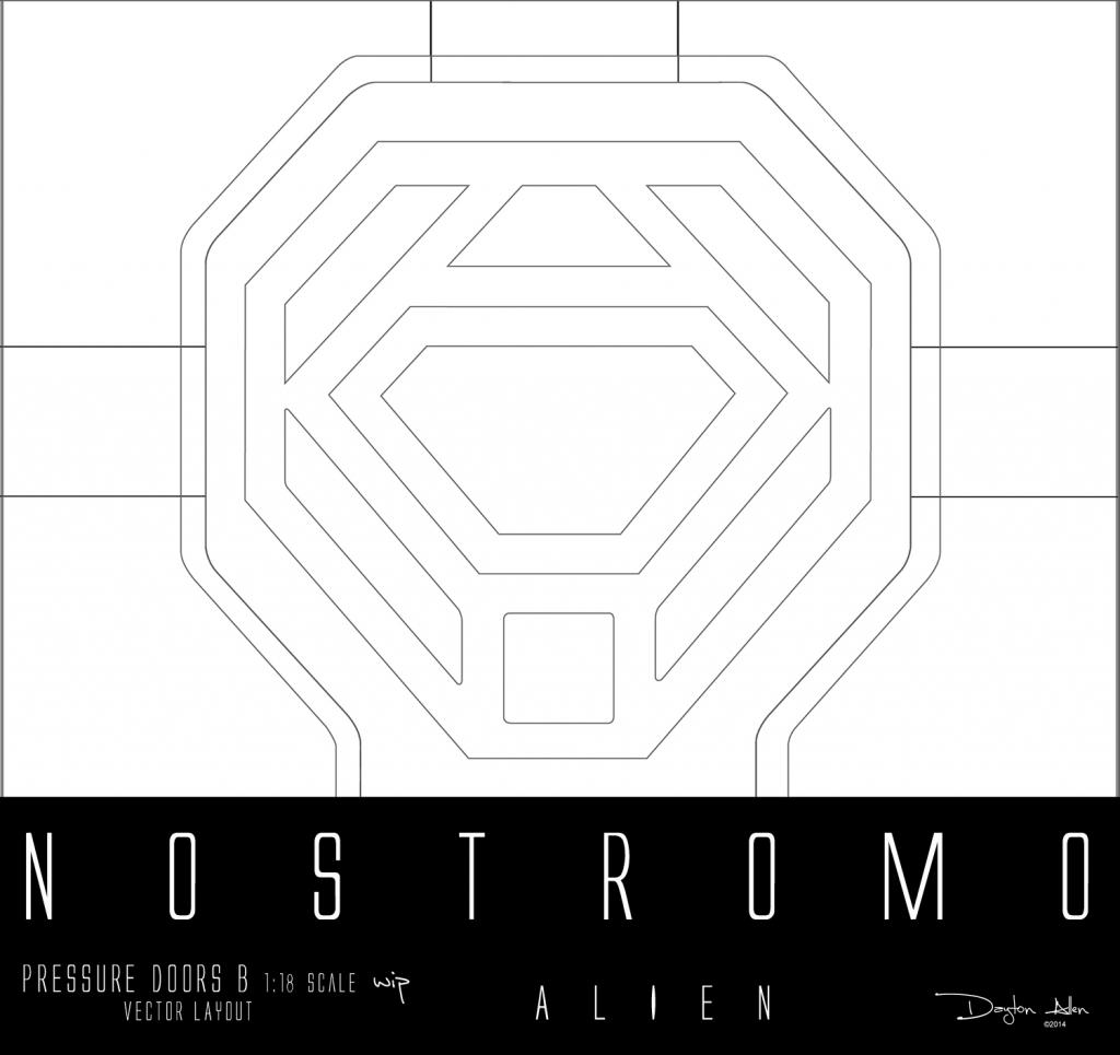

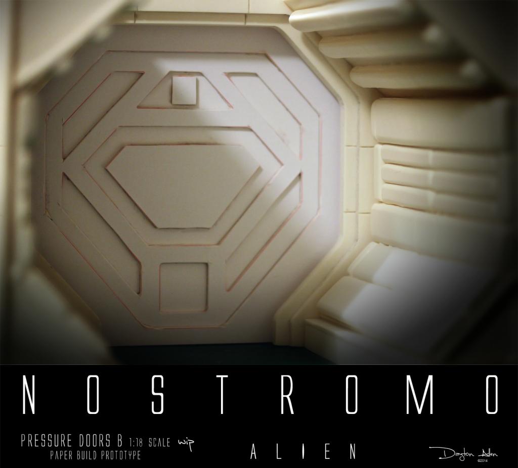

This time around it's all about PRESSURE DOORS...and the Nostromo is full of them.

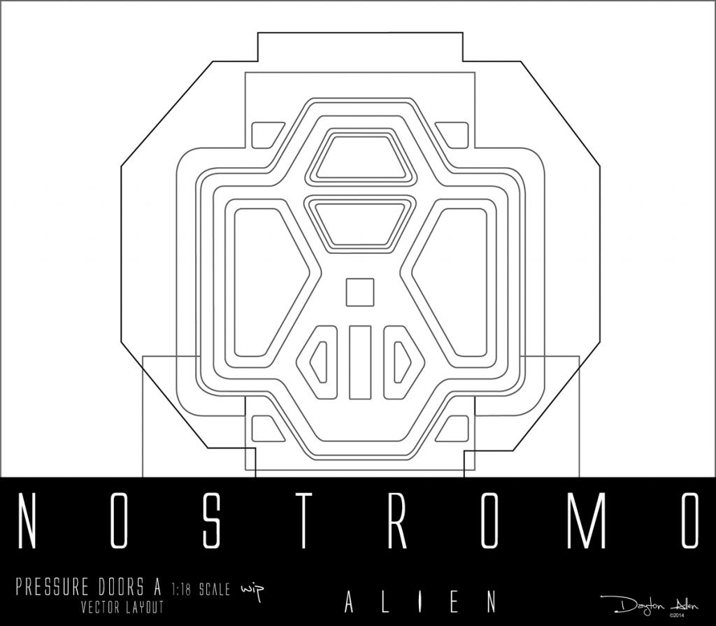

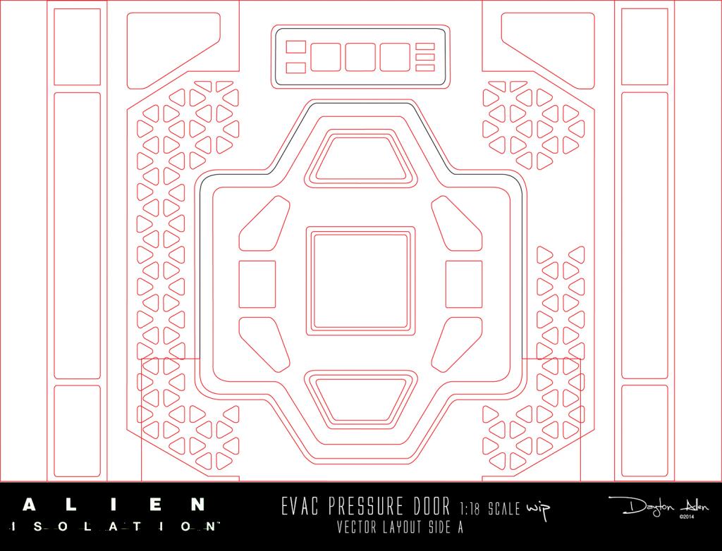

Similar to the Main Air Lock and it's exterior section, the first step is to set up the artwork as vector files. These will be the documents I send over to have laser cut. I do the same amount of research I do when it comes to sculpting and try to incorporate each section in it's own separate layer, listing the material that will be used for cutting (styrene, .125 Masonite etc). Here are the vector drawings I made for two pressure doors seen on board the Nostromo...
The standard pressure door that is seen throughout the ship (leaving the galley, through the corridors etc). The framework that will hold the door has already been made. The door will have two sides and a clear acrylic piece for the window. You can simply remove the door section when you want the portal to be open and place it back in when you want to show the door sealed. I was thinking about a way which I could pull up on the door section and lock it in place then push down to close it but felt that wasn't necessary.
Next is the pressure door that proceeds into the hypersleep chamber. Very simple design - I believe both sides are the same. I haven't seen any reference images to say otherwise. If any of you know of any please pass them along my way :) Same idea for this one.

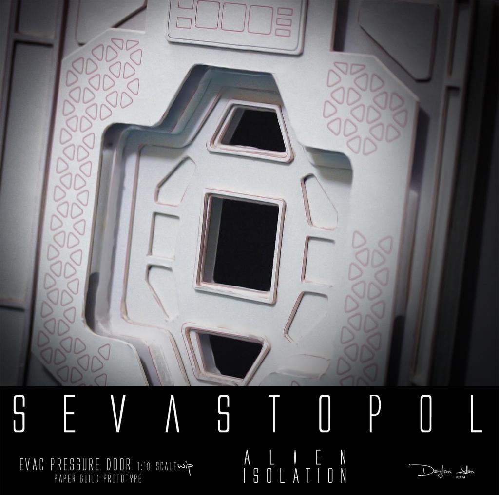

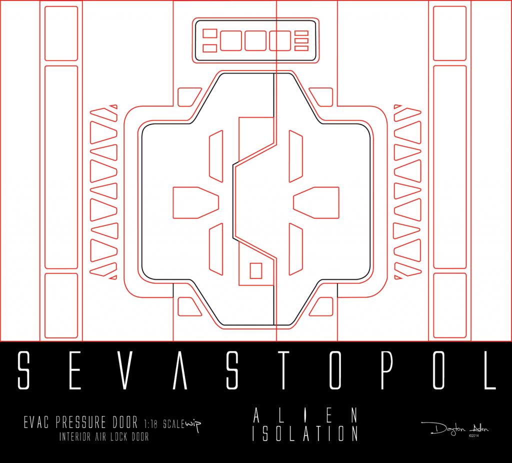

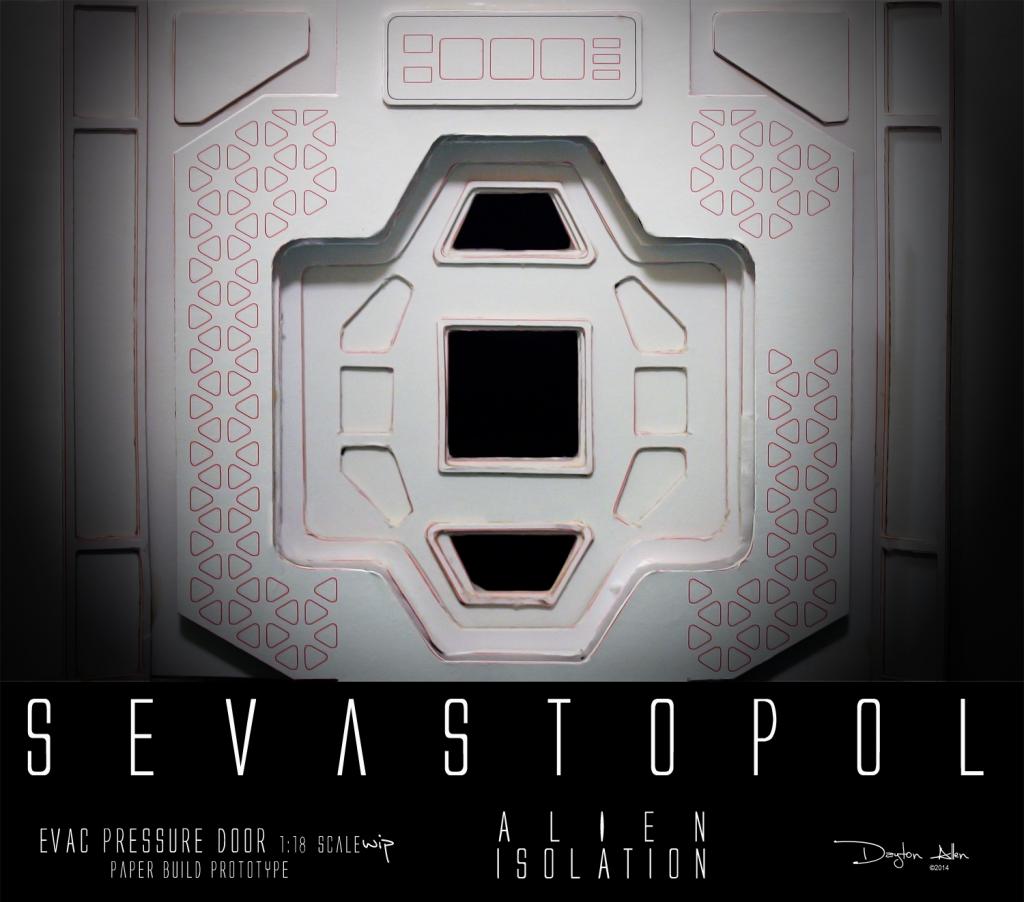

Anyone see the artwork and gameplay for the new ALIEN: ISOLATION game? I've been going crazy looking at all the 70s sci-fi and Nostromo-like environments. It makes sense that during this time in the ALIEN universe more vessels and space stations would share the same motif. Saying all that I was inspired to begin work on the air lock seen in the gameplay trailer!!! 1:18 scale like the others so again - hand in hand. Here is the line are for both the exterior and interior of the Main Air Lock of the space station SEVASTOPOL.
Inspiration for this project came from the ending to the 5 minute gameplay video that was released last week- starting around 4:16.
Once the line art is complete I cut out some matte paper/foam core mock ups to make sure the layers are correct and work with one another. They aren't perfect or pretty but they help get an idea how the final piece will look.
Sculpting the galley walls by the way - first panel almost complete.
So now I wait for the laser cutting to be completed - the gentleman I have doing this for me is a teacher so it's based on his schedule which isn't a bad thing since he does such good work and charges me a fair price so no complaints here....but I do get excited :)!!!
Much more to come for updates - I have the galley panels to work on, the table is almost complete. I have some additional corridors in the works and will begin working on the hypersleep chamber next week. Much to keep me busy! Thanks for all the comments and suggestions! If you have any questions please let me know :) Thanks!
