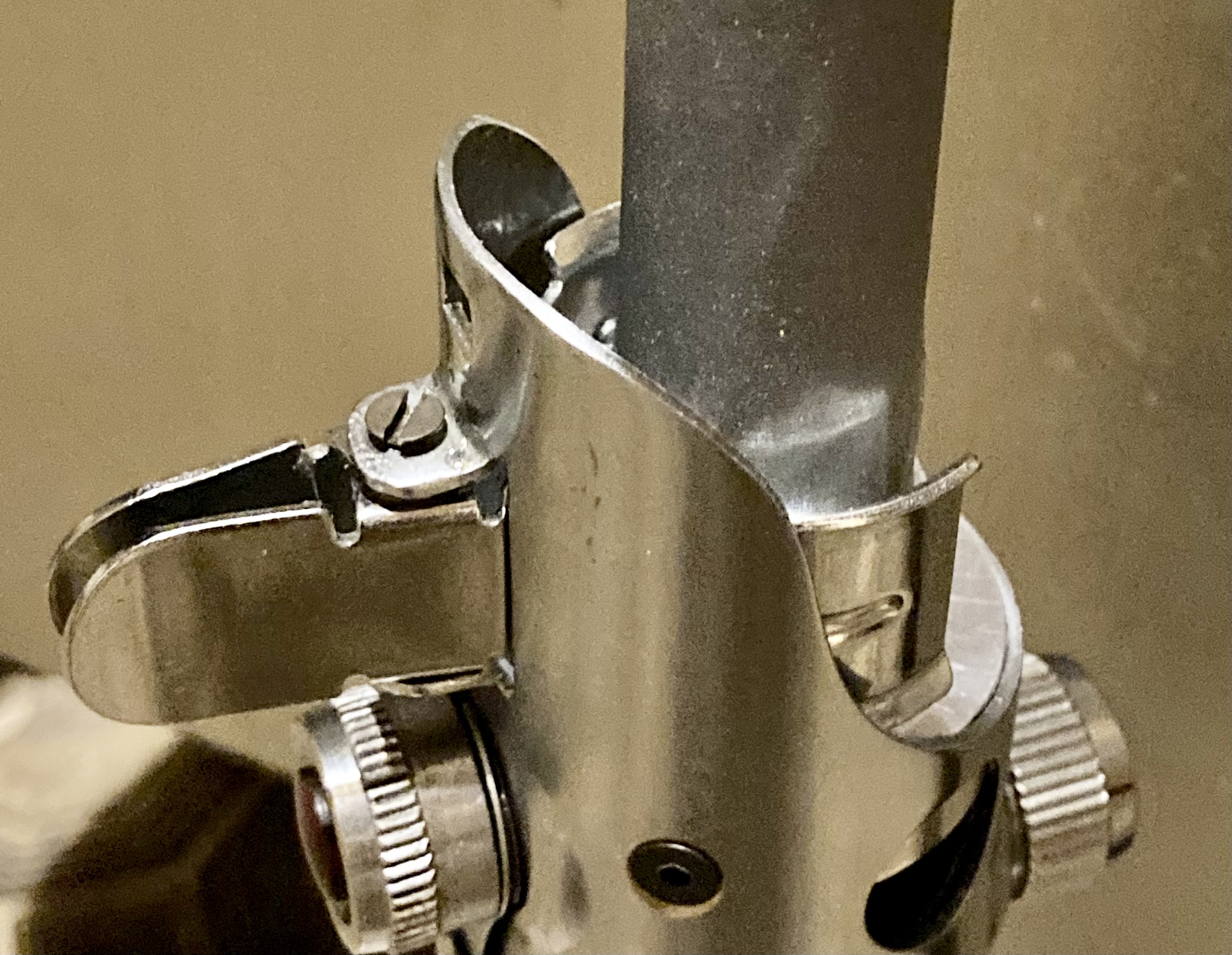

I’ve got some updates. I dremelled the rivet in the bunny ear ring and removed the spring. Right now I just have a screw I got from an antique store in there… I kept the bushing in there since the graflex tabs have a smaller hole, so whatever bridges the tube and ears has to be that small.
The blade… check out my “converting an OT blade” thread, this is Chinese reflective fabric, cut to shape and affixed with super 77 spray
Still up in the air: anything going on with the clamp and what is going on with the kobold and end cap.

Before I knew the graflex tabs were smaller I spent a half hour lathing a beautiful brass rivet
Then realized I could only stick it in the ears.. not the tabs lol
