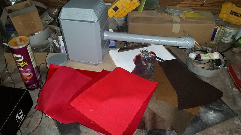

I've been traveling for the past week or so, but that doesn't mean I haven't been making progress while I was on the road. Admittedly, most of it amounted to shopping and waiting for the mail. Still, when I got back to the shop the other day, I was thrilled to find these beauties waiting for me:
That's a raw cast Mjolnir kit from the RPF's very own JUSTINIAN. (You can read the build thread here: LINK) It's a gorgeous kit, so if you're thinking of getting one, hurry up and buy it now. The rest of the new stuff was the wide array of sample fabric swatches I picked up from fabric.com.
After looking at all of the swatches in a variety of lighting, here's my final fabric selections:
From left to right: the lower leg wraps, the rear/main skirt, skirt front panel option A, skirt front panel option B, and the cape.
