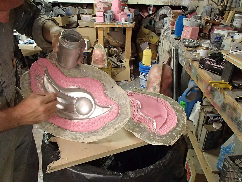

Yesterday I had one of my young helpers in the shop and I set her to work mounting the body of the helmet for molding:
When my friend Sierra stopped by looking to tinker in the shop, I put her to work building a clay wall for the wings:
At the end of the day, they'd both done a great job:
Once they'd taken off, I set to work mixing and pouring silicone:
After letting it flow over all of the parts, I used a tongue depressor to ladle it back up onto the top of each piece, taking extra care to work out any bubble that were winding up in the undercut areas below the eyebrows:
Here's how the three parts looked by the time I quit last night:
Today I'll be thickening the molds and adding registration keys. Tomorrow I'll lay up the mothermolds and get started on the 2nd half of the molds for the wings.
With any luck, I'll have a wearable copy of this helmet by Tuesday.

Back to the subject at hand, after scraping off Carl, it was time to start making mothermolds. I started with the wings. Here they are with the clay peeled back and smoothed out to prepare them for fiberglass layup:
Then I built up a clay mohawk to serve as a parting wall on the main body of the helmet:
And laid up some fiberglass:
Then more fiberglass:
The morning after, everything was cured and I set about removing the clay from the other side of the ears. This is when it enlist the help of some bored teenager:
The other side was made pretty much the same way:

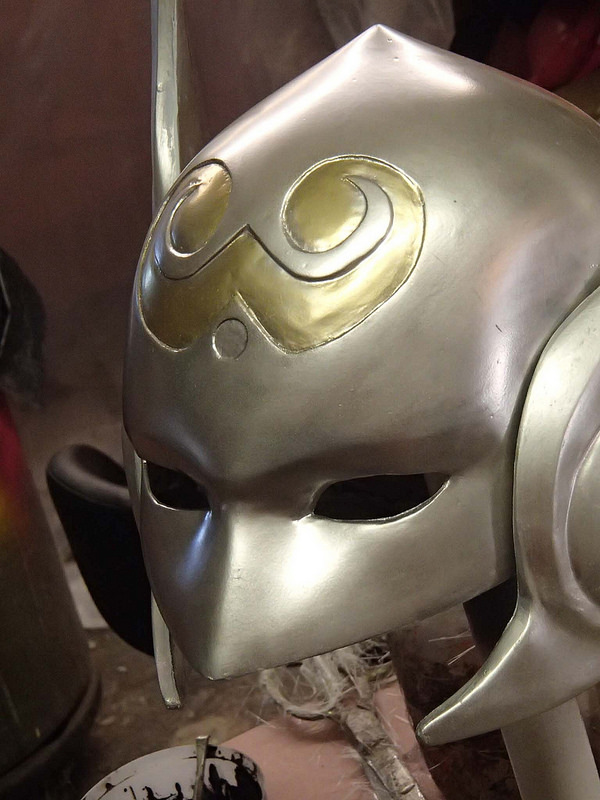

No, internet voice I've added to this post to make it more interesting, it's not painted. Instead, I dusted the interior of the mold with a metallic powder:
The main color was called "platinum" and the forehead inlay detail was "fine brilliant gold" or some such nonsense. In any case, after trimming out the eye holes and cutting the excess off the bottom edge of the main body of the helmet, the raw cast parts come out like so:
Here's a closer shot of the surface:
That's the second casting. The wings at this point are just held on with some double sided tape. I'll attach them more permanently after I've had a chance to paint them.
