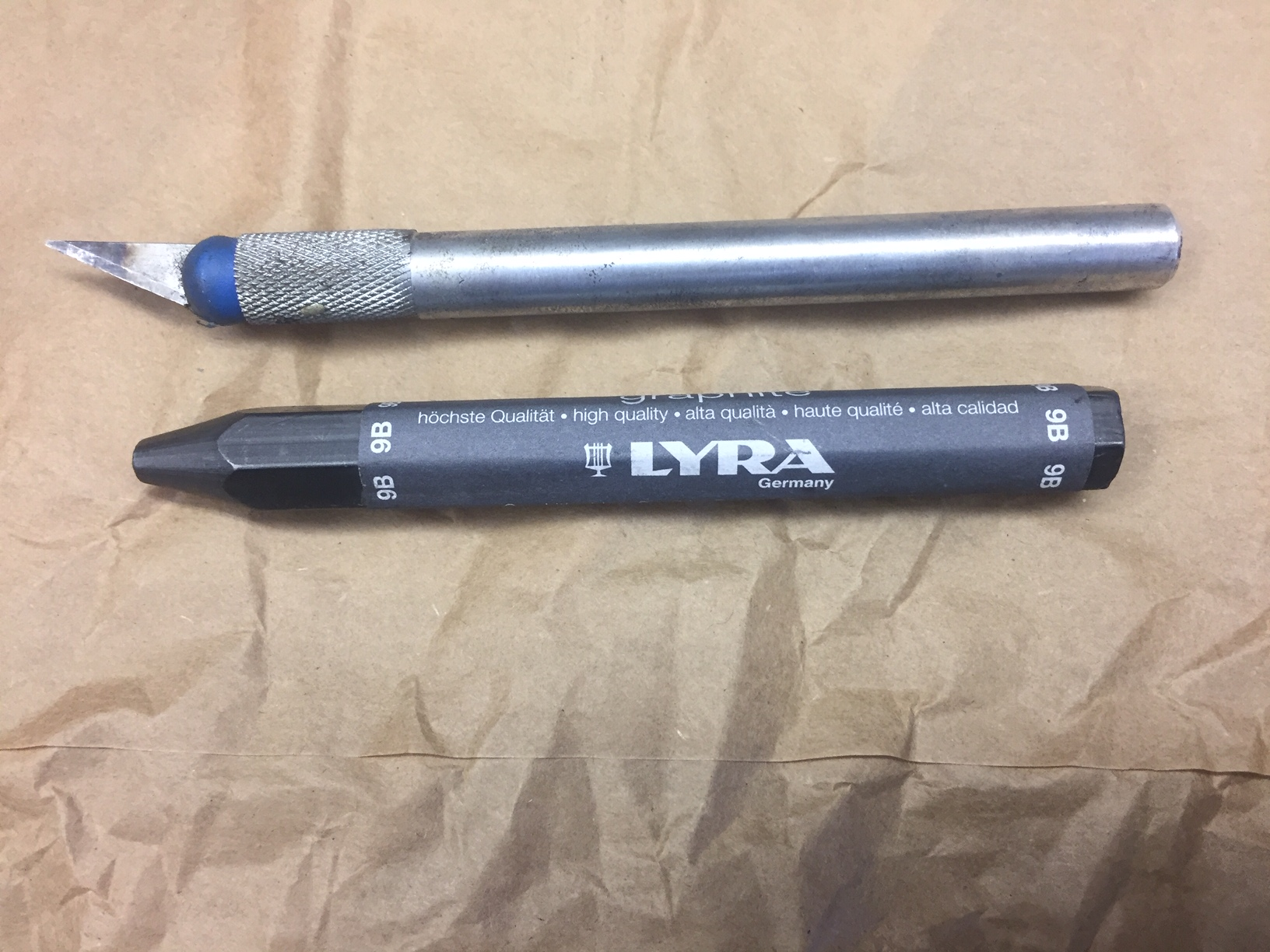

second, I am convinced to try the graphite powder over flat black trick. That looks amazing. I’ll have to test, but I have a matte clear that usually doesn’t cloud the color.
May I ask what particular graphite powder you used? I assume a super-fine grind, which I have (just not enough for the intended use) and a larger flake version.
Thanks in advance!
Hi ID10T,
Thanks for the kind words. I appreciate it. It was quite the job but worth it in the end.
Actually, when I went to my local art supply to buy the graphite powder, I saw they wanted $44.00 for a small bag.
I decided NOT to spend that much so I bought a graphite pencil for $1.63. I simply used my Exacto knife to shave it down into a small pile.
Using an old soft sock, I dipped into the pile and rubbed it on the gun.

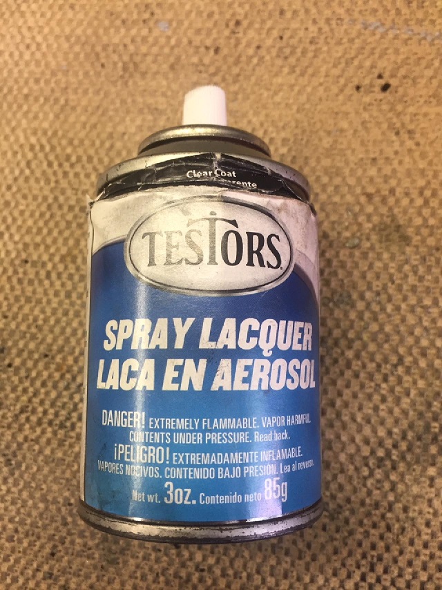

After that, I sprayed it with Testors clear Lacquer and let dry. --Ed
Nice. I’ll have to look for that (solid graphite?) pencil next time I’m in the art supply store.
I already have some powders for o-ring lube, so I’ll try them first.
Was the lacquer the “dullcote” lacquer?

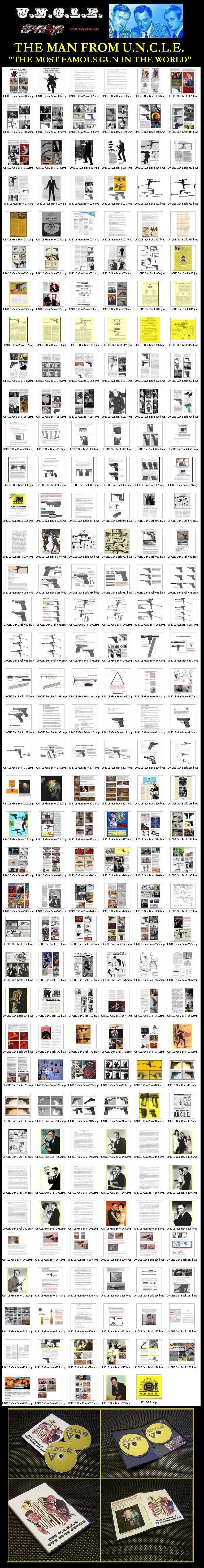

This is to show you thumbnails of the various pages of the booklet I put together. I was lucky enough to get to know the people who actually owned the original guns, as well as other props, from the show.
--Ed
I just KNOW this is a FAQ but do you sell that CD/book? Sorry if this is an annoyingly repetitive question (ARQ) :)
For those interested in the U.N.C.L.E. pistol, you can not find better information
then the CD from ed-209. I have gone through the info. again and again and always
catch something new.
