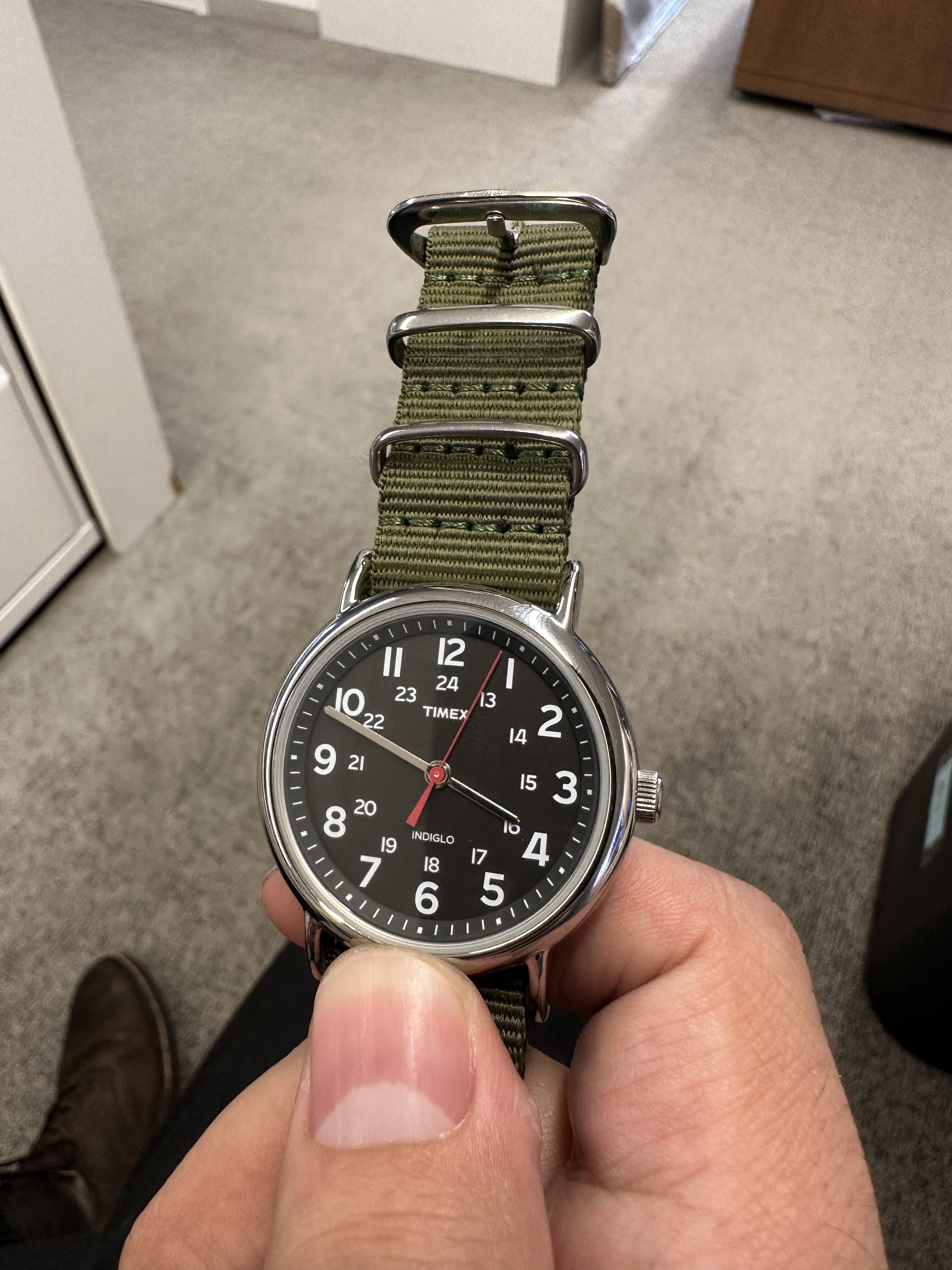

Nothing new, but I finally got the Timex Weekender 38 mm in hand with the Amazon strap referenced.
Can definitely say this is the one! Can’t wait to start modding.

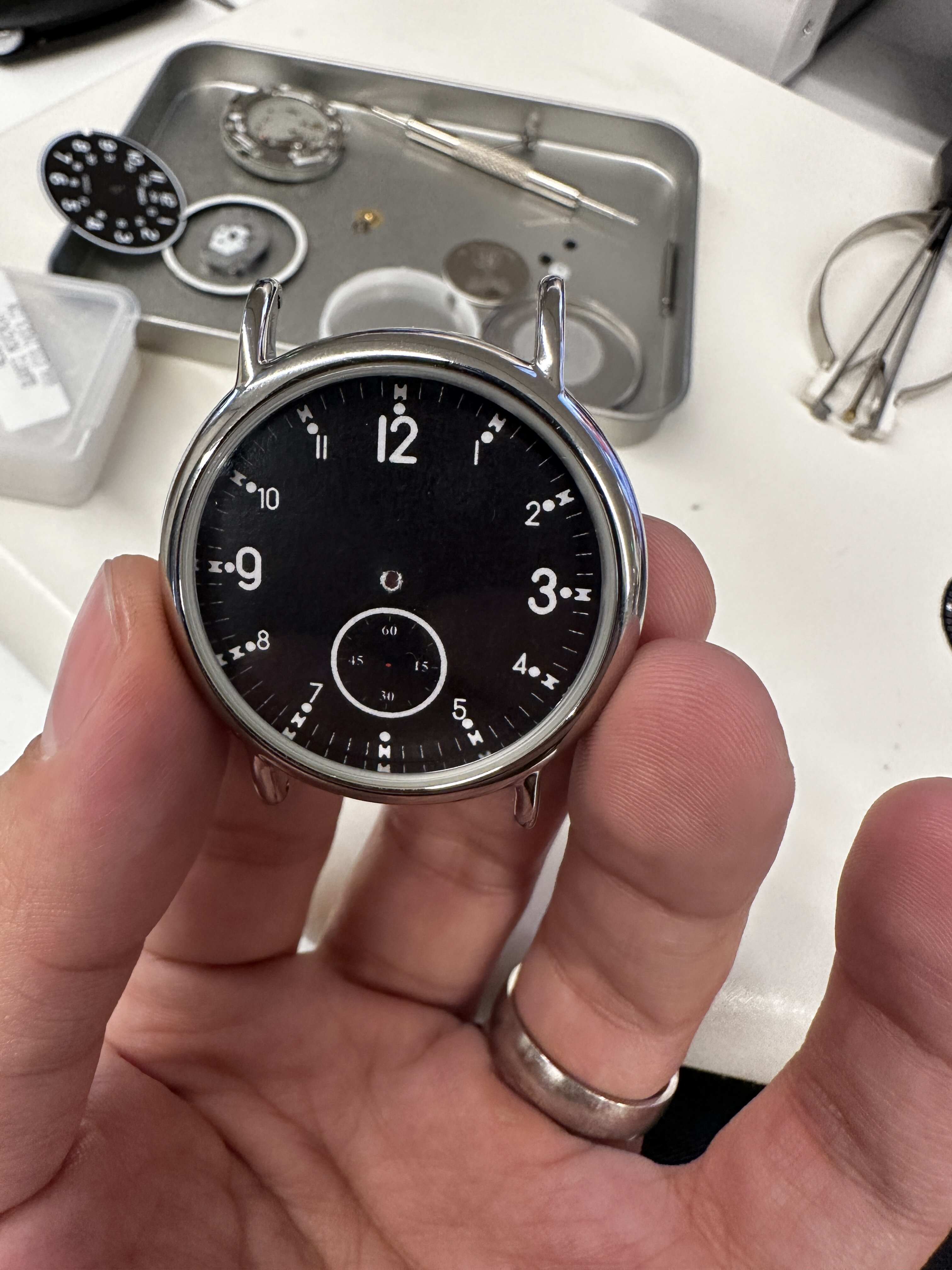

The raised ring around the edge comes off pretty easily. Any leads on an etched dial?
Oh yeah I was worried about that ha.
So actually, the laser etch plate is still a little smaller than what the dial is.
Can you upload a photo of the dial size width with a caliper?
I’m trying to see if I can just get the birthday hands 3D printed with resin. I need to measure out the hands though.
If anyone is really good with making .stl 3D models we could make the birthday hands!
Remember, the holes for the movements are minute hand (.70mm) and the hour hand (1.20mm).

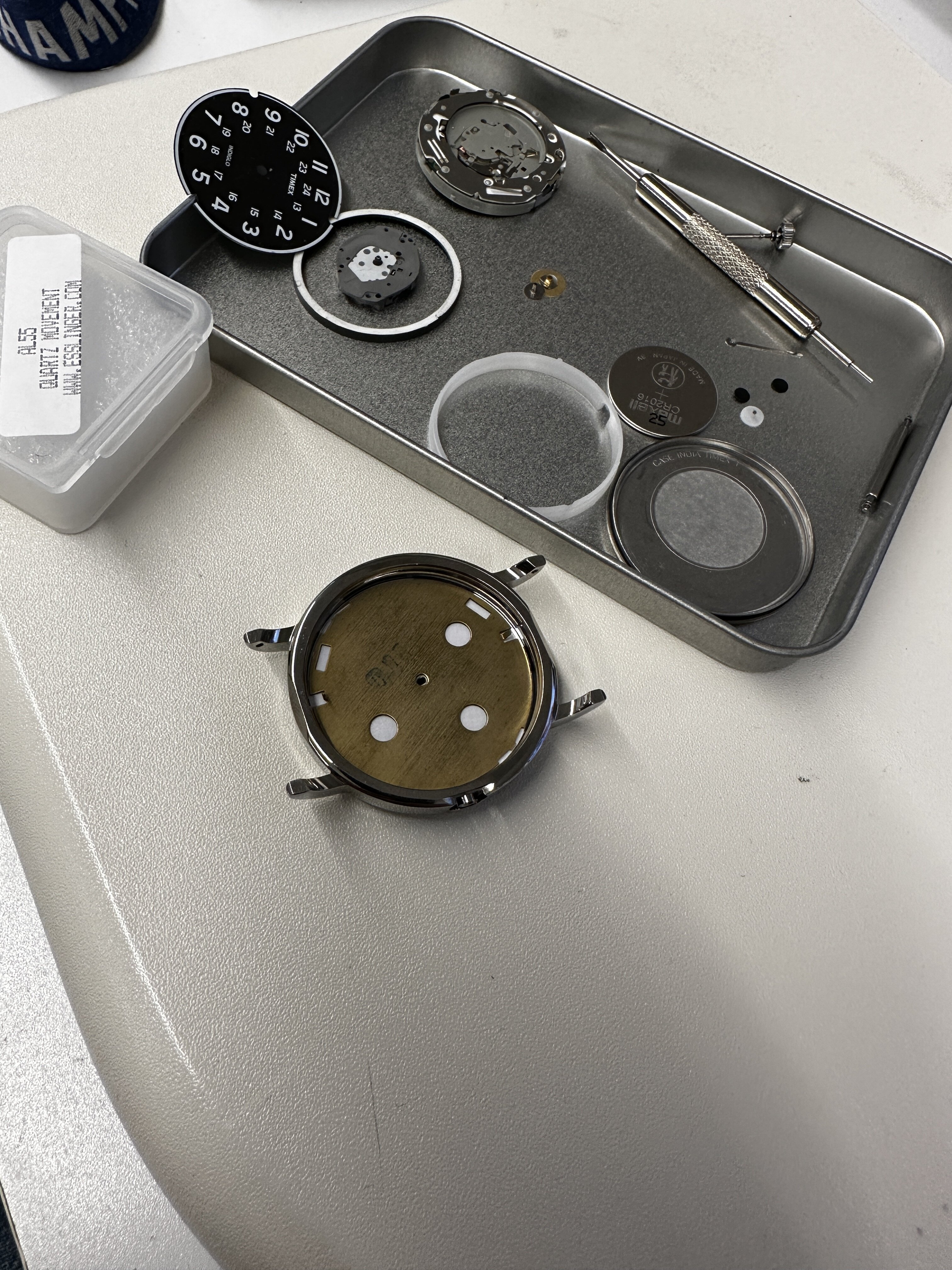

I just realized something. Once you remove the movement, and then the face plate of the dial, you can't just throw the movement in lol.
You have to get a movement holder, BUT, I have no idea where or how to get one for the movement in question.
Does anyone know what movement holder could the AL55 fit in inside the 38 mm Timex Weekender?
I can't believe I didn't think about that last screenshot. WELL DONE.
I was surprised we didn't get it sooner!! But that helps so so much. I found a guy who does custom watch movements holders, but it costs a little..... If I can pay him for the .stl file, I can 3D print my own lol, and then send them to you guys.
