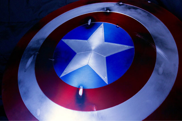

Thought id post up pics of mine. I finished it up last year.
I ended up engraving my star directly into the shield. ImageUploadedByTapatalk1437956070.567428.jpgImageUploadedByTapatalk1437956130.943271.jpgImageUploadedByTapatalk1437956251.378126.jpg

Great job! How'd you do the engraving?
Thanks. Nothing special.. I just cut a piece of metal into the star shape, bent it into shape, then I just scored the lines over and over using that as a stencil until they were deep enough, did basically the same with the inner star and then used a dremmel to do the rivets at the inner points. Then used a scotch pad rubbing with the grain to smooth it all out.

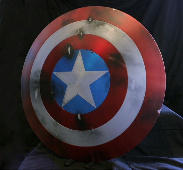

Completed another shield a few days ago my old one was looking a bit battered from events and parties so decided to battle damage the new one. I also have a child sized one ready to start!

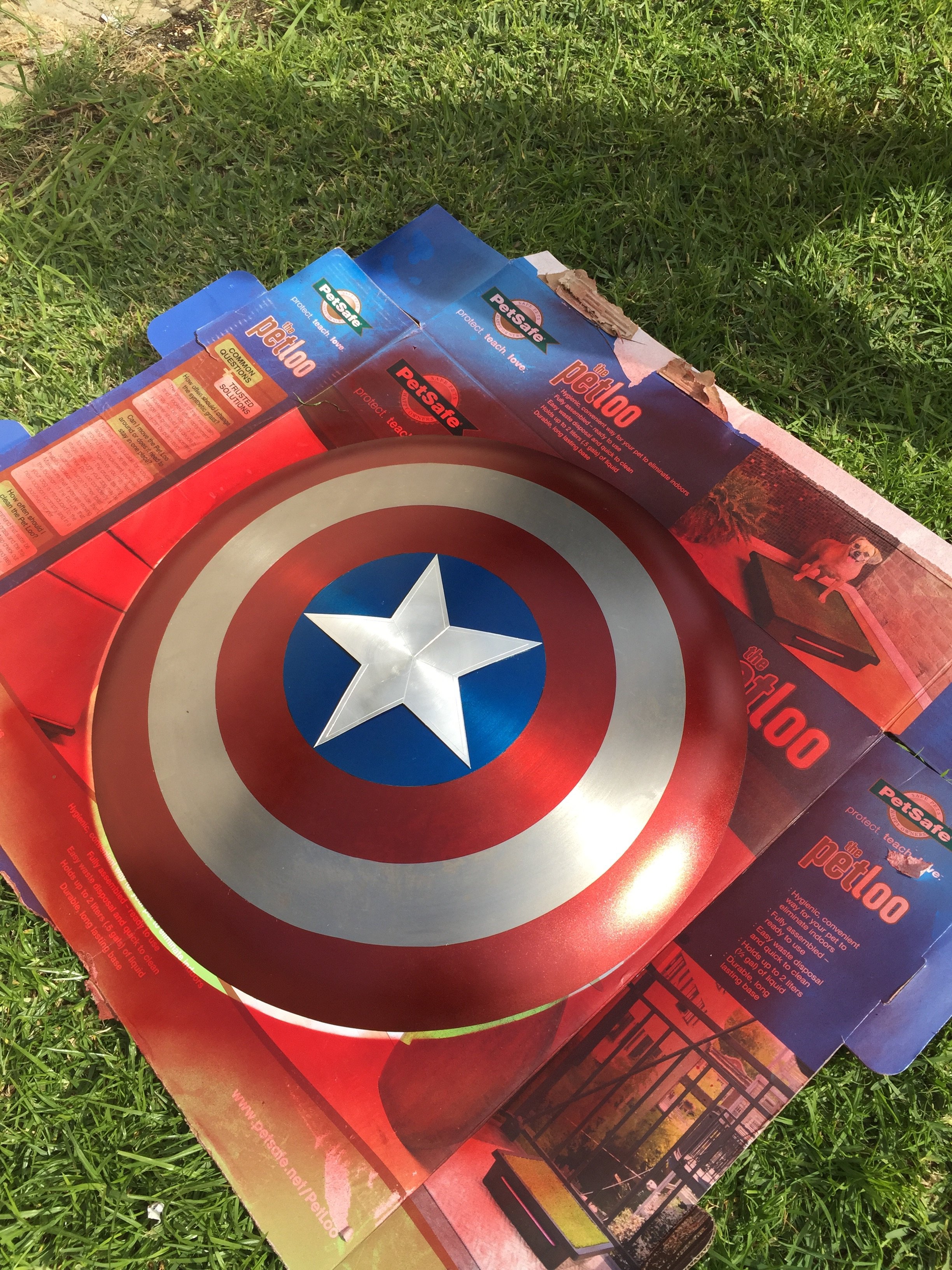

As per the picture I attached, my brushed Aluminium star has turned out a lot brighter than my steel ring and I want to know of any suggestions to either dull the star or brighten up the ring to get them somewhere closer to each other.
So far the shield currently (Which is accurate to the time the pic was taken) has had 2 light and a medium to heavy coat of Rustolereum Gloss clear coat.
  • Does the shield need more clear coat?
  • Best technique for wetsanding the clearcoat? Then buffing?
  • Do you clear coat the star (not attached yet, to be JB welded on after I'm finished with the shield)
  • How to dull the star or shine the shield?
  • Do you clear coat the back of the shield? If so do you leave a spot for the mounting tape like you did with the star?
Thank you rpf'ers

Thanks vinxero, I went with the gloss just to try and match the star but it is still much too shiny for the ring.
Ps love the plastidip idea just to do battle damage but be able to go back to clean.
Unfortunately you won't be able to brighten the silver ring to match the star using gloss.
Your two options are:
1. Darken the star some how (battle damage or maybe a light spray tint? )
2. Strip the shield and brighten the disk more with Scotch bright pads then re paint.
Sent from my SM-G900V using Tapatalk
Yeah that's not a bad call, I'm also thinking the easiest option is going to be to darken the star
I recon that would be perfect. I'll have to see what I can find. Being in aus we tend not to have most of the great products people used... My sleds shipping was twice the cost of the sled itself
