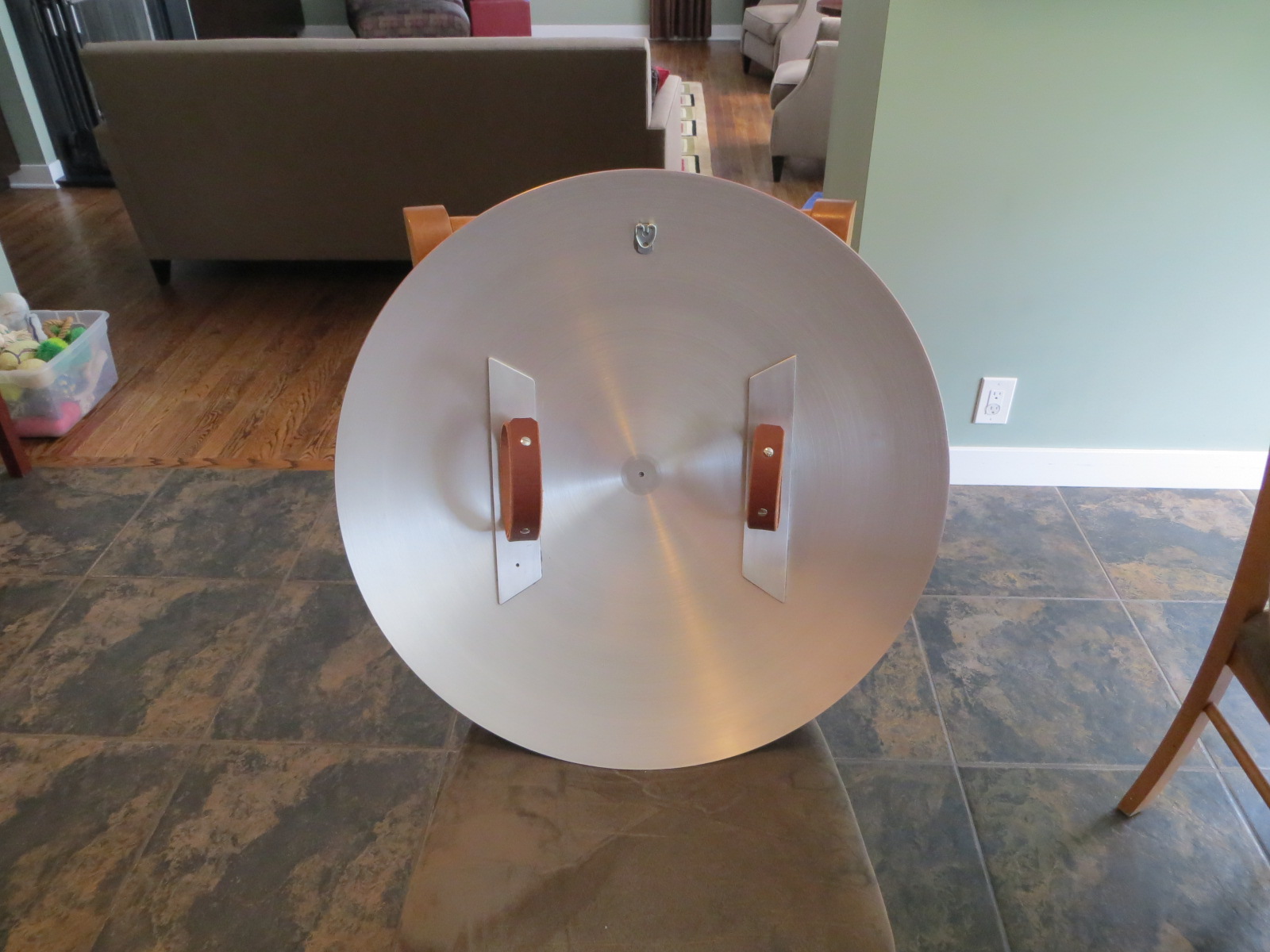

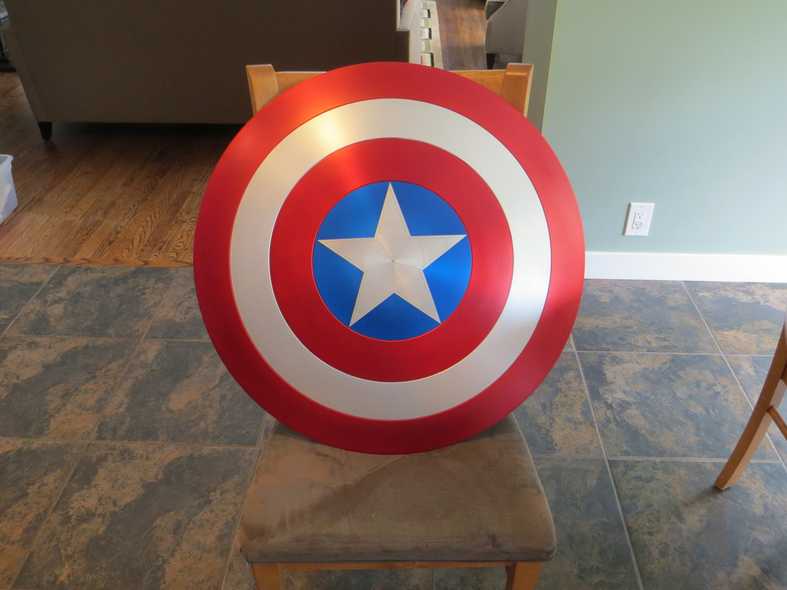

I finished my shield. Three attempts to get the paint right. Its not 100% perfect but you have to be about 5 inches away to see the flaws. I think I can live with that. Glueing the star on was the most nerve wracking part for me. I knew other that chiseling it off there was no going back. Here are pics of the front and the back. I did a modified bracket for the back, mainly because I will be displaying and not cosplaying with it. Thanks to everyone who contributed to this forum I learned a lot on how to do this project.

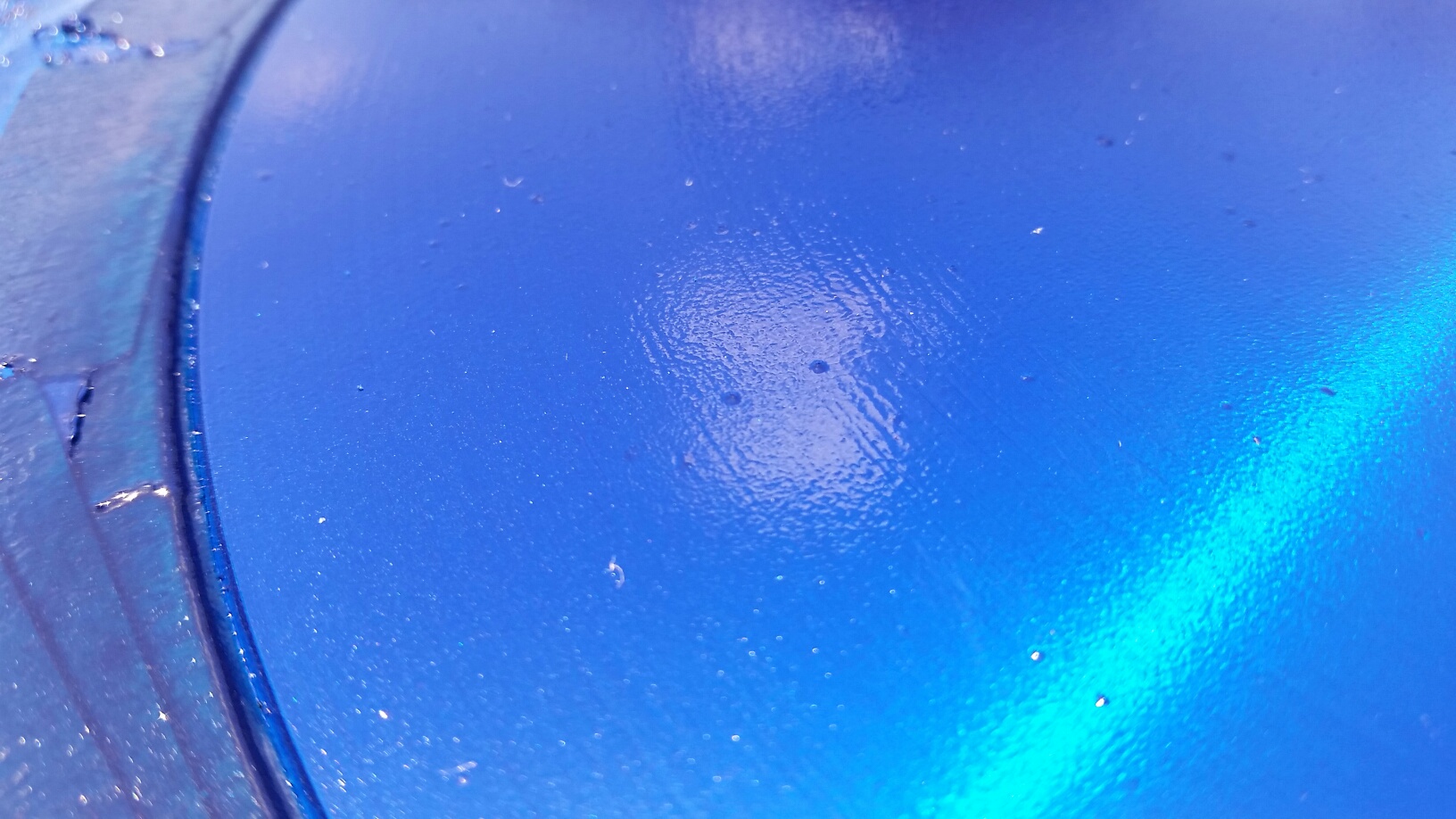

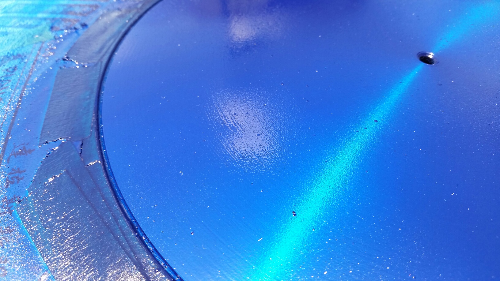

Can not get the duplicolor paint to go on the shield smooth. Did not have any issues in my test on a small paint can lid. Now when I spray it on i get particles in it. Am I spraying too close? What method should I be doing? I did this last one inside the garage. Prior to that it was outdoors. Here is what it looks like now but if you can see there are small particles that dried in the paint. Should I wet sand and if so with what grit or start over again?

It actually looks like dust particles have steered on your paint job as it was drying. That may be the case or you are spraying too far away and the paint is atomizing / drying in the air before it hits the shield
Having just finish a project for work using the Duplicolor Metalcast (purple, not blue), I can tell you that this stuff is finicky. It looks as though the paint started to dry before it hit the surface. You may have also had some dust either on the surface or get caught by the paint. I had the same problem when I did my project for work. When I redid it, I got a little closer and it fixed the problem. However, if you get too close you run the risk of putting it on too thick, so you may need to paint it faster. There is a learning curve to the Duplicolor Metalcast paint.
