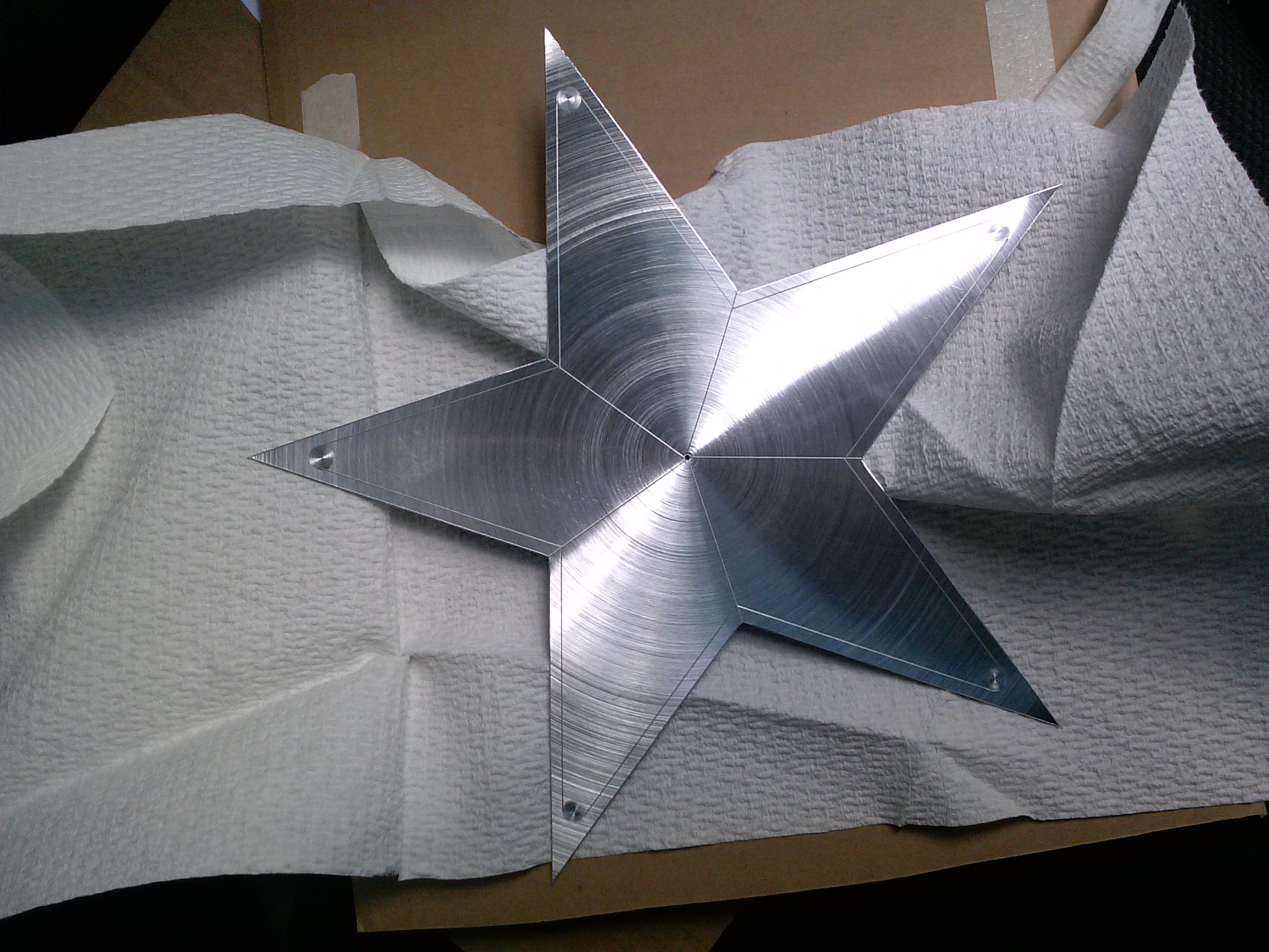

So I ran into a bit of glitch when starting to paint my aluminum disc yesterday: a small bit of tarnish or other blemish on the shield:
I'd already gave the shield a good rub down with the acetone to remove oils and get it cleaned up, but that spot wouldn't budge. For those that have painted with the Duplicator: will the paint hide that dark of a blemish? Or would I be better off doing some sanding to remove it? Or is sanding not the right thing? I've never worked with metal before so I'm not sure my approach is correct.
