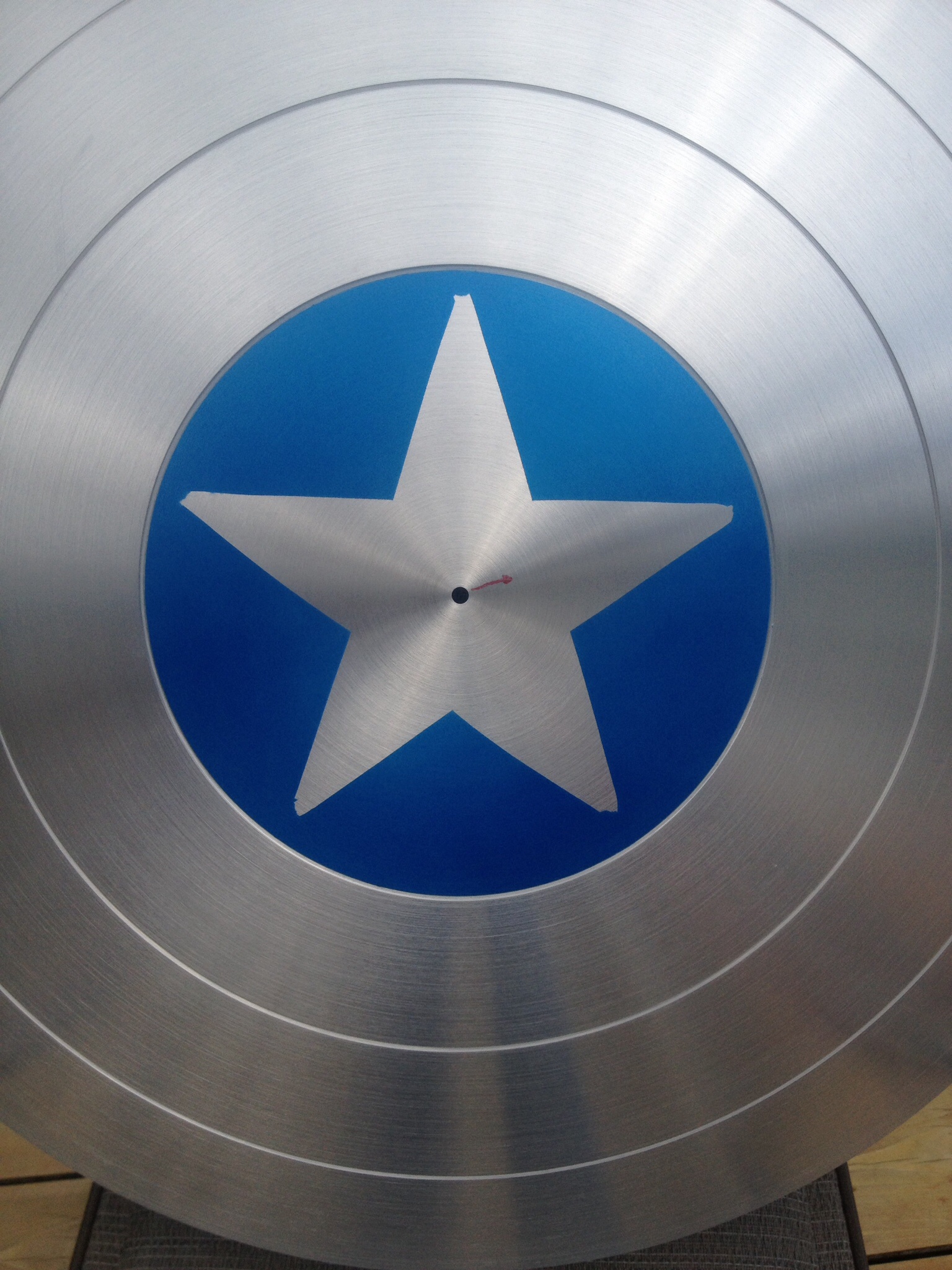

ive been reading this thread for a while but just posting for the first time. lots of great work here!! I built a shield for my 5 yr old out of fiberglass and used Testors to paint it. I really liked the hue of the colors but hated how they laid down and how long they took to dry. some parts would lay down nice and then a blobby sting of junk would shoot out
or I would get bubbles. I figured my son would smash this thing in no time so I wasnt too worried about redoing it (pictured below). for my aluminum one I decided to try Duplicolor. i painted the blue and my first attempt was a little too dark so like many on here I stripped it and tried again. my second attempt seemed great. everything laid down great and I think the color was spot on. would love some feedback on if this is the anodized look I should be aiming for.
thanks
Adam

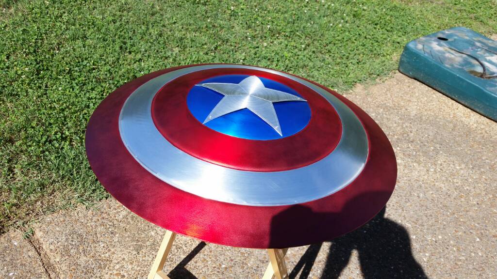

If you are clear coating your shield you do not need to wet sand your color coat. Also, if you are clear coating you don't need to worry if your color coat looks a bit flat in some areas. People who are obsessed with getting a perfectly glossy color coat need not be. That's what a clear coat is for. Trust me. All my shields had uneven gloss on the color coat. After a good clear coat followed by wet sanding and polishing. It all evens out. The important thing with the color coat is consistent coverage. It should look like the same darkness if red. Don't worry if it looks flat or even pebbly in some areas.

you out the man valor. Much appreciated for all the ongoing help
Crap. I was going to satin gloss but I've opted to use the Duplicolor gloss clear. I totally forgot about the wet sand and polish stage.

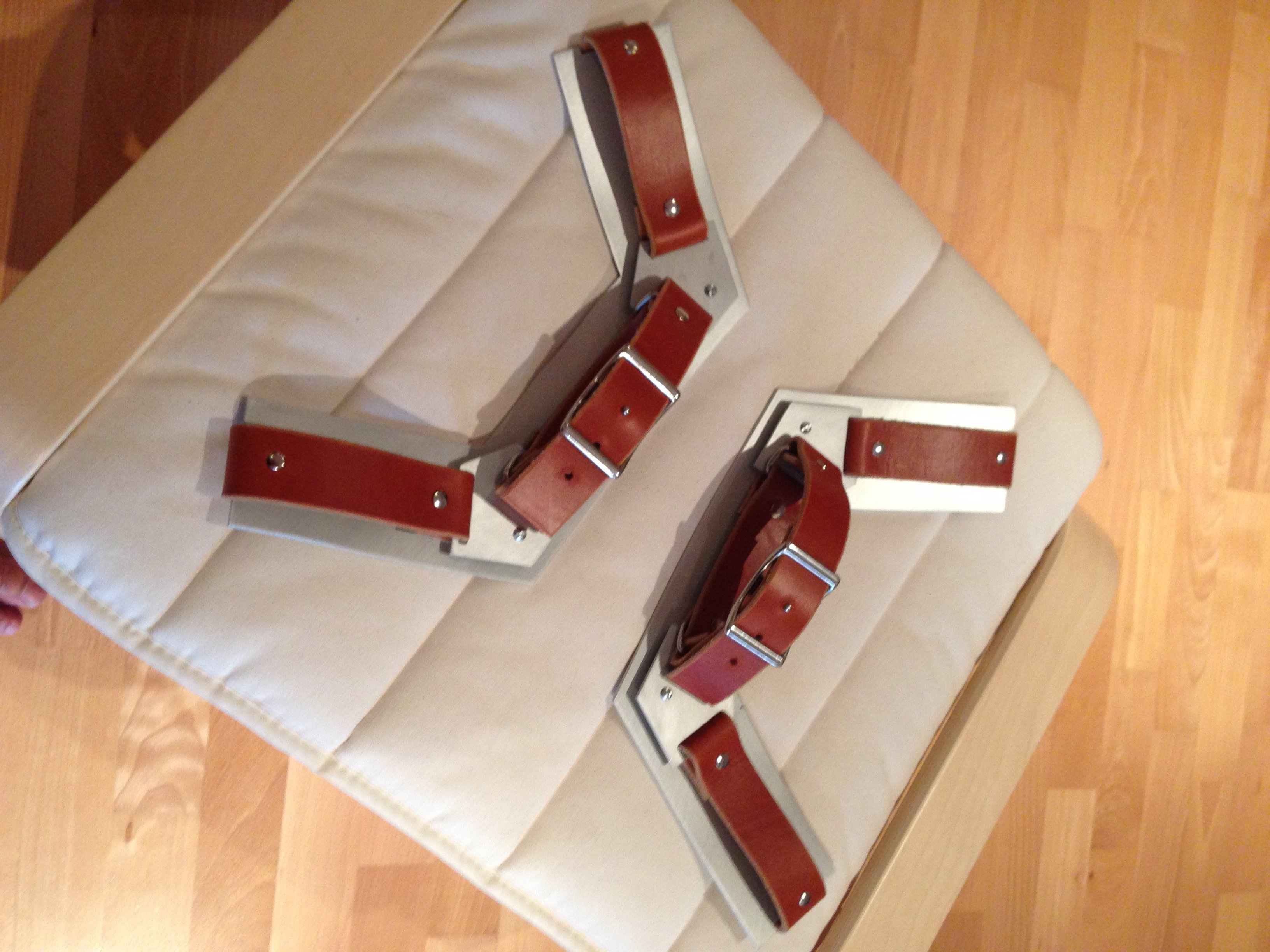

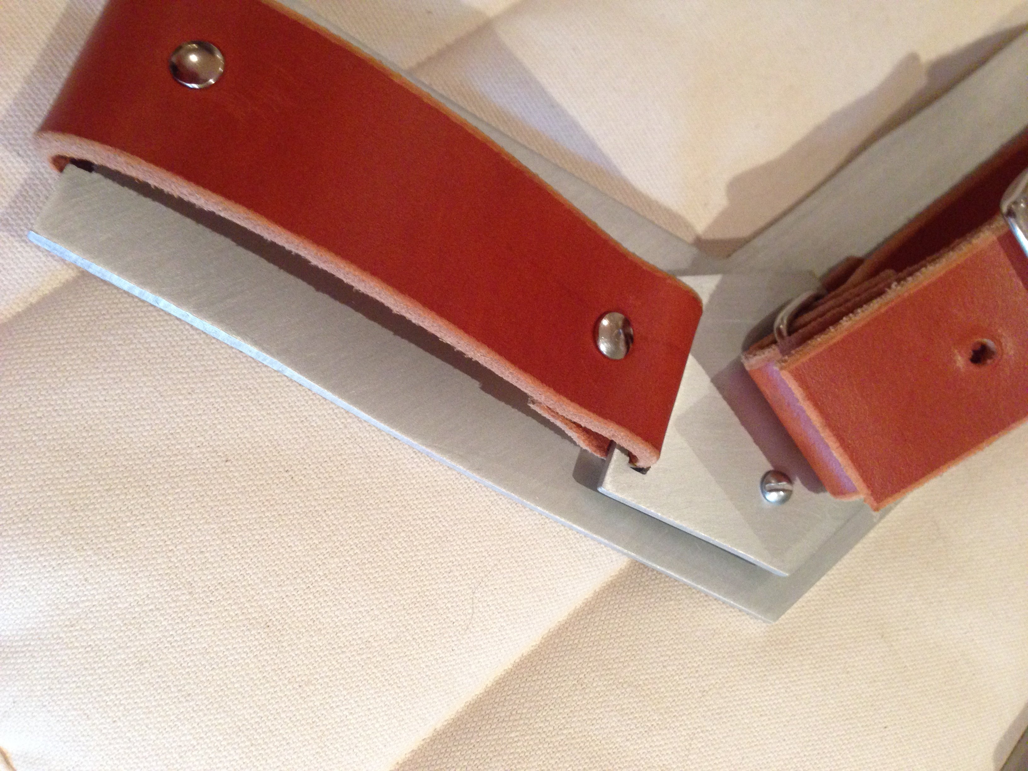

As an aside, here are my brackets, clear coated and ready for attachment:
If the outer straps look loose, it's semi-intentional. The clips are attached with superstrong 3M 200 dpi and 400 dpi velcro. They're actually a pain to pull off. The hope is that when I attach the brackets to the shield, I can detach the clips and use the entire assembly for shoulder straps =) I'll post shield pics as I do it. As is, I've stripped the shield 3 times. Can never quite get it the way I want it to look.
