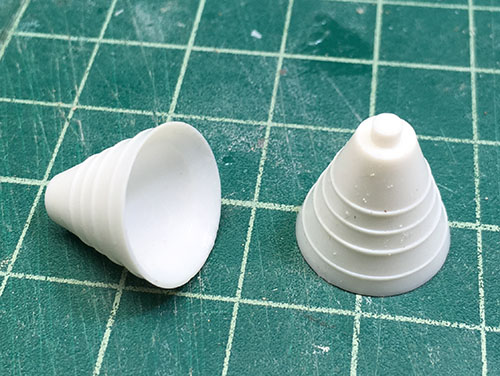

    They're not roto cast, just pressure cast in a two part mold. There's no big secret but I guess years of pouring resin creates a bit of an instinct as to what works and what doesn't. That's not to sound flippant, I'm really not sure what the trick is. One thing is to make sure not to mix too much air into the resin and I do over fill a bit, though not a lot. Since I only needed four castings I did not set up the mold with a fill channel and sprues like I did with the shrouds. Basically I pour the resin into the female side of the mold, then lower the male core side of the mold in displacing the extract resin. Then into the pressure tank. Every mold is different and has different quirks. The first couple of castings had bad bubbles around the rim until I got the hang of this mold.
    Yes, Filmtools is a good place, although they are a little pricey. Norm's is another good place, most of my stands are from them, cheaper prices, I think they are up in San Fernando now. Matthews and Mole Richardson in Hollywood are good, but a bit expensive.
