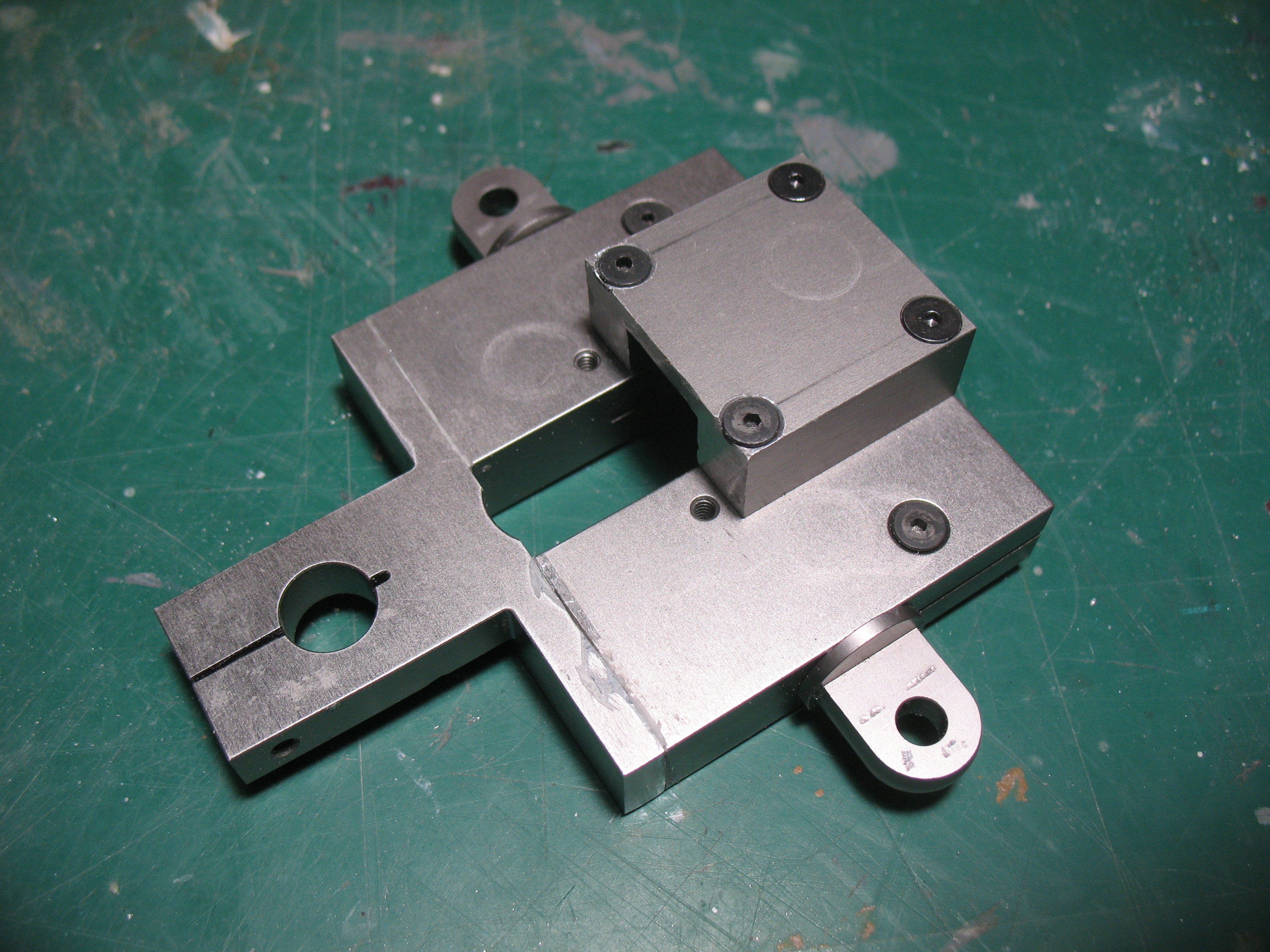

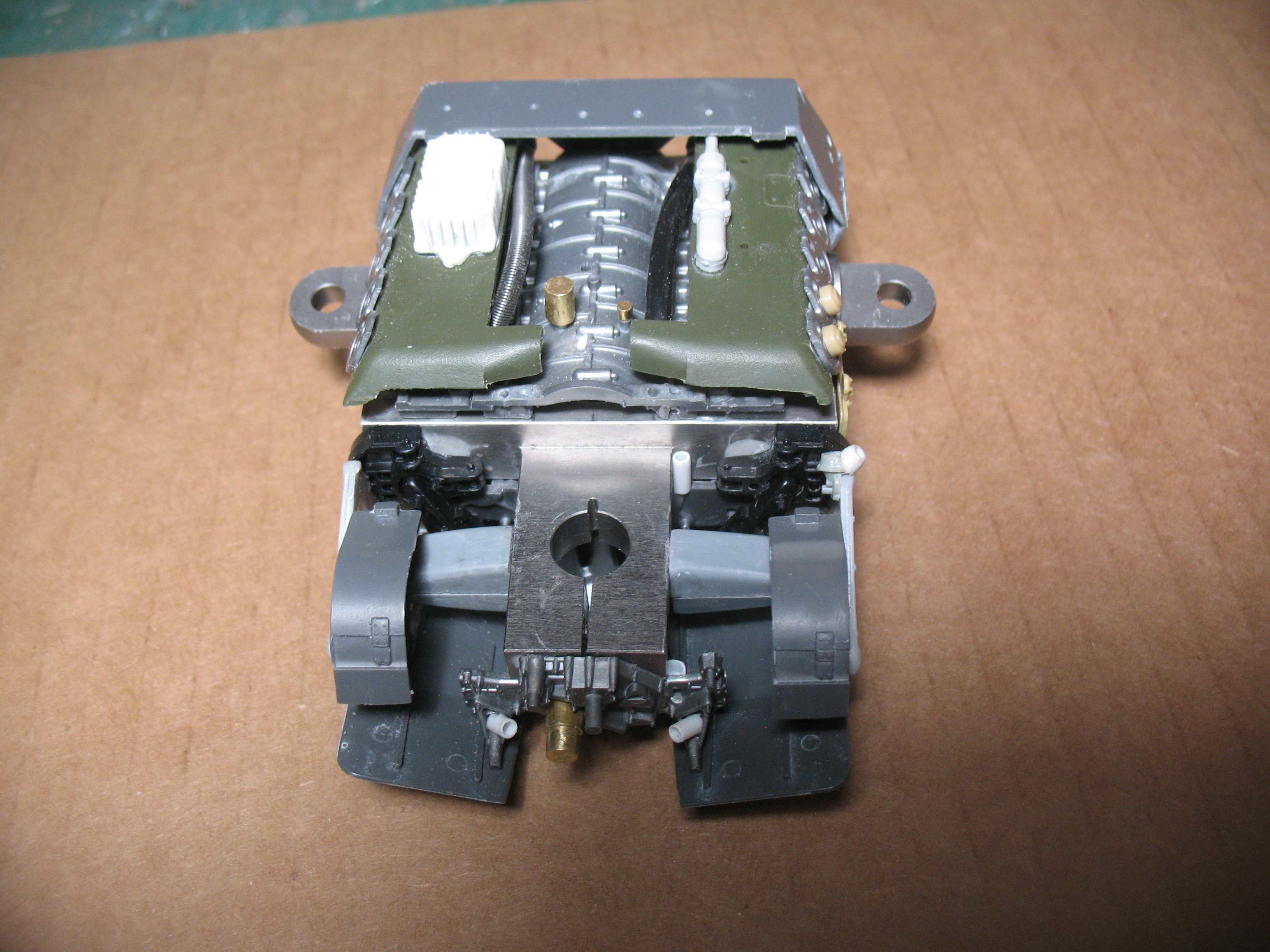

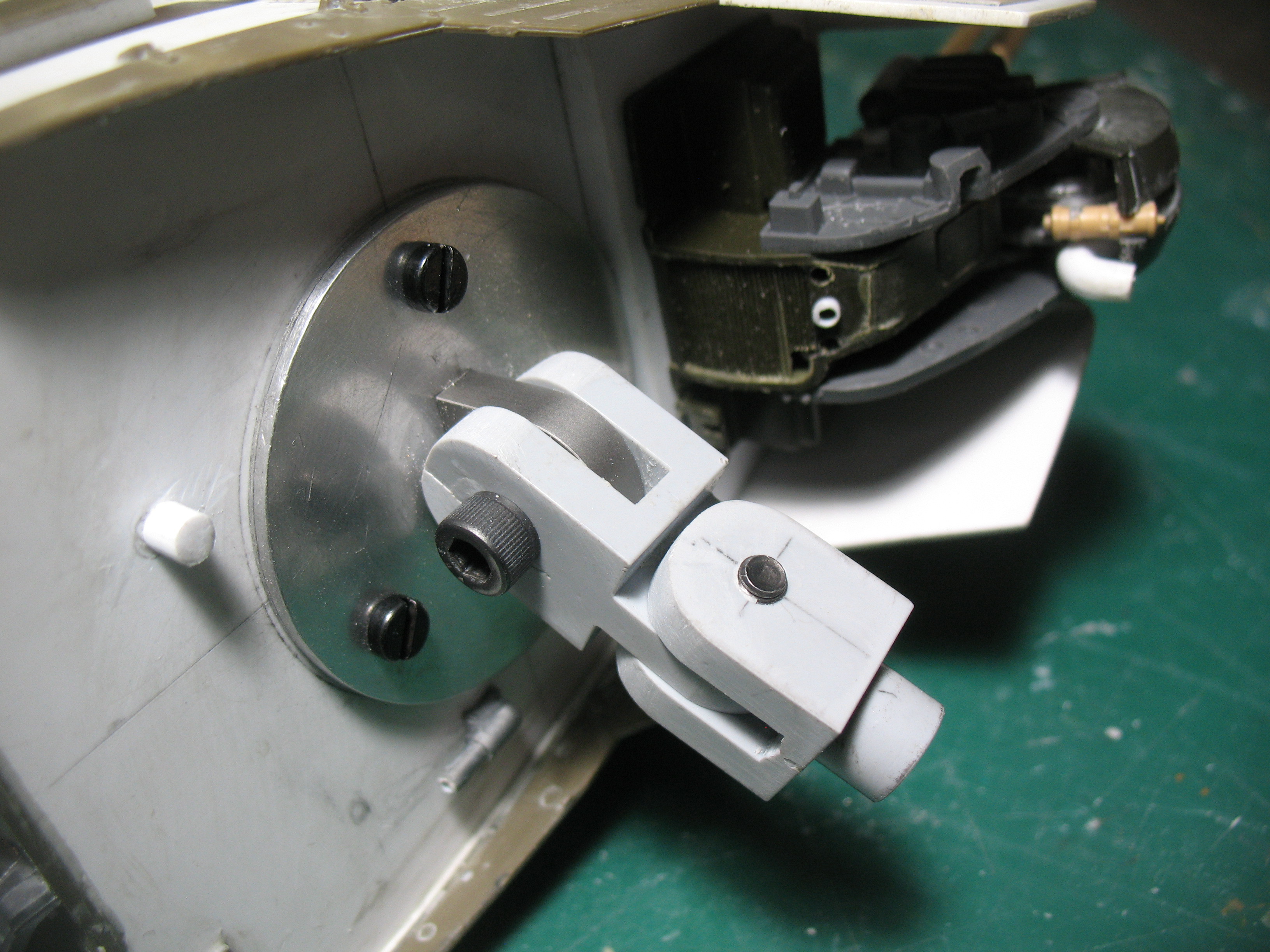

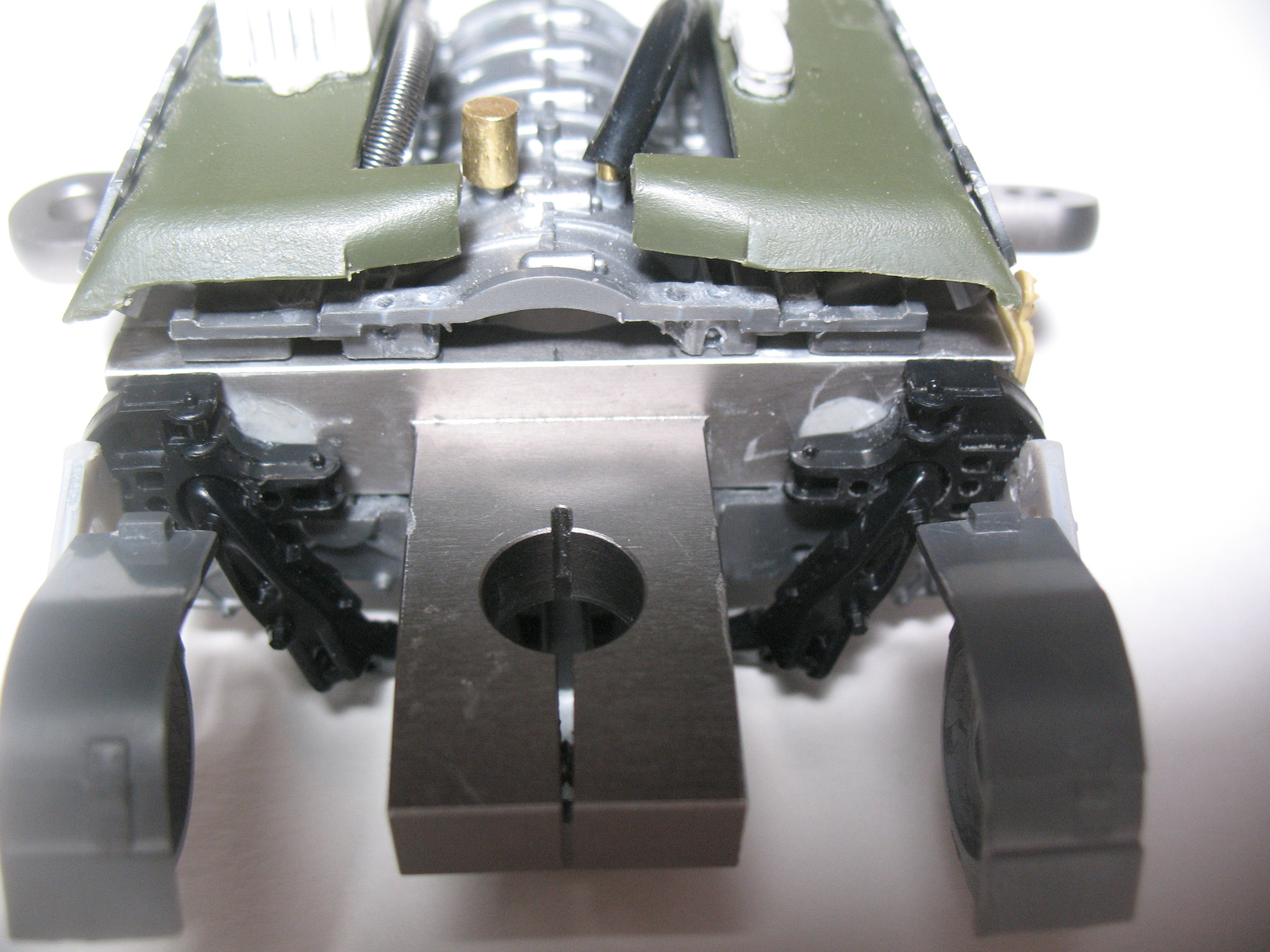

I originally made an at-st with a resin armature I made. Then I bought the Merlin armature when that became available. I was in the process of stripping it down and stripping the paint off. I used VMS Clean Slate for that. During this Jason Eaton did a video with new revelations on the build and making an announcement of a new more accurate armature. Well I already had the Merlin one so I decided to make some modifications to it. I started with the neck by making some shorter resin replacements. I then made a circular disk to attach to the head and cutting the metal bar and screwing that to the disk. After that the main body section needed to be shortened. So I cut the front off removed around 3/16 , 1/4 and re attached it with recessed screws. Finally the block in the back needed to be shortened.

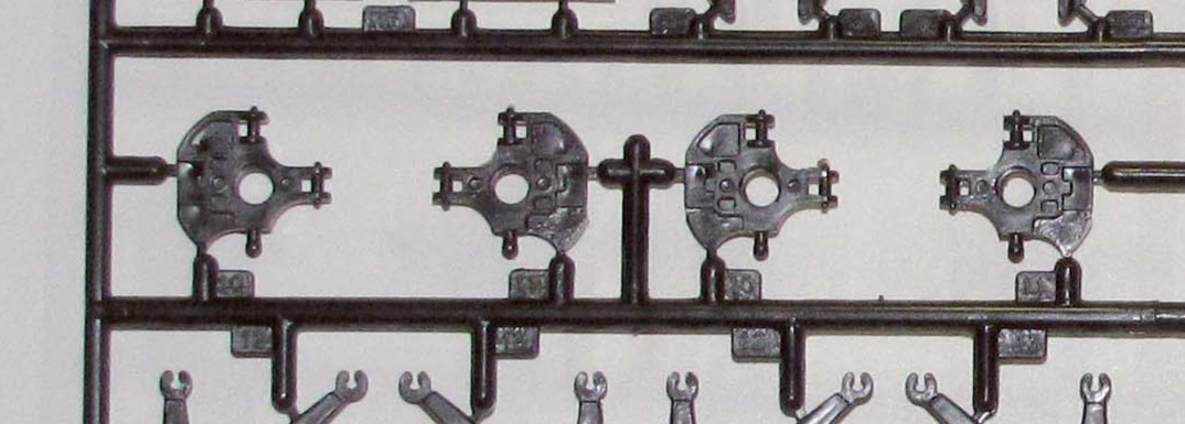

Here is an update. The black parts are from the 1/12 Tyrrell and 1/12 Lotus JPS. That bar at the bottom connecting the two Lotus parts always puzzled me. But when finding the part I was looking for in the Tyrrell kit there that bar was on the same sprue.

Is anyone willing to part with a pair of this part from the 1/12 Tyrell so I don't have to buy the whole kit for just two parts.
Please PM me if we can work something out.

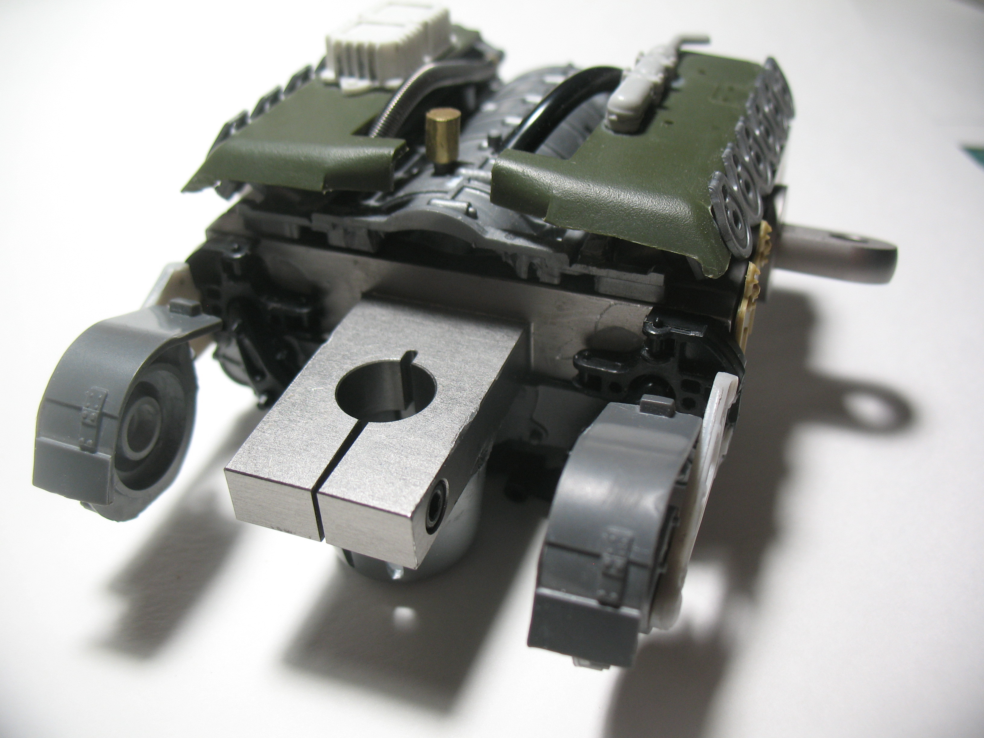

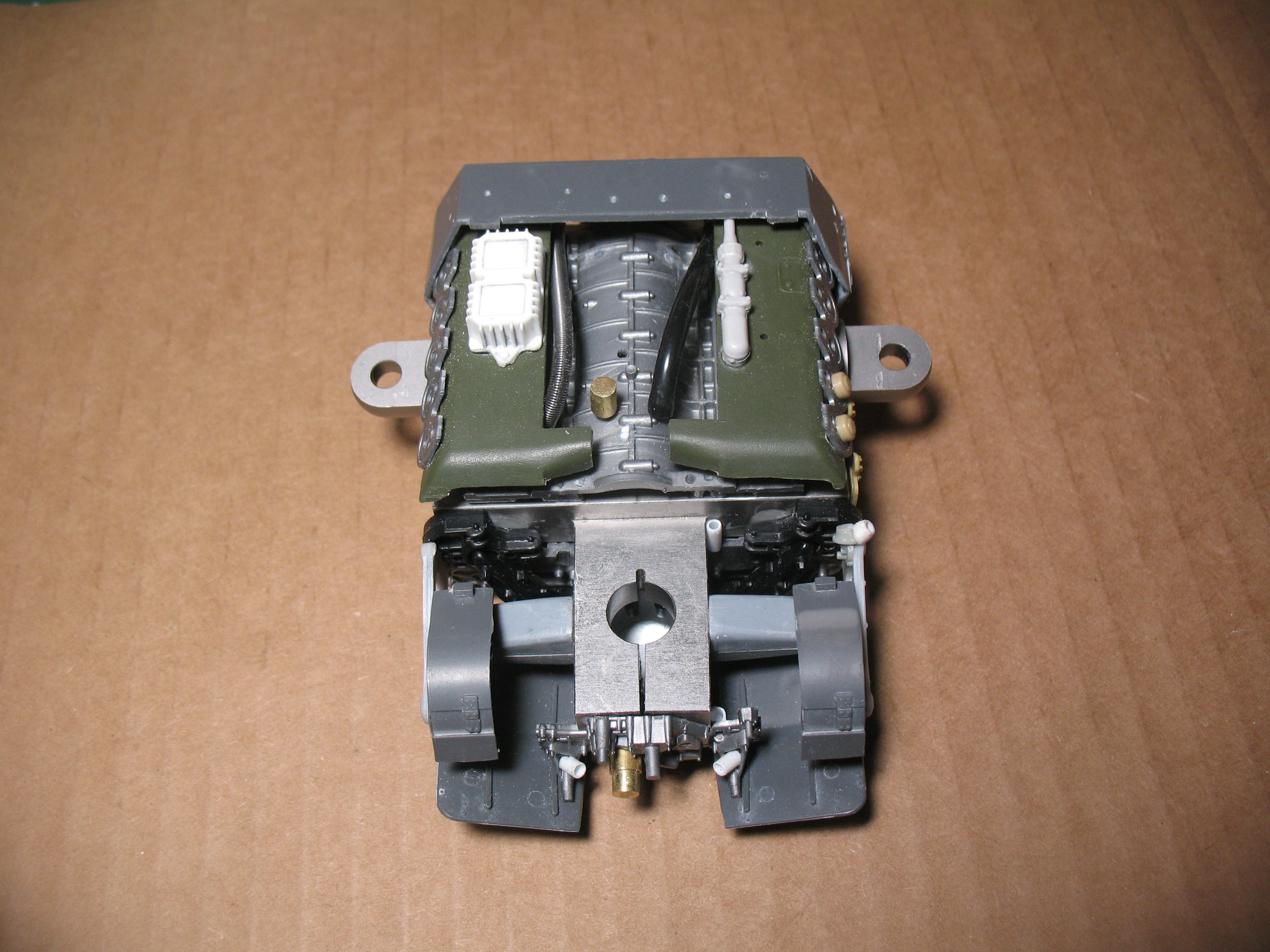

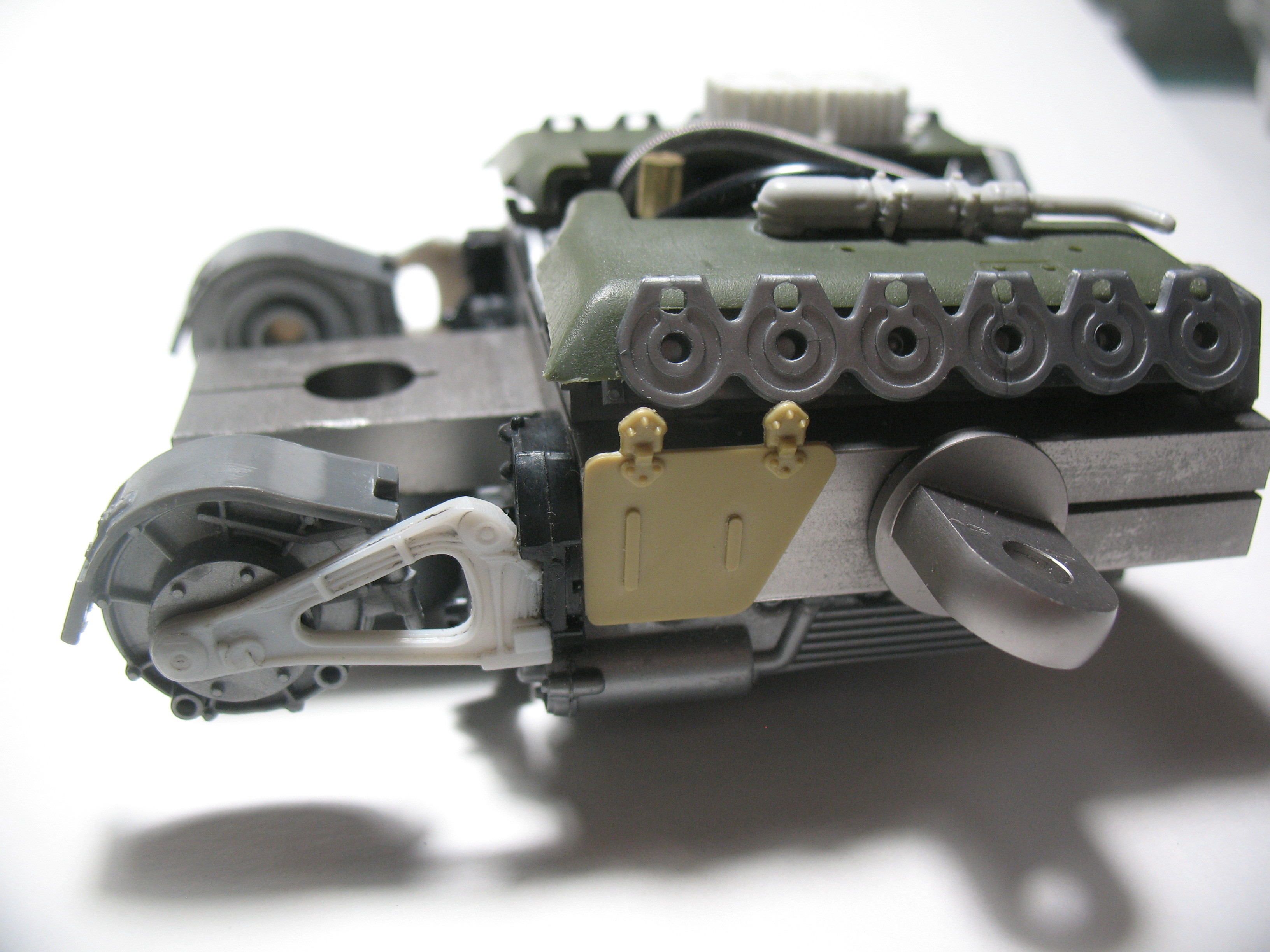

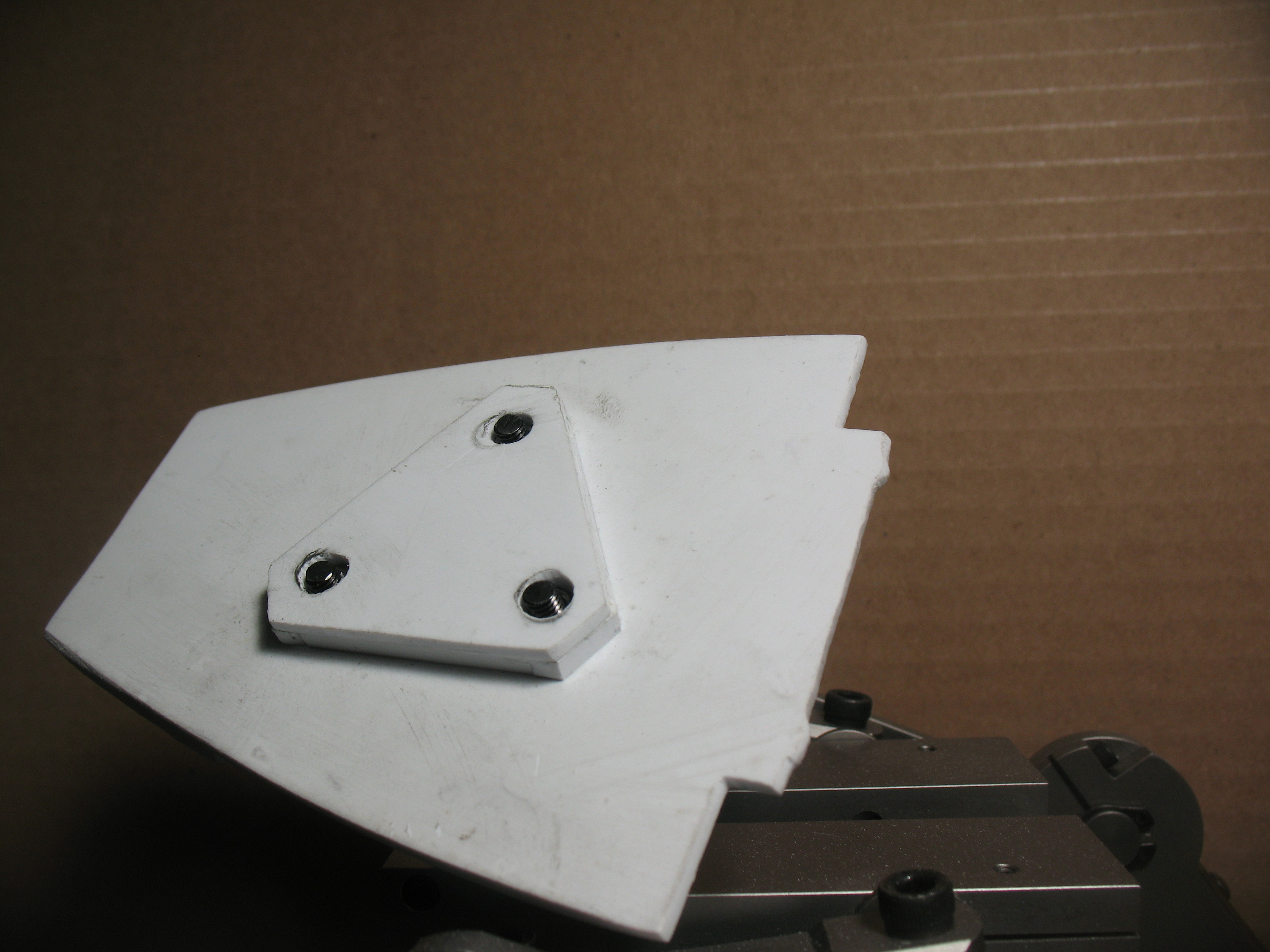

Here is the completed body. The front section has areas that are in deep shadow in the reference pictures so nothing can be seen so I kept that to a minimum and if anything better comes along in the future it can be added then. The two support triangle things going from the base of the neck outward are just some generic things I made represent similar shapes that can be seen in the ref photos

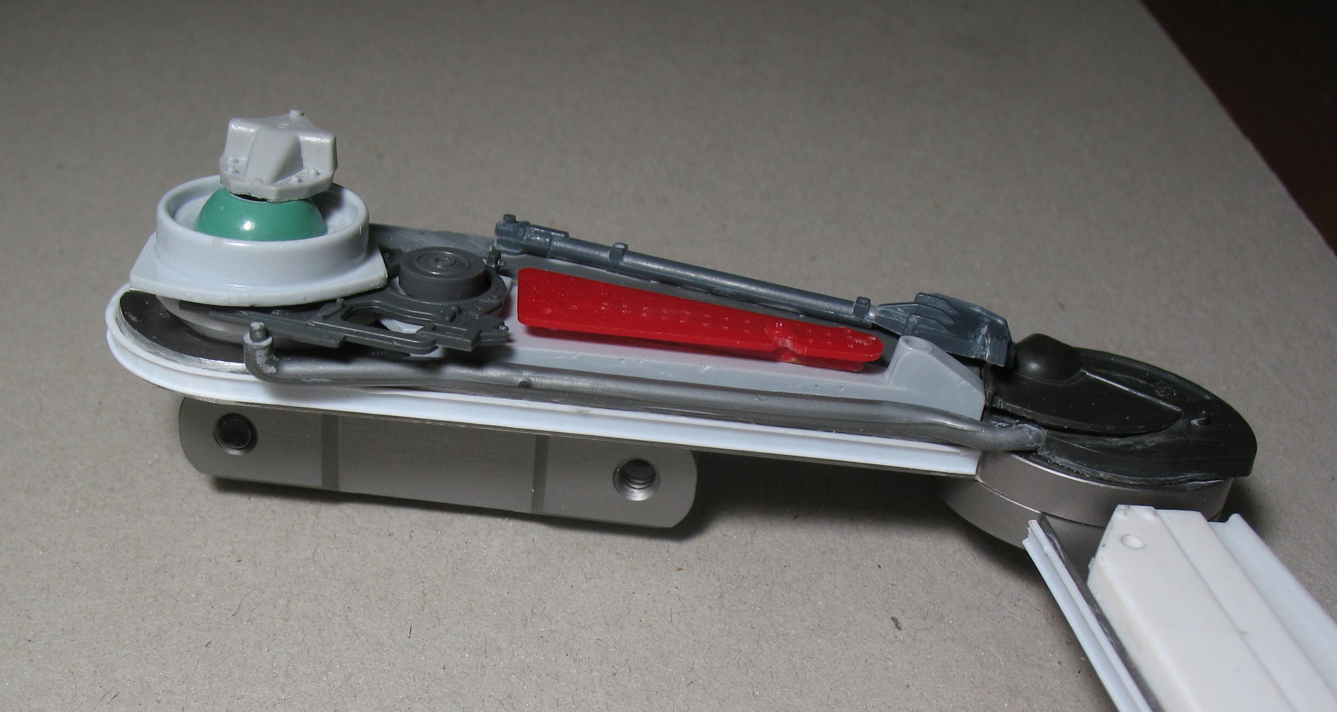

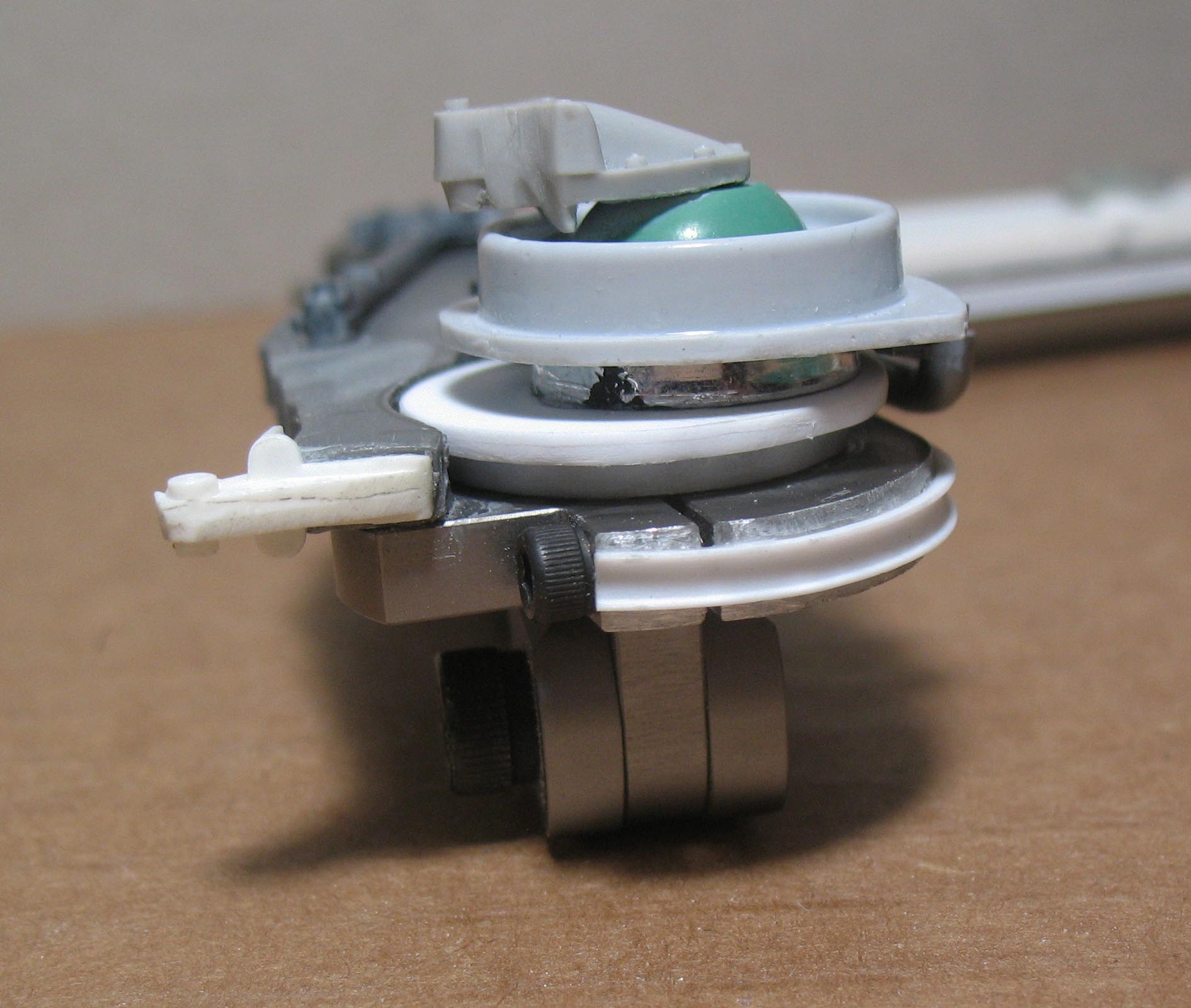

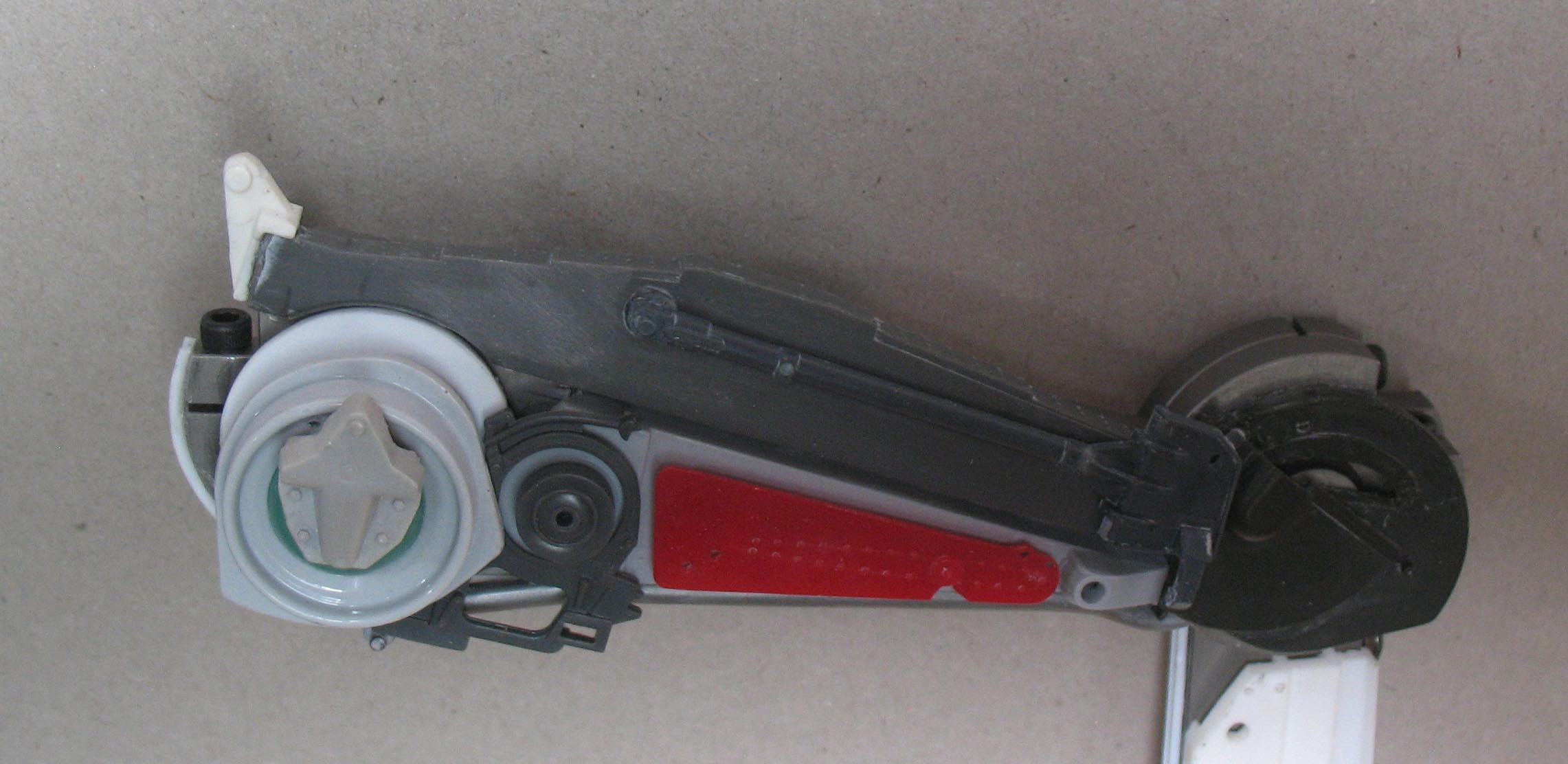

Here is the upper leg with the Jaguar parts. I found that the front part of the leg armature should be brought in a bit so it does not stick out from the kit parts but I thought modifying the front wound be too risky so I am leaving it as it is. Maybe Jason will make that correction. I made castings of the Jaguar parts and used them instead of the originals TOO pricey of a kit . The disk behind the circular jaguar part is scratch made who knows what is going on there.
