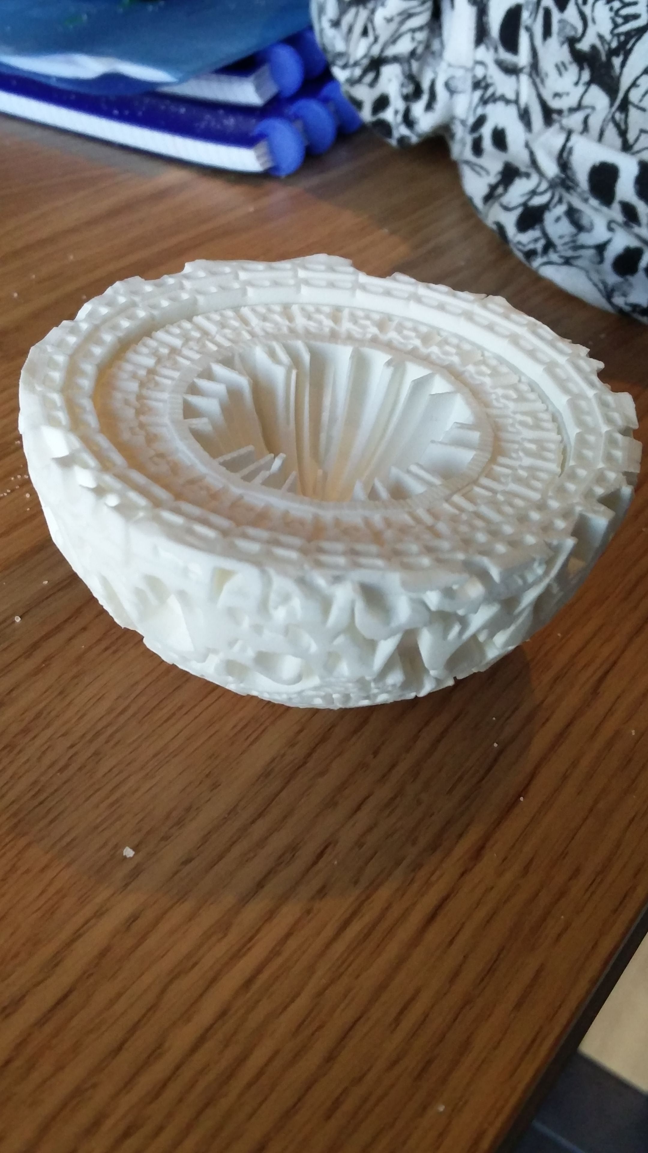

so this is my progress on the orb:
3D printed parts in PA (its a powder and its laserd so that the powder reacts and glues together verry strong and workable material)
so one half of the sphere is 3 parts an outer sphere an inner ring and and inner sphere

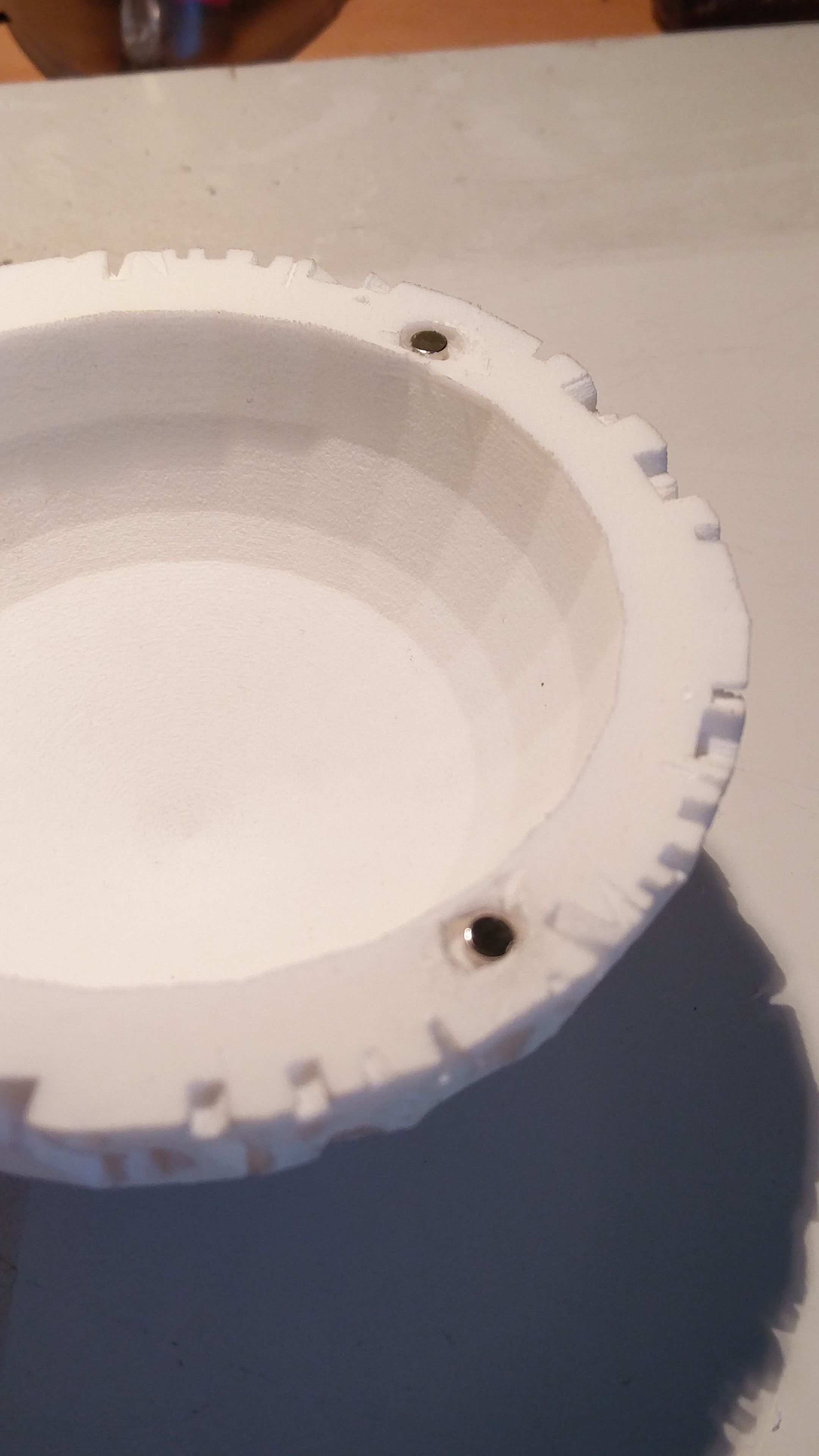

i am going to keep the orb closed by magnets witch are inbeded in the sphere behind the inner ring in the sides of the outer sphere as you can see here

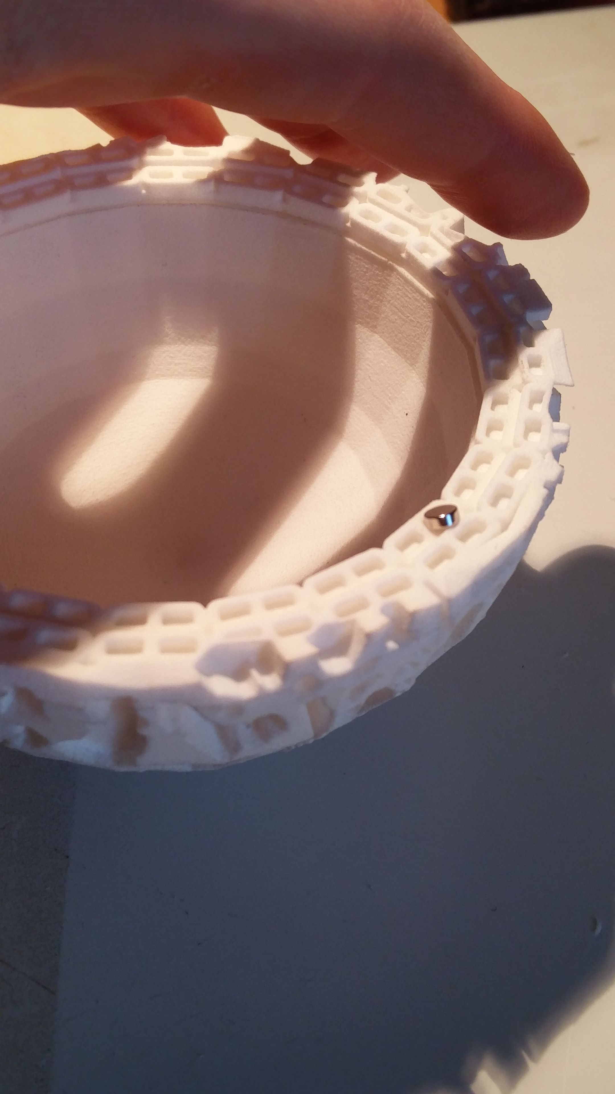

here you can see a magnet sticking on to its brother wich is on the other side of the inner ring

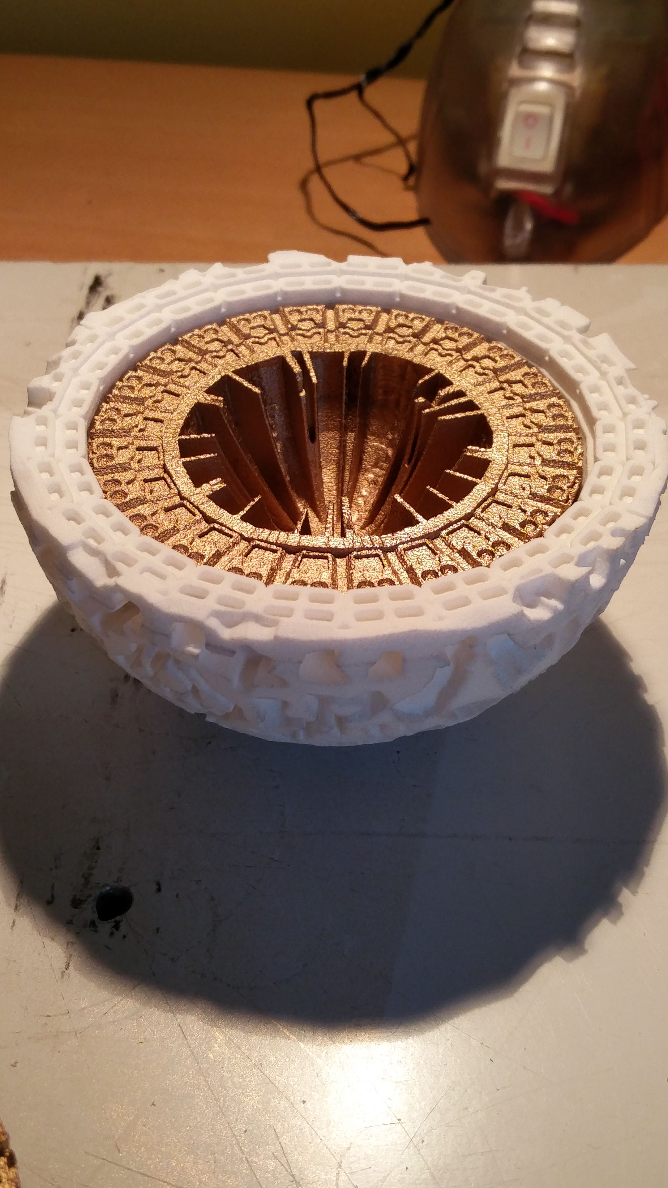

and this is on half of the orb with the inner sphere painted and the outer sphere and ring still needs paint but i am going to paint that in one go once everything is glued into place
i am still not sure about the magnets that i have
i've got disc magnets of 4mm diameter and a height of 1,5mm ( i like them because they are so small but they only have a strength of 350 grams
i also have cube magnets of 5mm and they have a strength of 1kg but i'm afraid thats a bit much
i will be using 3 magnets on every side of the sphere with 2 poles faceing the same way and 1 with its poles in the other way so that the sphere can only close in one way

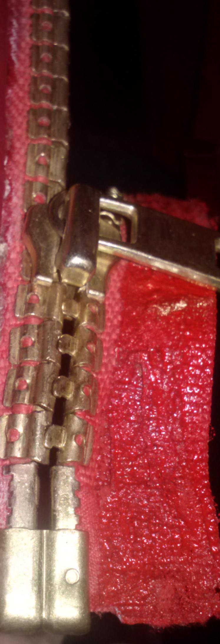

I feel I need to bring up a rather daunting quandary which has been upsetting me for quite a few days now.
It is in regards to the custom zipper needed for the standard Quill jacket. You can find them by browsing and, at last, I had managed to snag one.
While it certainly has visual appeal, I cannot say the same regarding its actual functionality. It is very stiff, somewhat thick even, metal links that are nigh impossible to zip unless all conditions are met flawlessly.
Whether it be by dumb luck or skill, I do get it in place and manage to zip it. Hardly still functional as the traditional zipper by any means, however.
And then I needed to alter more of the jacket, which required removal and now, for whatever reason, no matter how or what I do, I cannot recreate my original accomplishment. The teeth constantly run over one another, even when off the jacket itself.
I do not believe it has been damaged in any way, nor am I doing anything drastically different than the first time. The only thing I can think of is that I brought them in just a tad further (as is with the original jacket), so I hardly think that should cause such radical misalignment. It has become the bane of my existence.
Functionality wise, I can't say I'm a fan.
Does anyone have advice which will aid me?
Are you sure you got the right zipper manf?
I got it on Ebay, I assume from someone also on here months ago, nor is it that from Chinese site that was posted. It looks the same as what everyone else has that I've seen.
In any case, just from how thick the links are, it's nowhere near as versatile as a normal zipper. I must have it crooked. I'm going to try and upload a picture very soon to elaborate my problem with it.
EDIT: Pic added.
No matter how much I realign, it fastens like this instead. Incorrectly. I have measured and tried time after time, tried to straighten out the links, align them more to one another, it's always this. It worked before. I don't get why it won't fasten correctly any longer. It seems the zipper points are bending upwards with the zip, rather than inside the hole, as intended.

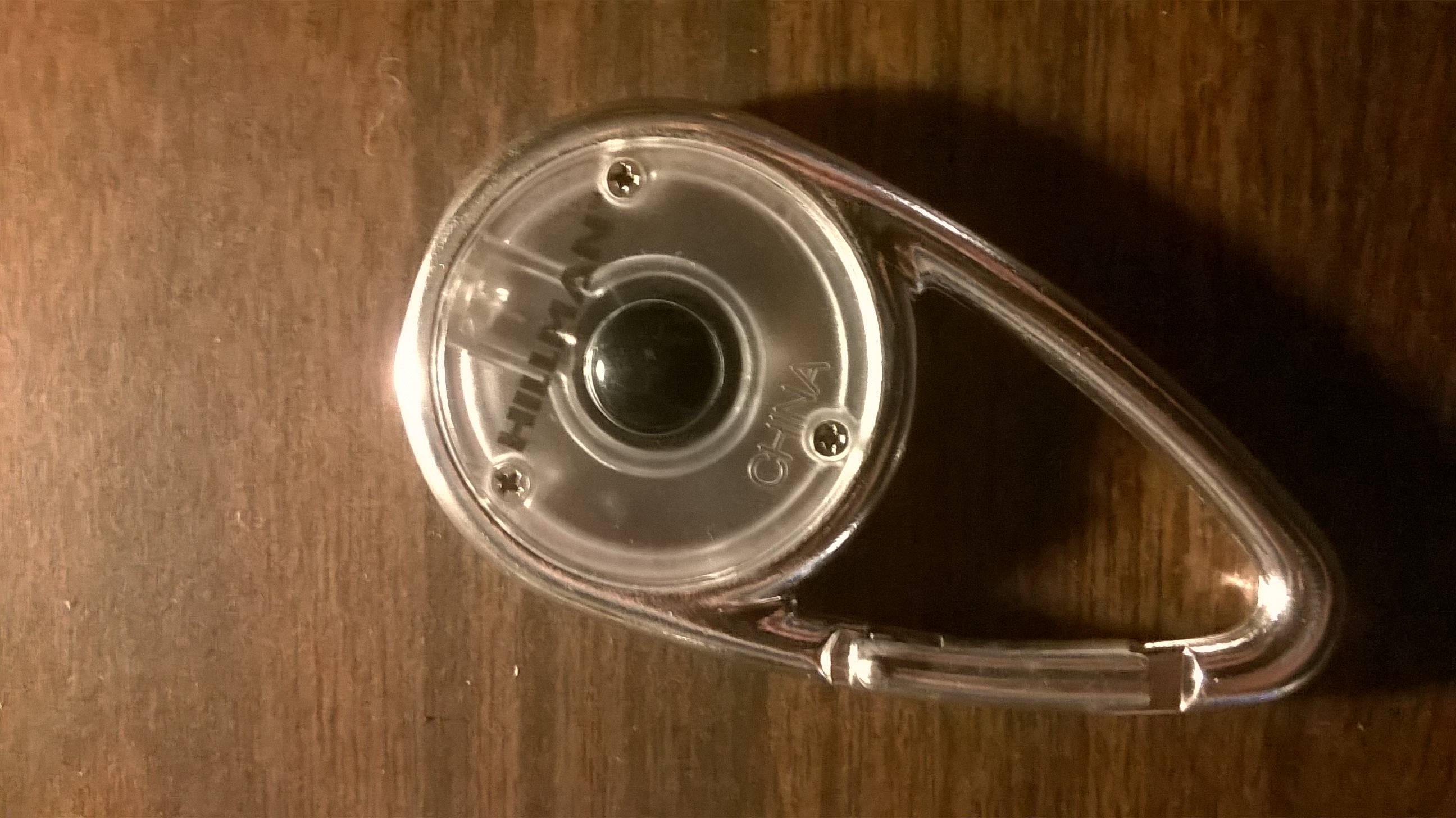

I don't know how useful this will be, but here it is anyhow:
I found these for $1.50 at my local Lowe's while looking for plumbing components to build my boot rockets. They light up when you push the little button in the center; They were originally designed as keyring flashlight carabiners, bt they're almost precisely the right size and shape for the boot rocket controls.
I figure with either duct tape, silver painted cut balsa wood inserts, or modeling clay, one could fill in the gap in the carabiner, and have a pretty good instant rocket control solution.
I intend to cap off the part of the light that points outwards, and do some work on the faceplate as well (maybe color it somehow if I'm feeling especially adventurous), but for $1.50 apiece I thought they made a decent alternative to the 3D-Printed solutions, if you're willing to sacrifice a little accuracy in exchange for cheap good-looking durability.
Have you lubricated the zipper? Google sewing stores for zipper cleaner/lubricants. Most of your local sewing stores sell them. Best stuff around to making stubborn zippers work.
