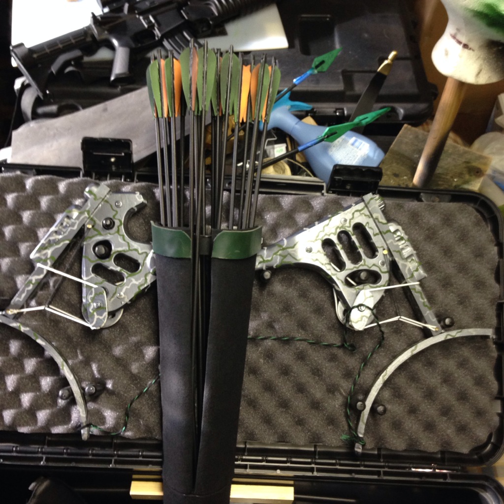

Been updating my Arrow. Season 2 bow and quiver. Not PVC pipe.
The feathers are actually olive green 3mm foamies and lightly airbrushed with a black acrylic. For the quiver I used my old one. My original quiver was taken off of one pic from season 1 so not quite accurate. Instead of having a slit in the back it was two pieces of material rolled together. The original quiver was made with a very thick leather used for belts that I got from a friend for free. I then used 3m super 77 spray glue and a black cotton twill to cover it. Then sprayed the quiver with a krylon flat black. The green straps were extra leather airbrushed with a very diluted liquitex paint that I mixed to achieve the optimal green color. I used the same cotton twill for my punisher war zone vest. Purchased at Joann fabrics. I couldn't see spending money on cordura when a cotton twill would achieve the same look.

I've put together group buys but if there's interest I could look at making more. The slit on mine is slightly crooked since I cut it after it was assembled. If I made more it would be straight. My quiver is tapered from the bottom. I don't believe it is just a straight tube.
You should start your own build thread if you haven't already.
