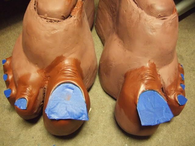

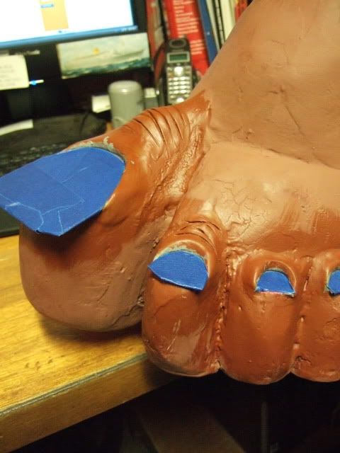

I skipped some steps in the picture taking process, but here they are sanded and primed.
I carve the toenail beds out and primed them, painted them pink, cut the nails, glued them down and used 2 part Plumber's Epoxy to make cuticles and toe wrinkles:
The nails are taped so the rest of the airbrushing can get finished.
Hair starts tomorrow, cause he has to be done on Thursday.
