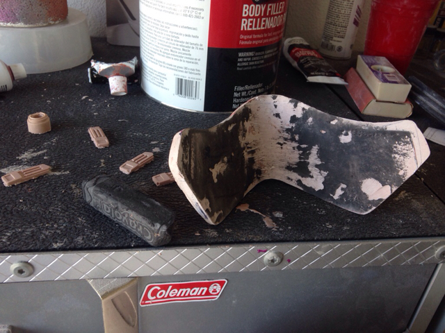

In order to add the hex mesh under the nose piece, I decided to cut the nose out and bondo the hole to create a base for the mesh.
This created a challenge when I went to put the nose back in place as the curvatures didn't match. I decided to use chalk on the back of the nose piece to find the interferences.
This required a lot of check, sand, re-check, re-sand... In the end, I was very pleased how it worked out!
