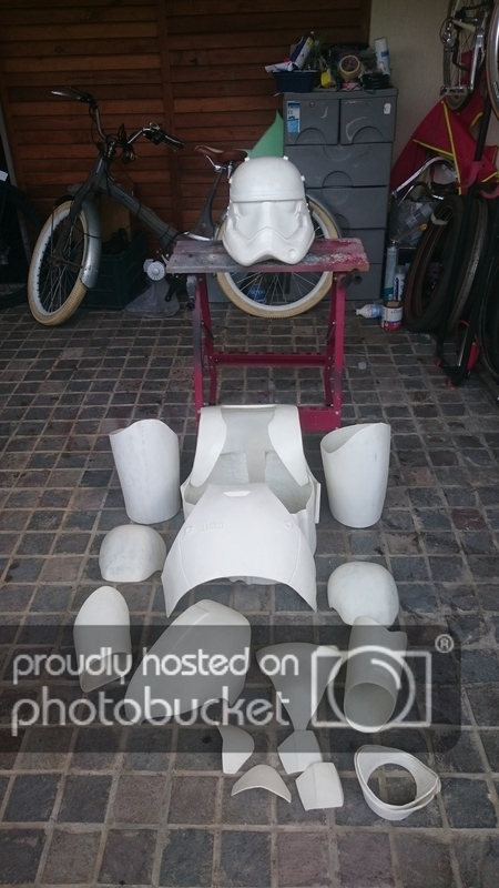

Here's a sneak peek at the armor:

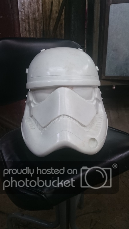

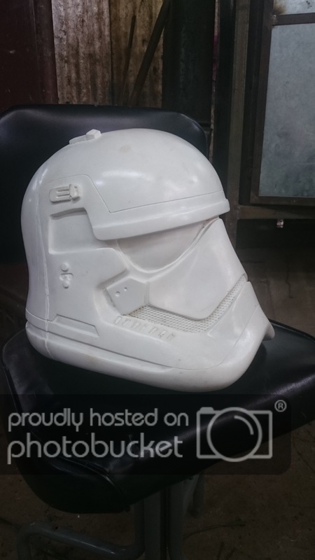

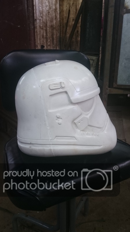

Here's the first cast, fresh off the mold! Helmet #001. :)
Waiting for the last few parts! This flexible fiberglass is awesome. It's like rubber. :)

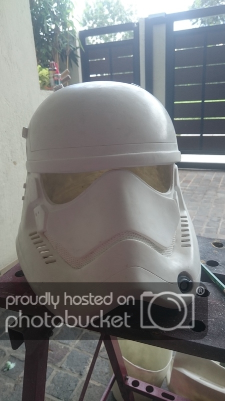

Cutting out the lenses and vents:

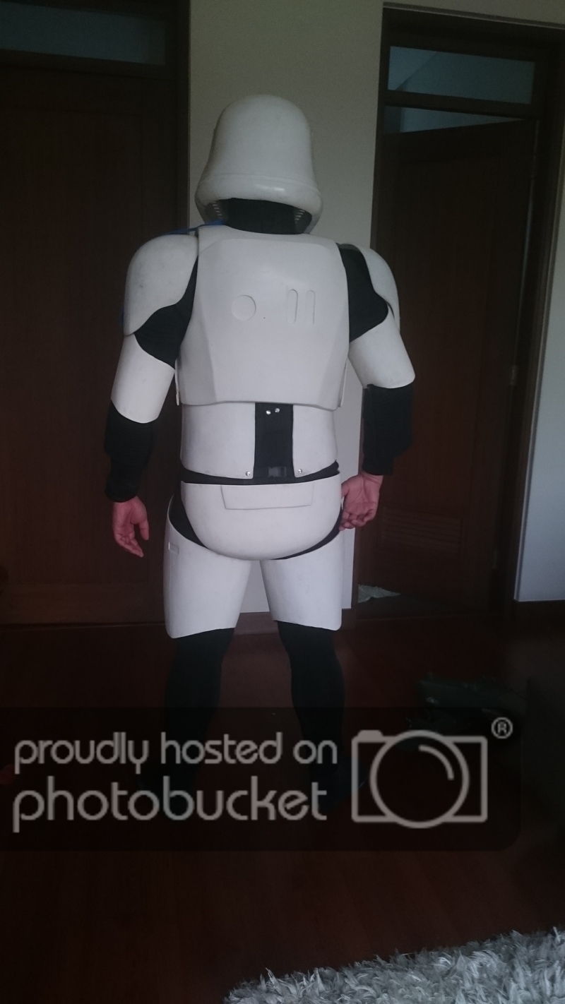

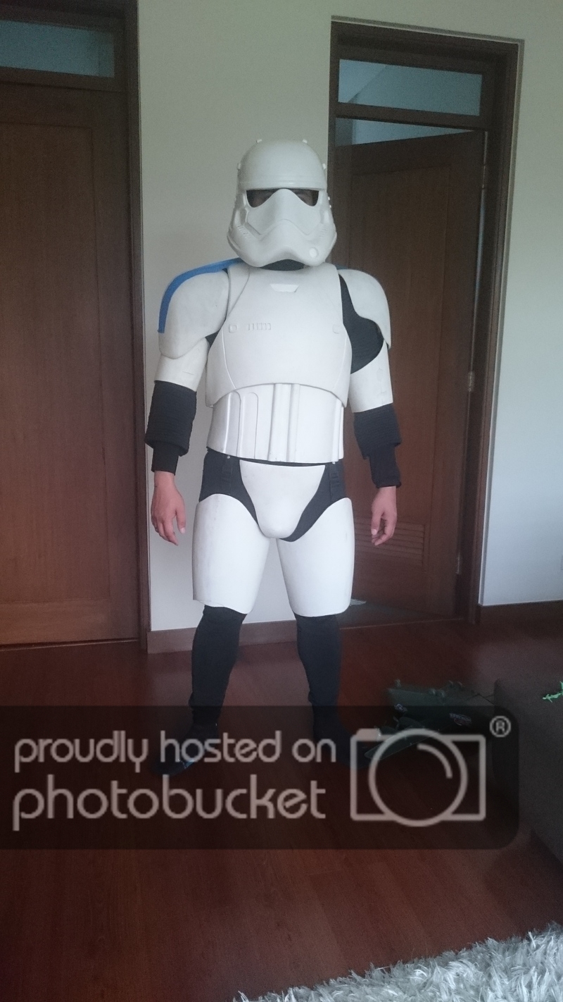

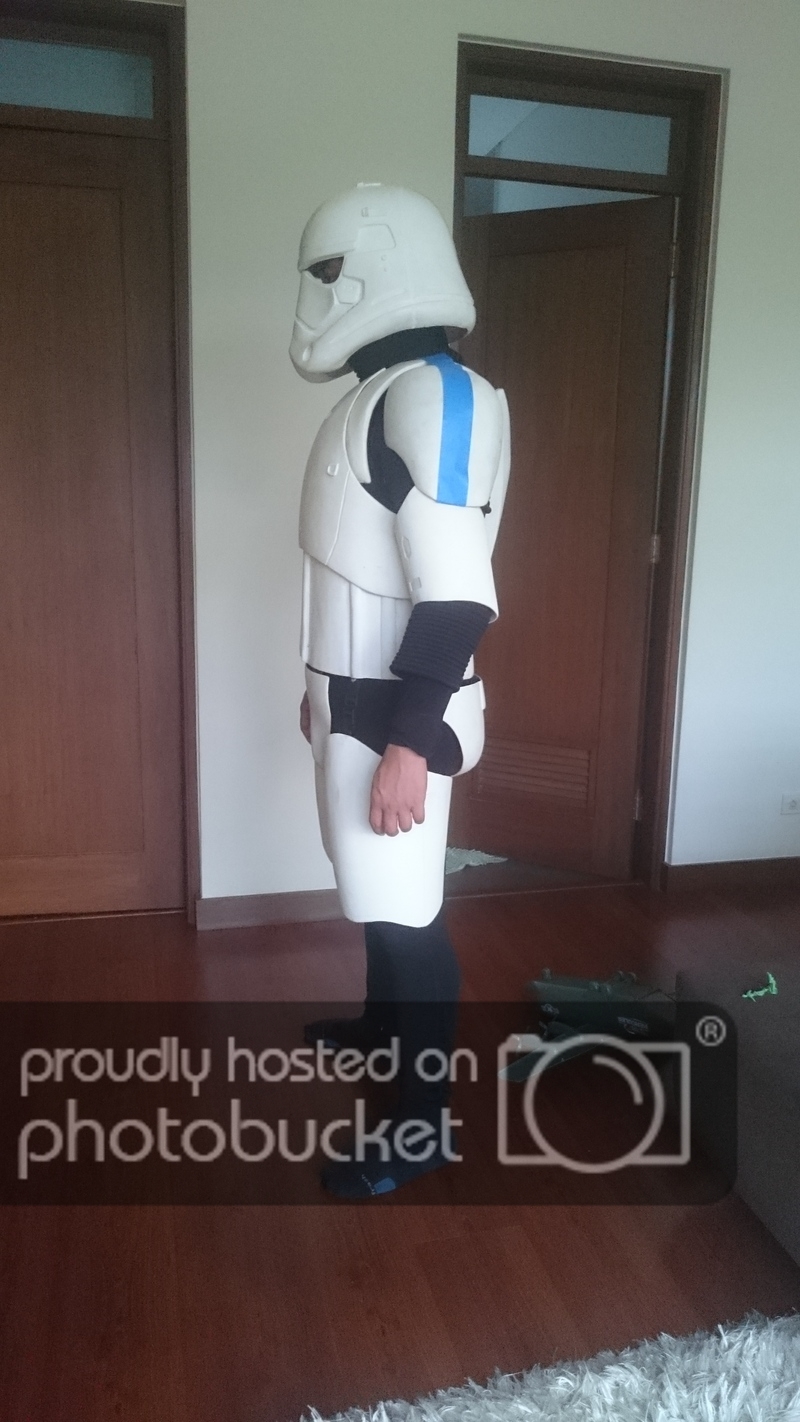

Test fitting the raw unpainted armor on the harness i made. It's much more comfortable than clone armor...maybe even more than tk armor. Pretty easy to move around too. But difficult to suit up on your own.
So far the glued (grecco888+e6000) snaps are holding. But the industrial strengh velcro pads were slipping as evidenced by the lopsided shoulders and arms. So i'll need to reinforce it with glue as well.
I'm also wearing the upper cloth gaskets.
I did have to trim off the bottom of the thighs as they were a bit too long for me. I wish i were taller. frown emoticon
For those wondering about size, i'm 5'8.5", 185lbs, with a 38 waistline. (i know, i know. :/). But the flexible fiberglass will make for versatile fitting whether bigger or smaller. The material is also thermoplastic so you can reshape with a heat gun if necessary. So the abs, chest, back can be made thinner or wider with minimal work.
Next i'll be testing how well it takes paint and how the paint on the flexible parts hold up to the bending.

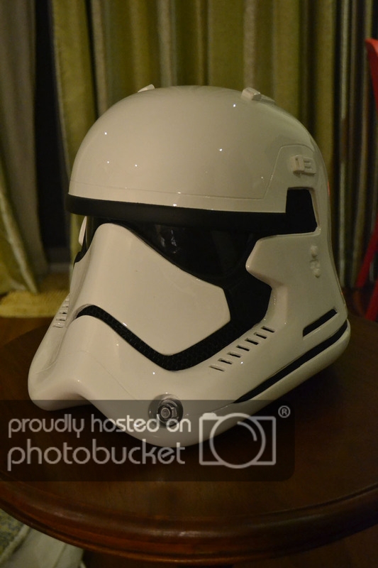

Updates:

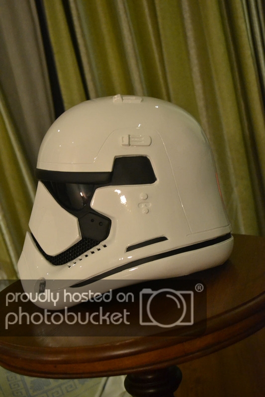

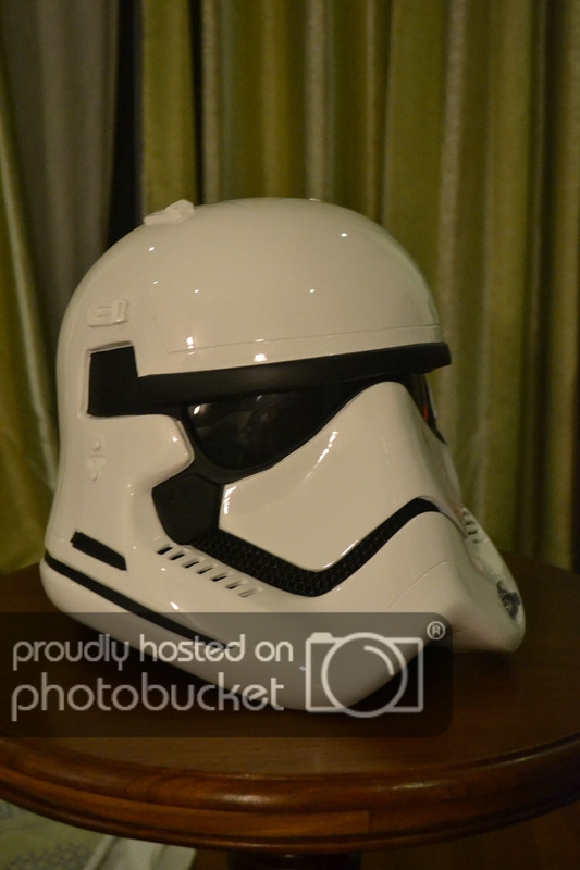

1) Here's my finished helmet. I used a cut down black tinted motorcycle visor as a one-piece lens. I've also cut out the mouth and hot glued some plastic hexagonal mesh and covered the back with black stocking material for better breathability.
2) The flexible fiberglass takes paint very very well. The paint also flexes with the armor without cracking. Full speed ahead with this!
Re: Another TFA Stormtrooper Bucket...Old School Sculpting

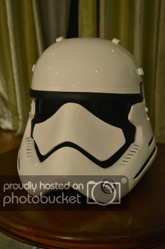

Looks fantastic, the one small thing that I think needs to be changed is the small greeblies on the helmet are too tall making them much too noticeable.
Thanks! About the latches: I actually did that on purpose. It serves as sort of my trade mark? In case someone tries to recast it. Tall greeblies = my sculpt. Besides, they are very easy to sand if you want 'em lower. :)
