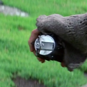

There's really no way for me not to be an ass about this other than remaining silent but I'm not gonna do that. Yeah, grips going all the way to the bottom end cap in the snow close-up... as I vehemently stated all along. *does the Chandler Bing happy dance like the ass I am* ;)
http://49.media.tumblr.com/b907b7e4ec2200d75b533b967615dc21/tumblr_nf4vhoi5u71smp4y5o7_500.gif
The grips do appear to go all the way to the end cap, on that one saber, and every other saber in the movie is basically the 'Hero' saber with the short grips.
So anyone could make an EP7 saber with longer grips to match that 1 saber, but it wouldn't be accurate to any of the media presented or the beauty, 'Hero' shots. But yes, they do appear longer on that stunt saber.

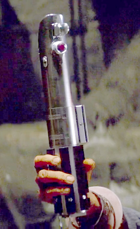

I've got some other interesting shots.
You can clearly see in the first image that the Graflex tubes are in the shortest position from the square holes in the clamp.
Also a nice view of the Kobold clip.
The grips do appear to go all the way to the end cap, on that one saber, and every other saber in the movie that are basically the 'Hero' show the short grips.

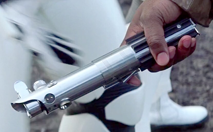

In that shot of Finn holding the saber, the grips are short at the clamp but seem to possibly go all the way to the end of the tube. But the glass eye looks like the one from the Wired photo shoot where it's been turned smooth, and I think the grips are short on both ends on that saber.
Most likely due to the fighting action the actress pushed the bottom part slightly more inside the clamp, thus the T-tracks appear to be flush :wacko
Chaim
Another observation on the shot of Finn holding the saber in the photo Roy posted:
If you look at the square cut-out in the clamp on the lower side by the lower tube, it looks like you can see a gap made by the slots cut in the lower tube to hold it to the clamp, and the grips are still short, showing that short grips would be intentional and not an accidental by-product of pulling the lower tube out completely.
Yep, that's what Roy pointed out. Though my old eyes can't see it :/
So to recap... Assumed hero - snow saber = short grips + rivets + clamp cover+ soon-to-be-determined T-track dimensions...
