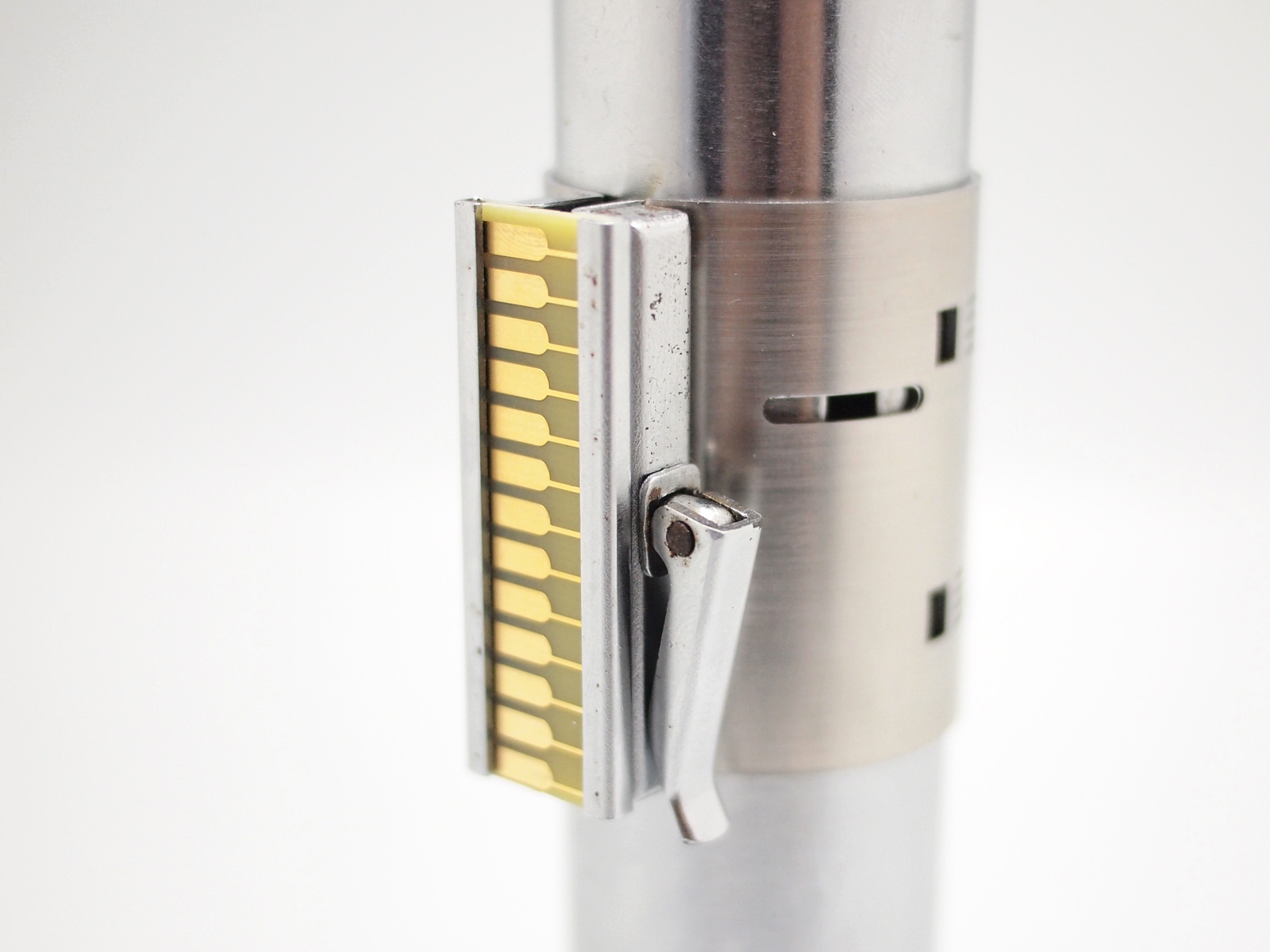

I wouldn't orient the clamp cover based on some random promo picture. Thin lines towards the clamp lever is the correct way.

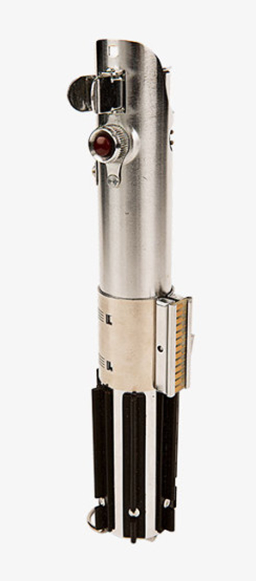

Launch Bay:

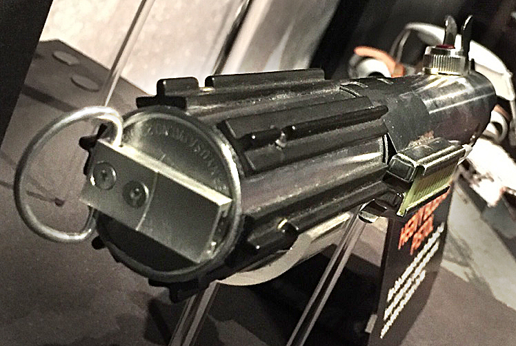

Those would be considered random promos as well, from what I and many others have seen from the actual film the thin lines point away from the lever.
If people are building Skywalker Ranch sabers, any of these can be legit.
There's no such thing as 100% screen accurate when the props themselves change from scene to scene due to differences between heroes, stunts, and back ups.
Well ... I consider a picture taken of the prop in the leather jacket used on screen a lot more accurate than any picture taken of a loose prop for promo in some magazine or Disney exhibition ... remember the so-called Ranch saber ... Luke's ESB lightsaber residing at the Archive near Skywalker Ranch ... that had the different wider textured mylar tape on the clamp which was never seen on screen?
Chaim
For sure-- I think there's a law of averages in play-- which details are the most common can probably be agreed upon to say what's most accurate.
If you look, the clamp card in the launch bay photo is off-center. Meaning it's very likely it wasn't in place for shipping and whomever arranged the display just stuck it in there however.
Exactly like the person who set up the Skywalker ranch display said "oh hey, we should cover this logo with something" and caused decades of debate. :) That said-- people do build ranch sabers as it is an anomaly, so in and of itself also rare. Like a misprinted baseball card being worth as much as a legit one.
My bigger point was-- each of them has a certain level of legitimacy. Once the Blue Ray hits and people can see film stills at high res a lot of things will be decided upon for sure-- I just think that the quest for 100% accuracy is something that can truly ever be attained due to the nature of film production.

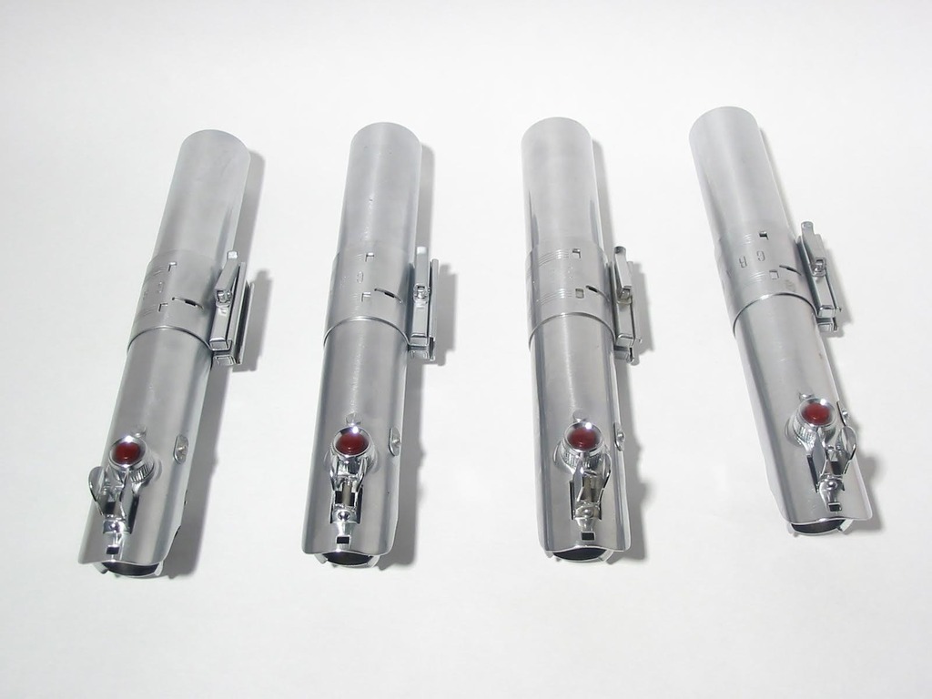

In all 7 complete G R A F L E X flashguns were purchased by Foodles . . . 1 directly from ebay . . . after which that seller was contacted and 6 more were found and sold for production . . . so there was absolutely no need to recreate the clamps . . . clearly whoever was interviewed for Cinefex did not have all the facts. Here's 4 out of 7 G R A F L E X flashguns :
Now as far as those 'rubber fins' for grips that's interesting ... if it's accurate and true.

It'll be interesting to see how close the Launch Bay sabers are to the screen-used ones. At least the grips do not match. The fin is rounded on the notched part on the Launch Bay version, also not as high. Thats compared against the promo shot with leather jacket you posted as well as the wired photo shoot where its a straight cut.

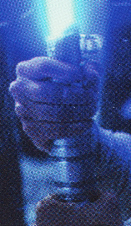

Notice anything odd about the saber? Yep... what's up with all of those grooves?! That thing is *not* a Graflex.
THE PLOT THICKENS.
This is probably their stunt/dueling saber. A body that you can actually handle without tearing up your hand, something set for the rod and LEDs, with the top using a Gralfex syncro/mini for visual continuity.
What you seem to see is most likely an optical illusion ... partly from being a photograph taken off a screen, which in turn was made with a 35mm movie-camera and most likely re-worked in post, hence the loss of details of the 4 lines going around the G R A F L E X clamp. Shadows, light and reflections can really create another picture ... in your mind :)
Chaim

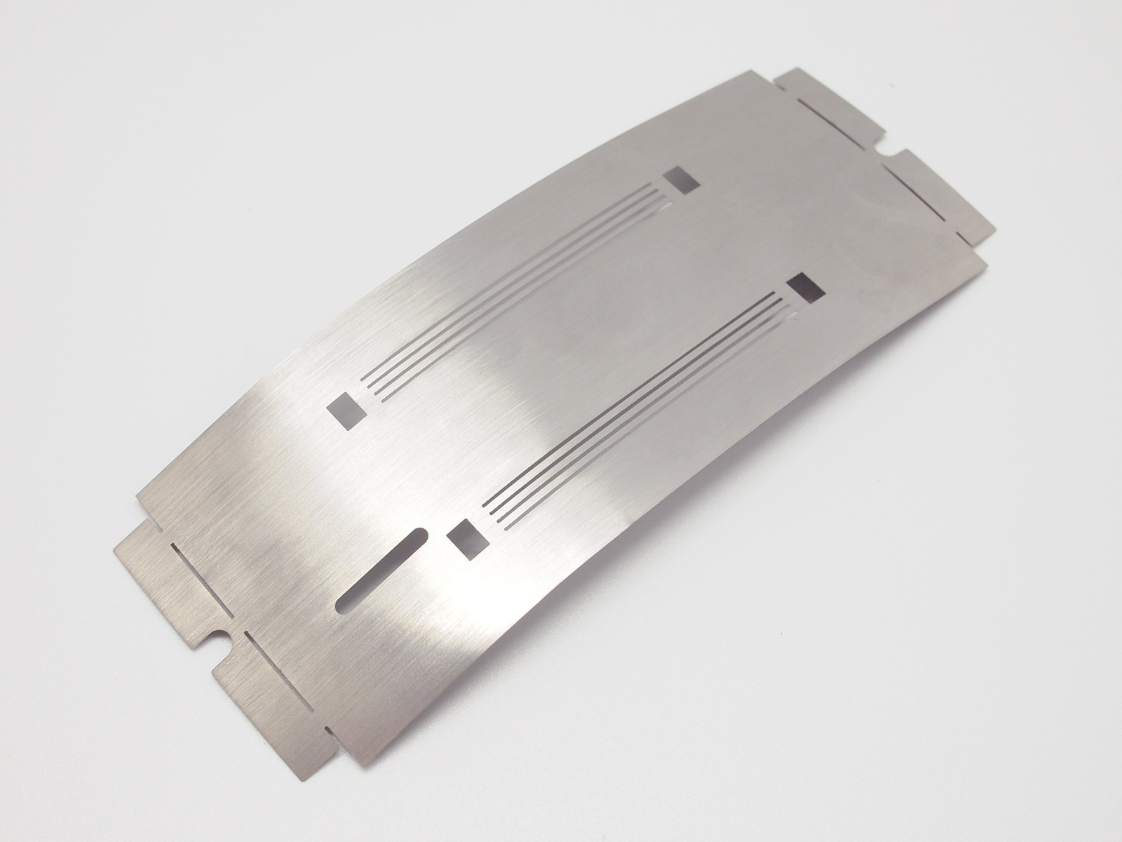

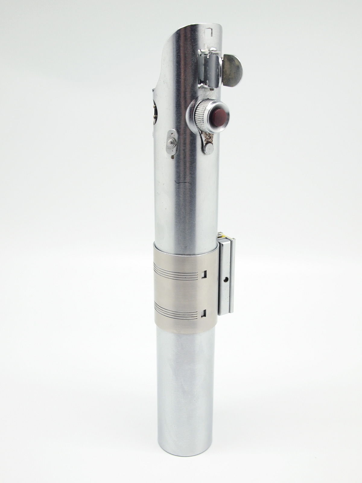

The TFA edge connector clamp cards are now available!
http://wannawanga.com/products/edge-connector/

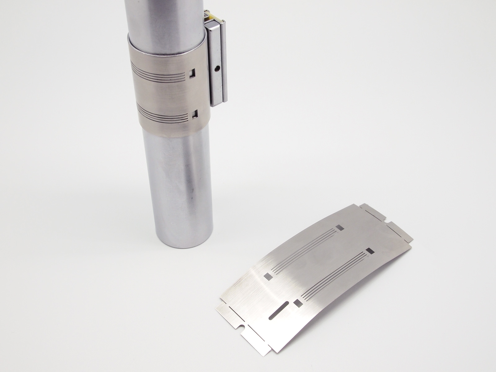

As you can see I also have a clamp cover in this picture. This is a sample version.
It's not available yet, I actually need your opinions!

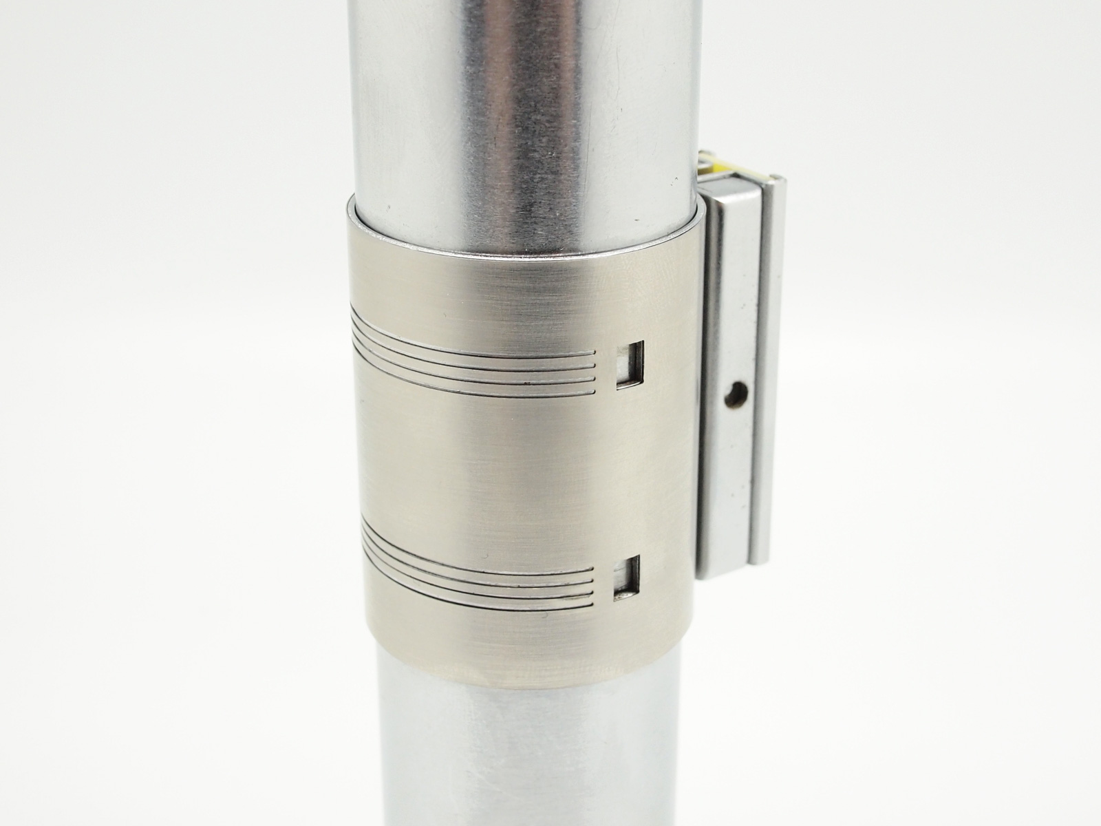

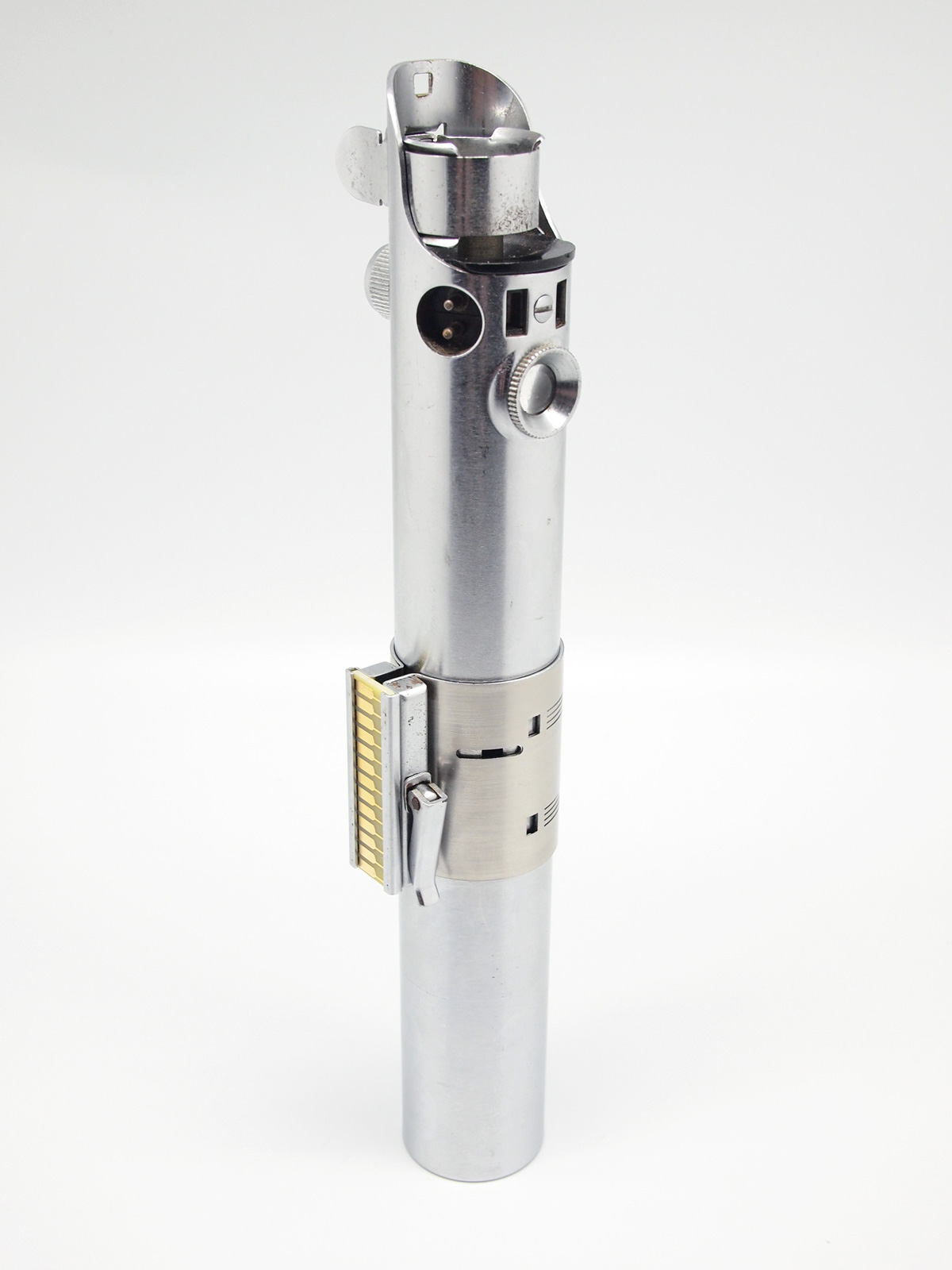

Here are some more pictures:
View attachment 585411 View attachment 585412
This part is stainless steel (0.15 mm) sheet. This is much tougher than you might think. (I tried 0.2 mm, but that's too hard to bend)
As you can see, I made the grooves as cutouts instead of engraving (also called embossing). This gives a very sharp and precise definition.
I also created tabs that go underneath the rectangular Graflex bars. This is a very convenient method of assembling and it's not at all visible as was the case with the much thicker Force FX clamp test.
The surface of the steel comes mat and without brushed texture, but you need to brush it by hand (with 600+ grid sand paper)
So the question is: shall I make THIS version available? (price $15, available in 1-2 weeks)
Or shall I continue the development and make it with engraved grooves and WITH a brushed texture? ($15, available in 5-6 weeks)
Let me know what you think!
