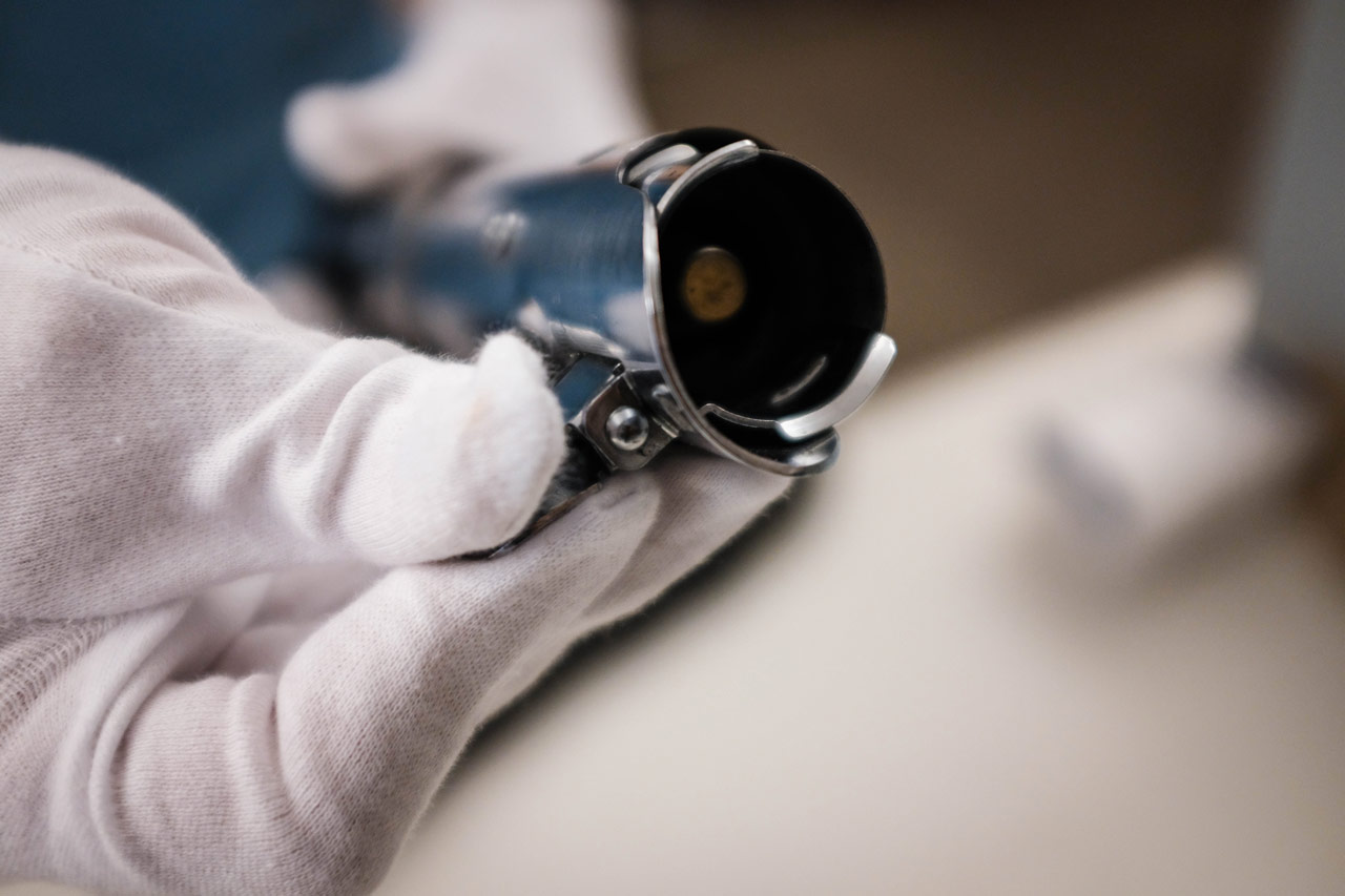

Interstingly, in the photos of Madlyn Burket holding the "Rey Light Saber" prop where she's wearing the blue SCARIF sun T-shirt ( http://www.starwars.com/news/here-a...adlyn-burkerts-5-favorite-star-wars-artifacts ), the clamp cover simply looks stainless.

And I sure wish we had a better version of this pic, since in that article... "On telling this lightsaber apart from versions used in the original trilogy: (Madlyn says--->)“This one has a pretty big tell. There’s an opening here for the blade to go in.”" She's pinching the Bulb Holder open, but there's still the Bulb Plunger sitting there... I don't see a hole! Is it a blade plug with a Bulb Plunger in it??? Or does she not fully understand that the "hole" she sees when compressing the Bunny Ears is just the enlarging of the Bulb Holder where she thinks a blade can go? Or are we simply unable to see that there is an actual hole around the Bulb Plunger?

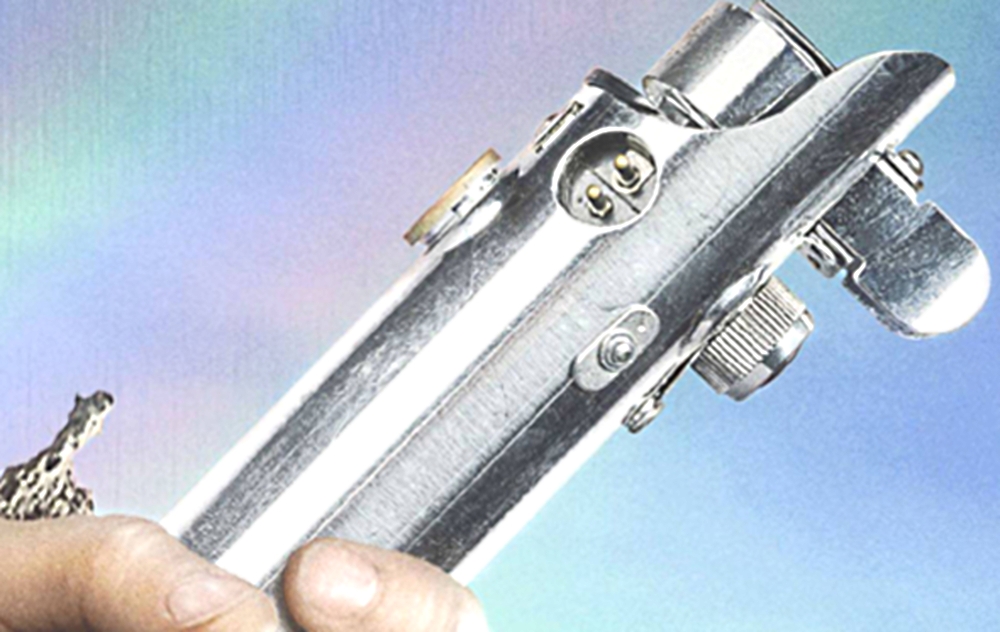

Hey scottjua, I dunno. I'll have to double check my copy of the magazine, but that fuzzy pic above looks like it has a lock washer under the de-knurled ring. Hold on a second, I got this image covered last year, be right back.... Yep, here it is again...
attachment.php
So, the Empire Magazine GRAFLEX looks like it doesn't have a washer, but it still isn't sitting in place properly. Maybe it's a goofy shaped bulb preventing the Glass Eye from seating fully. I know I had to modify the lip of the LED bulb that I put in my GRAFLEX in order for it to seat the way it did with the old round incandescent bulb.

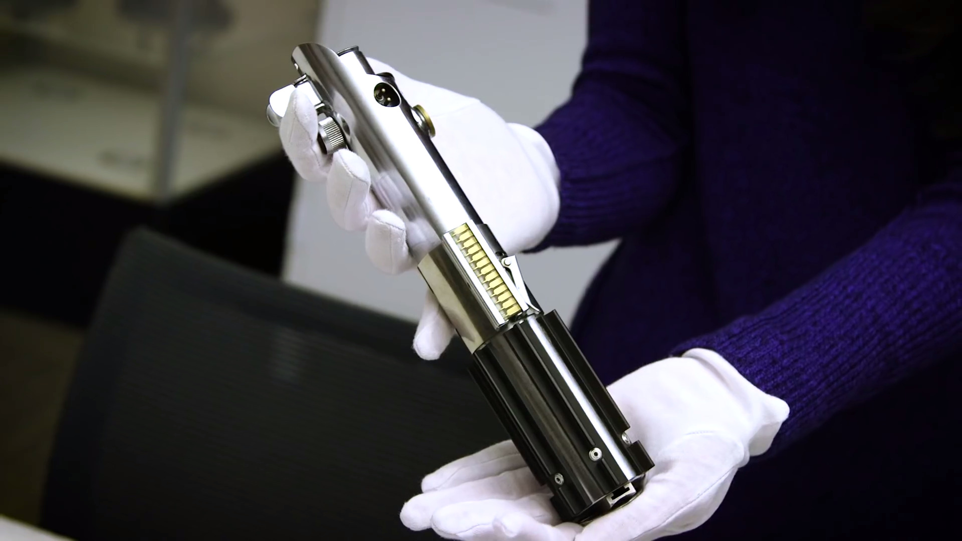

I'm still in the "there's a washer under there" camp. At least for the 'Rey Light Saber x 2' in the 'GOT Creators Making New Star Wars Films, Up Close with the Falcon, and YOUR Solo Teaser Reactions!' video with Madlyn Burkert holding it...
LIGHTSABER - Rey Light Saber x 2 - held by Madlyn Burkert - Lucas Film Exhibitions and Collectio.jpg
Maybe it's a "light-a-fact" (photographic artifact), but it seems to have something steel colored beneath the exposed brass of the de-knurled ring that is almost the same diameter as what's left of the Glass Eye. A lock washer would certainly make sense in order to help prevent it from backing out and getting lost.
