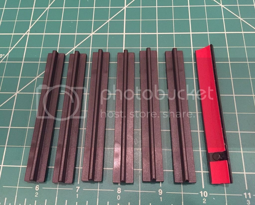

Thanks guys.. I am completely embarrassed at the finished t-tracks. Does anyone know who can make a symmetrical set for me?
Spot putty and paint.
I had my dremel set a little to low and am in the process of correcting it now.
If the damage isn't too deep, try wiping the grips down with a cloth soaked in laqueuer thinner. It should level out the area and smooth out the rough surface of the filed parts.

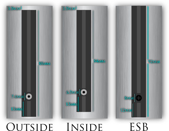

IMPORTANT NOTE!
I just found out today (thanks to DARTH SABER's build and his PM to me) that ROMAN's replica has a longer bottom than a vintage. The difference is around 3mm.
A vintage bottom can also vary a little and measures around 92 to 93 (in my collection). This is measured from the bottom to the edge of the clamp in pulled out maximum length. Roman's measures 95mm.
So whatever version you are planning to build, you need to take this into consideration and re-calculate the length. My recommended lengths (as in my blueprints) are all based on a vintage bottom of 92mm.
Thanks for the warning Roy - pre-measuring the bottom tube is probably a step many people would have skipped on a simple assumption.

IMPORTANT NOTE!
Side to side mine look the same.
Measuring them, Roman's is about 1/16th longer. If I line up the tops, the clamp sits list a little bit higher. To the naked I I honestly couldn't see the difference, but I will definitely adjust my grips accordingly.
Yeah its mainly to to into account for grips.
