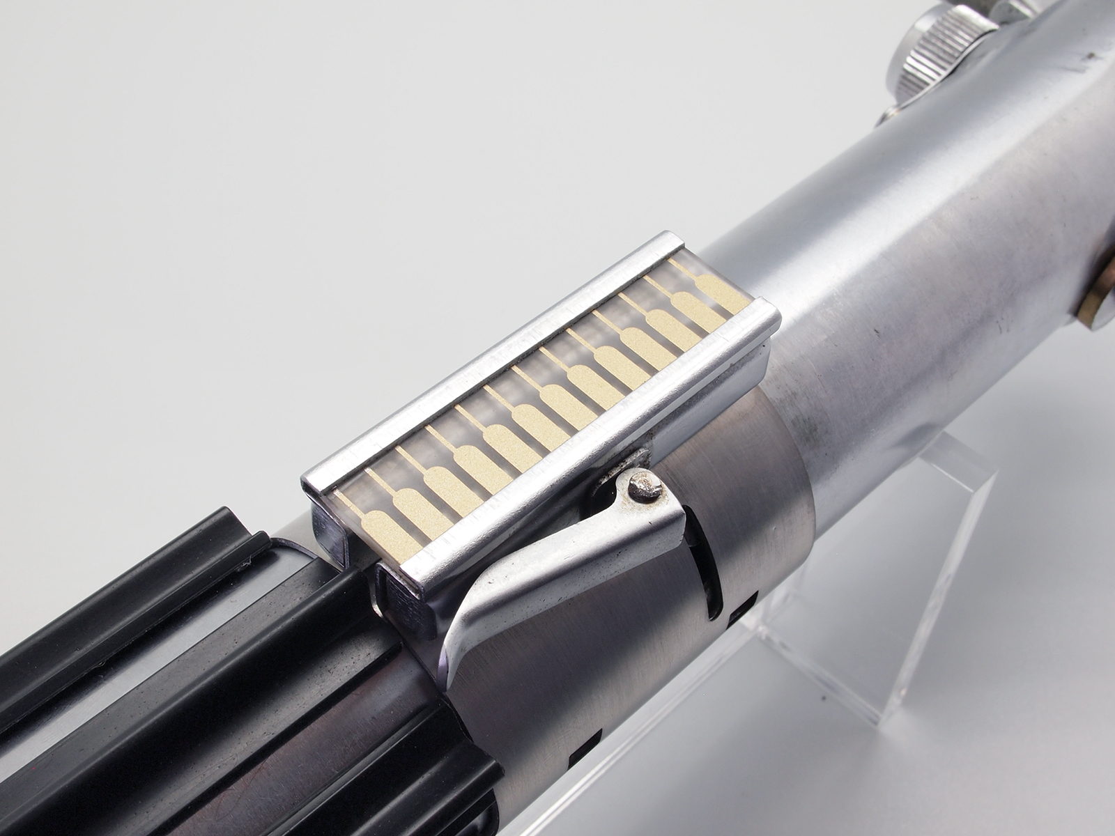

I just had a nightmare with a Roman clamp, Wannawanga clamp card and V2 lever. I bought a set of micro spring clamps and put on on either end of the clamp so I could use two hands to get the lever in place, instead of one hand to hold it together, and one to thread the tiny pin.
That might help. I can't get everything lined up and stayed lined up with out it fly apart when I try to put the pin back in.
That was exactly my issue-- it was wiggly. The two clamps made it way easier. The trick, as James' video shows, is to get enough of the pin in to turn it, but without locking it into the washer. To do that, things have to be way compressed down.
The kit looks great. Has anybody considered that the clamp card may be translucent silicon instead of plastic? Like on this cable...
Yep, it was that pesky pin not going in because it would not line up....so I put the pin in from the opposite side, lined up everything and THEN clamped it. I took the pin out, put it in the correct way and BINGO, it worked! I must say, it hides that old corroded clamp very nicely!
