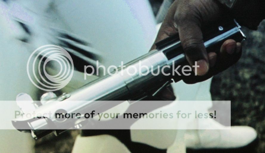

But then there's the scene where the saber is first taken from his hand, before he reclaims it from the fallen trooper. No chance of damage here. It's a hand-off, and a close-up shot, but still, grips to the bottom:

So the grips go to the bottom not only for the snow scene, but also when Finn pics it up from the dirt, as mentioned previously.
http://i1346.photobucket.com/albums...nter2k/Finn Captured_zpsk4mgrpno.jpg~original

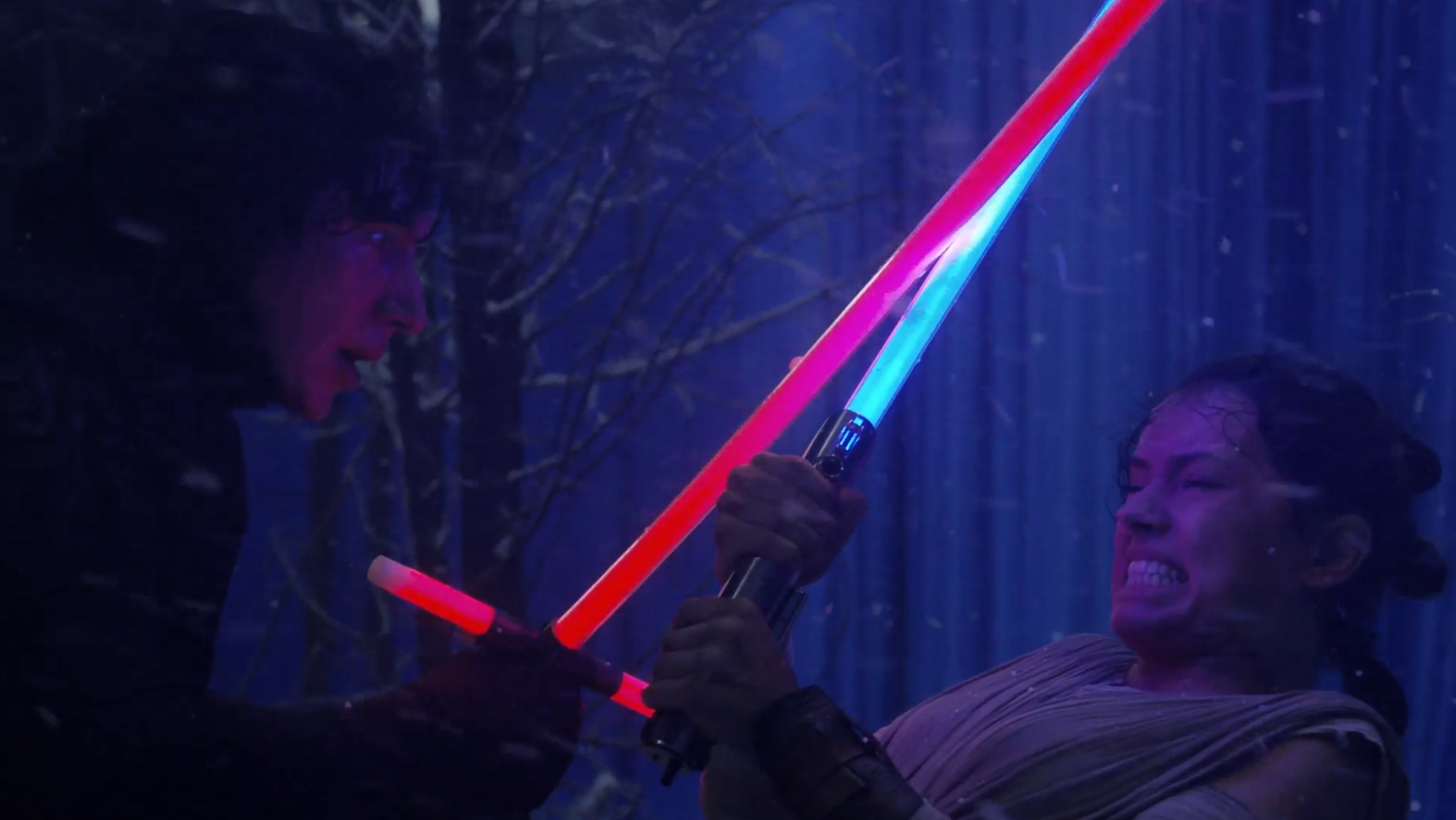

Here's a scene of Rey fighting with Ren in the end, with grips to bottom...
http://i1346.photobucket.com/albums/p700/tscanter26spyhunter2k/rey finale_zpsjz7vclje.jpg~original
...but, if you look closely above, it appears that the fins in that scene have been trimmed down close to the surface of the saber...

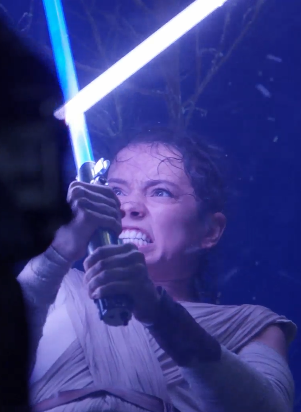

Btw, here's a cap of Rey using the antenna saber. You can just make out the antenna poking out the back:
http://i1346.photobucket.com/albums/p700/tscanter26spyhunter2k/rey stunt_zpsahaecu48.jpg~original
No rivets in the grips in that Rey photo?

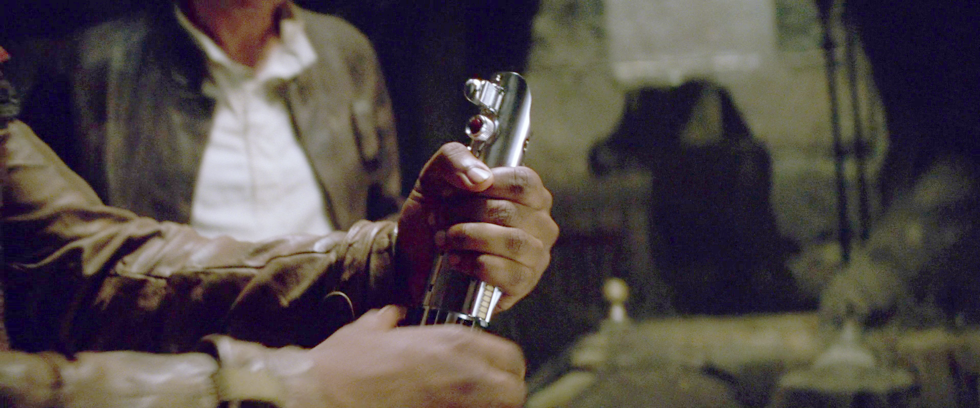

I believe the right hand version can be seen when Maz is handing the saber to Finn. I recall Roy posting a screen cap of that. It appears both versions can be found in TFA.

This looks like it could be one of the cloth covered sabers we heard about, given that it has no rivets in the handle and the grips seem twisted, which would make sense if something with a cloth sleeve was being handle and swung about. Just my two cents here.
rey%20finale_zpsjz7vclje.jpg~original
I guess he missed the article I posted from Cinefex.
Guess he missed where I never referred to whether or not I believed the Rey fighting saber was or wasn't one of the ones made from cloth/memory foam/rubber, and was simply posting a new pic and commenting on the fact that whatever it was, the protruding grip ridges were absent and they extended to the bottom of the saber.

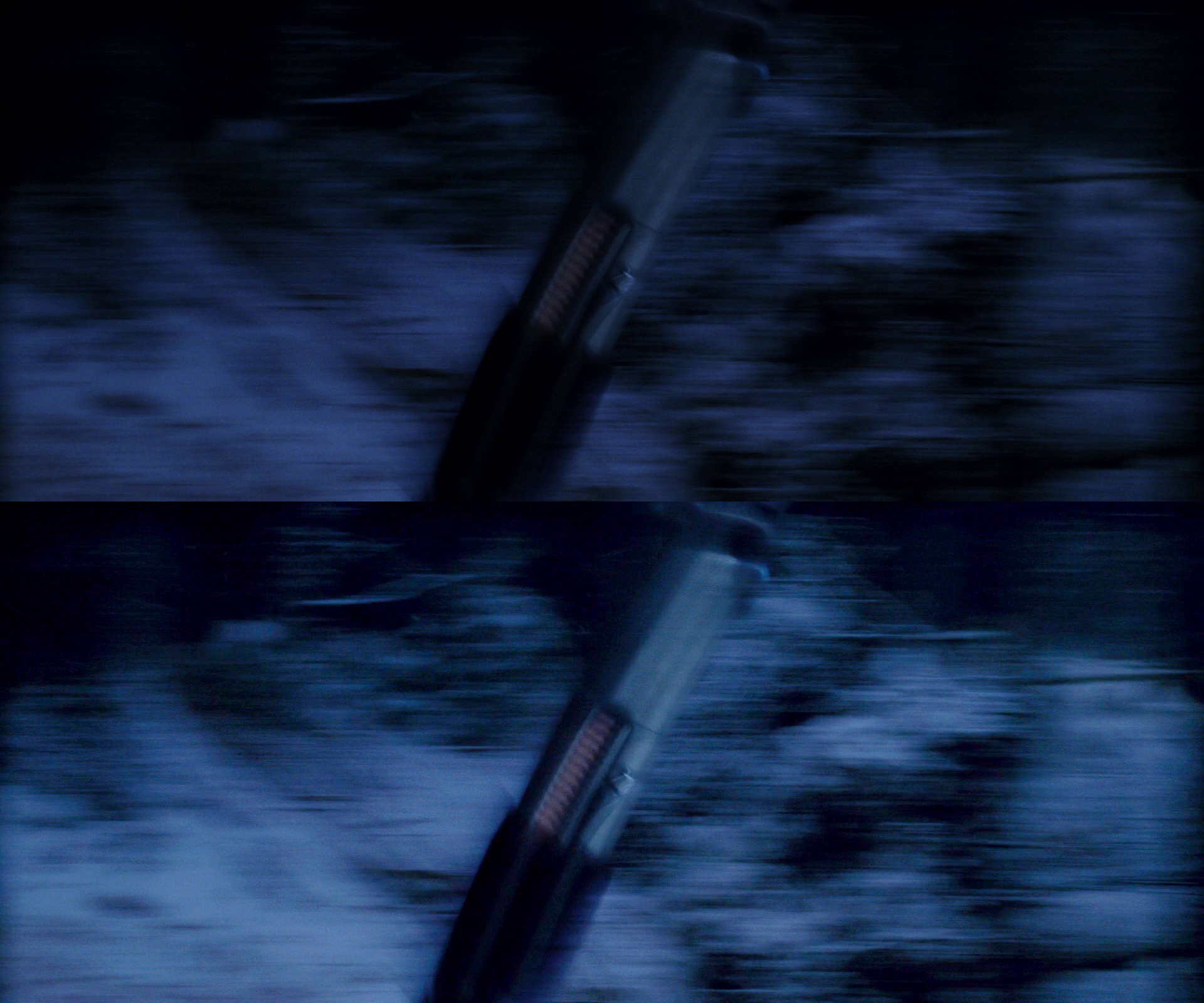

Sloth, I did my best to look for any other shot beside the Finn grip shot that shows the card, but the only other one I saw in the whole movie was when it was flying from the snow to Rey's hand—comes very close to the camera—at which time the card is visible. But the cap is blurry because of the spinning motion. Still, if I had to guess it looks like thin left traces to me, as with the Finn grip scene. Doesn't make sense that they would have created two versions.
Here's the blurry cap:
circuit%20board%202_zpsovxmy34v.jpg~original

I've done some additional research about the variations based on many screen-grabs (image brightness modified) and I identified 3 hero versions:
2. Maz handing saber to Fin in castle (hero #1)
- short grips: distance from clamp, distance from bottom
- mirrored edge connector, thick lines lever side

Sloth, I did my best to look for any other shot beside the Finn grip shot that shows the card, but the only other on I saw in the whole movie was when it was flying from the snow to Rey's hand—comes very close to the camera—at which time the card is visible. But the cap is blurry because of the spinning motion. Still, if I had to guess it looks like thin left traces to me, as with the Finn grip scene. Doesn't make sense that they would have created two versions.
http://i1346.photobucket.com/albums...er2k/circuit board 2_zpsovxmy34v.jpg~original
Found that frame and here's a slightly better version, brightened and original:
1920x1600
The thing is though, I am 99% certain this is a CGI saber
1920x1600
Man, with the better cap, I am unsure again as to which direction the thin traces are pointing. On that saber (which I agree could be CGI) the traces could very well be going to the right.
