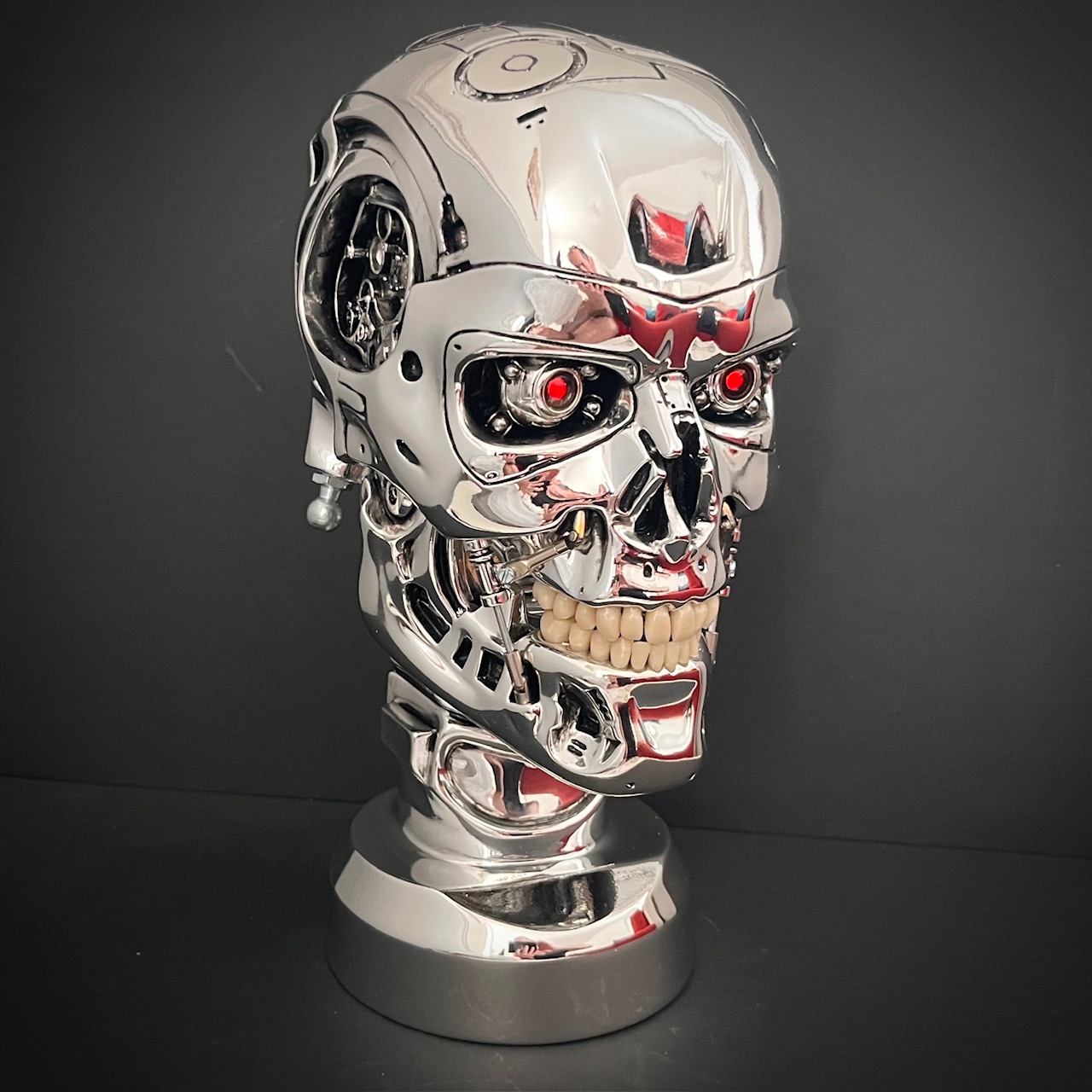

I have recently just finished a vacuum metalized resin T-800 endo skull build.

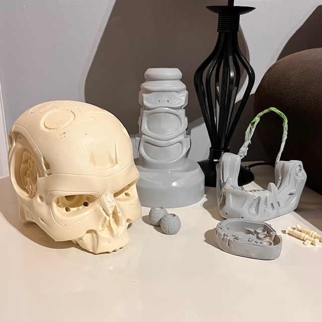

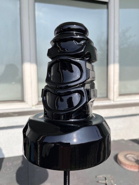

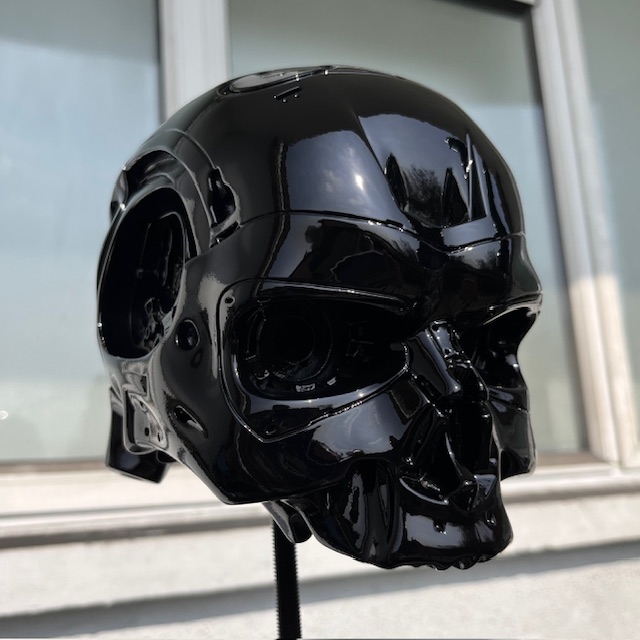

I started off by prepping the castings and priming the pieces.

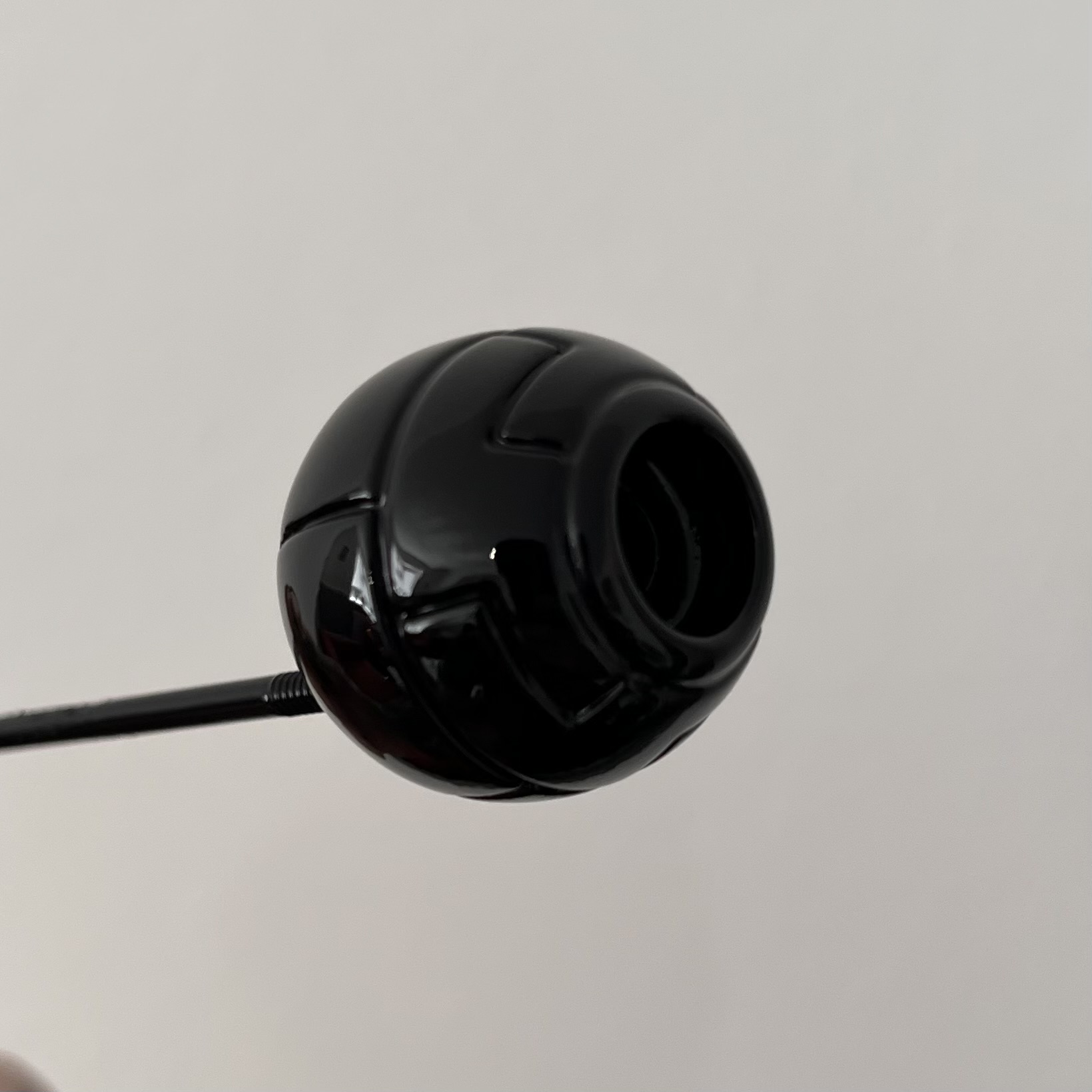

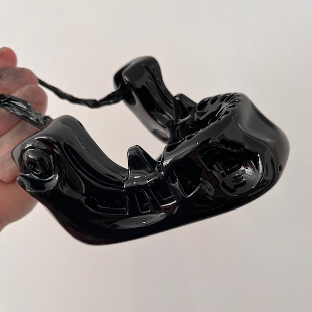

I then sprayed the parts in a 2K Gloss Black so they could be sent off to be vacuum metalized.

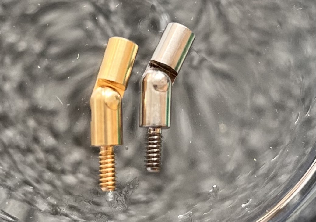

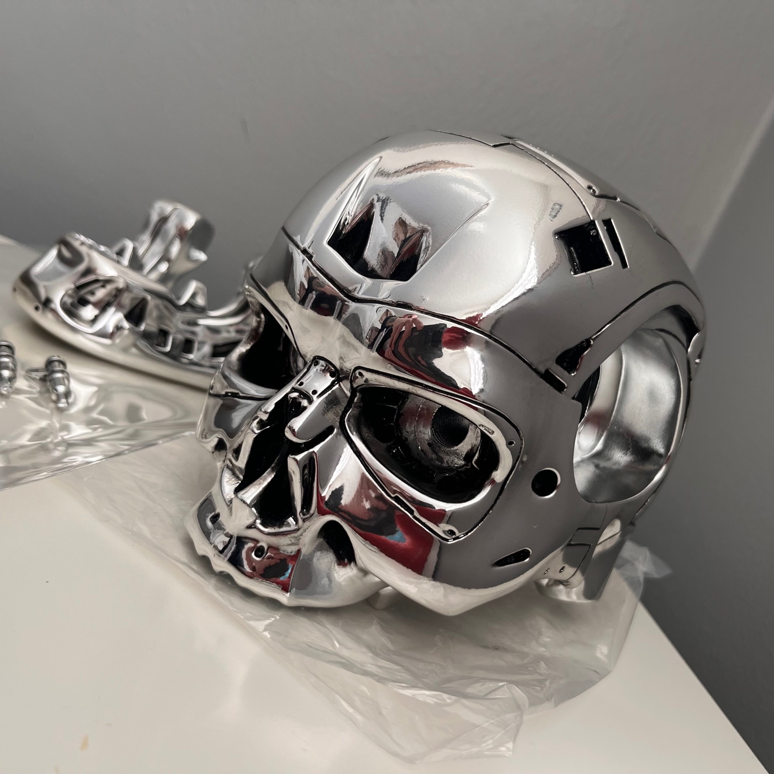

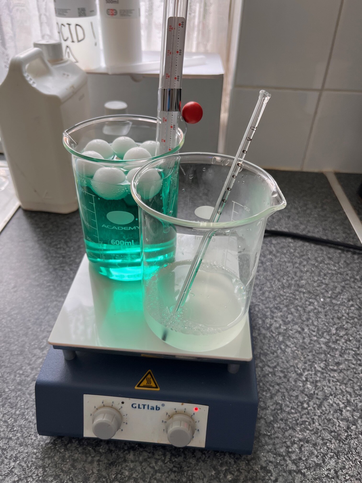

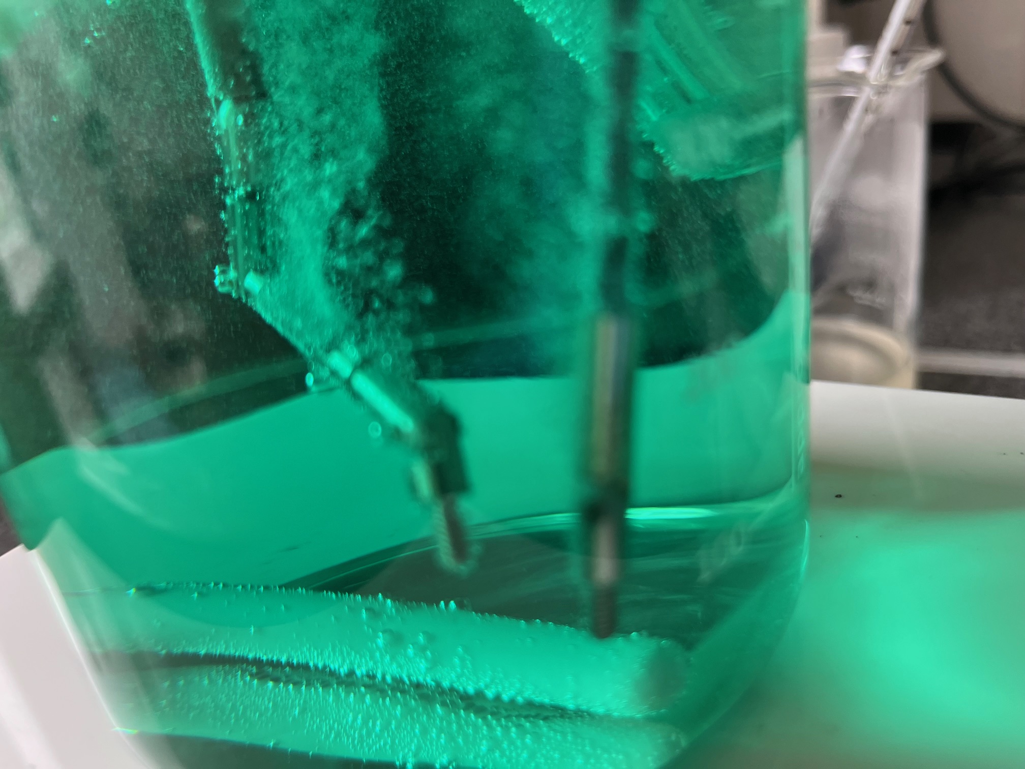

I sent the parts off for the metalizing process, in the meantime I electroless plated some of the jaw pivot parts.

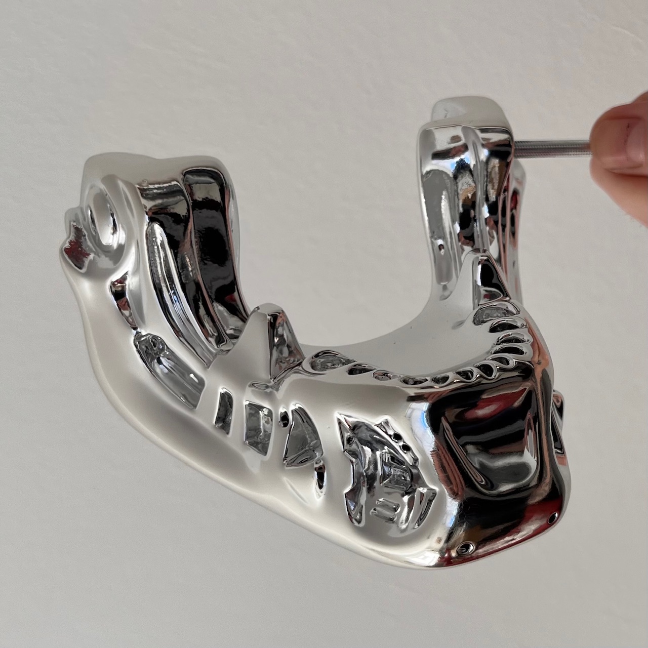

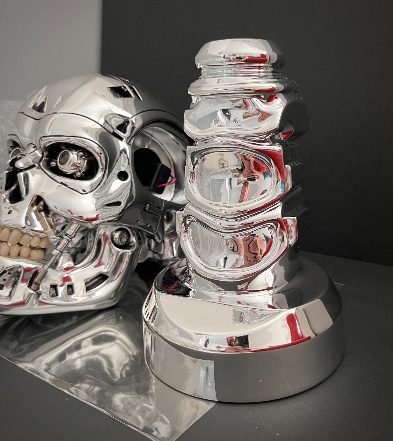

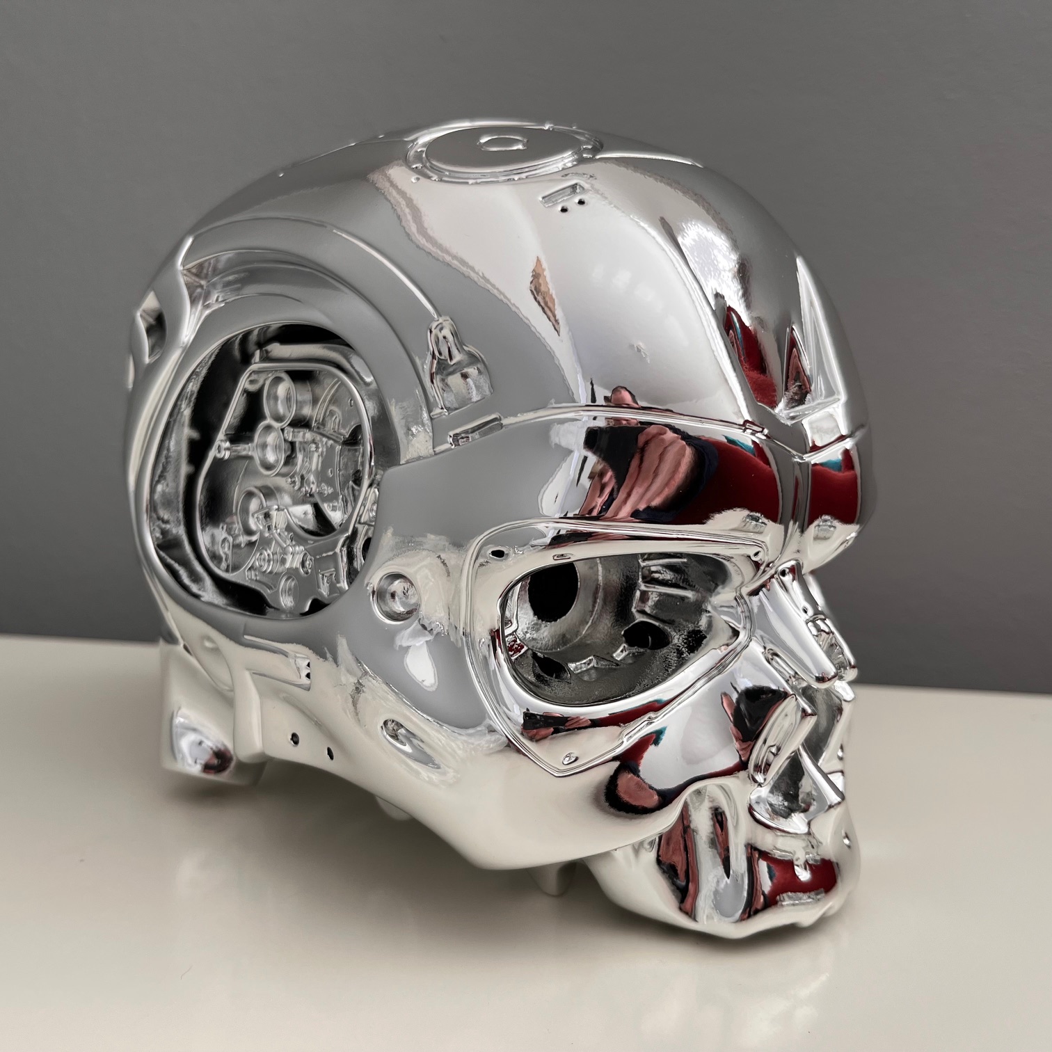

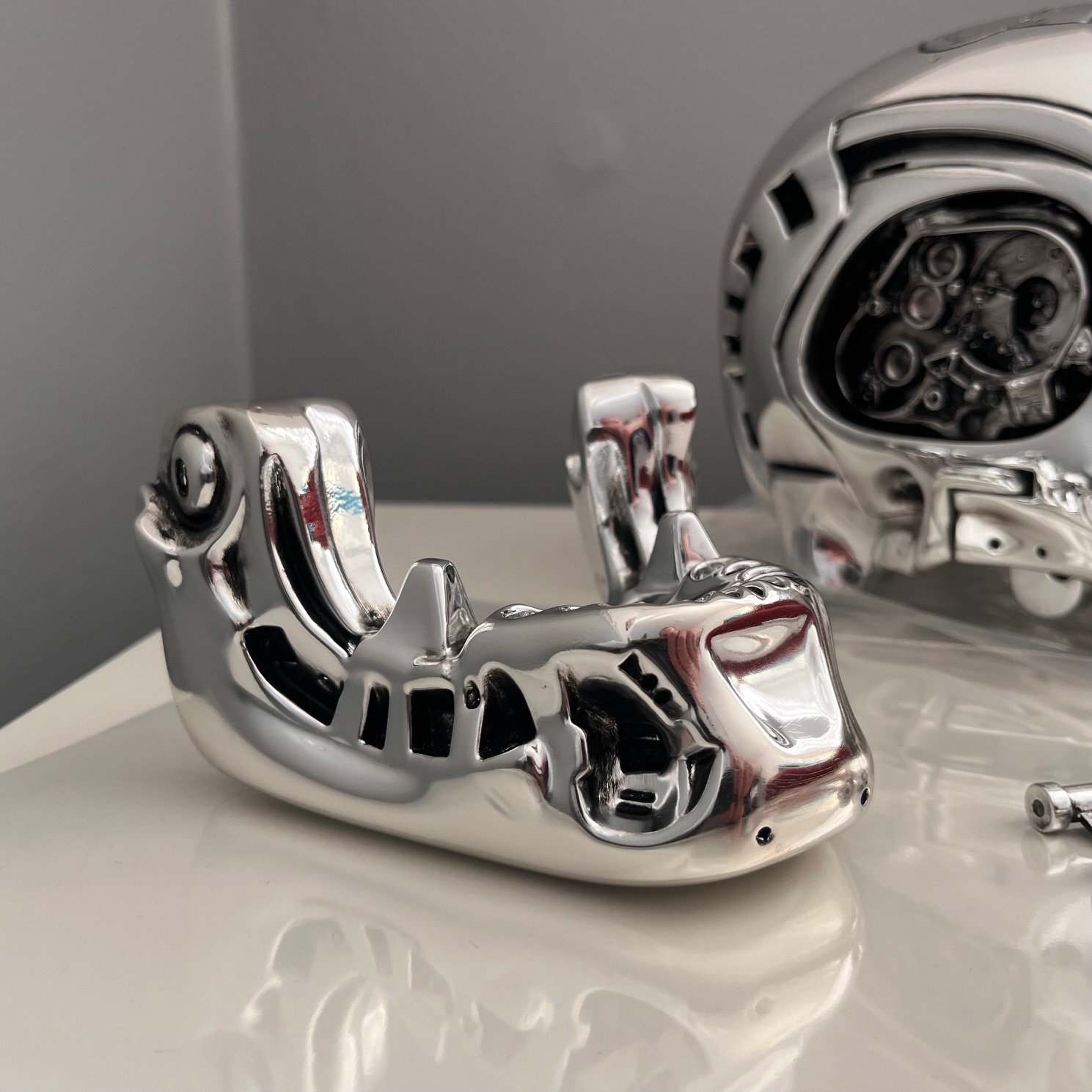

The parts came back from the vacuum metalizer looking really well

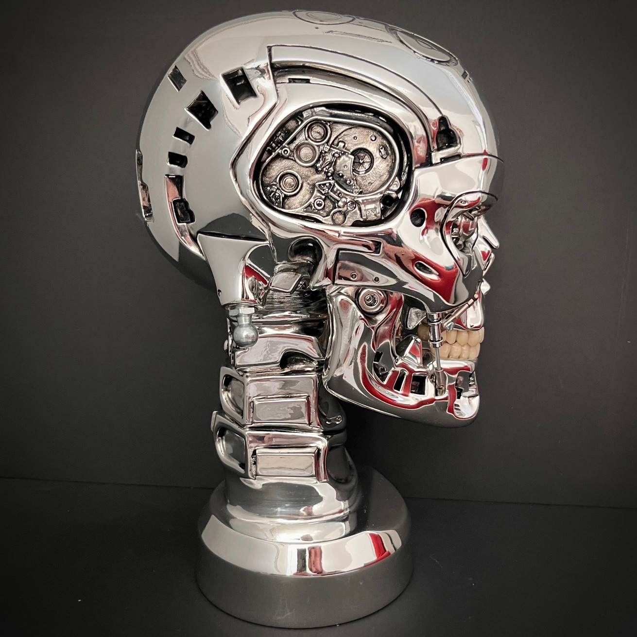

I then used a dark oil wash to weather the pieces

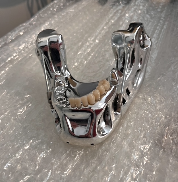

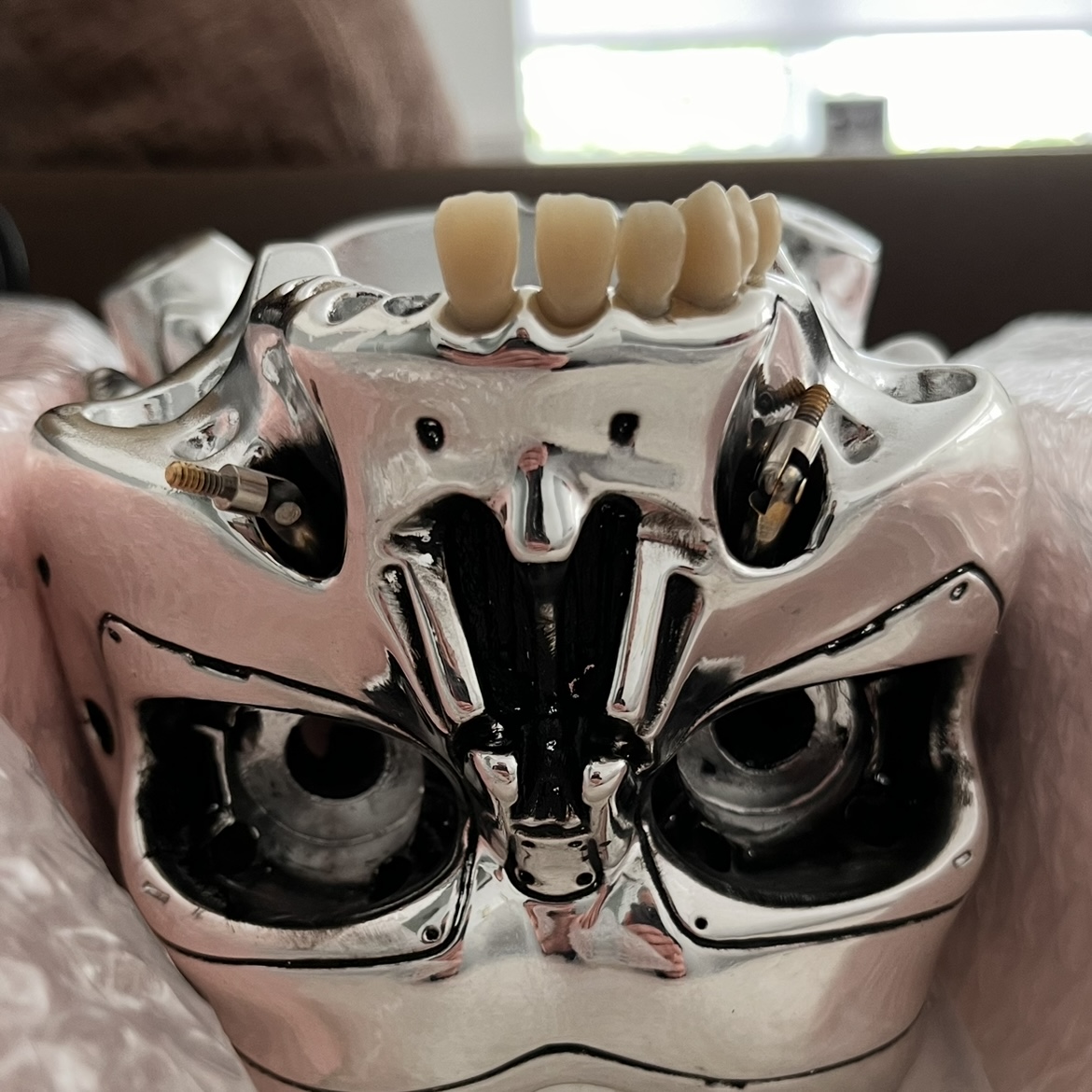

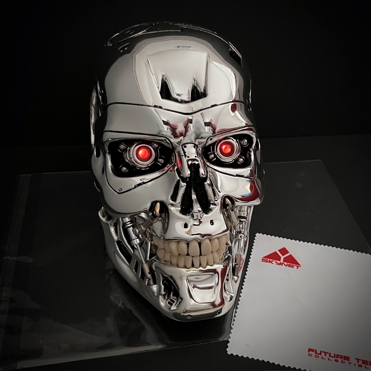

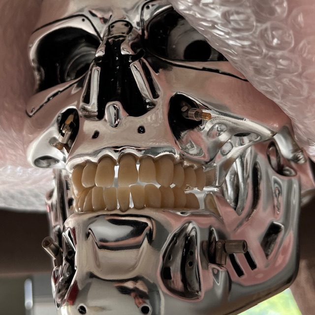

Then onto fitting the dental resin teeth

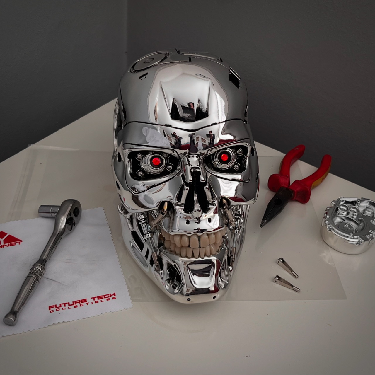

I then had to get all the parts bolted up.

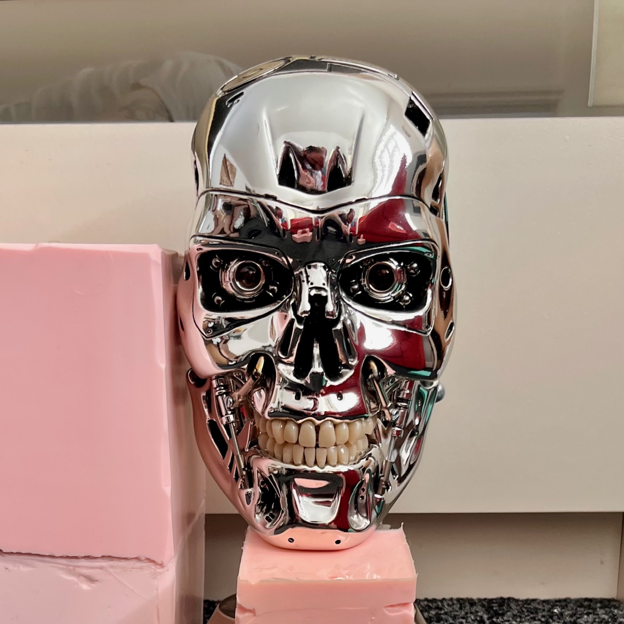

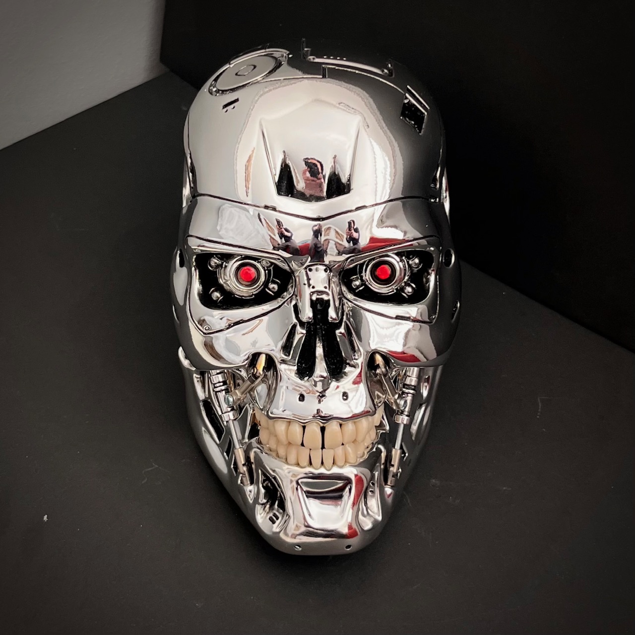

Then epoxied the neck and base to the skull.
And a little video of the final finished piece
