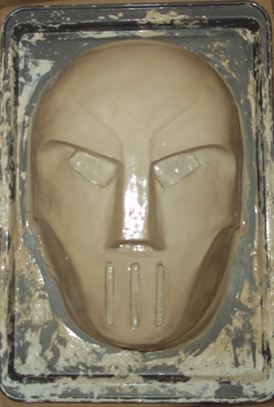

I built up the mother mold over the latex mold for the Casey Jones mask. I just need to let it dry and then I'll take up the whole thing from the sculpt and cast the final mask. :Dmmold.jpg

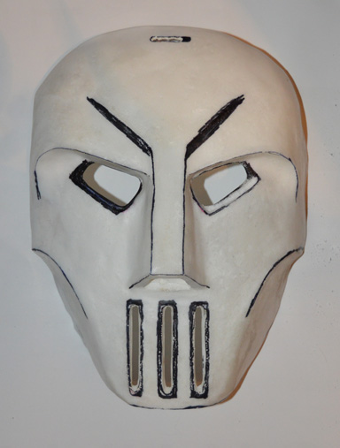

After a long lull in progress I've started working on this costume again. I got a bit discouraged after the mask didn't turn out as well as I would have liked, but looking at screencaptures of the real deal and comparing it to my mask I've managed to spot the areas that have room for improvement. First off the chin was a bit too long under the mouth area. I've already chopped about a 1/4th of an inch off the bottom of the mask and it looks much more in proportion already. The long face always bothered me so I finally went for it.
I've also taken a sharpie to the mask and marked off areas that need to be either cut away or filled in.
The eyes need to be expanded and cut out further. The v of the forehead needs to be more angled and end lower as well. The underside of the dark lines is going to be the new edge. I'm going to build the V up with JB waterweld. The stuff is like putty filled with magic!
Here is a current photo of the mask. Much more to come!
You can see I've already started to remove some more of the area around the eye on the right side, the masks left.
