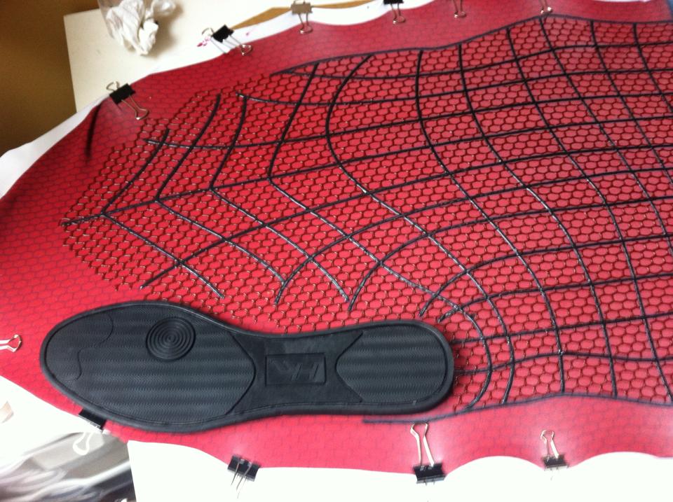

I'm probably 2/3 of the way through the legs and it feels like this purgatory is never going to end. Sooooooooo close.

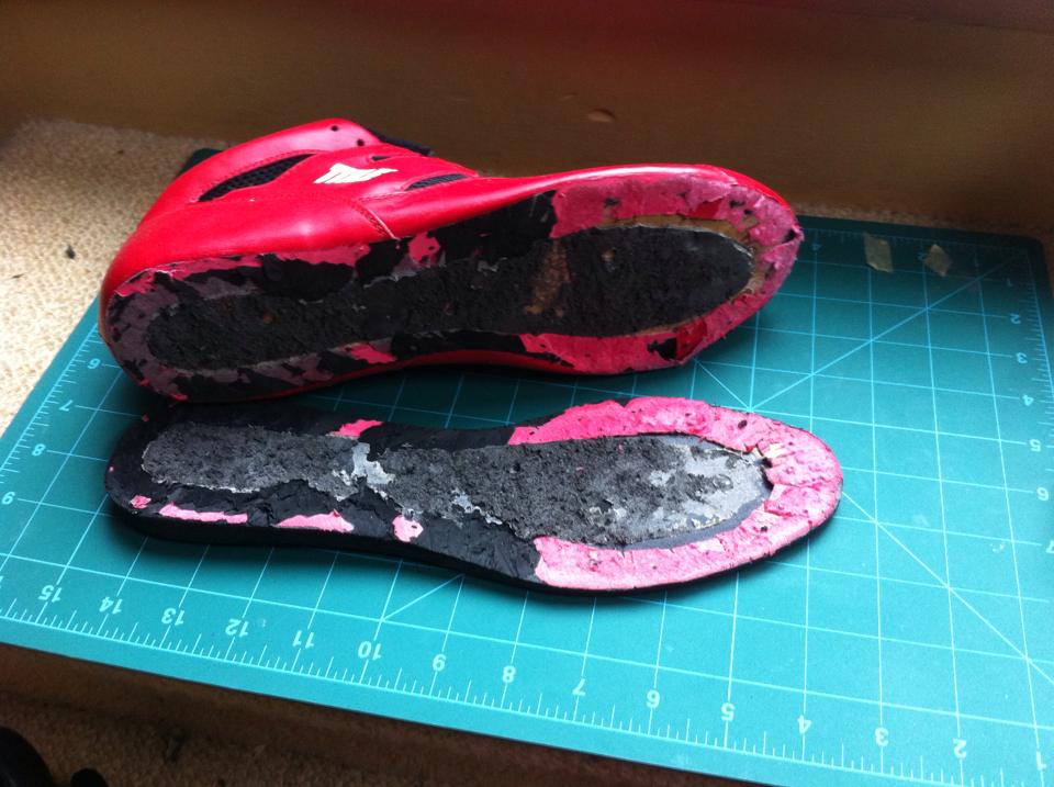

I did also disect one of the shoes, which was time consuming but very successful so I will post some photos of that when I take apart the second one.
Stay Tuned!
Okay, shifting gears here for a minute to talk about shoes. Puff painting is puff painting, and I'm on the home stretch. Looking to be finished by next weekend.

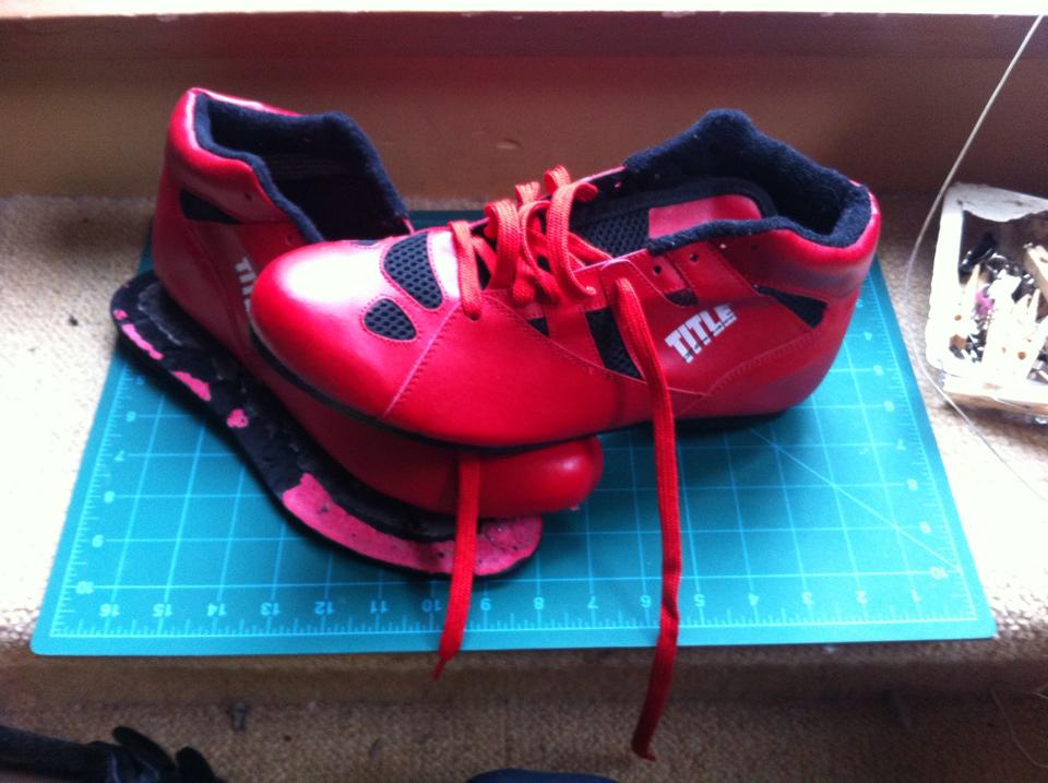

What I have for shoes is Title ankle high boxing shoes. Its kind of a shame too, since I also train boxing I know Title's gear is awesome.

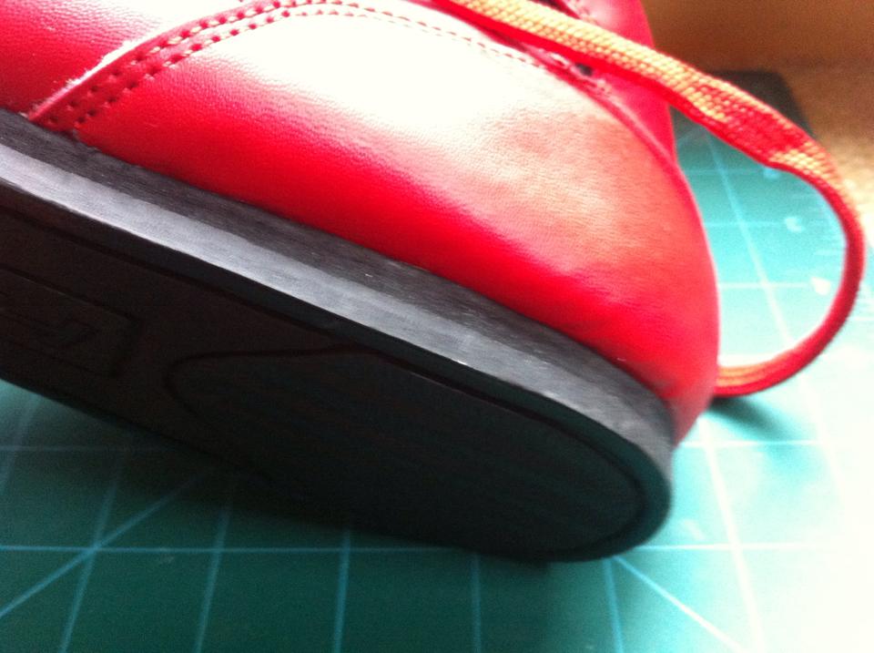

The plan here is to remove the sole in order to insert the upper into the sewn foot and glue the sole to the outside of the foot.

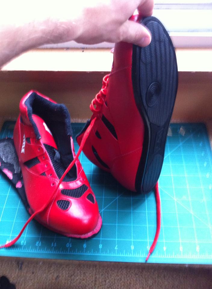

I used a hobby knife to get right into the seam of where the sole and upper meet and cut it away.
It looks really ratty, but all of this will be trimmed and hidden when its ready to get glued to the suit.
I really don't care about the "accurate" pattern on the soles.The TASM1 shoes were far more interesting to me, and a lot easier to achieve. These are fine, and nobody is going to be be looking at the bottom of my feet.

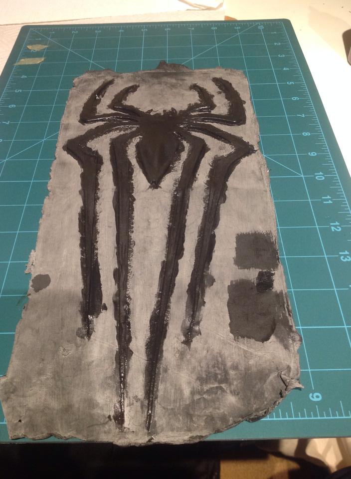

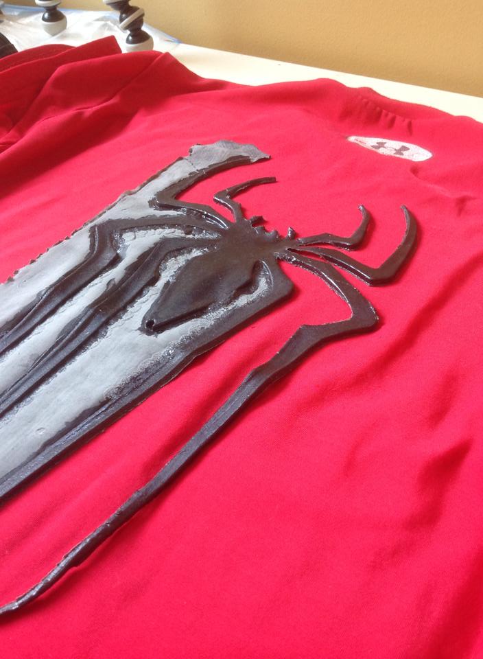

The spider is made out of latex, and needs to be washed, dried, and painted. I had a couple ideas about how to paint it, but honestly I ended up brushing on a few very thin layers of the puff paint I used on the webs. It will eventually peel off, but the adherence is good enough for everyday wear and tear if its thin enough.
Cutting it out sucks. I used a hobby knife and had to go tiny spot by tiny spot, since the latex will stretch a lot before cutting along the line you want it to. Around the points of the legs and the teeth are the worst.
And against red Under Armour for colour example (not the suit fabric)

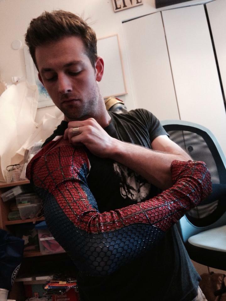

And first fitting! These suits are puzzles even with a really great guide, so it required some figuring out with my friend Maple Bunnie and I. It's also a challenge to tailor the proportions to exactly your own shape since even if the pattern is scaled, your shape is unique.
Apologies for poor quality iPhone photos.
The most challenging areas I think are going to be the gloves, the mask, and getting the belt section to sit just right, but I love how its coming together.
