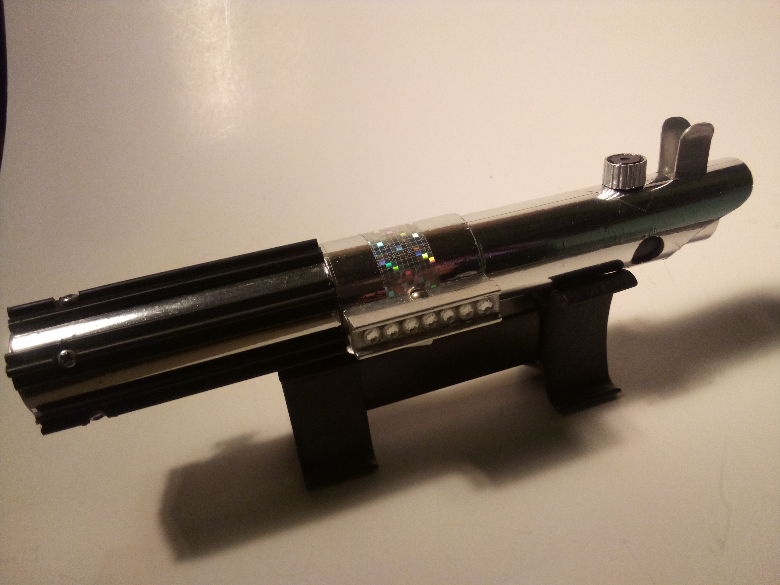

Are you able to post up dimensions of this plastruct track? I’m curious if you split it to make two rows of T track, or use the full height and just trim one side of the H
It reminds me of the Energizer Bunny saber track!
Just cut off one side at full height.

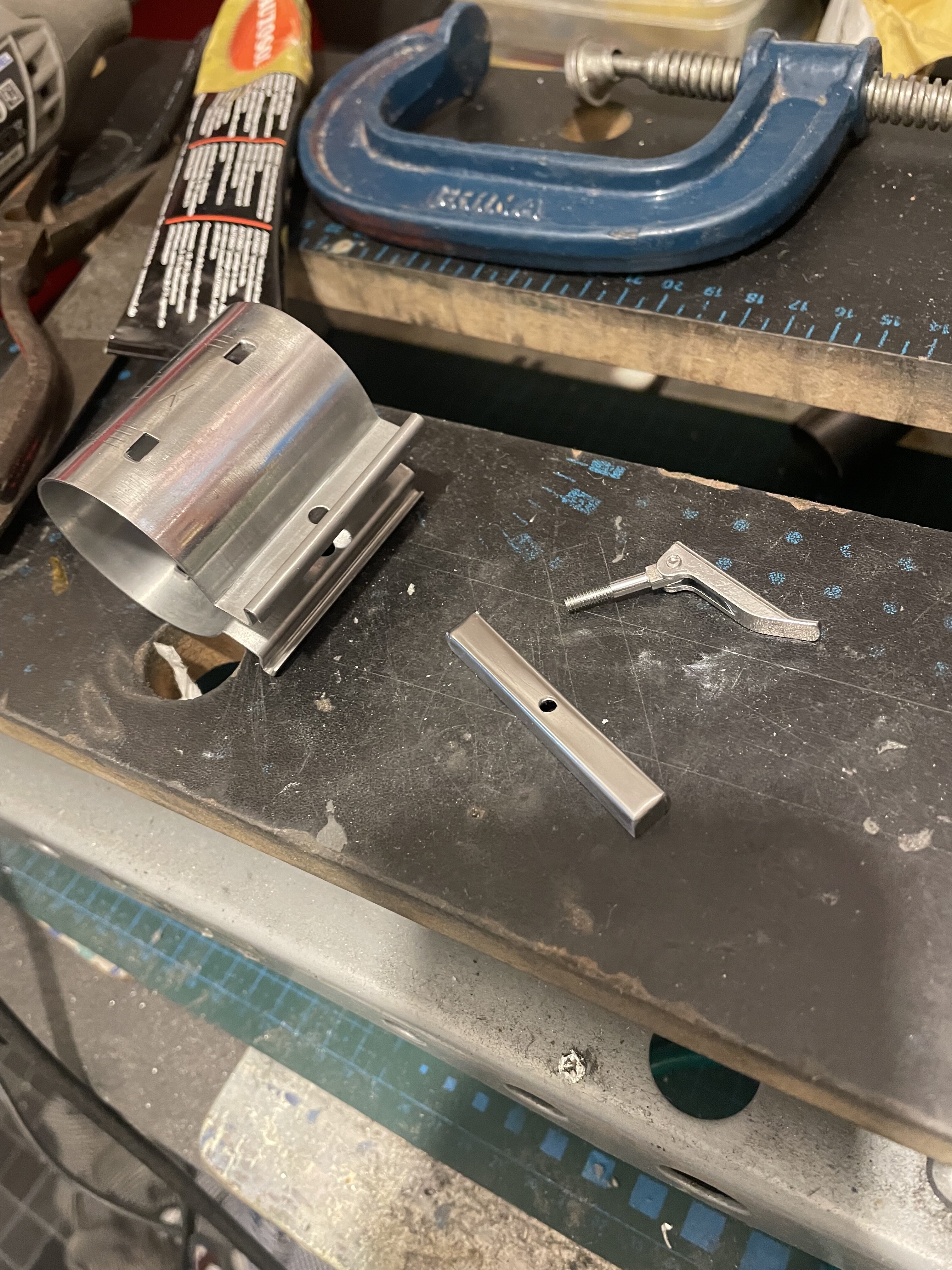

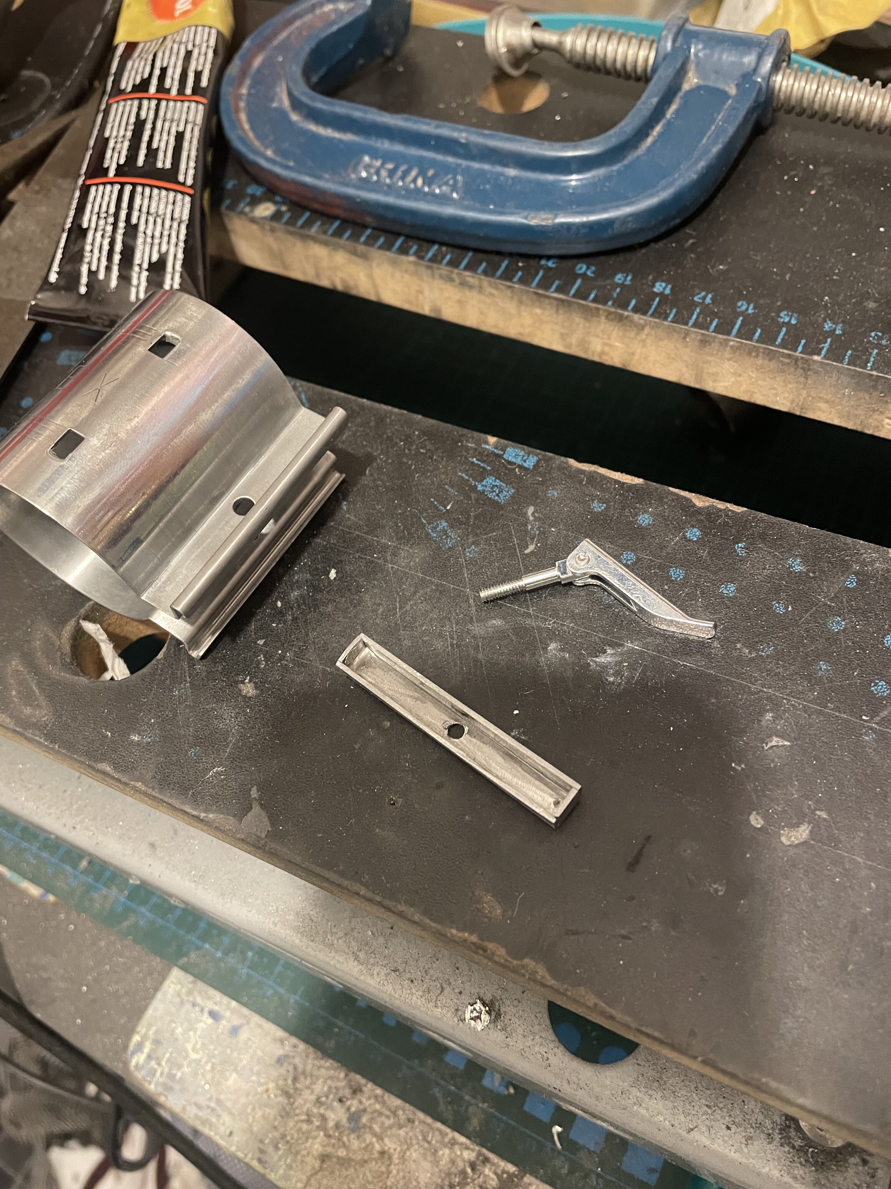

Thanks. Unfortunately there's no simple solution to the clamp. I'd say get pack of step flashing, a pair of needle nose pliers with a long straight edge, and start bending!
The clamp I acquired didn't have the bars or a lever, so I had to supply my own.
Here's the aluminum sheet you want. It's thin enough to bend easily, and cheap enough to make a few mistakes. I haven't bought it in a while, but it should still be available at Home Depot.

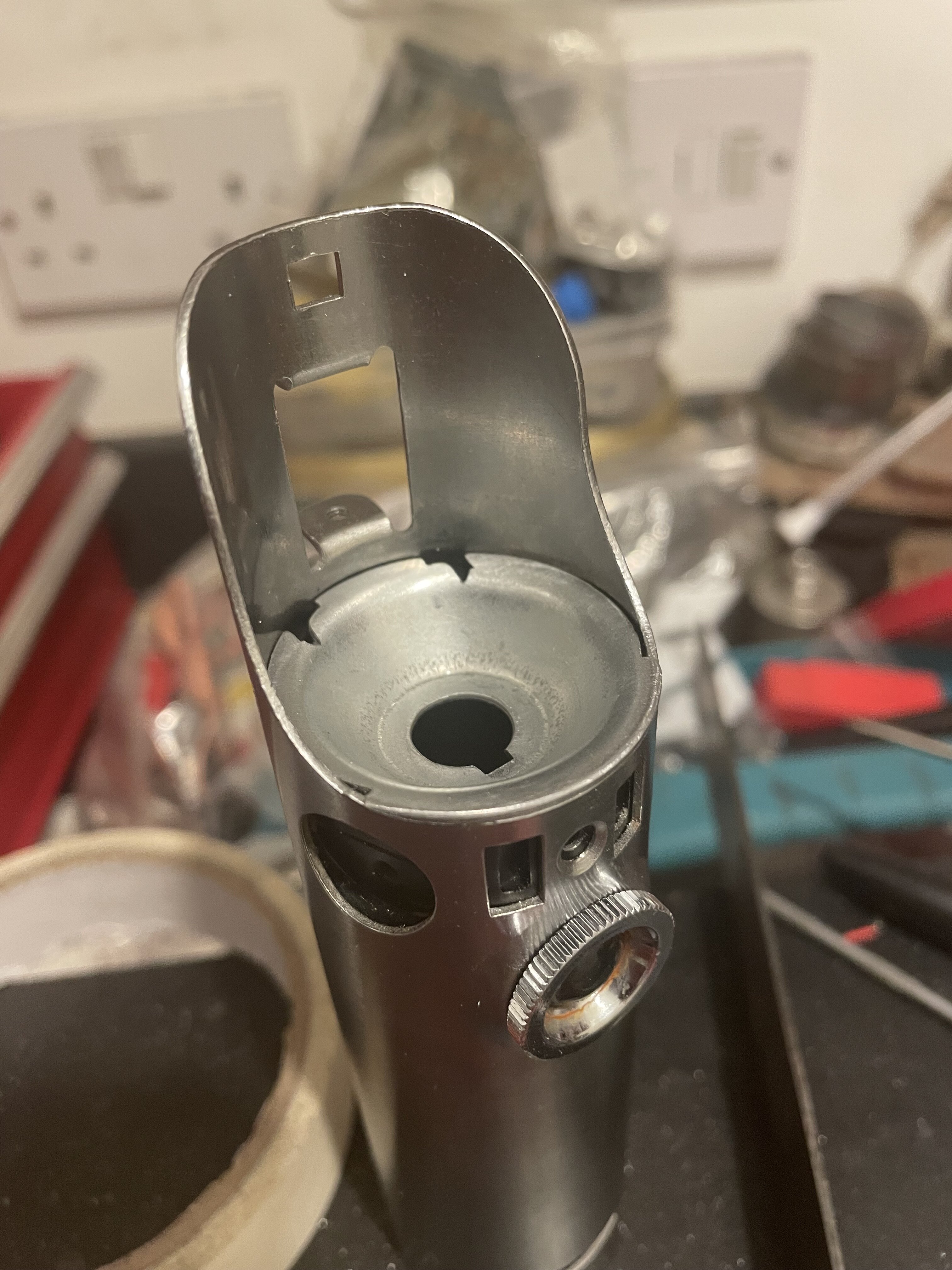

Don’t mean to highjack your thread, but it helped me when I needed to make some replacement clamp bars
So I thought it would belong here.

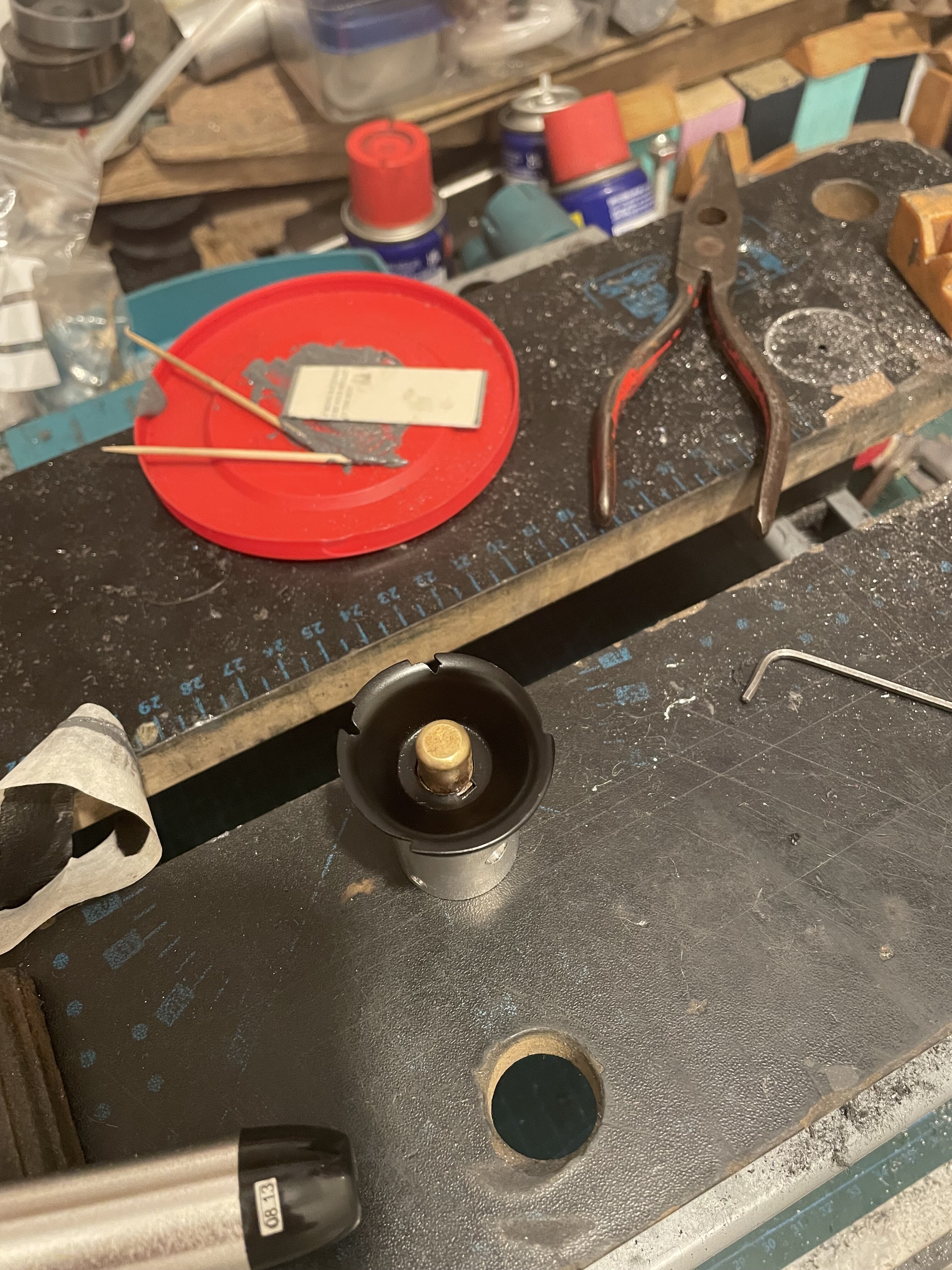

A while ago I acquired some graflex parts, mainly a top, bottom and a few clamps, but there were quite a fair bit that was missing, the main part was the bulb socket, though I did get the brass connector.

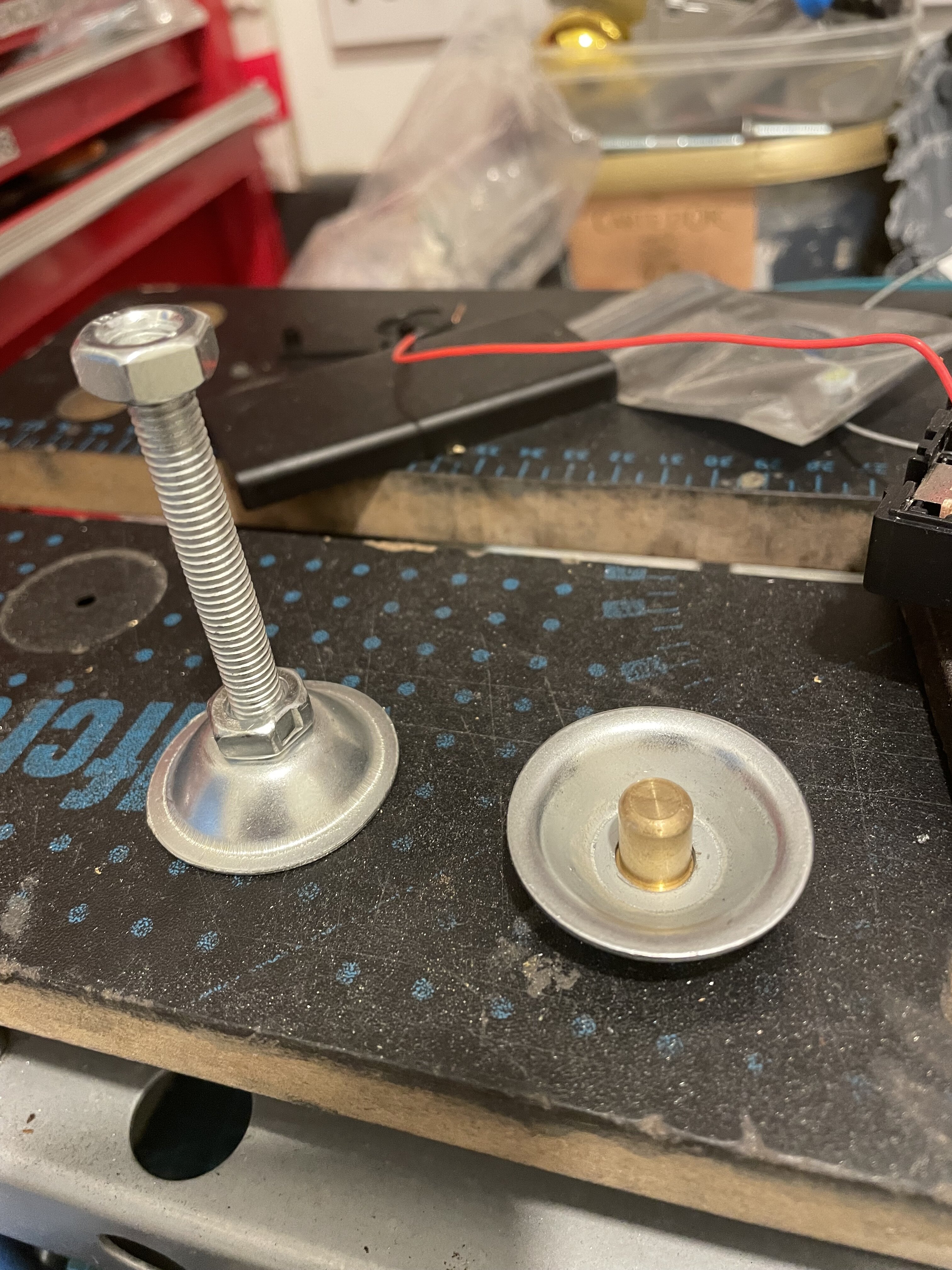

My solution was to make my own, I found these 38mm clamp cups, or adjustable feet that looked a close match with a little modification, I was also able to add a sping aswell

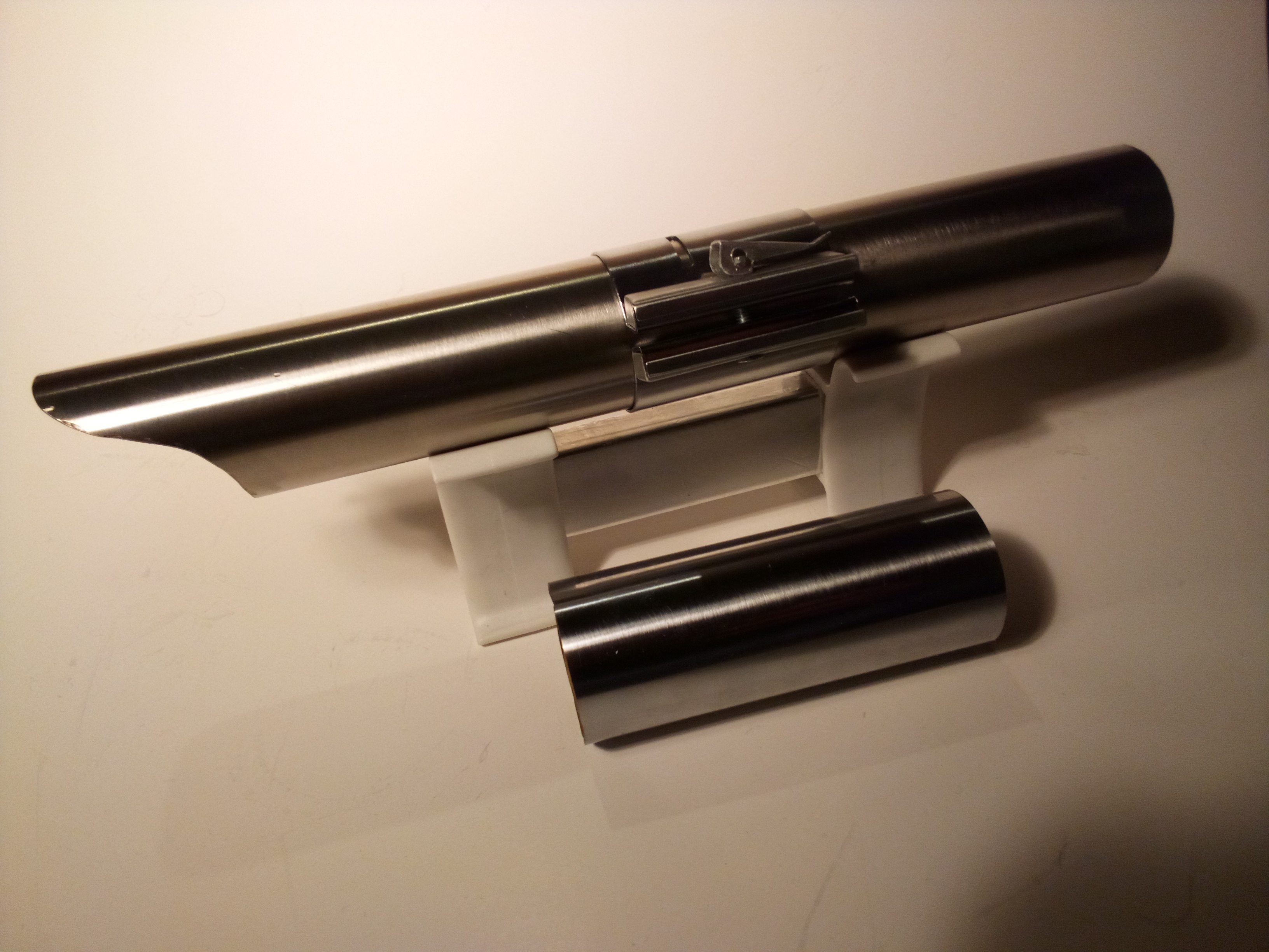

The grab bar tube with the clamp attached. The other tube is a scrap of plumbing pipe with the brushed metal look applied with a Scotch Brite pad.
