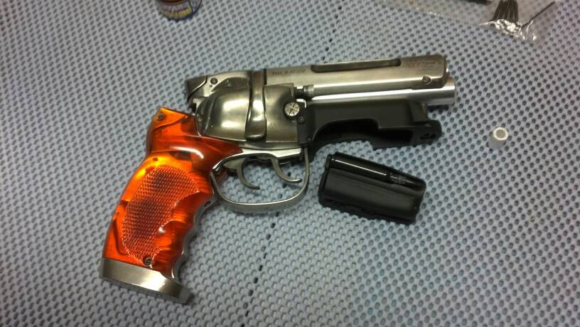

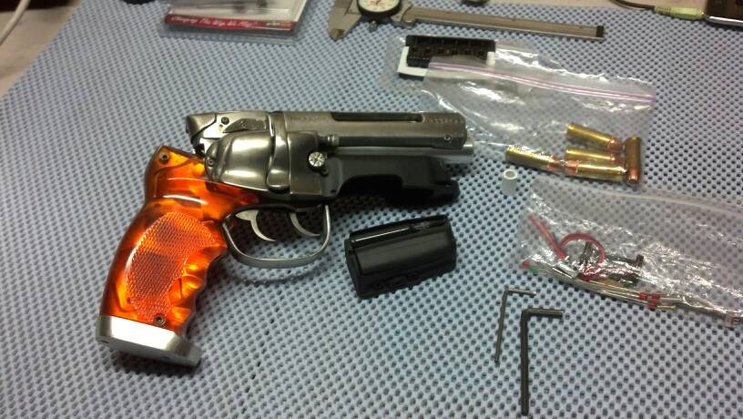

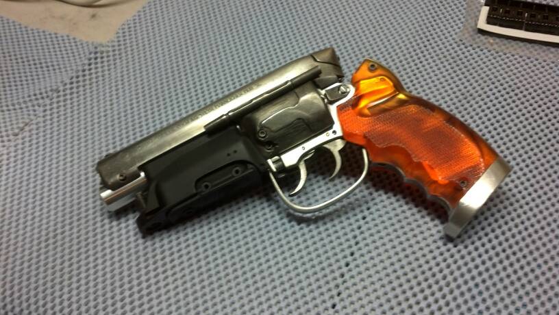

Tackling my second Coyle metal kit build!
I haven't started the ammo clip yet, I'm currently awaiting its arrival from Rich...the one in the photographs is broken and can't be wired the way Rich dies his so I'm getting another. When I do I'll post up a bunch of photos on how I do it...

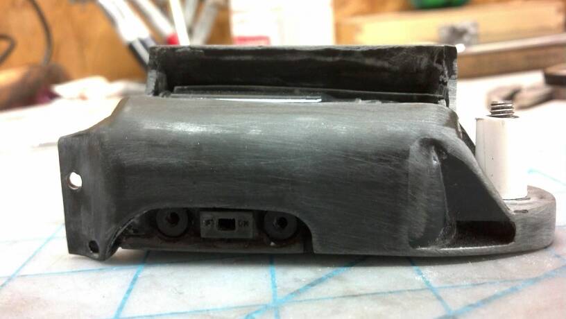

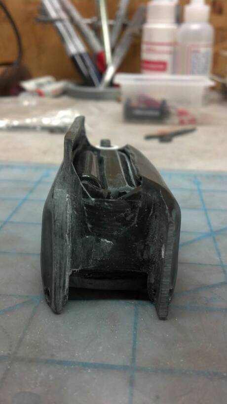

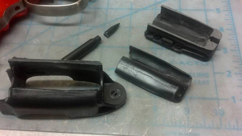

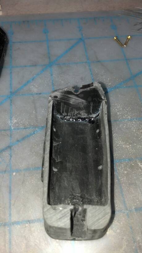

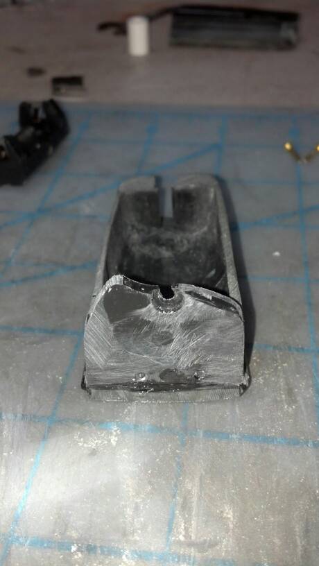

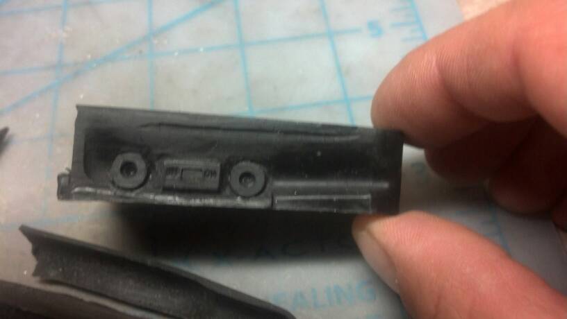

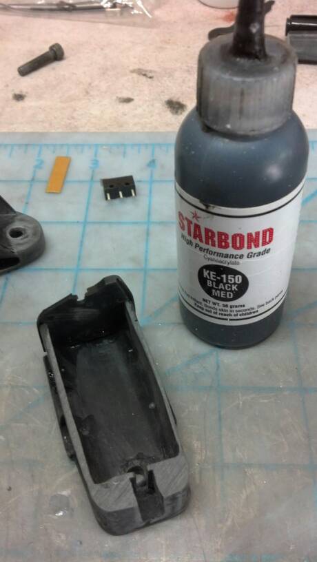

Here are some shots of the ammo clip in progress... first filed down all the high spots and leftover resin, then sanded it even with 220 grit sandpaper to smooth it out and finally 400 grit to polish it up a bit..then using black super glue...I glued the back part of the housing on after drilling the two holes needed for the brass nails to poke through.
uploadfromtaptalk1403902136815.jpguploadfromtaptalk1403902148650.jpguploadfromtaptalk1403902159259.jpguploadfromtaptalk1403902173614.jpguploadfromtaptalk1403902186191.jpguploadfromtaptalk1403902211827.jpguploadfromtaptalk1403902225304.jpguploadfromtaptalk1403902243737.jpguploadfromtaptalk1403902260322.jpguploadfromtaptalk1403902274756.jpguploadfromtaptalk1403902285401.jpguploadfromtaptalk1403902303800.jpguploadfromtaptalk1403902315198.jpguploadfromtaptalk1403902332275.jpguploadfromtaptalk1403902343463.jpguploadfromtaptalk1403902356544.jpg

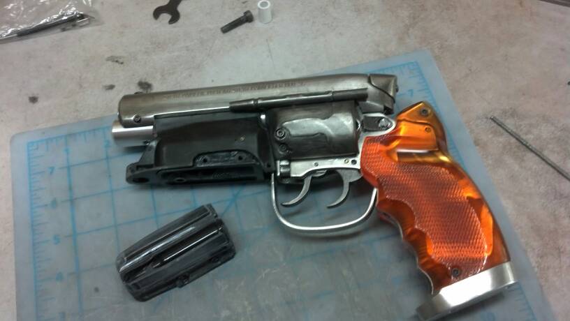

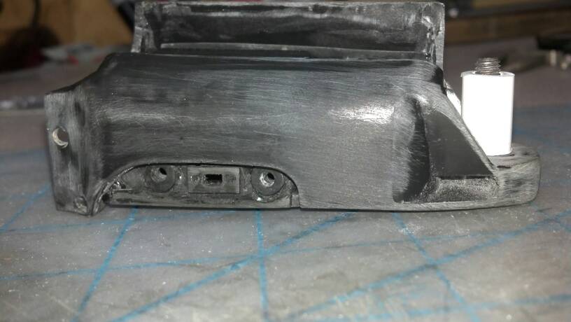

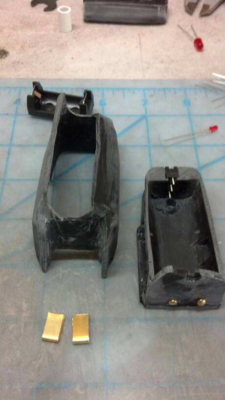

OK...so, there you can see how the brass nails are supposed to align with the back brass flat connections when you insert the clip and also that the small click switch gets installed in the front of the clip...I have to say also, be sure to test fit everything before painting and wiring because you may have to refit a few pieces after you paint but its worth making sure everything fits first...uploadfromtaptalk1403902541119.jpguploadfromtaptalk1403902550345.jpguploadfromtaptalk1403902560583.jpguploadfromtaptalk1403902568454.jpguploadfromtaptalk1403902576264.jpguploadfromtaptalk1403902583383.jpguploadfromtaptalk1403902592391.jpguploadfromtaptalk1403902601370.jpg
I will begin the wiring soon after I paint and get the ammo housing and clip where I want them finish wise...hope these help! Cheers!

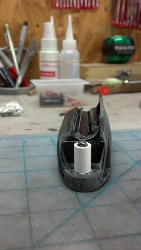

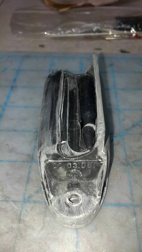

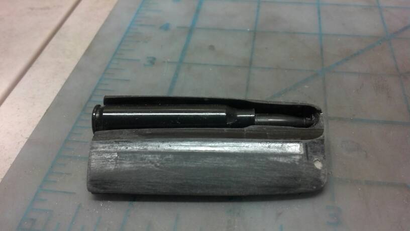

Here are some better detailed shots of the ammo clip beginning construction...

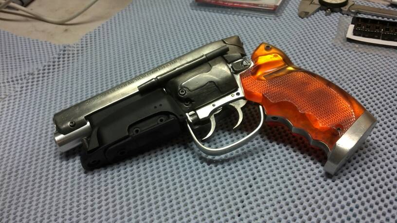

OK...I painted the ammo clip, housing and top cover today using my airbrush on a fine mist in three coats...I think it came out pretty nice. I'll put a final gloss coat on after I do the side covers and site rod tomorrow... here's a few shots!
Enjoy! uploadfromtaptalk1404017257494.jpguploadfromtaptalk1404017272363.jpguploadfromtaptalk1404017283538.jpguploadfromtaptalk1404017295496.jpguploadfromtaptalk1404017305065.jpguploadfromtaptalk1404017311758.jpg
uploadfromtaptalk1404017366776.jpg...

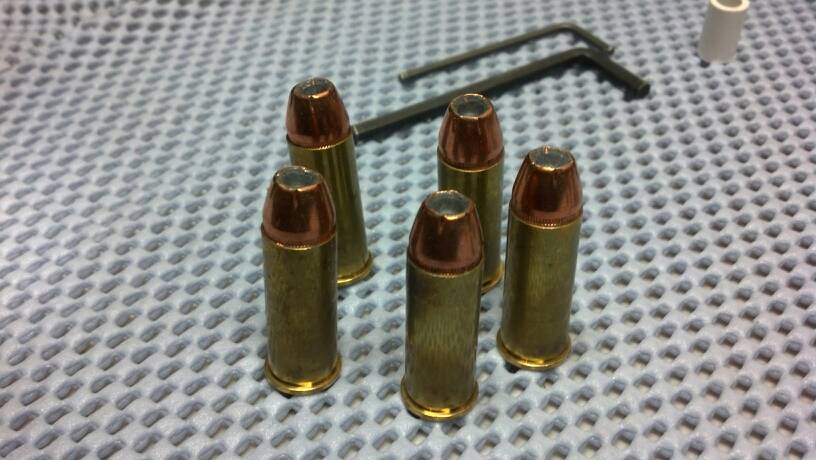

and last, here are the FAKE hollow point .44 rounds I'm going to load into the cylinder.
