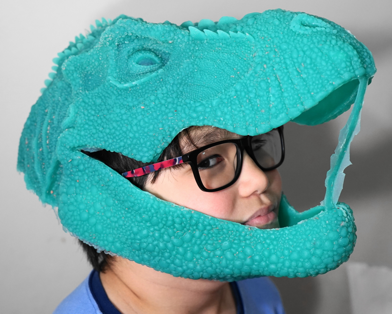

Test silicone cast with new thicker core. All the detail was captured with a straight gravity pour of Dragon Skin NV (no bleeder holes or vents). I really love Dragon Skin NV! This cast is lighter than the first one, but I still very heavy.
I made this core with Task 15, which was much easier to rotocast than the last one I tried with 65D.
Apparently the dino is big enough to also be a mask!

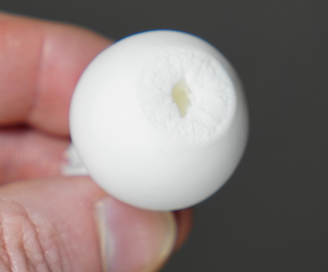

Here is a first casting of the eyeball in Smooth-On Task 15 resin.
Next up I will try to pull the real one with full coloring and detail. I guess it is time to learn how to patch and paint silicone.

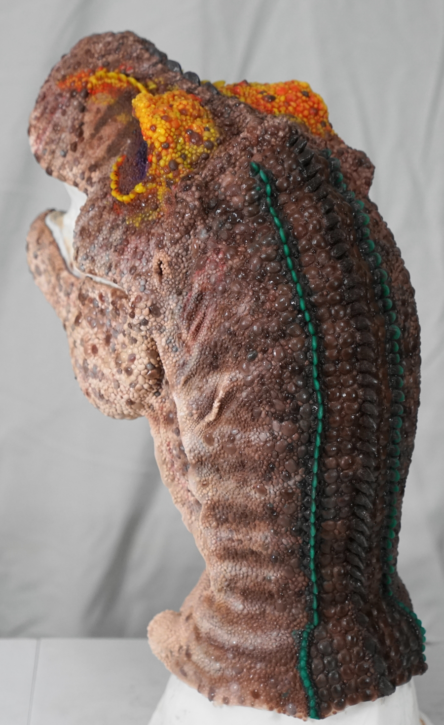

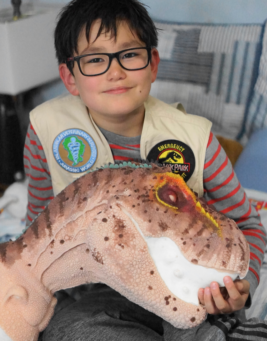

Okay, I finally got a skin I could patch enough to use... so here is the silicone skin.
1029361
1029362
1029363
1029364
Lately I have seen a number of things online saying T-Rex might have had orange coloring above his eyes, so we went with that idea. I painted many different colored print coat areas of Smooth-On Dragon Skin 10 Med in the mold for the basic coloring and then poured the rest with Dragon Skin 10 NV.
I did my best to seam and patch the skin -which I found out I am VERY bad at and reinforced the thin/bad areas. Lastly, I added more detailed coloring by airbrushing Psycho Paint with Silc Pig colors through a Paasche H airbrush.
I signed up for a Stan Winston school monthly account and found the videos to be very helpful. This skin would have been ruined without the help the silicone seeming and painting videos provided.
It has taken almost exactly a year to get this far.
Now on to sculpting teeth and a mouth interior!
