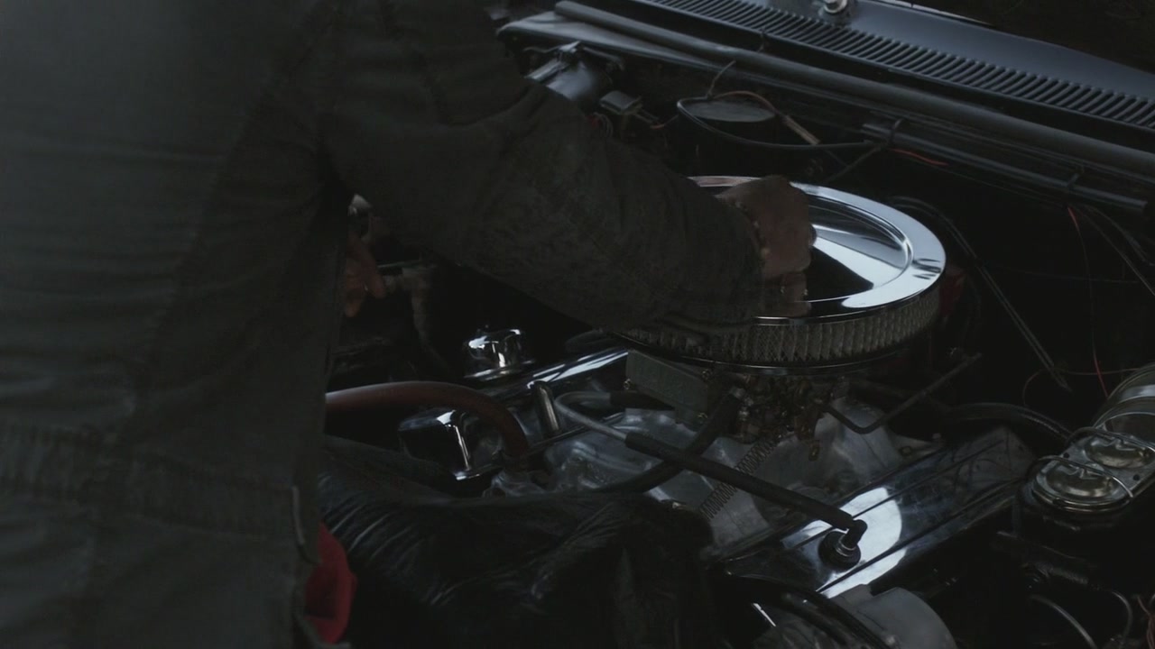

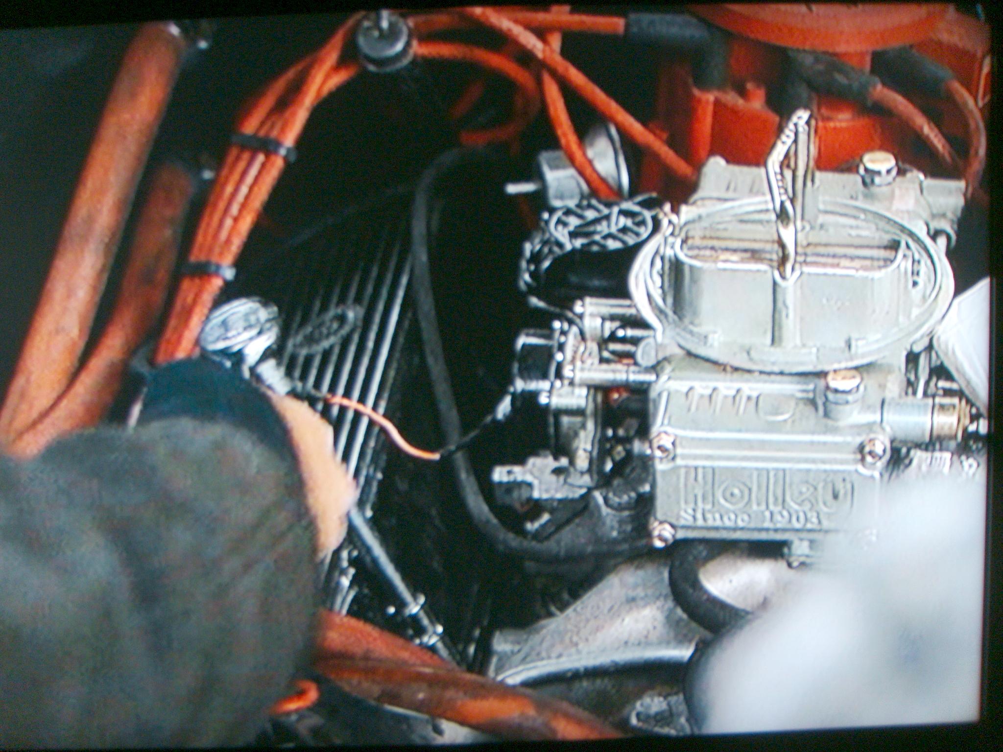

While you are dropping off sweet screen caps Russ, you have any of the engine bay? In quick glimpses I've noticed a Holly 4 barrel carb, and the for mentioned valve covers. A nice high res engine bay shot would be awesome if someone has one laying around :)
I've just started my annual Hellatus re-watch of the show.
If a scene pops up with a decent shot of the engine bay, I'll let you know. From memory, even with the hood up, the show rarely focused on what was under the hood.
I do not have high res shots of the cars engine bay but I do have a finished screen accurate impalas engine bay... I have a good buddy who has built a scree used one and know what parts they use. email him and he can help you out. projectthx138@hotmail.com
Lee, Probably not the best, but it's the only one I have. I'll see if I have any others. The picture shows more than you realize. You can see that it is a Holley carb, the type of valve covers, the distributor type and intake manifold.

Hey LeePeyton, at least you have a 67 and that's a lot more than some people have...................... ;) OK, let me see if I can answer your questions here about the Hero car seen in the photo. First off the engine is a 327. The Intake is the Edelbrock Preformer with a Holley Carb sitting on it. The air cleaner and valve covers are just your run of the mill chromed pieces. The engine has Summit racing headers (black) on it. the car also has a CPP master cylinder and power booster on it as the car has front disc brakes. What can not be seen in this photo is the Mallory 8548201C Distributor. The engine also has red plug wires on it. Everything I just mentioned can be bought on Ebay...... :coolNow that that's been said I would not run the Mallory Distributor if you like driving your car as it is one BIG PIECE OF CRAP............. :devil Also I'm not a fan of Holley Carbs but to each there own. Last thing I would not get the black painted headers as the paint burns off REALLY FAST and the headers start getting rusty. I prefer the same headers in the ceramic coated version as they always look nice and they will last a very ong time................... :)
Hope this helped you out
