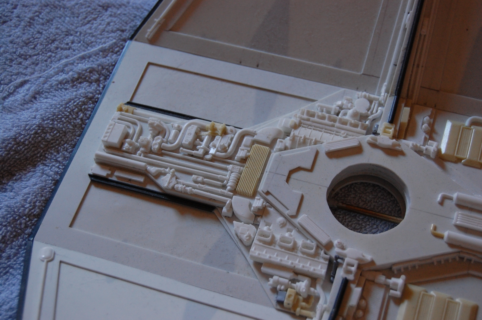

I just started working on the Tie Interceptor, my first studio scale model. Kitbashing and identifying the model kits is new to me, but I think I found parts of the following model kits which were used on the wings:
Tam. 1/12 Tyrell 6 Wheeler
Tam. 1/12 JPS Mk III
Tam. 1/20 Ferrari 312T3
Tam. 1/20 Tyrell 6 Wheeler
Haseg. 1/72 Mörser Karl
Tam. 1/35 Flakvierling
Tam. 1/20 JPS MK III
I still have difficulties to find all those small parts especially on the wing edges (some are from the Mörser Karl) and which ship(s) were used (1/700 Prince of Wales) Maybe someone of the pros here at the Studio Scale Forum could give me some hints which kits are missing in the list above :) Any help would be much appreciated.
Thanks!

Wow! I just realized I started this scratch built almost 2 years ago! Here are some photos of my progress so far.
most of the hull parts are finished, the cockpit is currently under construction.
I am happy with the overall dimensions of the wing, the kit parts fit quiet nicely on the styrene parts but the wing dihedral looks wrong :-(

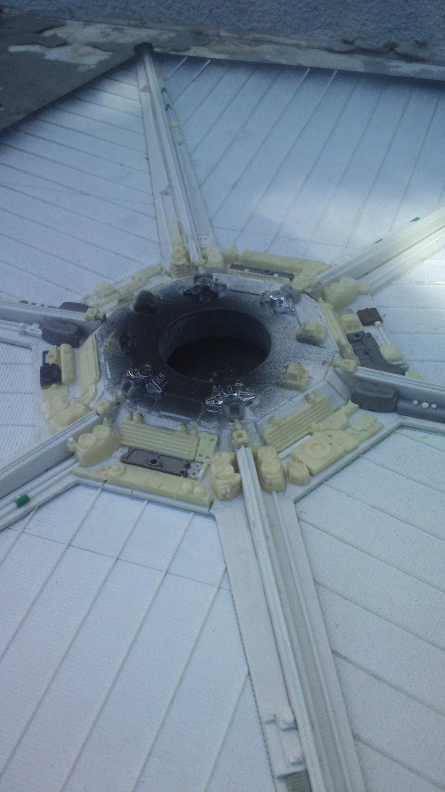

Yes I know about the discussion about the right size (5, 5.125, 5.25) The underside of the cockpit interior is almost finished (unfortunately not 100% original kit parts)
Here a quick photo how it looks:
oh and I really hate camera distortion :(
A 5" ball is too small (no need to take any measurement, just put the parts on a 5" ball and you'll see it wont fit well).
Dont have the measurement from an original cockpit ball but from an original ANH cockpit hatch, and it doesnt fit a 5" ball (got the diameter of the pipe they used for the wing support from an original ANH TIE too, Im not at home so I cant check what was the correct diameter).
Alonzo Fonzo's cockpit confirms that's a bigger ball looks better with all the kitparts on it. Awesome job so far ! Cant wait to see more :)
Thanks MonsieurTox!
Does anyone know the right angle of the wing? I built it with 30° which fits with the height from the Chronicles book, but it looks too "flat". It´s incredible difficult to measure the angle from photos or screenshots.
