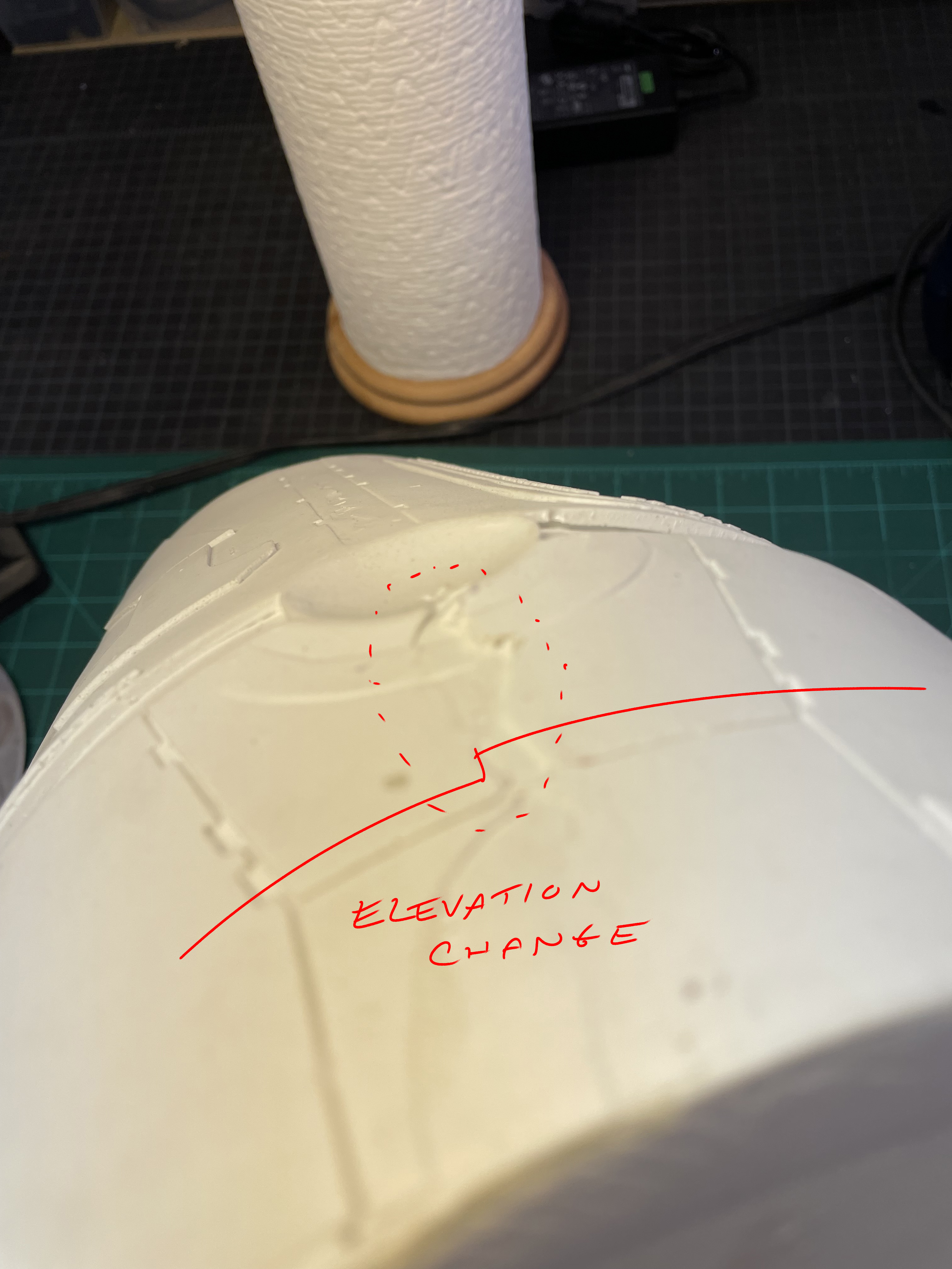

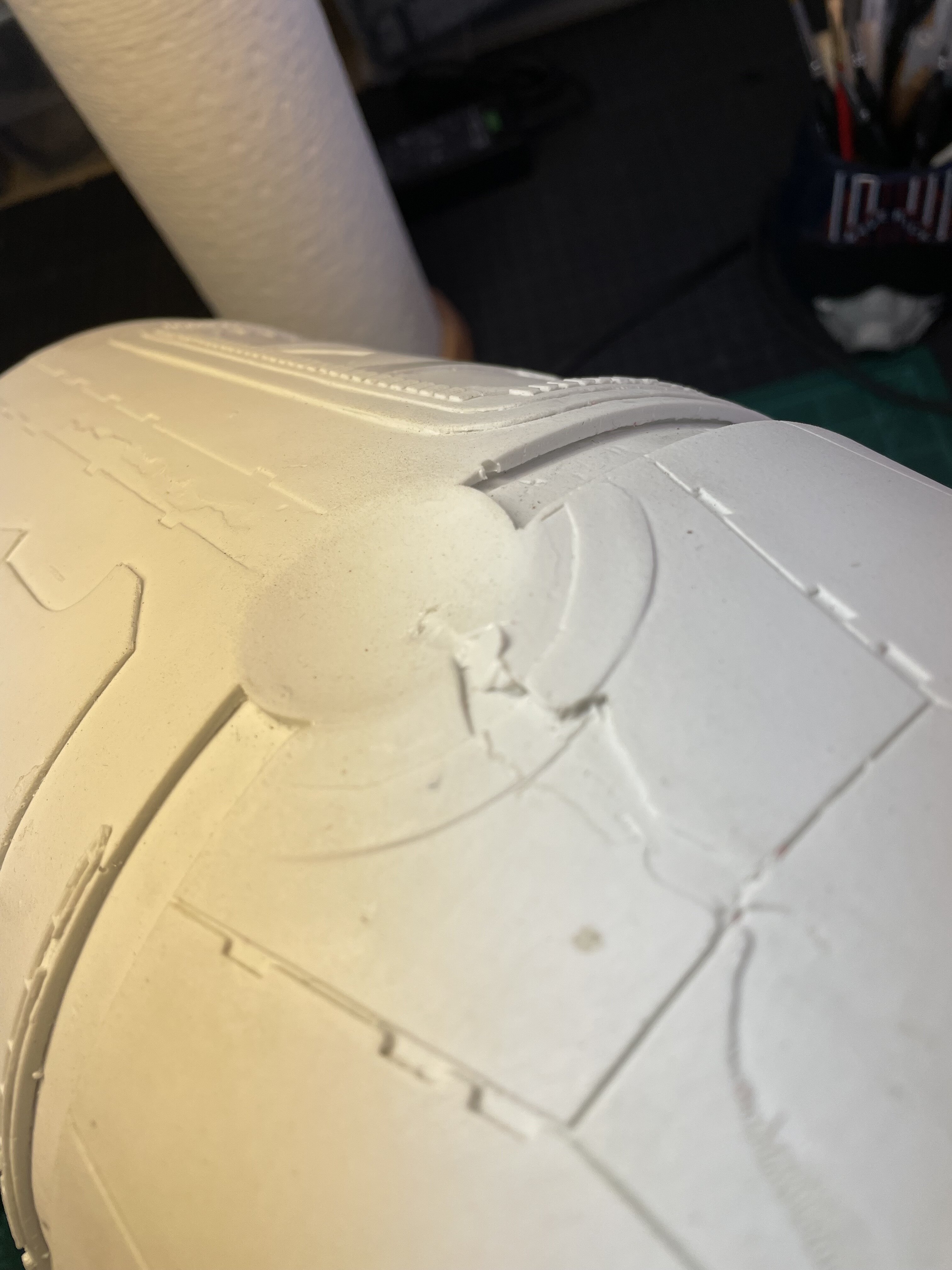

I got this kit from someone in trade a few years ago and have decided to tackle it. Problem is, the main body has an area that looks like the jacket for the mold was misaligned, and there a large step or elevation change in one of the areas with the bowl shaped depression, see pics.
I'm thinking just grind out the area back to round with a dremel and try to reconstruct it with Evercoat, but now I'm noticing a large area on the other side where the whole body is flattened a bit and completely out of round. How perfect was the ILM pod?
Seems like a lot of bodyshop work to correct, I have half a mind to just 3d print a whole new body and use the rest of the cast parts.
Any ideas or advice from some of you old hands would be appreciated!

Looks as if the casting had some issues when being made, which is not unusual if this is a studio sized pod. I'm thinking you're doing the right thing in filling the uneven section. For the depression, if you are brave, you may try using a hair dryer to see if you can push it out from the inside. If you've never done this before, I urge you to be careful. Too much heat will soften the resin too much and you'll end up with a worse mess than before. Heat evenly from both sides and push out slowly. If it doesn't move, heat it up again for a few seconds and try again. Keep cycling until you feel and see the resin rise. Once you have the shape you want, cool both sides with a cold cloth, so that the resin doesn't return back to it's original form.
