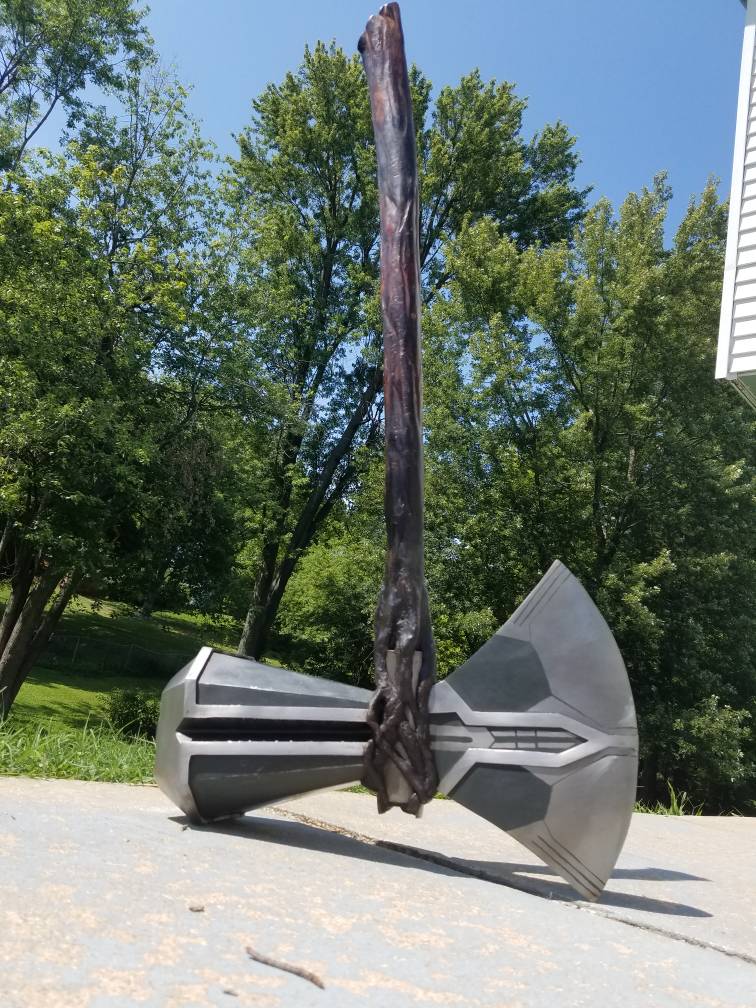

This is my attempt at making a full scale steel Stormbreaker! Ive made metal Mjolnirs in the past, but this is a whole new level. Most of my dimensions are based off of a 3D model i found on Do3D.com as well as taking reference from the Hot Toys Thor figurine. This isnt so much a step by step post, but more a sampling of pictures ive taken along the way. Let me know what you think!

More progress on the project. Ran out of welding gas so in order to stay productive I started on the handle. Its a branch of osage orange and it is tough, hopefully tought enough.
Shaved it down with a draw knife and carved in the grooty detail with an angle grinder. No stain was used. All of the brown came from running a propane torch over the wood and buffing with steel wool.

Update on the progress, all of the trim pieces are on and the handle is set. Because my etching turned out alittle faint ill be painting the etched areas for better contrast. After that I'll be using Apoxy Sculpt for the vines that wrap around the head. The end is near!!
