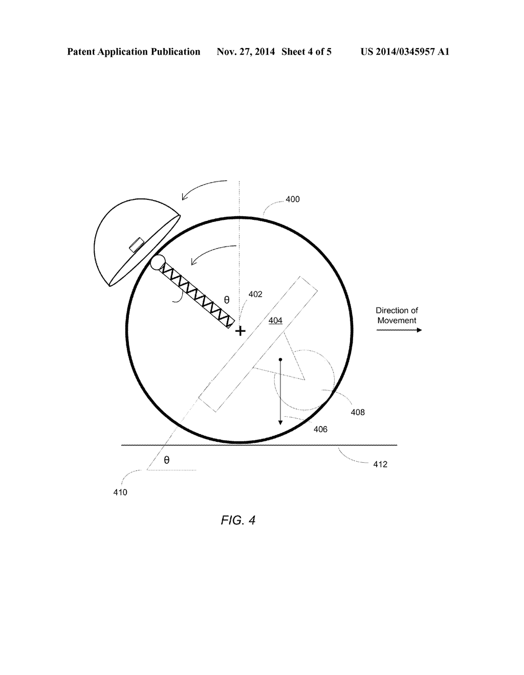

This was linked to on the astromech builders page. All these guys work on Sphero.
Patent application title: [SIZE=+1]MAGNETICALLY COUPLED ACCESSORY FOR A SELF-PROPELLED DEVICE[/SIZE][SIZE=+1][/SIZE]

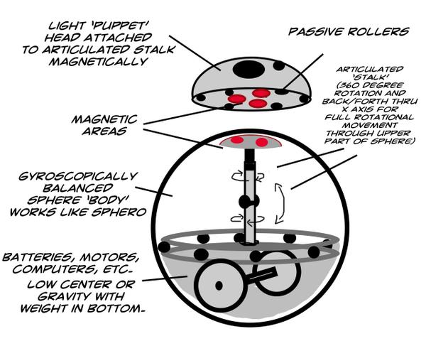

Nice, magnets it is then! After watching again the way the droid moves in that video, I take back the idea that there's anything in the head -- the head does seem to lead where the droid moves. You can sort of picture the point of contact being exactly where that spring/"biasing mechanism" would come up at a perpendicular from the drive carriage.
Perhaps the carriage is able to tilt just a bit before the ball starts to move, creating that head movement while the ball is at rest. I wonder if there is still a way for the head to spin independent of the drive carriage. That would allow the head to look side to side while BB-8 is driving in a straight line, as it seems to at a couple points in the video. A central magnet to hold it in place, and then a second magnet that mates with another inside the ball that is on a spinning ring that is concentric around that central magnet?
Mattonymy appears to have it correct. I'm about 99% sure this is the actual patent for BB-8, based on the description of how everything works.
If you haven't read the description, I suggest going to the patent page and doing so; it's super informative.

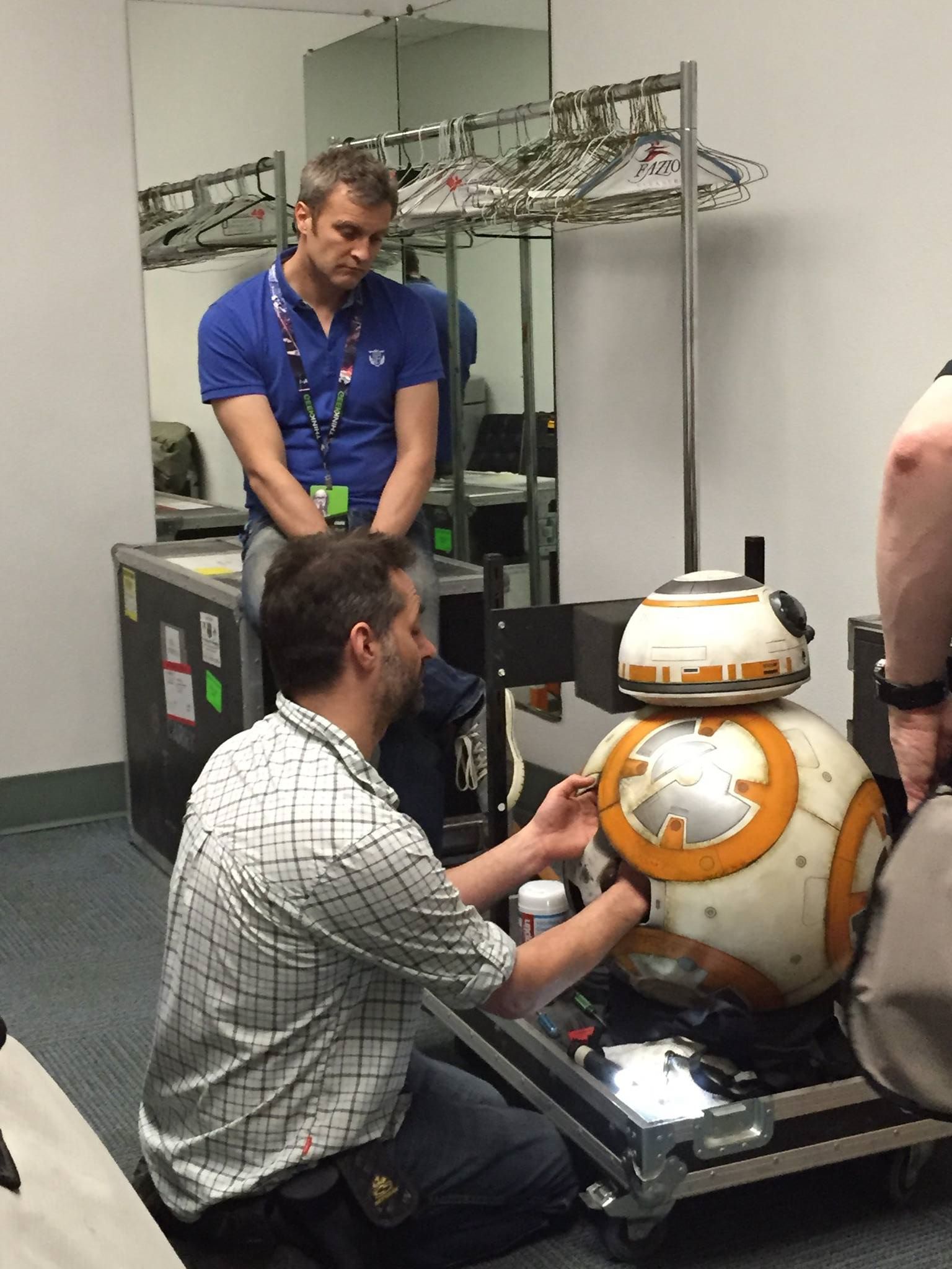

What do you guys estimate the diameter of BB-8 to be, 18"?
I did some rudimentary math and comparison measurements from when BB-8 was on stage with R2-D2.
I came up with an 18" diameter body, and a 10" diameter head.

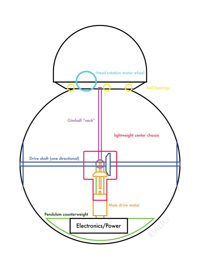

Here's an idea i've got. where the centre chassis holds the main drive motor, and the rest of the pendulum gives it turning ability by swinging side to side.
with option to rotate the "pendulum" or a weight attached to a motor/servoto achieve sphere/body rotation.
On top of the centre chassis is a "neck" ball jointed preferably carbon or aluminium rod/tubing with neodymium magnets at the end. head rotation by either a wheel drive on the head which will require its own power supply and RF. or via flexible shaft that rotates the magnet at the end of the "neck" rod. 4 styrene ball bearings help reduce friction between where the head meets the body. air sandwiched between the two parts might also be a solution if there's a pump efficient enough.
I try to keep all the major components at the bottom hemisphere of the sphere.. to help it counter balance the head and neck mechanism.
So I'm recanting my measurements from before. I redid the comparison measurements and rudimentary math using this photo I found that has both BB-8 and R2-D2 side by side:
I now think that BB-8 has a body diameter of 20" with a head diameter of 12".
Seems large, but he is definitely a little wider than the accepted body diameter of R2 (18").
