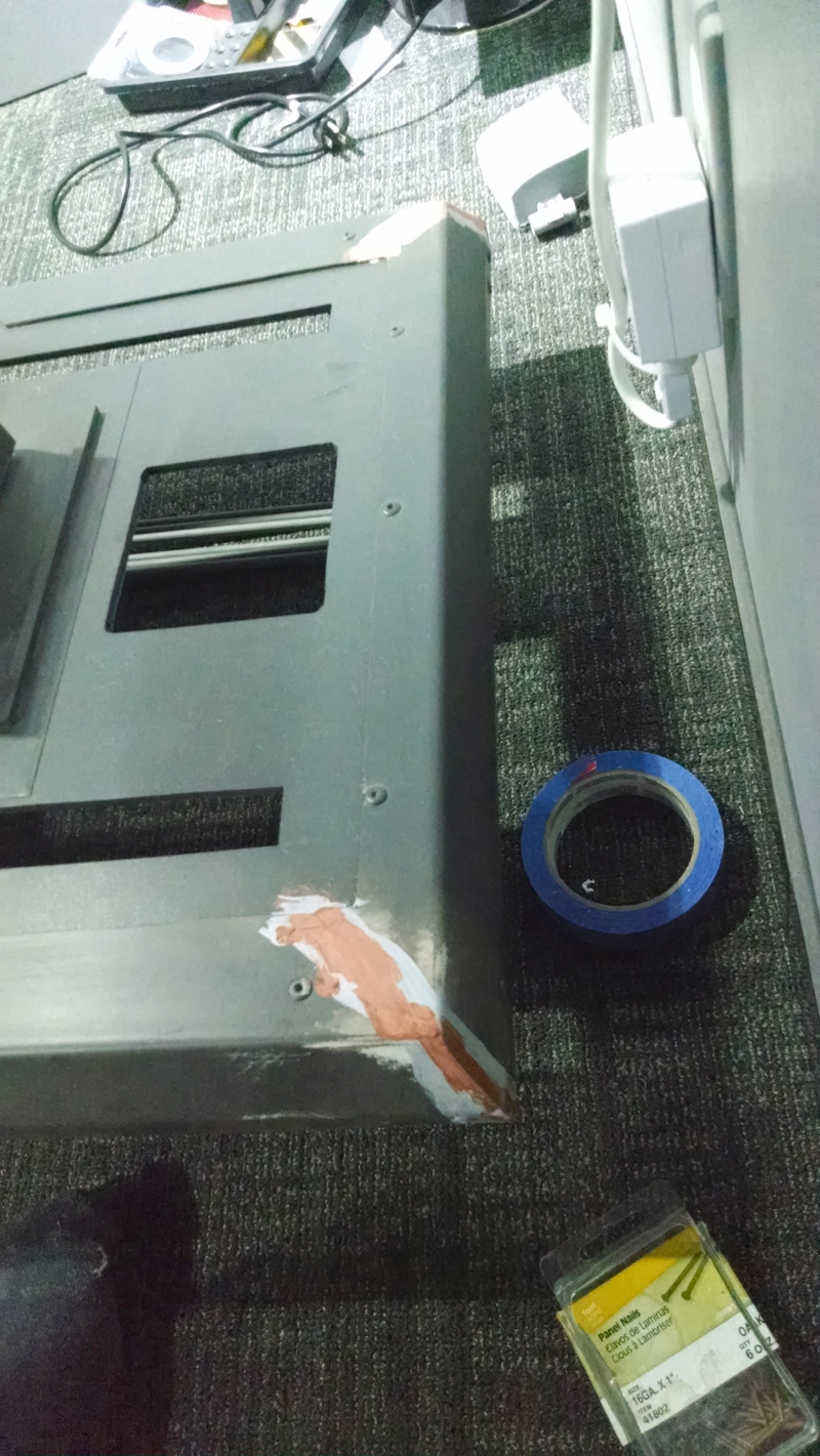

This shows where I left off, finishing the corners on one end. I want really nice corners, so there is some filling and sanding involved. I have some family coming over next week, so this week I want to get this thing hung from the ceiling, if only temporarily. Eventually this ceiling centerpiece will have some lighting, a fan, and some other features.

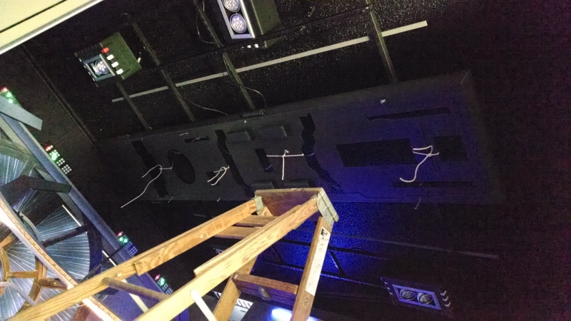

Back to work on the ceiling centerpiece, now painted. It took two people to get it hanging from the framework. None of the fasteners worked as expected, so we've got it hanging with some ropes temporarily.
attachment.php
The corners of it (on the rightside end) turned out just fine. Tonight I need to re-figure the mounting hardware, then start attaching some greeblies. That's the best part.

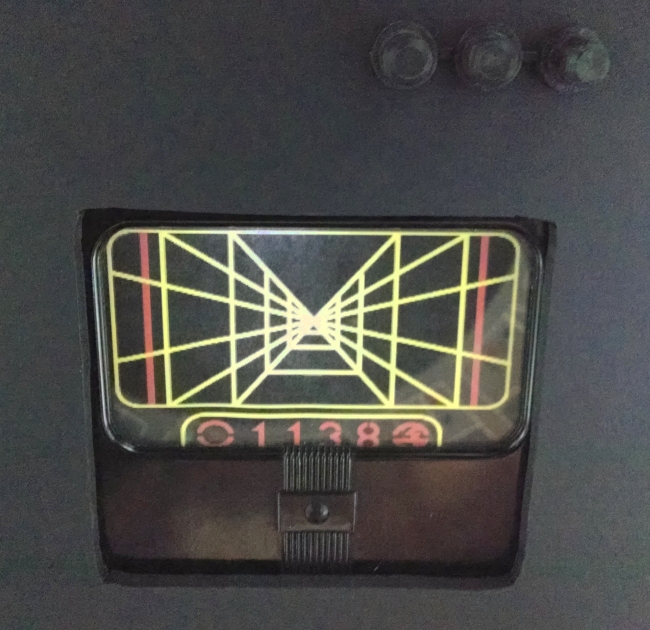

I continue to look for items that I can recycle into decorations. That saves money on the build. Here is an old audio VU meter that I made into a targeting computer display.
attachment.php
It has a glass face and is lit from behind. More later!

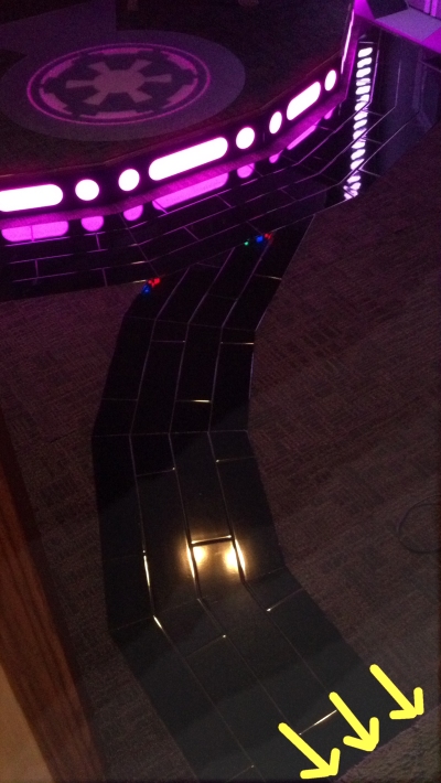

The last couple days I have been working on a threshold for the doorway to this room. For the past year, I had been looking around for some kind of wood that would be suitable. But I didn't think any pre-made wooden piece would look right, or fit right over the tile ends.
attachment.php

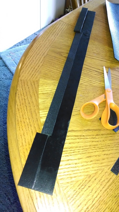

I didn't want a piece of oak. Did they have stained oak wood in Star Wars? Probably not. Making it more complicated, was the dimensions of this trim piece I needed. I was dealing with three heights to try and match up. The tall hallway carpet + pad, the thin room carpeting, and the (fragile) black tiles are taller than the room carpet. I wanted to make sure the tiles wouldn't crack when stepped on. So I decided to make something FREE out of the plastic-like Sintra material I had on hand. This is the bottom-side under construction.
star-wars-movie-set-den-build-thresh01-jpg-345800d1404589452

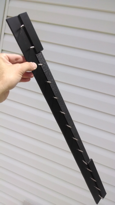

Above, I chopped up some Sintra and glued on a cushion strip in the middle. This rubbery cushion will be in contact with the tiles to prevent them from being cracked.
star-wars-movie-set-den-build-thresh02-jpg-345801d1404589467

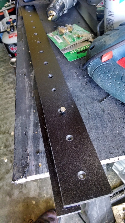

Above, I've drilled some holes across it and begun to counter-sink the holes.
star-wars-movie-set-den-build-thresh03-jpg-345802d1404589480
Above, I've test-fit some star-head screws. These are stainless.
star-wars-movie-set-den-build-thresh04-jpg-345804d1404589493

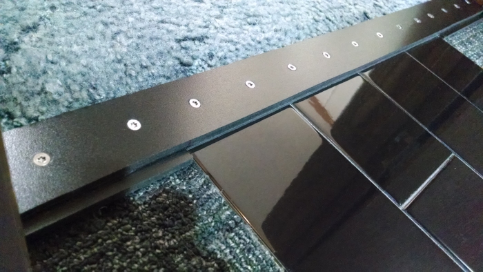

Above, the threshold is done. Done! ...at least I thought so till my wife came home and saw it. She doesn't like the look of the screws. So, now what? I could put something over it, but keep in mind - almost nothing sticks to un-sanded Sintra, except plumbing (PVC) glue. And I don't want to make this strip any taller. What would you do? Leave it, or trim it somehow?
