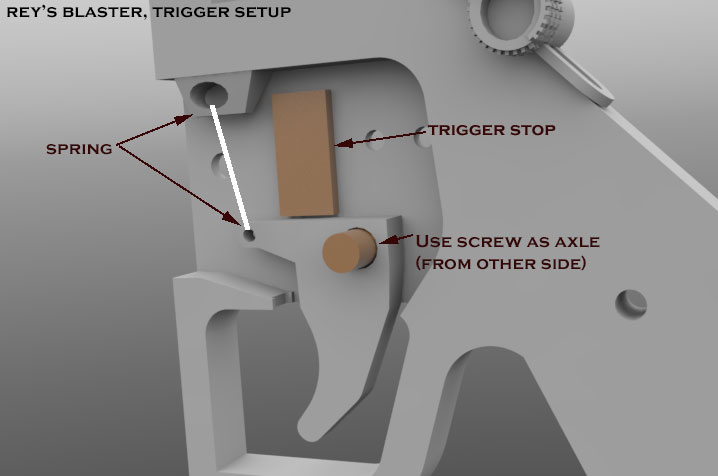

Also... here's how to set up the moving trigger.

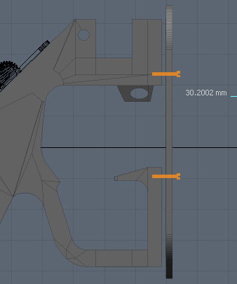

I also suggest using a couple screws to secure the grip frame to the body backplate for extra durability. It's not essential, so I didn't model screw holes into it, but if you're going to be trooping with it, the extra durability could be warranted.

As mentioned above, you can also add some strength with a couple small screws right through the "plate" that connects to the grip frame. It's not essential, but it WILL give you a bit of extra strength if you plan to handle the gun a lot. Like this:
If you use small wood screws, you can just scew them right in. Just be careful around the trigger guard. (I added a couple freehand just to try and it worked fine.) But again, it isn't essential.

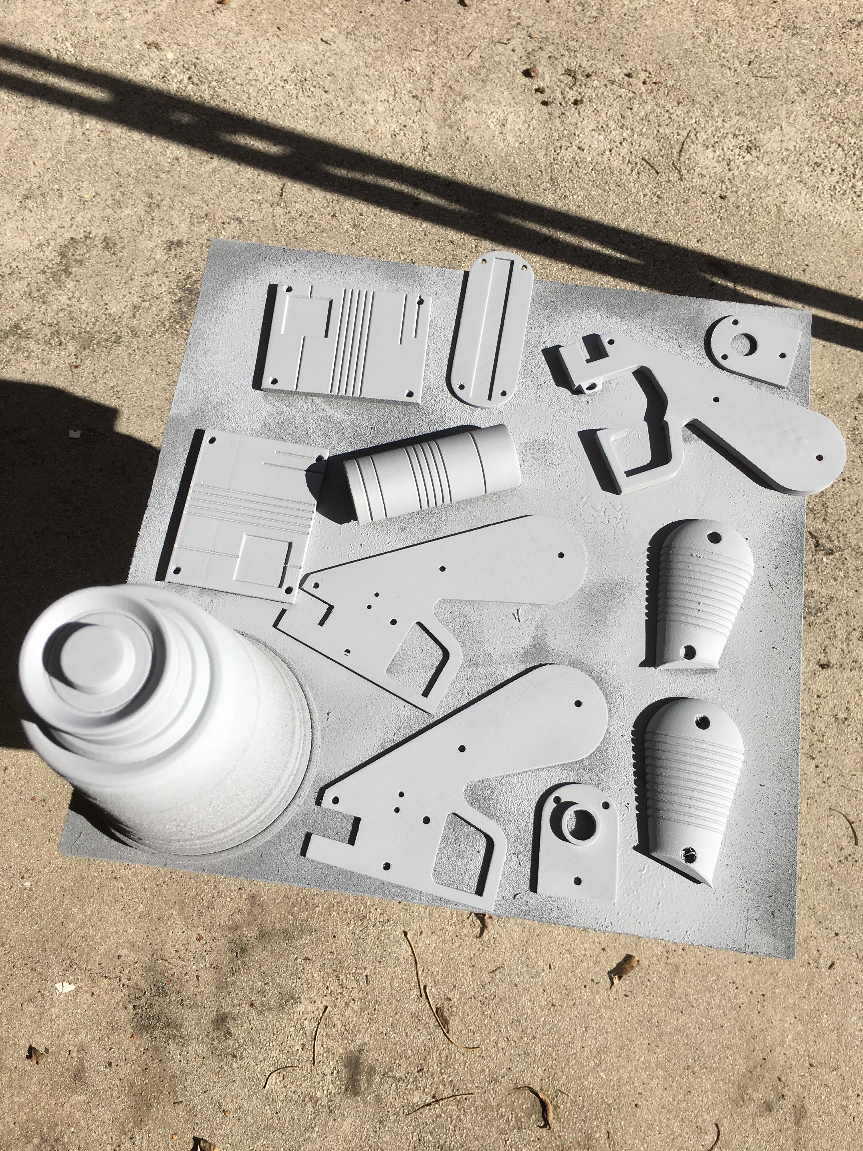

I've been going home during the day to get in some sanding time while it's still light outside and today I had a chance to get to the hardware store and get a coat or two of filler primer onto some of the parts. Then it's back to sanding!

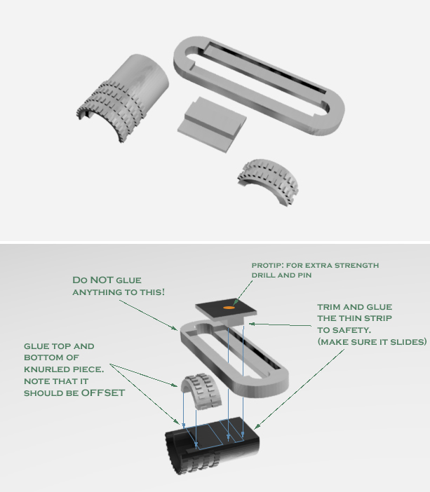

I also have some cool news. I've just UPGRADED the kit. A page or so back, MiraDarkstar asked about a moving safety and well, even though I don't think it's screen accurate (doesn't look like it moves in any photos I've seen) I got it in my head to try it as a challenge... and to make sure those of you who so kindly part with your money for these things get the best stuff I can do. (I know my kits cost more that some, but I try to make them worth it.) So... here it is:
I managed to get it working on my own test build. It's a bit fiddly to put together (see the above instruction image)- you need to trim a little until it moves freely in the groove, but I'm going to automatically include it with all the kits from now on. Those of you that really want one and already has gotten their kit, let me know via PM and I'll print one up for you too because I don't want anyone missing out on any upgrades just because you ordered first. Visually, there's no real difference if you just want to assemble it static aside from the fact that I've actually gotten the knurling to have better definition.
