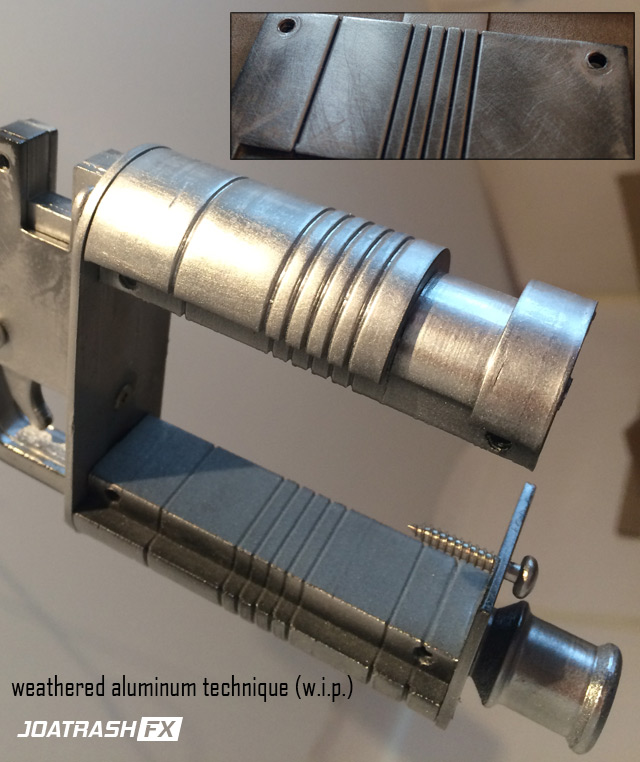

Here's a w-i-p of one of my kits where I'm using a special airbrush technique to fake the look of brushed and weathered aluminum:
attachment.php

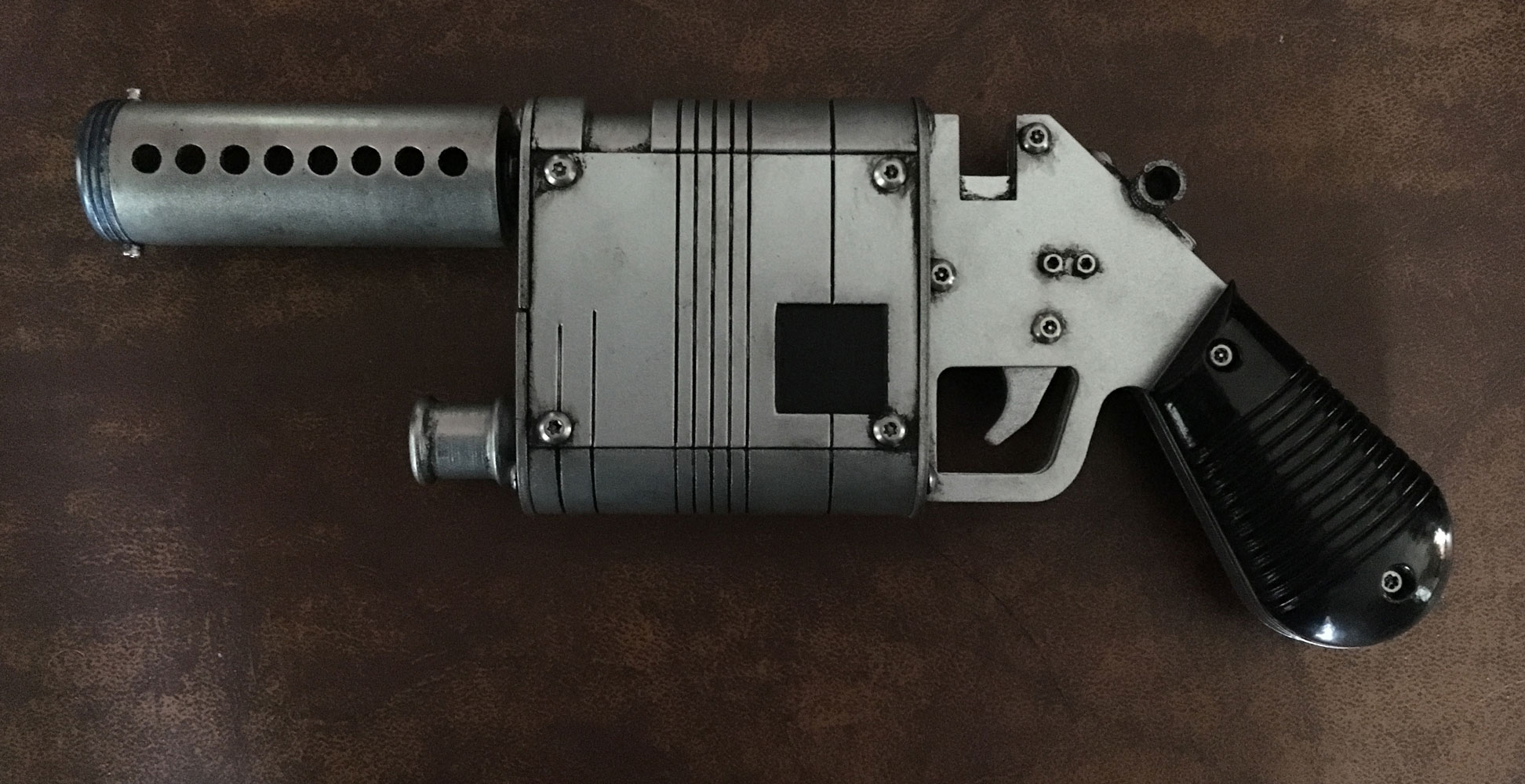

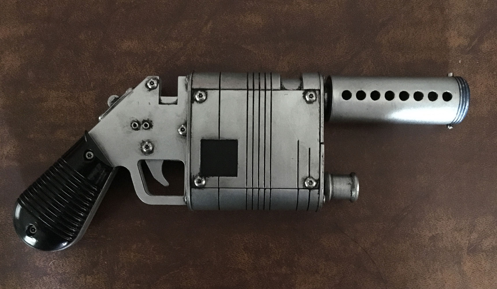

Here are mine all finished.

View attachment 624692View attachment 624690
Nice!
Nice build, Unfated!

By the way everyone: NEW PAINTING TIP
After finding out that Alclad is now illegal here (due to improper chemical labeling) I had to give Vallejo's "metal" series a try. THEY ARE FANTASTIC... possibly even BETTER than Alclad. The surface is (from my initial tests) just as shiny, they are water-based and DO NOT RUB OFF nearly as much. Vallejo also makes a clear-coat specifically for the metal paints but I haven't tried it yet.
I did an "aluminum" test on my Star Lord gear the exact same way as with alclad (a gloss black lightly sanded with 400 grit before applying CHROME paint to it) and it looks fantastic. That method, using chrome instead of the aluminum shade actually looks more realistic.

How did you guys get rid of the print lines?
Travelling atm but it's basically like preppoing a resin kit. Here's a quick tut:
1 wetsand with 120 to 280 grit paper.
2 spray filler-primer
3 wetsand with 320-400 grit
4 black gloss undercoat
5 Mist whatever silver/chrome paint you prefer.
Protip: for a brushed/weathered aluminum look, sand the gloss black unevenly and lightly before applying silver.
