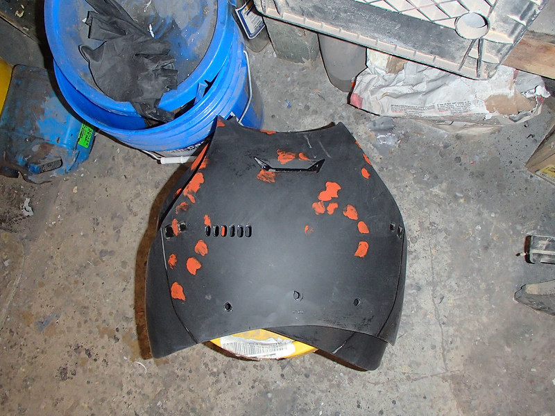

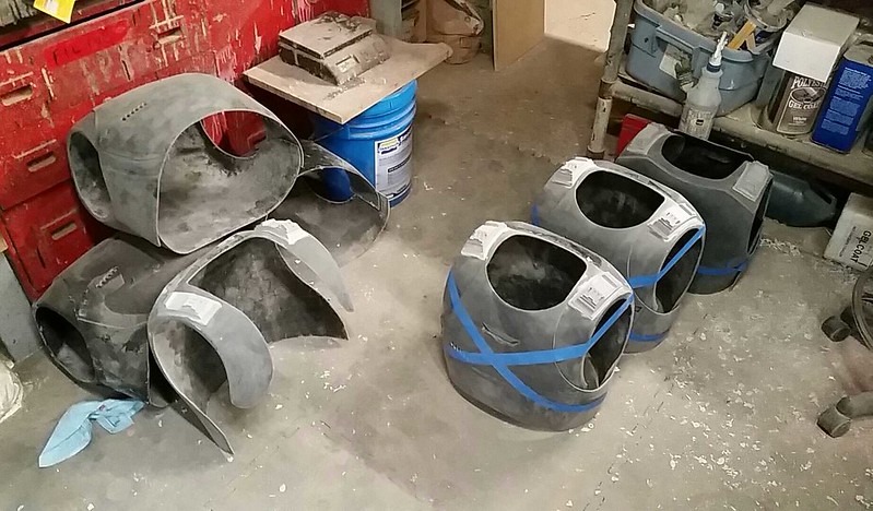

Chest and back armor is in the fine-sanding stage:

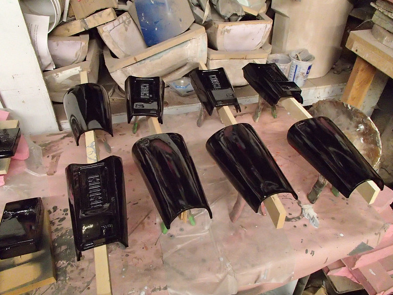

Still churning away on the gauntlet stack too:

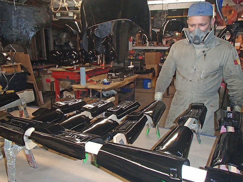

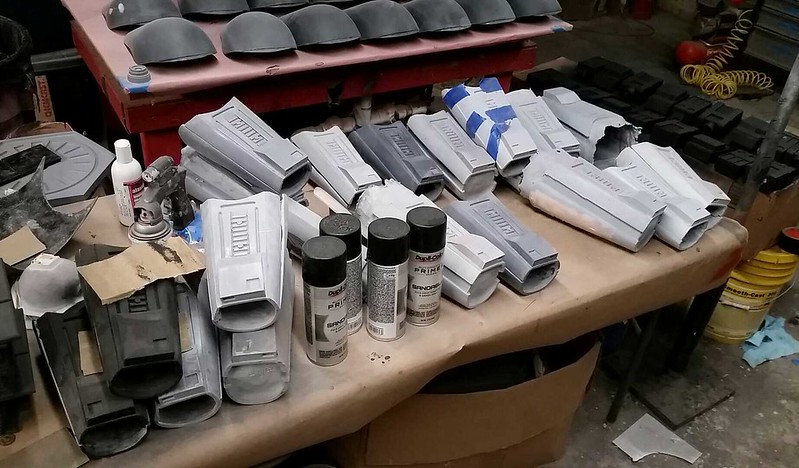

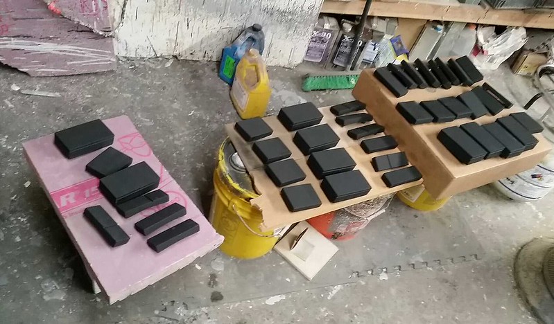

After a solid week and a half of nothing but sanding and filling, I primed all the parts. Then did more filling and sanding:
Once I thought I'd filled all of the tiny little pinholes, it was time to get to painting:
Here's the stack of shoulder armor somewhere in the middle of the process:

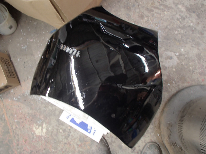

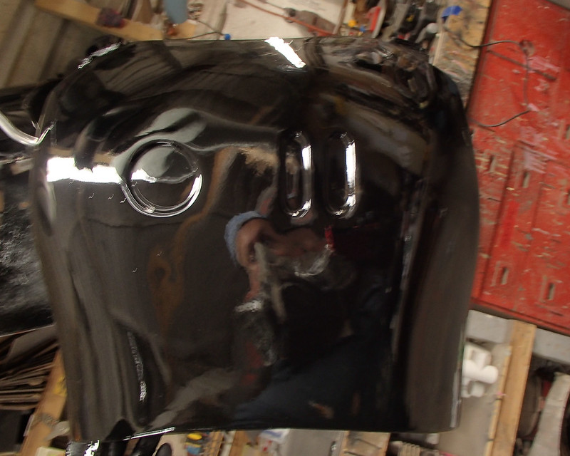

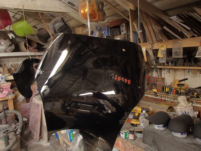

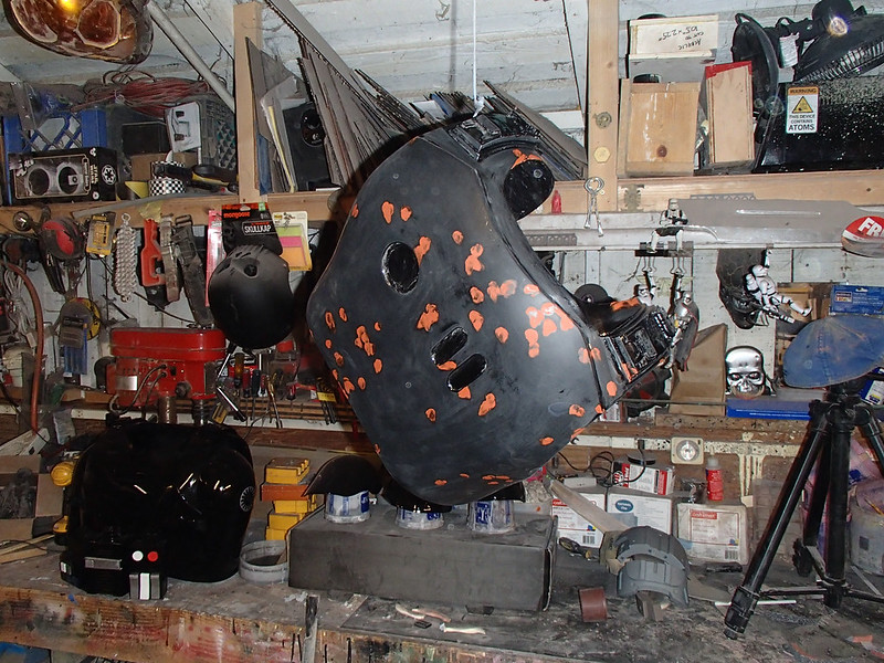

The gloss black revealed a few stray, tiny pinholes on some of the fiberglass parts:
This is the worst piece:
These pieces are all very difficult to photograph:

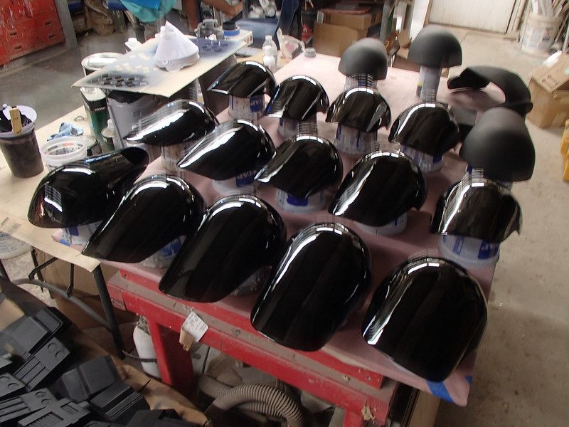

Here's all of the painted chest boxes:
The resin pieces took the gloss much better (no pinholes):
So now I'm just waiting for the paint to harden a bit more (it's cold here) and then I can touch up the pinholes, wet sand everything, and shoot another coat of gloss black. I'm using an automotive, single-stage urethane black, so it doesn't require a clearcoat. I may add one anyway since more shiny can't be a bad thing. It'll depend on how I like the surface once the second coat cures.

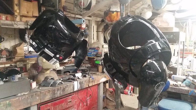

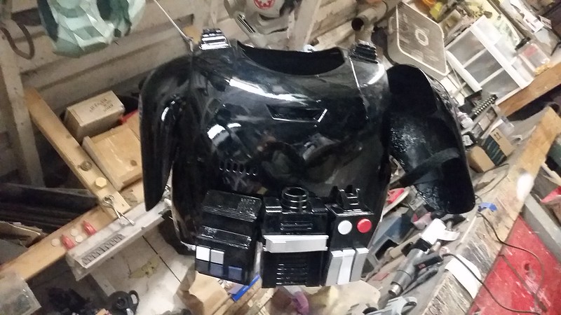

Despite the fact that the paint wasn't perfect, I decided to try and pull together a set of armor for the Rogue One premier on Thursday. It went okay:
Then I got a call from a friend asking me to get a set together for him, so I stopped working on mine and strapped another set together:
I ran out of time before I had a chance to assemble the belts and forearms, but they were looking pretty good at this point:
Sadly, it means that the day was wasted and I still have to disassemble both sets so I can wet sand all of the imperfections out of the paint job and recoat them.

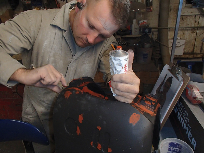

Here's another one of the chests after wet sanding with a dab of spot putty over every one of the pinholes I could see:
And one of the backs in the same state:
Since then, I've sanded them both down to 600 grit. The spot putty has been reduced to just enough to fill the pinholes themselves, so it's barely noticeable on the now dull surface.

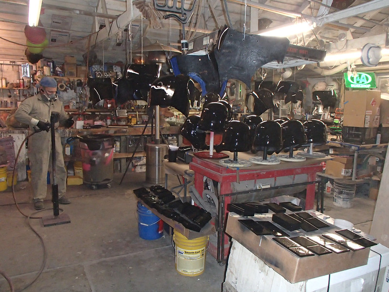

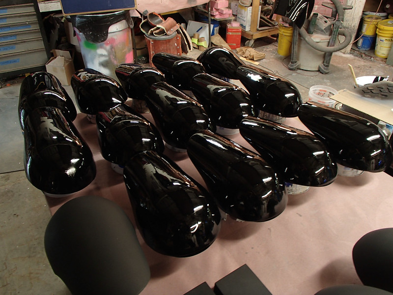

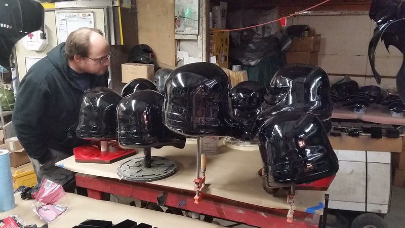

Apologies for the lack of updates. It's been a while, so I'll summarize progress: Cold weather slows paint cure times, rain messing everything else up, wet sanding takes forever, and holiday travel got in the way there somewhere too.
But now I have a second coat of paint on everything and it's gorgeous:
Once all of the paint hardens, I'll be buffing out a few minor flaws and it'll be time to pick out the details, add straps and decals, and start packing things to ship out.
