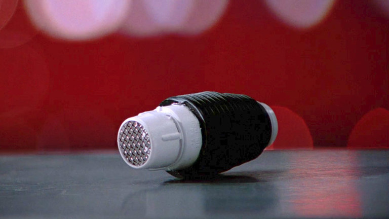

Star Wars Comlink - what was the bottom found part?
I still think it's the inner nipple of the Hovi. Maybe with the top nipple part cut off.

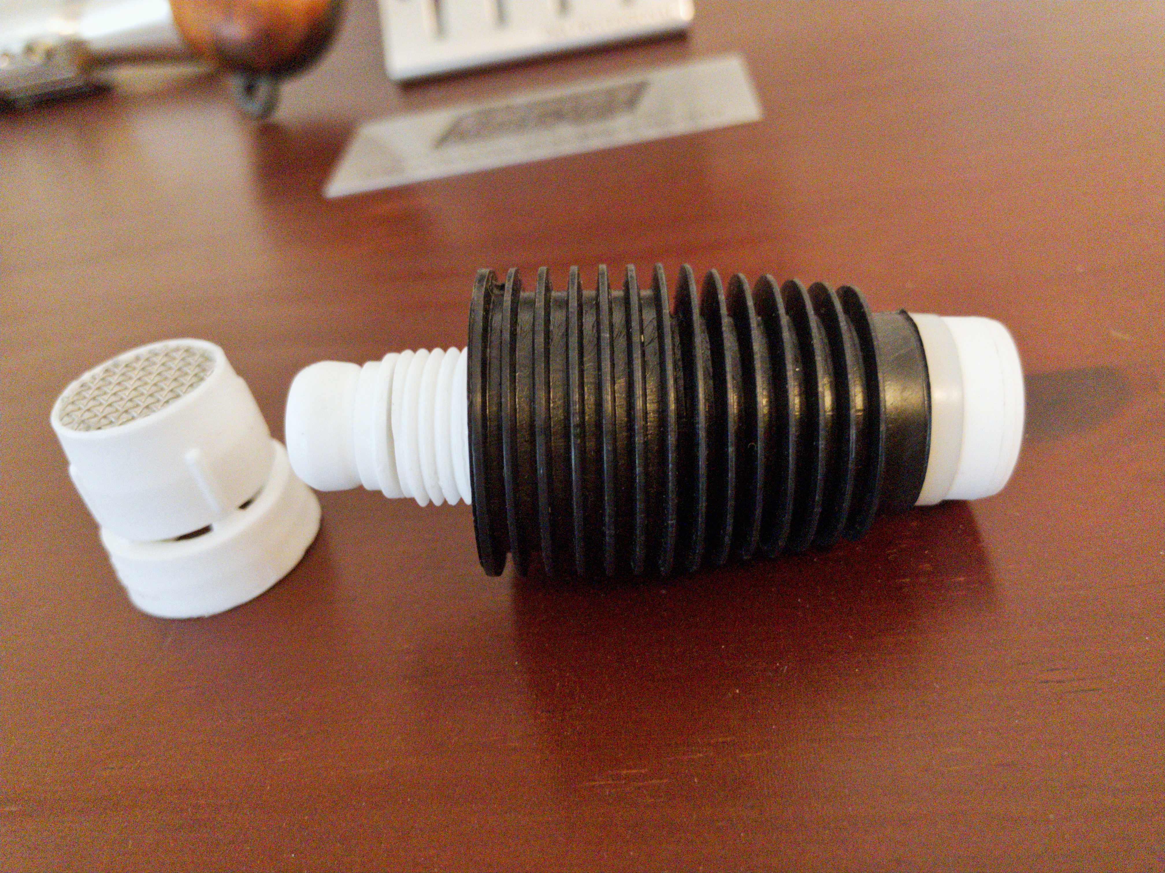

Here's one I made, built from the screw cap posted about above (thanks for that!), a custom white acetyl washer/spacer, an original Reade cylinder, and a "swpropman" hovi tip I found on ebay:
Something I noticed while building it is that the Reade cylinder's large end is not concentric with its hole. That's why the Reade part in the movie screencap above appears to have a smaller diameter in relation to the hovi - that's the "short" side where the central hole is closer to the edge. Take a look at the bottom and the flange is much wider there. I replicated this positioning as best I could with mine, though some asymmetry in the replica hovi mix tip meant I couldn't also position the raised text in the same place.
A few more angles:
I built it without using any paint or adhesives - it all assembles around a brass screw with aluminum spacers for weight.

Thanks! I actually got a black tip set first but asked the seller (swpropman; not sure if he is on this board) if he could do another in white, which he obliged. When comparing the tips he makes against the comlink in the movie I see small differences like the rib width, and maybe they're a bit too tall, but overall they are nice quality replicas, are very cleverly engineered, and include details like the inner piece and raised text.
Very nice work! You inspired me to go off and collect the parts to make one myself.
Thanks for showing your steps.
