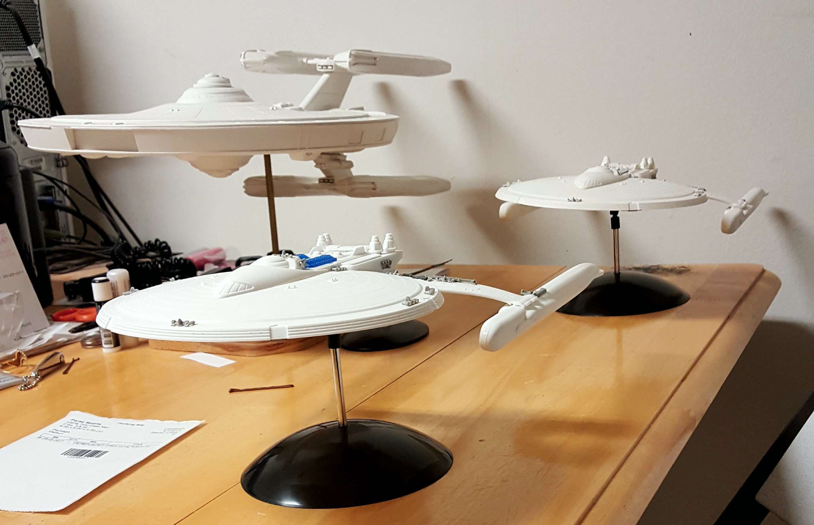

Some new pics of the USS CENTAUR and USS STARGAZER.

Thank you, Barnstormer. I do hope you can find some time in the near future to work on your model of the Centaur. I'm hoping for some warm, dry weather, to come this way so I can finally do some painting of my model. Looking forward to viewing your build!
I'll have some work to do removing the out-of-date/inaccurate parts cleanly, and I know I was still working on the seams of the rollbar-pod - I'll have to revisit that now that we have a better understanding of how that mounts to the saucer to make sure that it's still viable.
When it comes to mounting the saucer onto the rollbar/weapons pod, I did basically what Adam did with the original, I kept cutting away the back of the saucer under the impulse engines to fit the shape of the weapons pod, and cut down the sides of the weapons pod to fit the area under the impulse engines. The front of the weapons pod needs to be sanded flat until it is level with the top of the photon torpedo launchers. Should you do this, you will notice that the photon torpedos will launch right into the bottom of the saucer hull. That is how the filming model is set up. Adam told me that he made the second version of the Centaur so that the photon torpedos did not have that issue. So depending on how you want your build to look, plan ahead before doing the modifications to the saucer hull and weapons pod. I wanted my build to look like the filming model, so that is how I built mine.

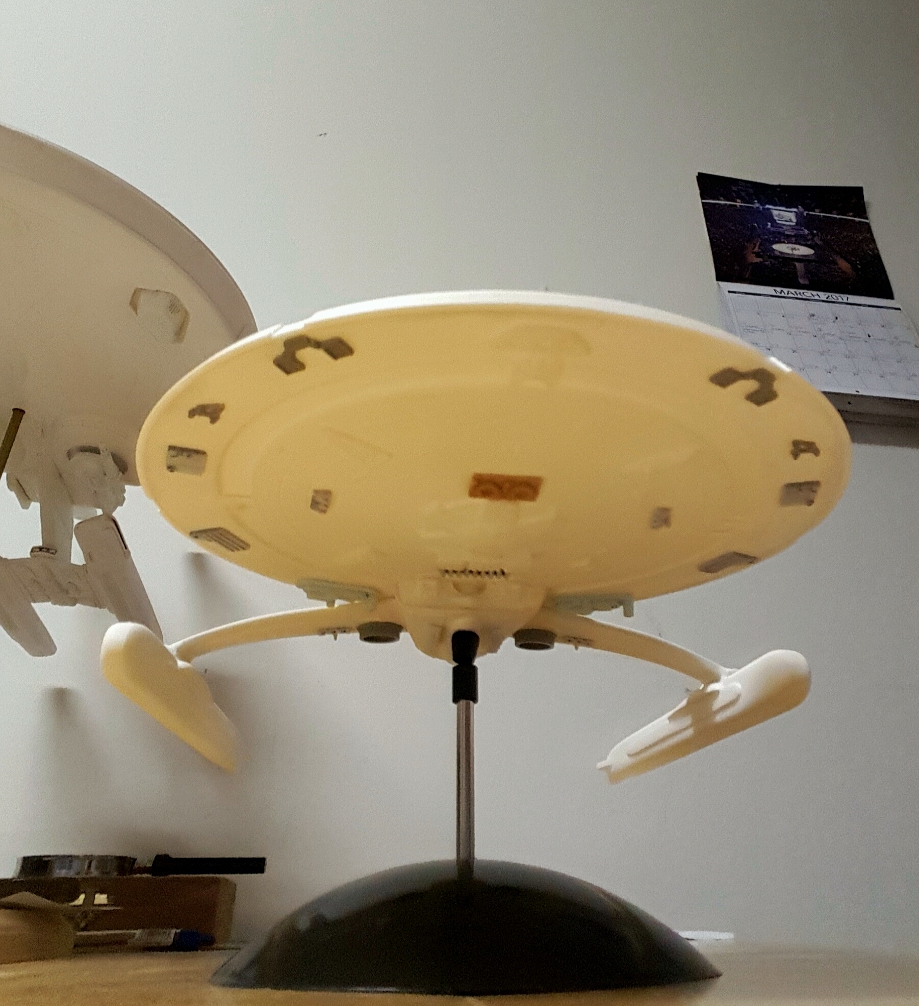

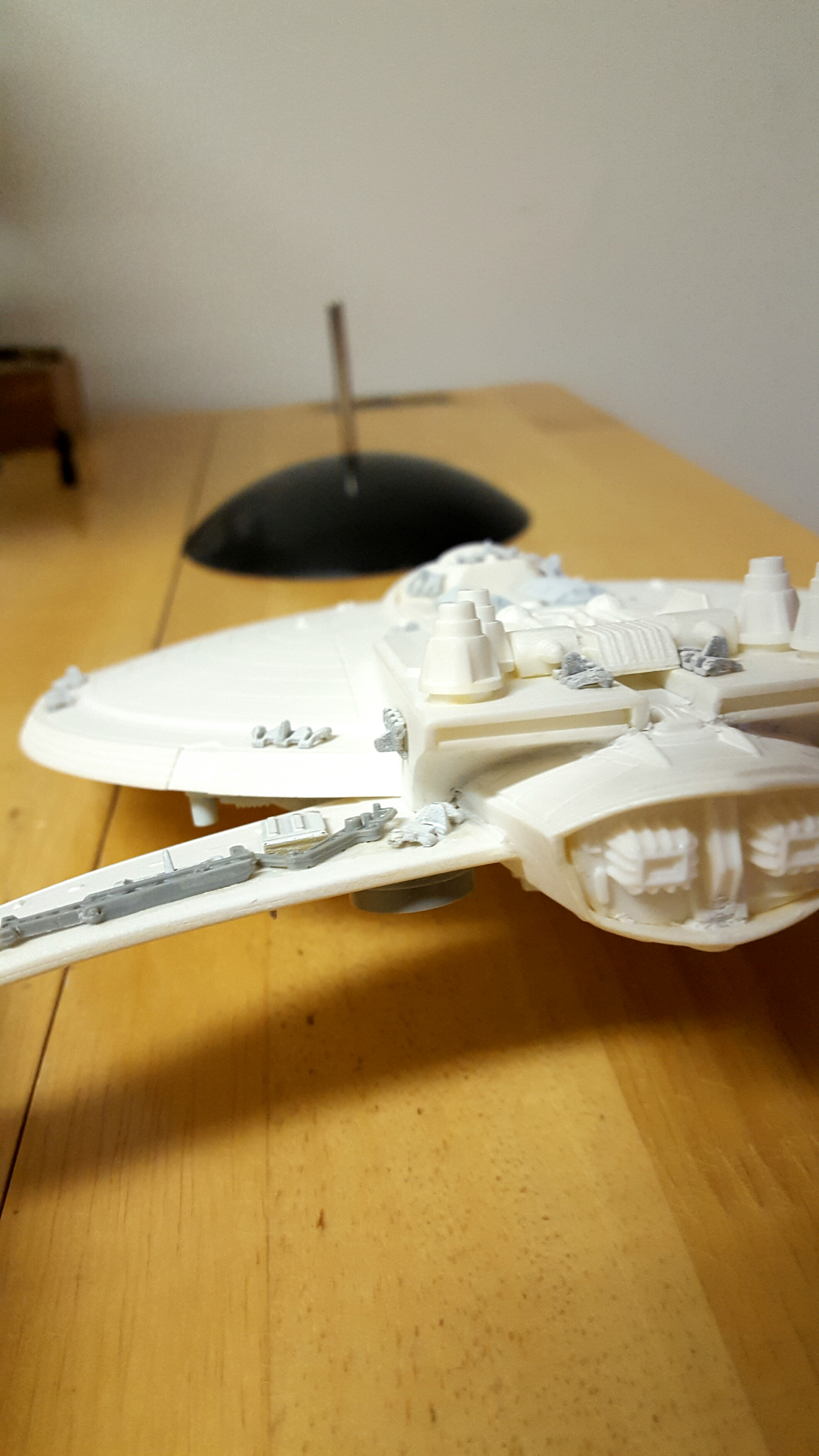

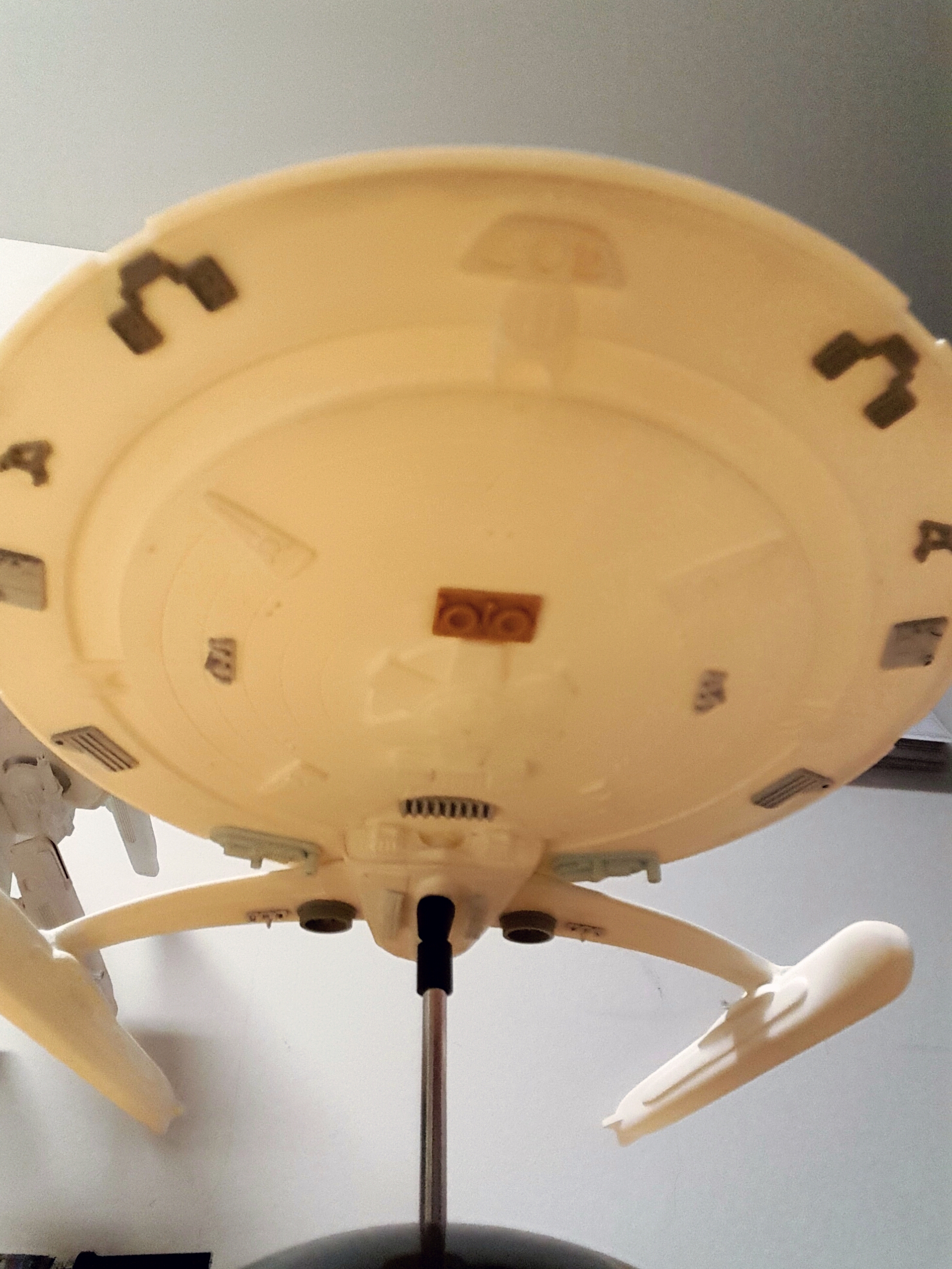

Since my last post I got some model putty and filled a few gaps that needed covering. The following photos show where I filled those gaps. One place, between the impulse engines, I used some scrap plastic to fill in where on the studio model they used putty. That is my one main deviation from how the original build was done.

You must have used a stronger solvent based glue than I did when adding parts. Most of the inaccurate parts on my build literally "popped off" using a standard modelling blade or a chisel blade. Good luck!
This is beautiful! One of the best and most accurate builds of the original "Buckner" configuration I've ever seen. Can't wait to see the final product.
Thank you very much, Gebirg. Believe it or not, I am building a second original "Buckner" Centaur. As accurate as the first build was, this second build is going to be even more accurate. I know it sounds weird to build another Centaur, but I do like the look of the ship. :D

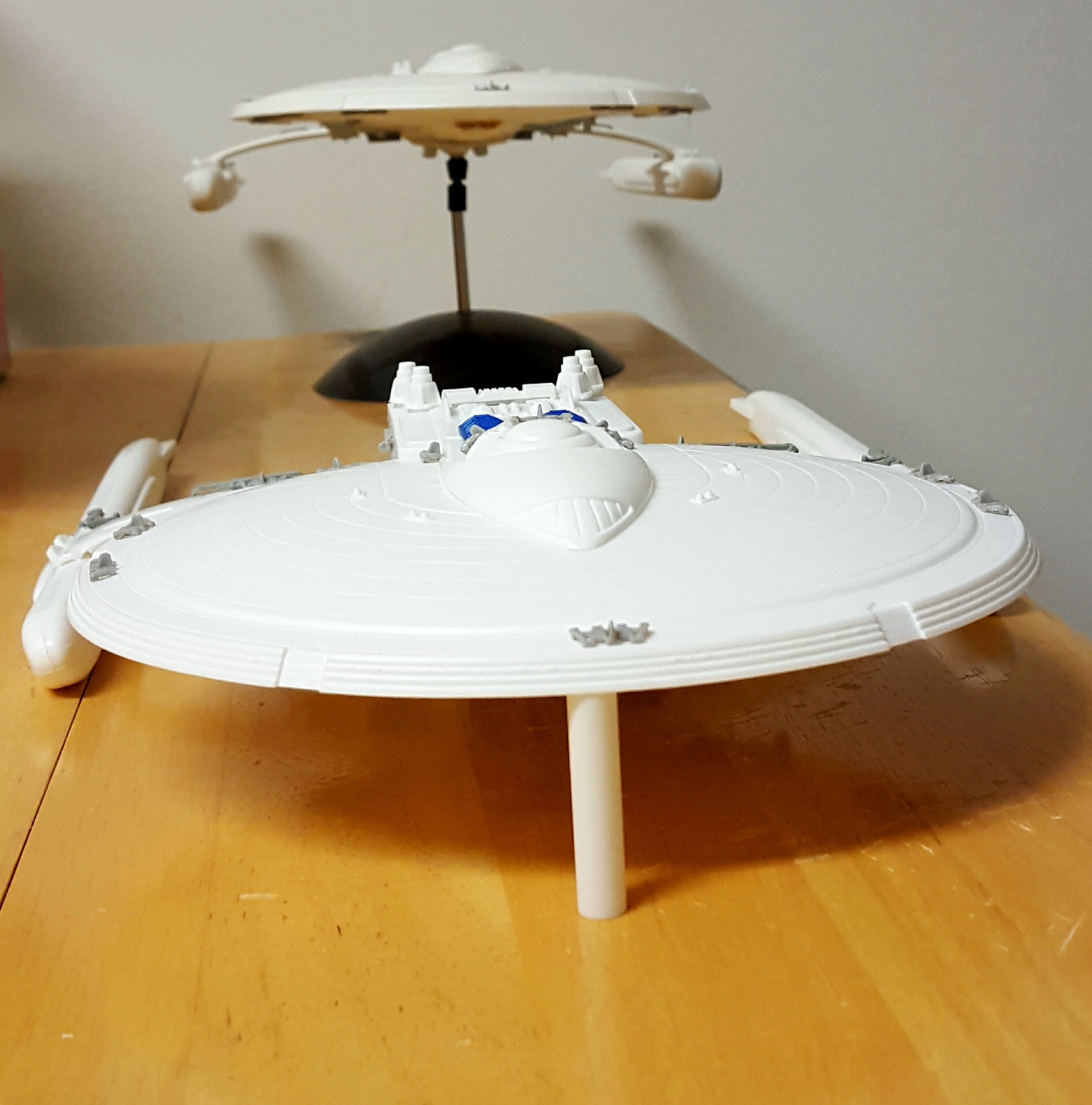

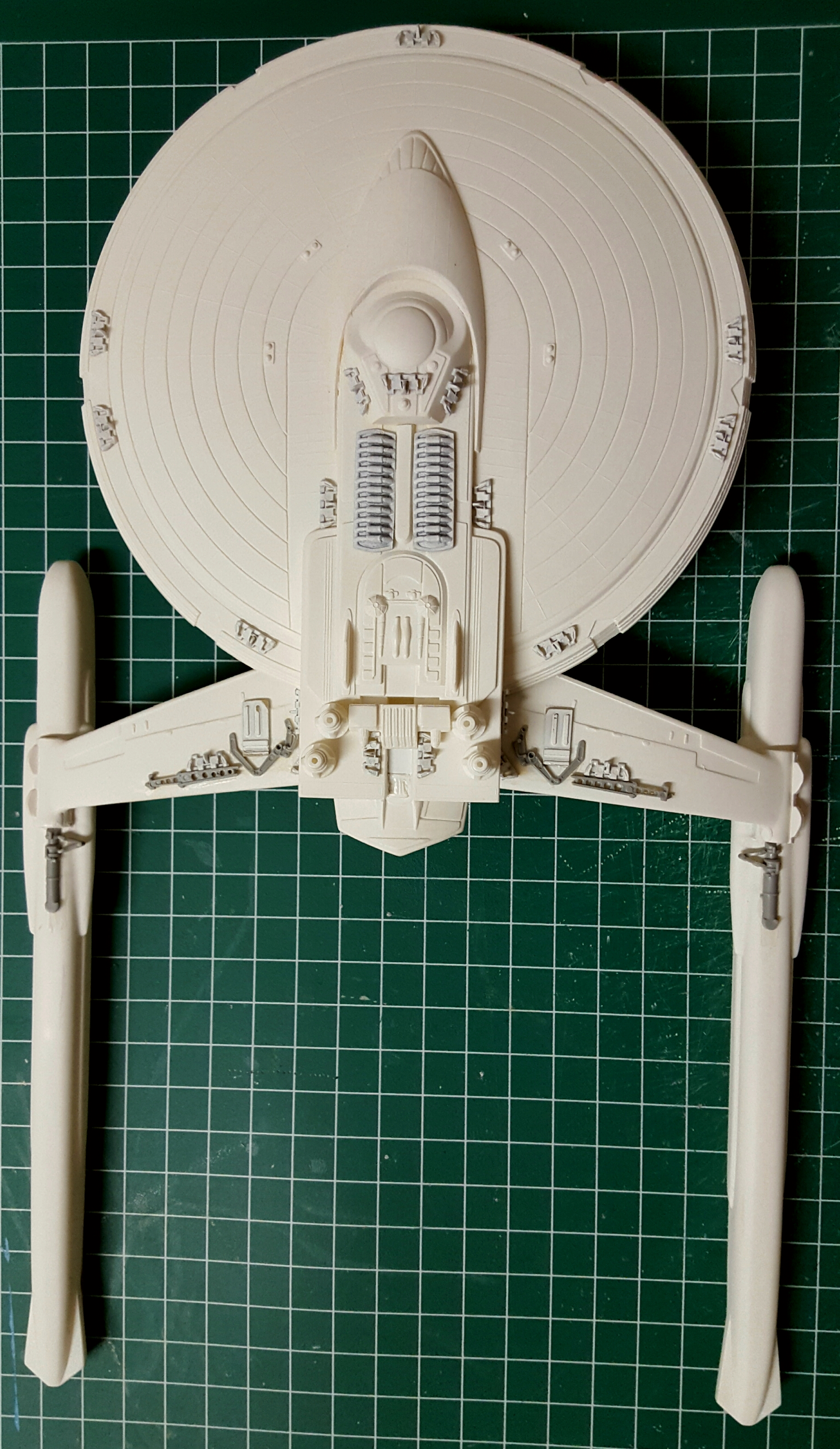

Small update...did some painting on the greeblies to make them pretty much the same color. Used Model Masters Camouflage Grey FS 36622. After some minor gap filling, will be painting a full basecoat to bring this build up to speed before adding the colors seen on the studio build.
