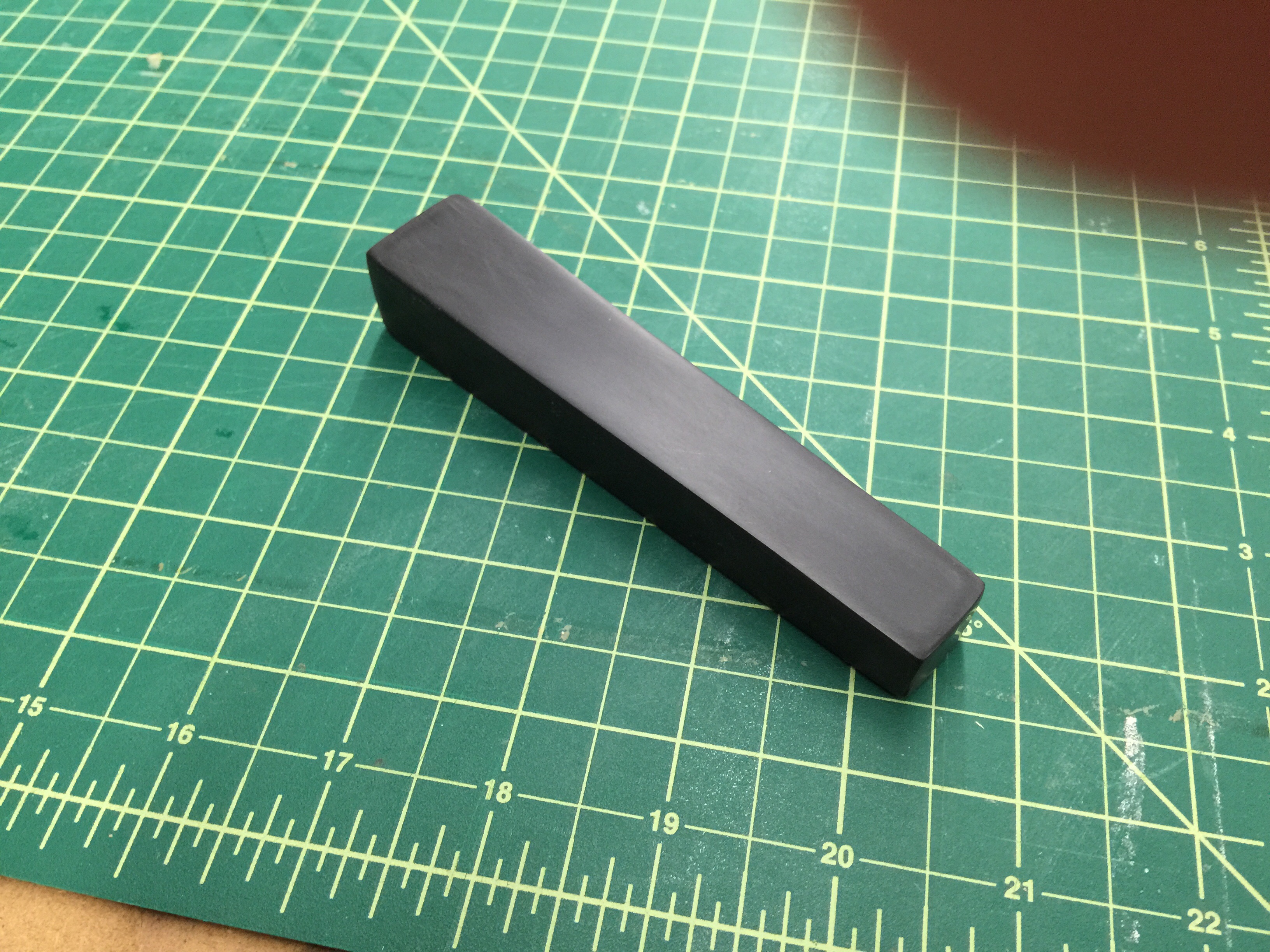

Here it is with the pieces held in place (nozzle is pressure fit):
An advantage of casting it in black is I don't have to paint it, and it has a nice smooth feel right away. :) I'm very happy with how this has come out so far.
Aw man, that's looking beautiful, buddy! All the pieces go really nicely together. I like the idea of no painting required. Just assemble and Ta-daa!
I think that's partly the reason I have so many builds still undone. The thought of having to do all that painting can seem a little daunting sometimes :p

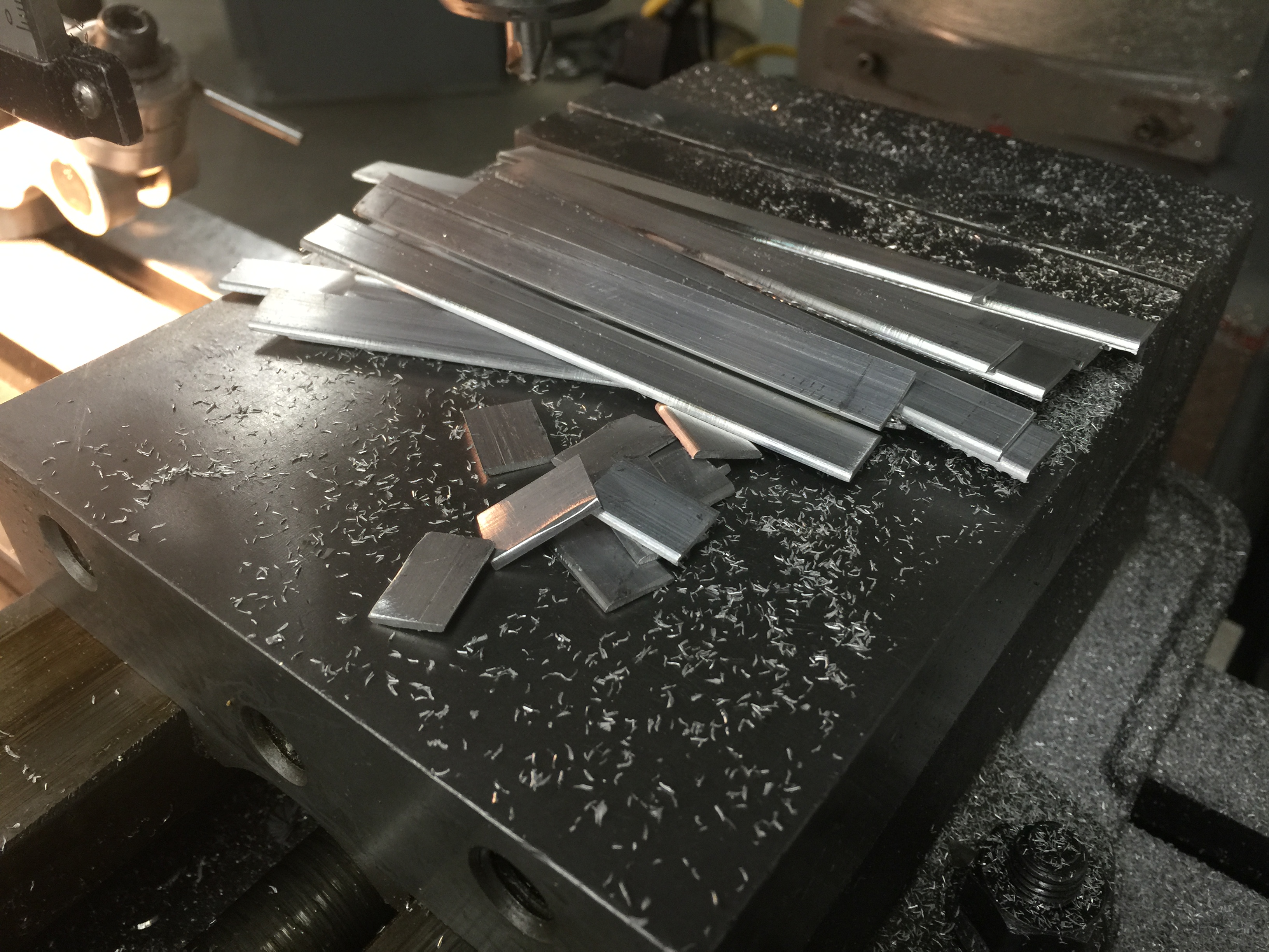

Things are poking along. I have put corner radii on the aluminum side bars and the (smaller) top buttons. I'm in the process of polishing them. My goal at the moment is to make 10 scanners.
With the radiused edges, before polishing:
I'm making bodies, but the de-mold time means I can only make one per day, with the occasional throwaway due to bubbles. (I figured out last night that I was using the pot at too low a pressure and will increase by 10 psi to 60 tonight.)
I'll be posting more granular updates/techniques on my workshop notebook.

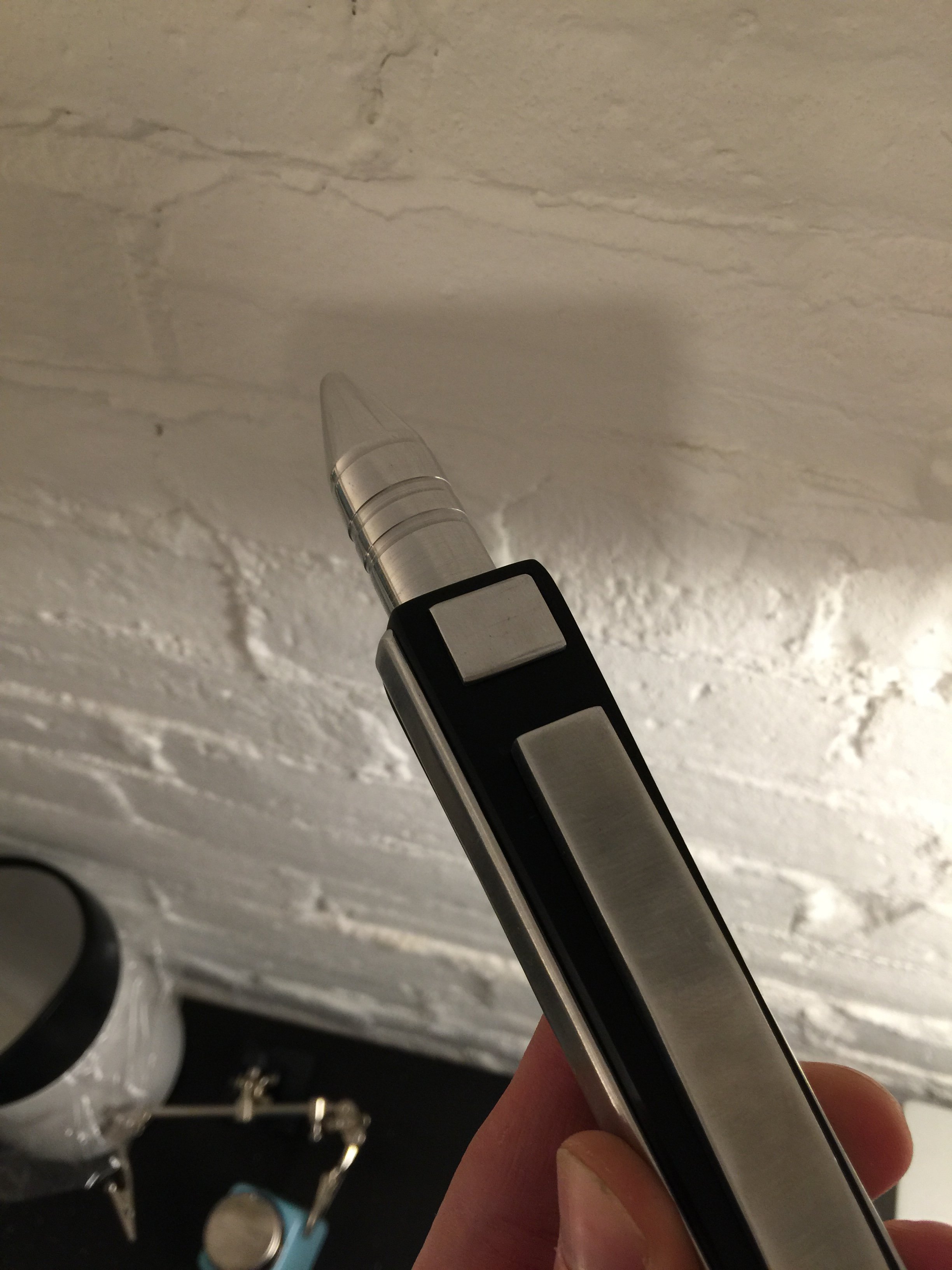

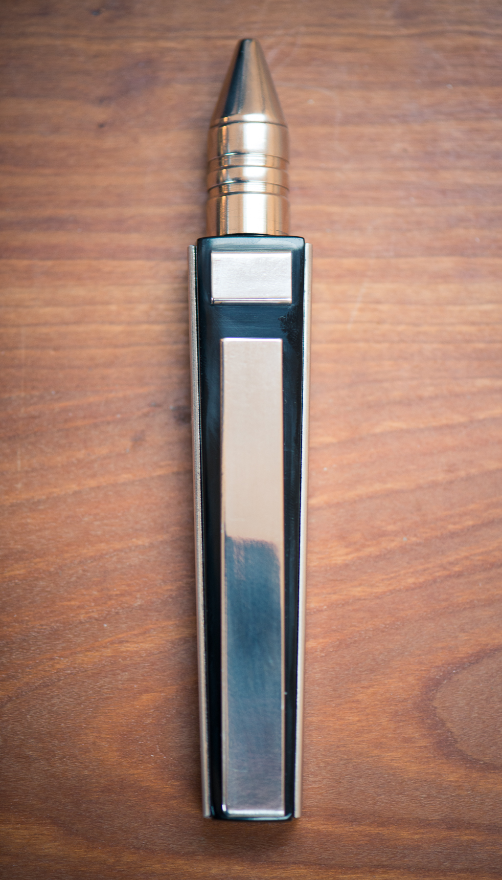

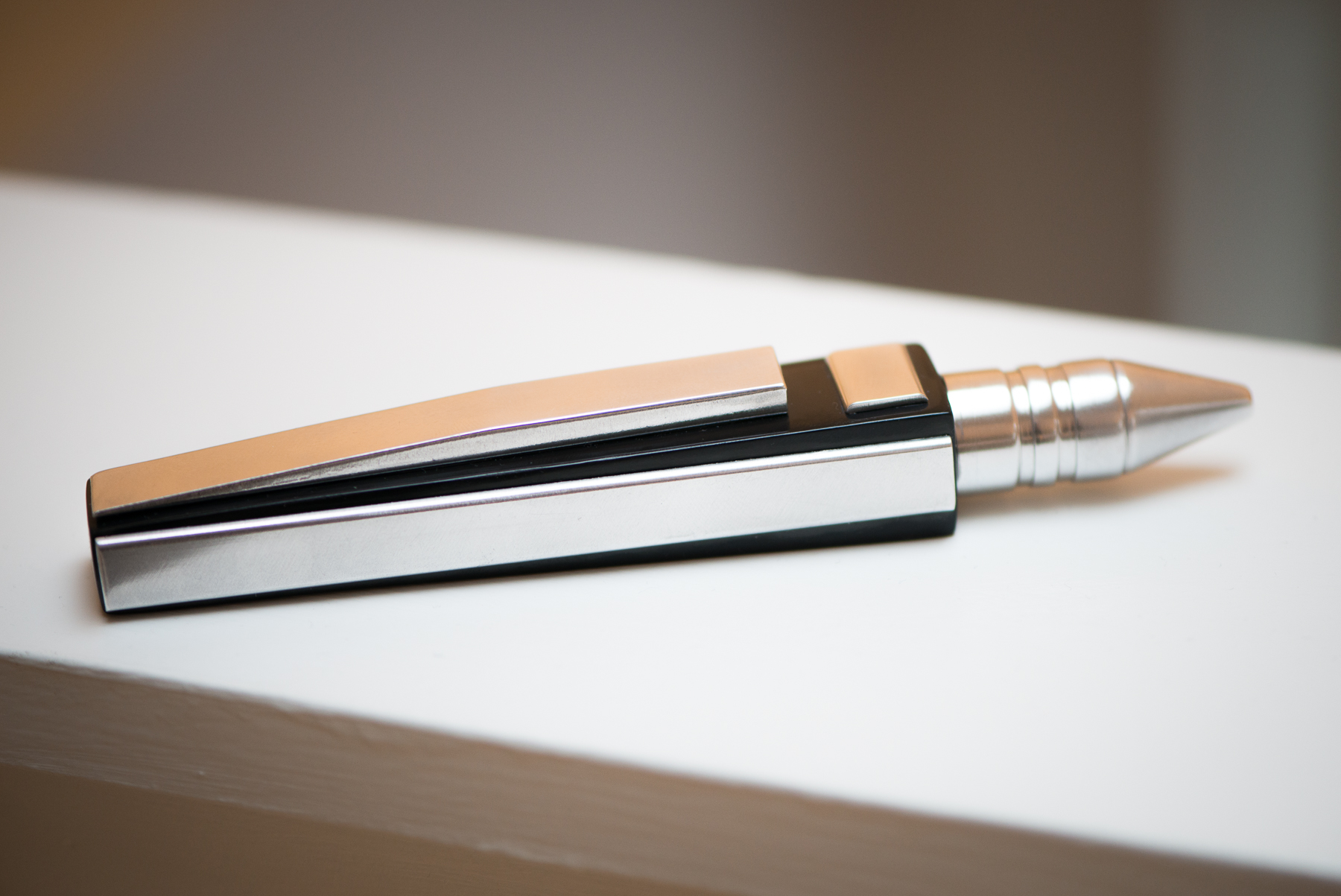

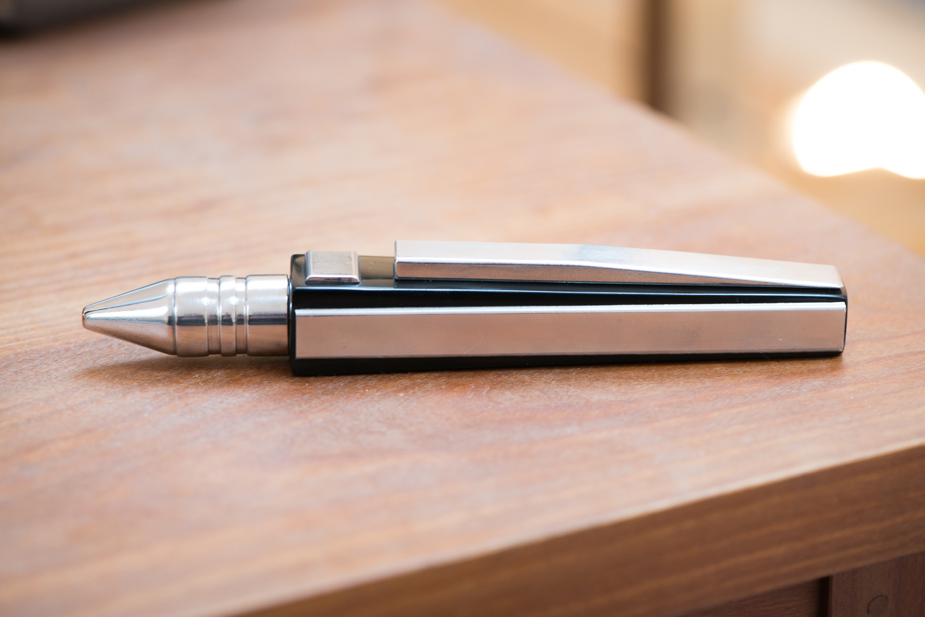

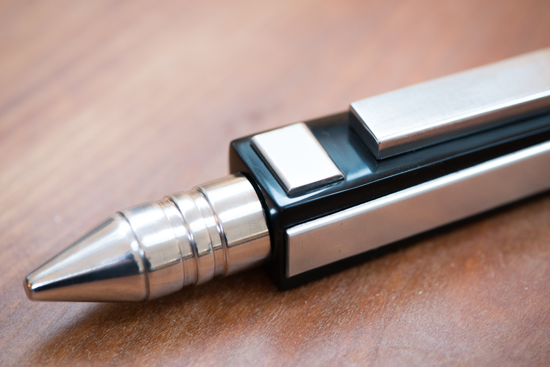

Well, slowly but sure I've now finished the first scanner to my satisfaction. I ended up casting the body in an onyx resin, no paint! This meant I could polish it up to a nice shine just like the aluminum parts. I have been writing about the machining process over in my notebook thread.
I'm going to make a few more for practice and good measure (and possibly trades).
Sorry for the fingerprint in this last photo. I snapped these photos off fairly hastily and didn't have a polishing cloth on hand.
Wow fantastic! Agreed, it definitely looks much more like a real tool than a prop, seeing how refined it looks! Would definitely love one of these for my collection!
