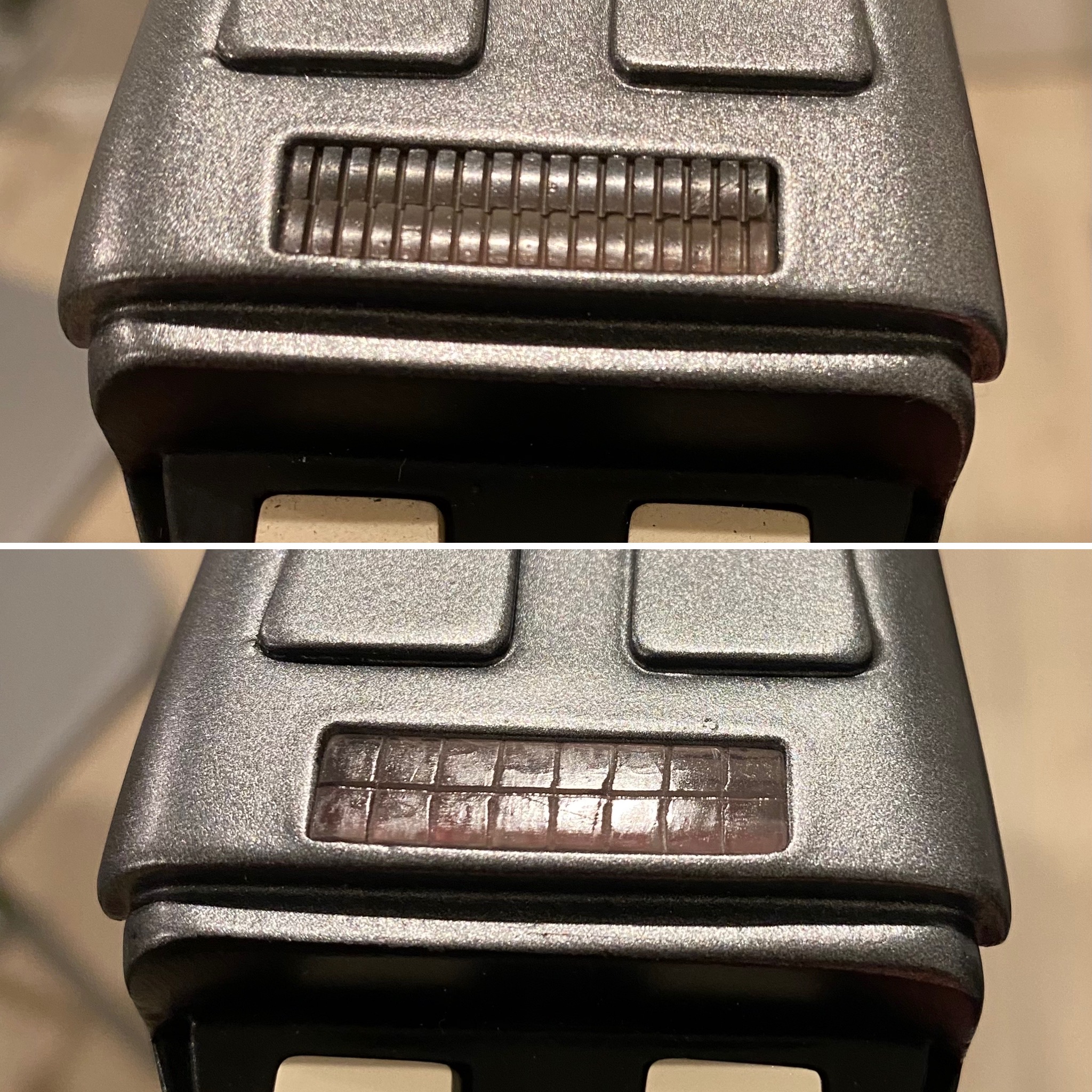

Second question is regarding the power meter bar. The Stapleton kit comes with a version based on the First Contact power bar (lots of little lines), but on Voyager/DS9, the bar was different (more like little squares). Does anyone know of a source for different power meters for the kit?

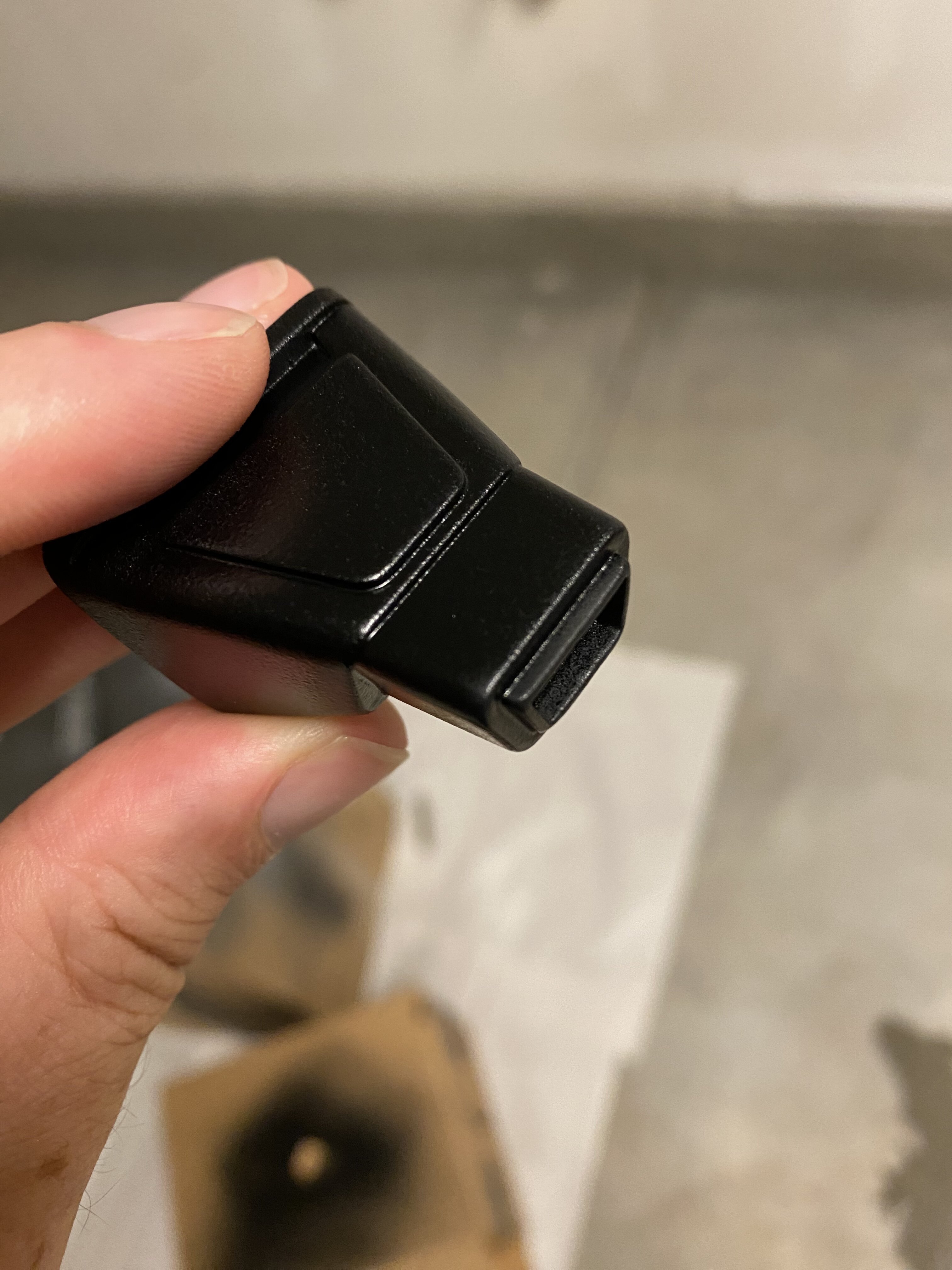

So I’ve been working on my Boomerang phaser build and have been running into some minor but frustrating issues. The first is that when I spray the emitter in Duplicolor Universal gloss black, the gloss doesn’t dry with a uniform finish. Some of it dries dull. I’ve tried two different new cans of paint, warmed it up and shook the rattle can for 6 minutes plus before spraying. Anyone know why this would be? See first picture, where the raised lip of the emitter is dull.

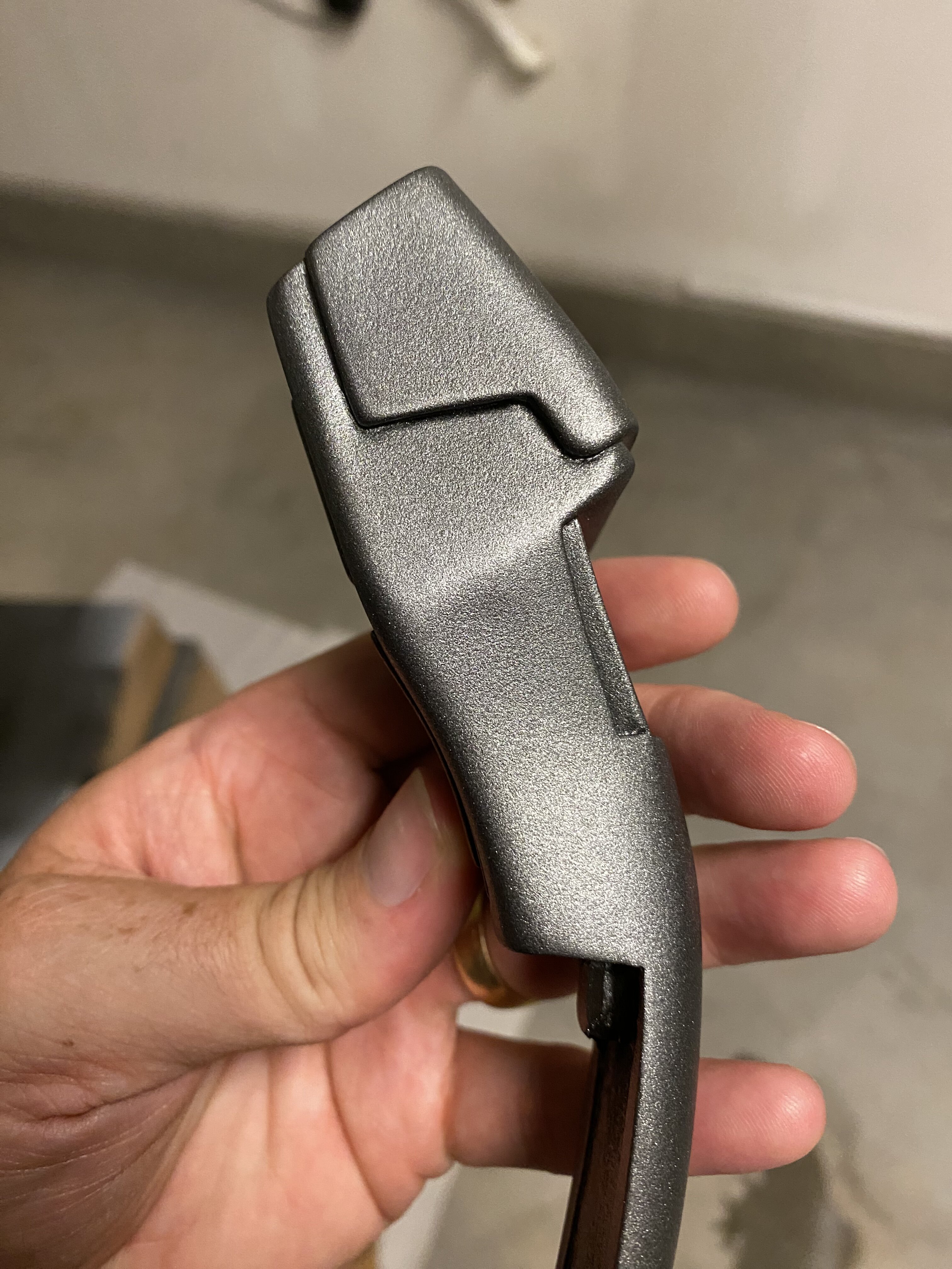

Second issue is that while the Duplicolor GM347 silver dries with a uniform finish, it has a rough grainy feel to it, despite my having sanded the underlying resin and primer with super fine grit. Anyone know how to get a smooth to the touch finish? I’ve heard that you don’t need to sand the actual finish coat if the underlying coats have been well sanded. Is this correct? See second picture.

That fogging on the black could be from too much humidity. I've found Duplicolor paints are pretty sensitive on that front. Try clear coating it and see if that fixes it.
The rough finish looks to me like a possible chemical reaction causing the paint to lift/wrinkle. Does it spray on smooth and develop the rough finish as it dries? If so, what brand and type of primer are you using? The Duplicolor car paint is a lacquer base so you need a lacquer primer.
It's also possible you have a clogged or defective spray head. If it sprays on rough, see about cleaning out the spray nozzle, or trying a different can.

Thanks for the help! Humidity here in Southern CA at the moment is about 55%. I’ll try a clear coat and see if it helps.
I’m using the Duplicolor grey scratch filler primer so thought they should work together being the same brand. I’ll try cleaning the spray nozzle and potentially another can. Any other brand black gloss paint that you could recommend? Thanks again.

I'm in SoCal too, near Culver City, and this level of humidity is well above the amount that totally ***** with Duplicolor in my experience. A clear coat should take care of it.
Yeah, that should work fine then.
Try painting something else with that can of primer and paint, some scrap plastic or something if you have it. There's a small possibility of a chemical reaction with the resin itself.

Does anyone have tips on how best to paint the power meter? Is it just Tamiya acrylic green on a bristle brush? Thanks!
