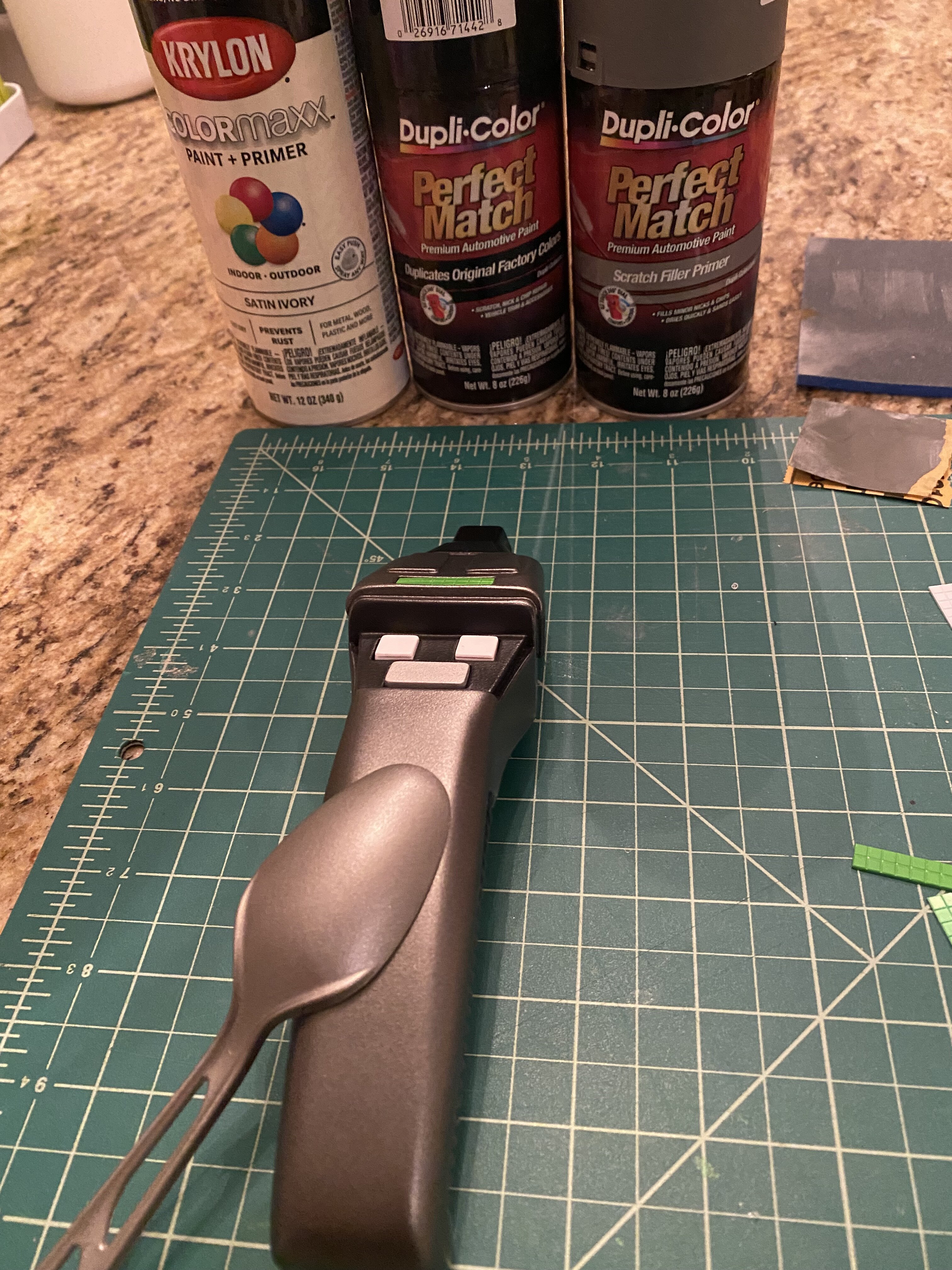

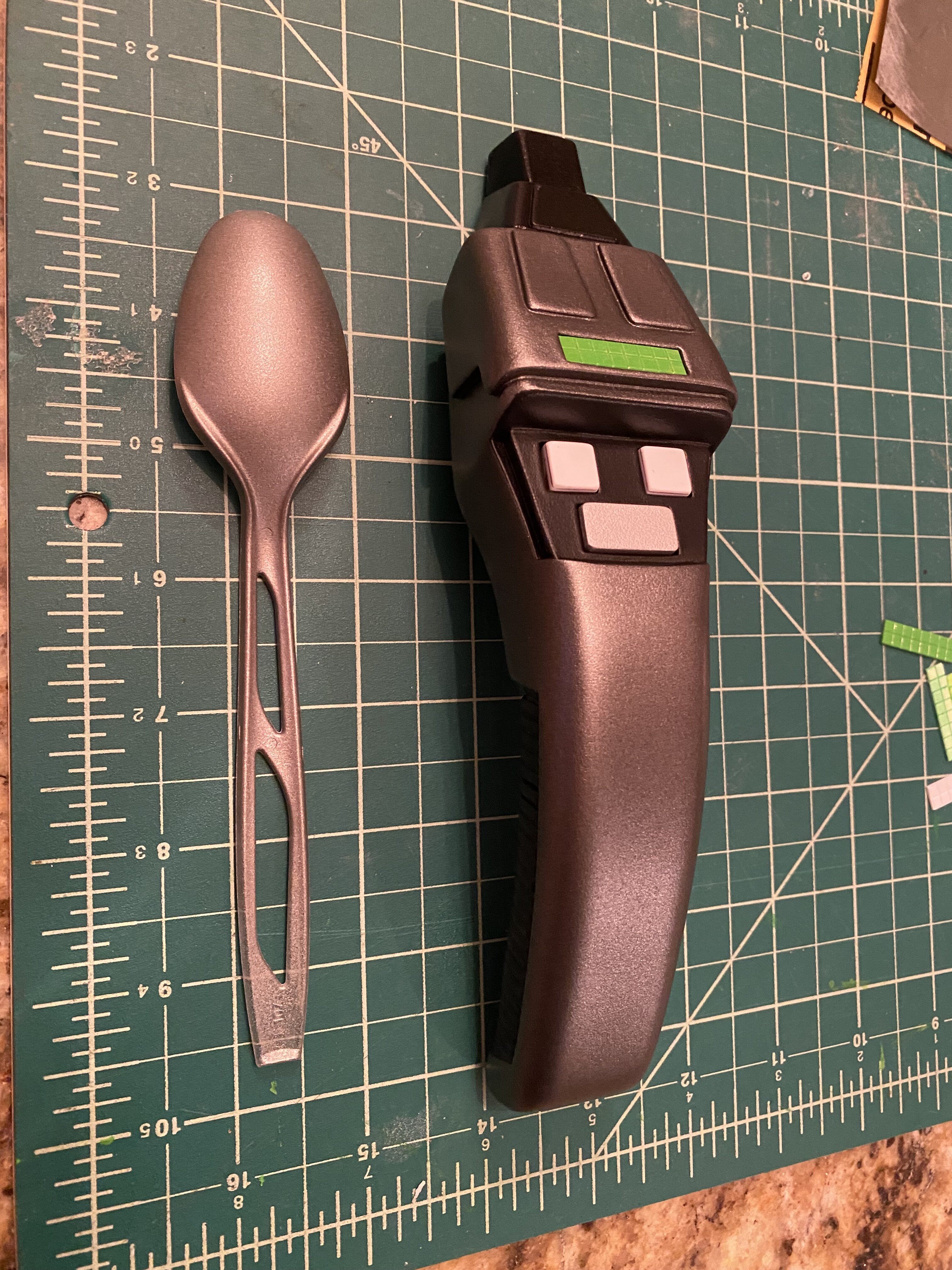

Ok, thought I’d post an update on my phaser build. Thanks to everyone for the comments and tips so far! The body has turned out great, using Duplicolor GM347 medium grey metallic silver, Duplioclor flat black for the button pad and Duplicolor matte clear coat.
The nozzle and setting buttons on the other hand are still giving me issues. I’ve probably stripped and repainted them ten times with different combos of paints. Have been using Duplicolor grey primer but my Krylon Colormaxx Ivory for the buttons stays tacky every time I apply it.
Using the same primer on the nozzle, it either dries tacky using Krylon colormaxx gloss black or dries without proper gloss and a blotchy texture using Duplicolor gloss black. I’m planning to strip again using goof off and retry with Krylon satin black.

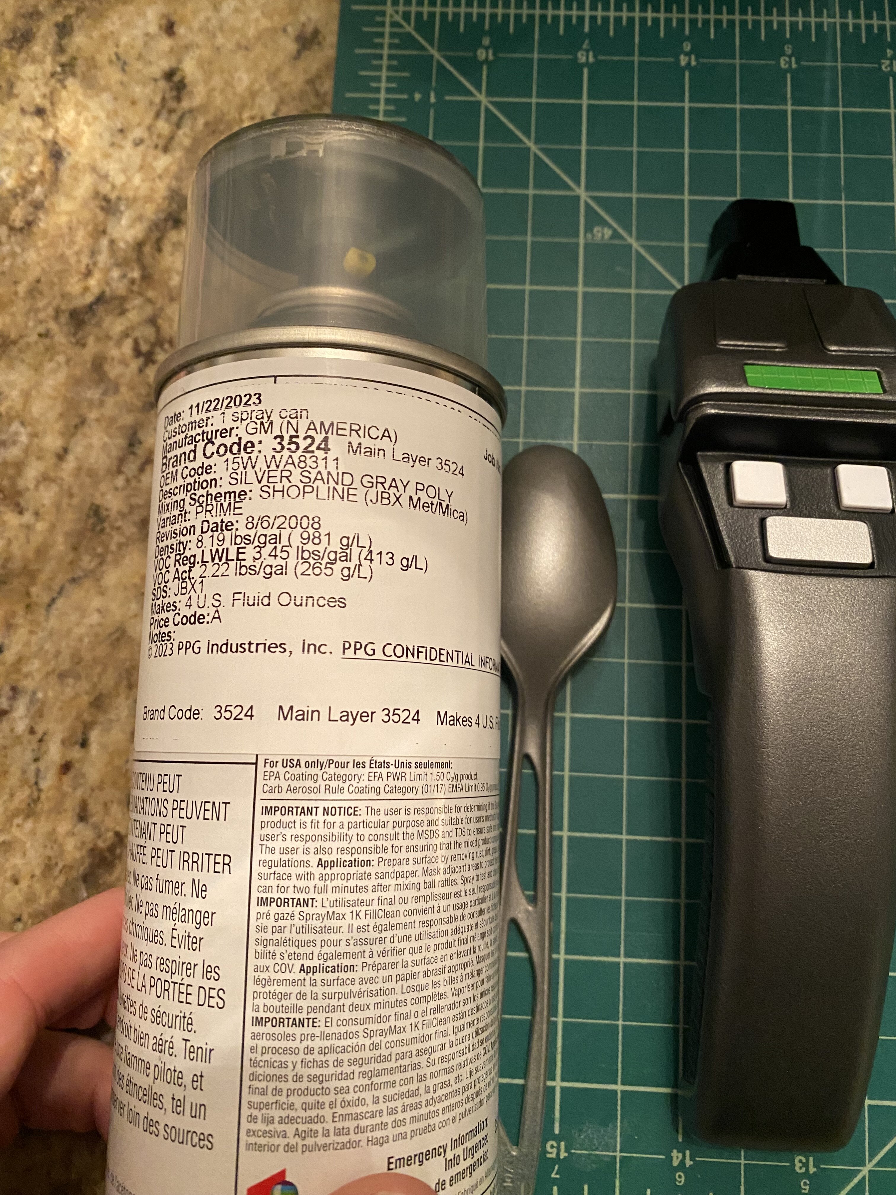

I picked up a can of the Silver Sand Metallic color today from an automotive paint shop using the codes posted on the thread. It looks nice on a spoon and I can’t wait to try it on another phaser once I get this first one finished. Its a little darker than the old Plastikote 7173 I have, but still looks great. Onward!
