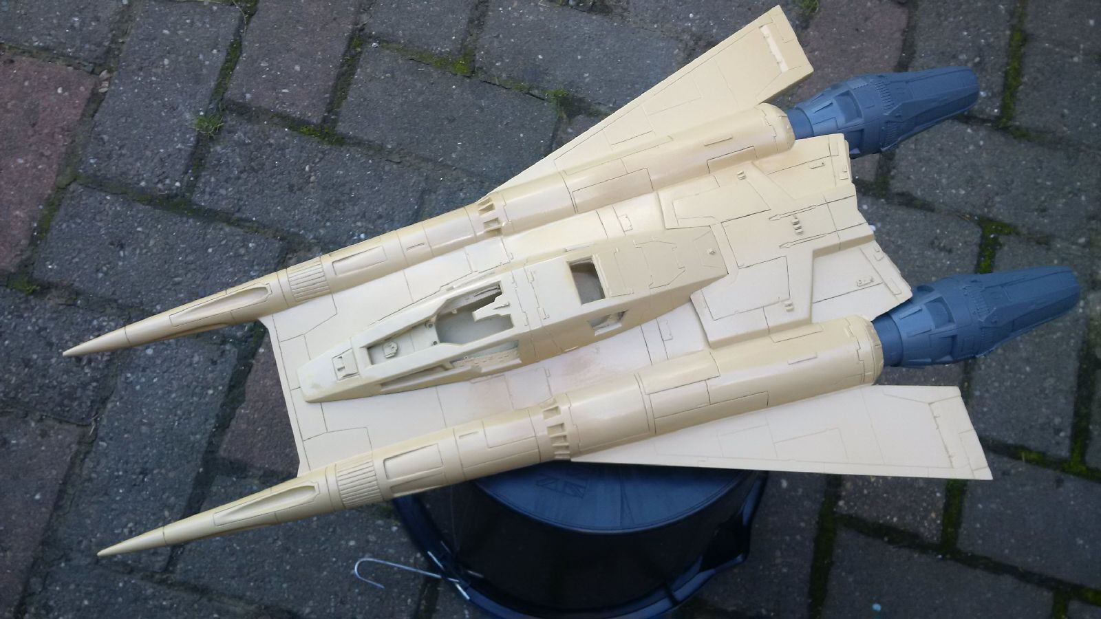

OK so I just sprayed the Pantne 467 and here are my thoughts:
1. The colour is horrible!!!
2. The spray nozzle is terrible as it sprays a thin but wide horizontal line rather than a nice cone of paint like the Halfords car cans do!!!
So there is too much paint deposited to get coverage I turned the nozzle 90 degrees to see if it did anything....no difference it still lays down too much paint. Off to Halfords to see if I can find a colour more in line with what I want...Namely a light sand colour as in

If these Pantones are to be used, I would suggest decanting them and using an airbrush. I will do this with the Thunderbird 2 colours I have for the 1/144 Imai Big one I have.

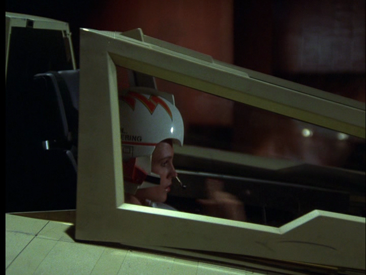

Though I guess it is more like this in colour
vlcsnap-2016-03-31-20h47m28s35.png In reality....not as the pic above.
Too yellow for the look I want. Decisions...decisions!
Might try Testers light air craft gray. It has a slightly warmer yellow cast, closer to the photo.
Sweet model by the way.
The original color is too yellow/tan for my taste, I'd prefer a white/gray myself. Inaccurate but I like what I like.
The nozzle design is a fan spray pattern and is meant to prevent heavy buildup. A horizontal line is for spraying in a vertical motion, a vertical line is for a horizontal motion. It works great when you know what to do with it. I saved a few fan nozzles to use on cans that don't have it.

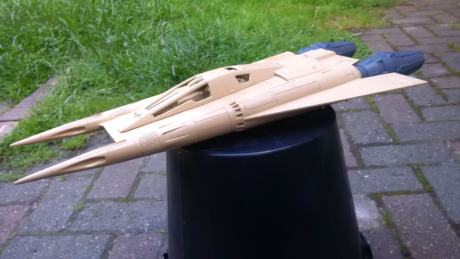

Robn, I considered swapping the nozzle for a Halfords one which I feel dumps less paint and is more controllable ( just my opinion ) but as I didn't like the colour so there was no point.I found the can put down a lot of paint which created the orange peel effect which I do not get with the Halfords. SoI picked up a can of spray from Halfords and have put down a layer. Will post pics tomorrow. It is Rover Rattan Beige.

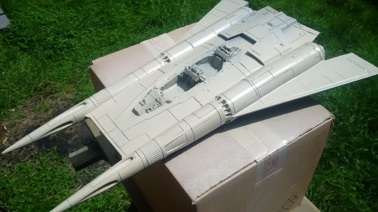

A super rough color correct, assuming that her helmet is white:
It's probably still quite not right but probably closer to what was photographed.
